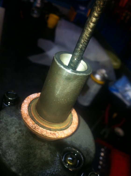

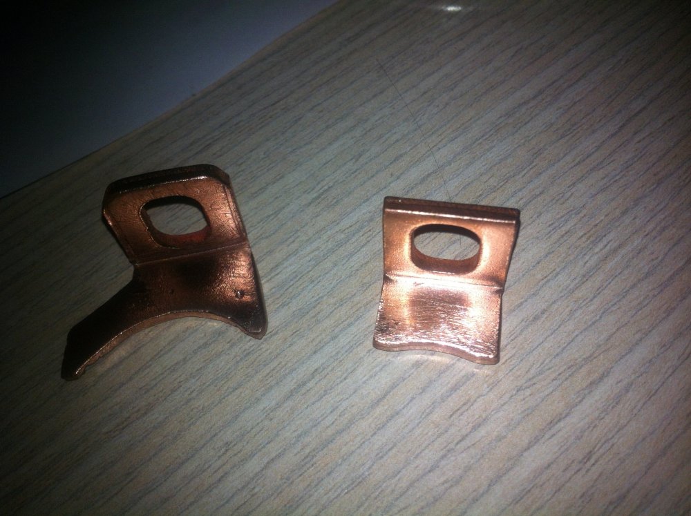

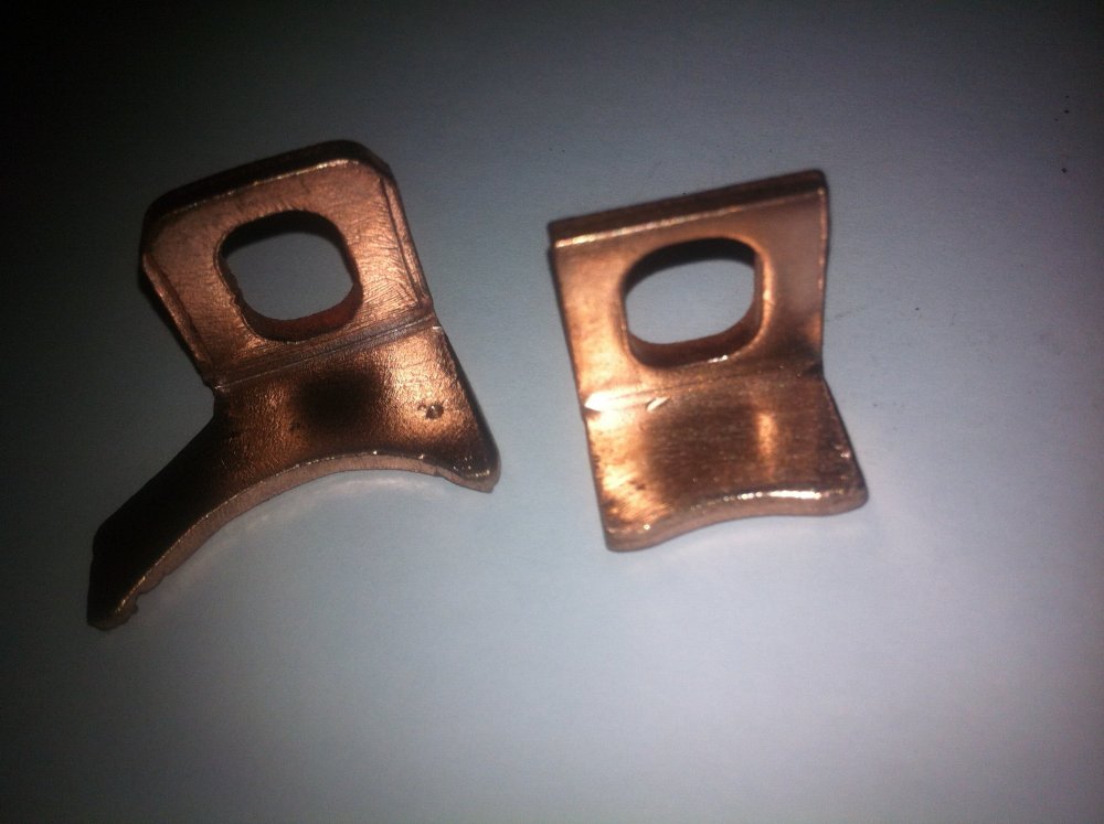

As promised:
Before:
IMG_0178.thumb.JPG.9df20952e3c50c824b895162d183f603.JPGIMG_0179.thumb.JPG.b97fbc0782fd23e3c2f34e3d4784c536.JPGIMG_0180.thumb.JPG.6c70e652dfe49993a4536cf6aa019f76.JPG
After:
IMG_0181.thumb.JPG.6f780fcebaf87e726c73d1dae993389a.JPGIMG_0182.thumb.JPG.700979043c5e24e5b2efab85ef1080f5.JPG

As promised:
Before:
[ATTACH=CONFIG]198734[/ATTACH][ATTACH=CONFIG]198735[/ATTACH][ATTACH=CONFIG]198736[/ATTACH]
After:
[ATTACH=CONFIG]198737[/ATTACH][ATTACH=CONFIG]198738[/ATTACH]

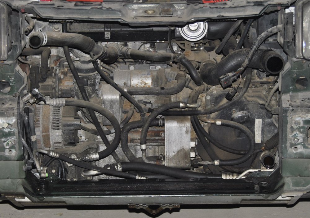

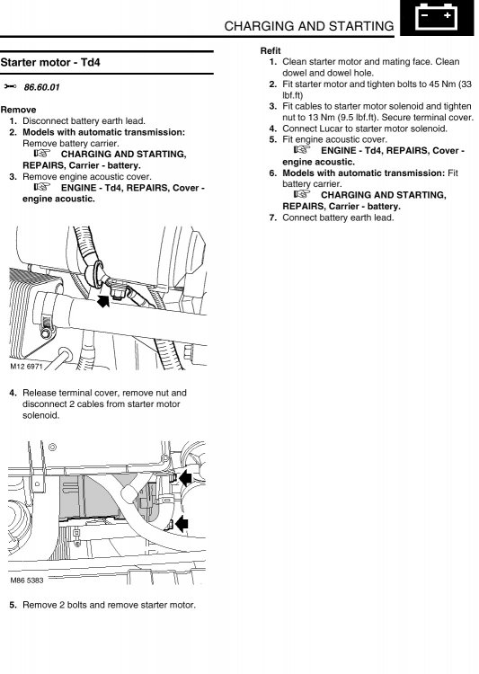

@rcdragomir, poate iti ajuta si poza asta, in ea se vede si pozitia electromotorului. Pentru un acces mai facil si vizibilitate perfecta as recomanda demontarea galeriei de admisie +EGR.
Editat de DKW
