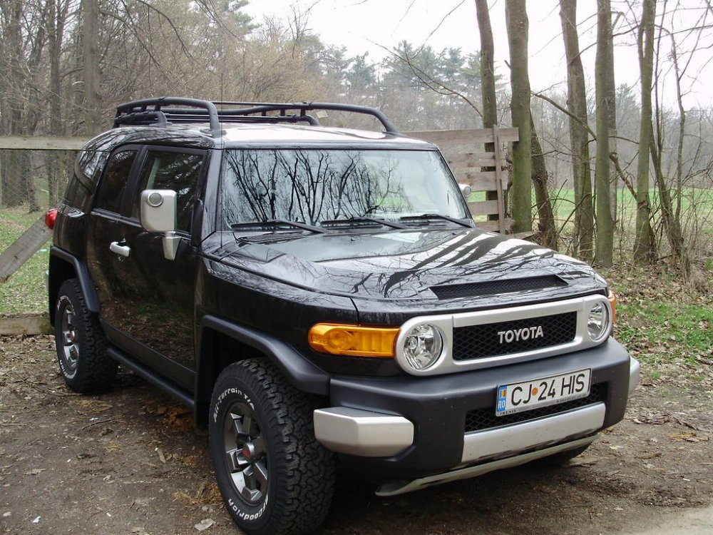

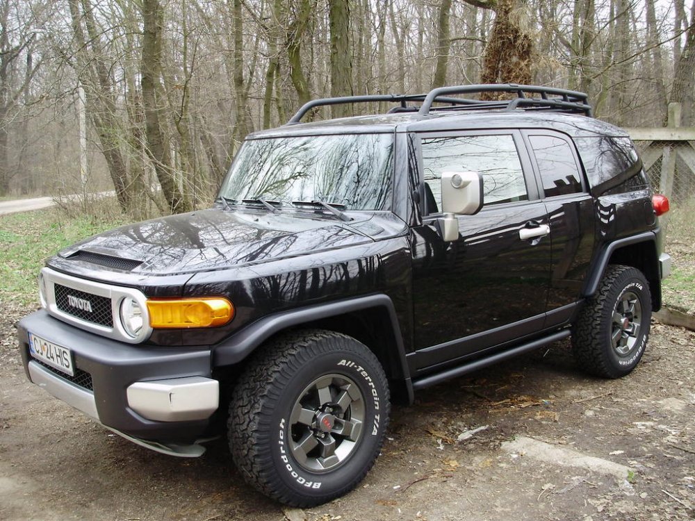

ALPINA Posted April 3, 2011 Author Share Posted April 3, 2011 (edited) Re: Despre FJ CRUISER? MULTUMESC DIN SUFLET CELOR CE SI-AU DAT SILINTA SA -MI EXPLICE DESPRE FJ! AM CONDUS MULTE MASINI DAR IN ASTA MA SIMT A C A S A:banana Edited April 3, 2011 by ALPINA NEVER DRIVE FASTER THAN YOUR GUARDIAN ANGEL CAN FLY!!!! Link to comment Share on other sites More sharing options...
seb560 Posted April 3, 2011 Share Posted April 3, 2011 Re: Despre FJ CRUISER? Fain arata... cit te-a dus? Sunt ceva bani astea Landcruiser Link to comment Share on other sites More sharing options...
ALPINA Posted April 3, 2011 Author Share Posted April 3, 2011 Re: Despre FJ CRUISER? 24000 am dat ! poate sunt prea entuziasmat insa daca voi face rost de cash si voi gasi una 0km am s-o iau si am s-o conserv pt mine!:tk NEVER DRIVE FASTER THAN YOUR GUARDIAN ANGEL CAN FLY!!!! Link to comment Share on other sites More sharing options...
seb560 Posted April 4, 2011 Share Posted April 4, 2011 Re: Despre FJ CRUISER? nu e rau pretul, sunt scumpe rau ar tb sa te grabesti ca din 2010 nu se mai fabrica daca vrei una noua oricum arata bestial Landcruiser Link to comment Share on other sites More sharing options...
ALPINA Posted April 11, 2011 Author Share Posted April 11, 2011 Re: Despre FJ CRUISER? acum i-am inteles pe cei ce le au de 2 ani si nu le-ar schimba! a mea e si TRD:bananadeci nici gand s-o revand! NEVER DRIVE FASTER THAN YOUR GUARDIAN ANGEL CAN FLY!!!! Link to comment Share on other sites More sharing options...
