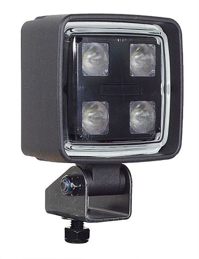

Am descoperit aceste proiectoare de la ABL Lights Group, din care mi-am montat 2 in spate si 6 imi voi monta in fata (pe Roof-rack):
ABL 500 LED
ABL 500 LED is a new LED work lamp with halogen performance. It is equipped with a patented LED-engine holding 4 high performance LEDs. To secure high output, performance and long life, a patented cooling system is used. ABL 500 LED meets the highest quality demands of the vehicle, forest and mining industry.
LED: 4 high performance LEDs. 6000 K
Voltage:10-36, 48 and 80 Volt
Light patterns: Medium flood, wide flood, broad beam
Mounting:Pedestal, pendant
Fixation: M10
Connection: Bare lead wire harness, integrated 2-pin Deutsch DT 04-2P Lens:
Hardened glass
Housing: Aluminium alloy
IP Rating: IP66
Vibration: SAE J577e AUG1970 1h
Operating temp.:-40 to +80°C
Applications: Forklifts, construction, mining, agriculture, forestry, utility ehicles,
military
EMC: EN 12895:2000
Thermal: Protected
Reverse voltage:Protected
Load dump protection:72V
Fac o lumina excelenta, perfect alba (6000K), si in fata vor completa f. bine "spoturile" si "ceata" de pe bullbar.
Un proiector are 4 leduri a` 3W si un consum de 1A. Adica 6 proiectoare consuma aproape cit un halogen de 55W + un bec de semnalizare de 21W:grin:.
Abia astept o noapte intunecoasa pt. a face un nou "Light-Test".
Revin cu poze
[ATTACH]99377[/ATTACH]
ABL 500 LED
Fixation: M10
Hardened glass
IP Rating: IP66
military
EMC: EN 12895:2000
Thermal: Protected
Revin cu poze

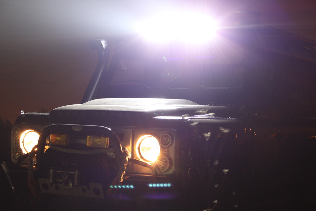

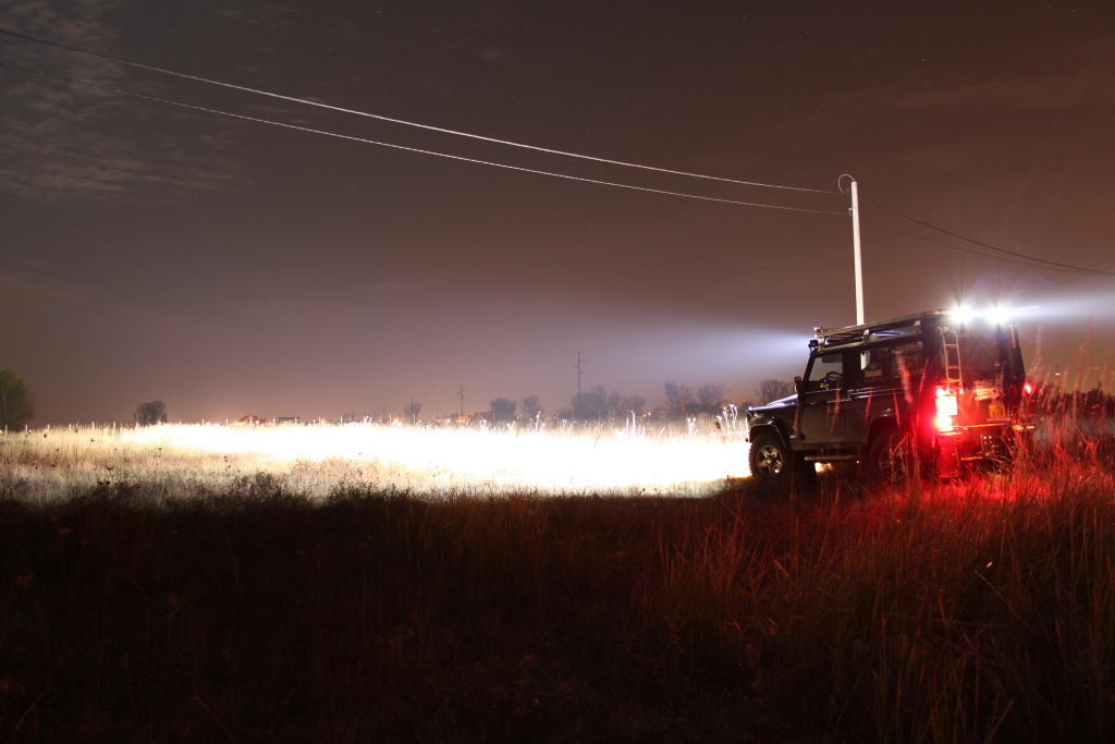

Cred ca am mai pus poze pe undeva-2 bucati Leduri 6x10 W, IP 68.La accident au sarit vreo 10 m pe sosea si nici nu s-au zgariat.
Cu faza scurta aprinsa:
Pe camp, impreuna cu faza lunga:
Alea din spate is 1 x10 W.
