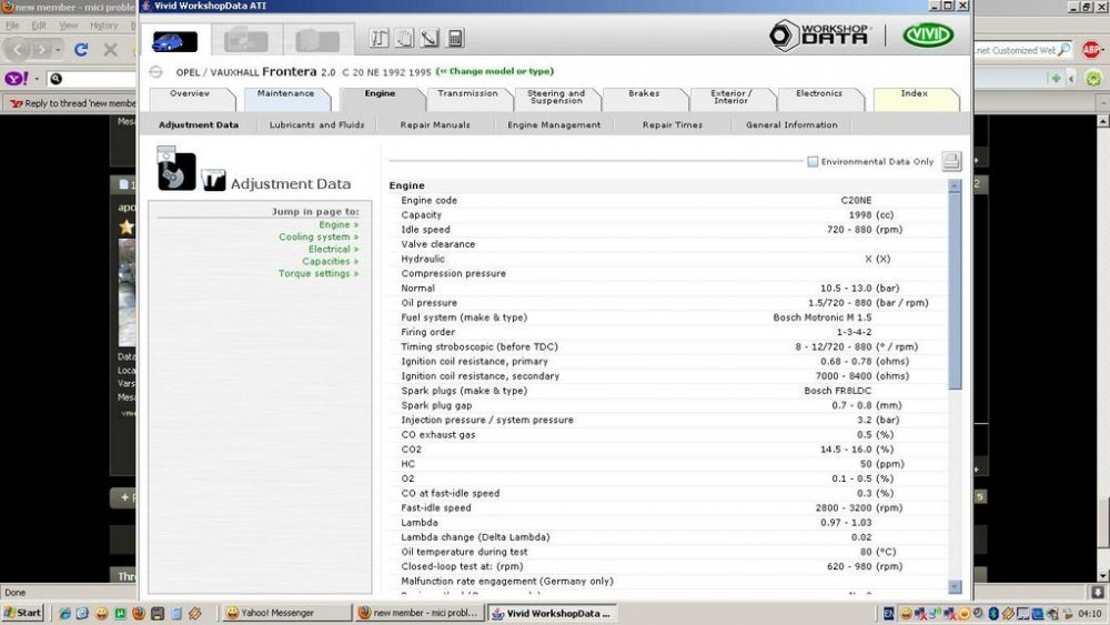

buuuunn! pina aici m-am lamurit si va multumesc, dar tot o sa va terorizez cu un miliard de intrebari. care ar fi turatia de ralanti la c20ne?
Re: new member - mici probleme ?
720 - 880 rpm
c20ne.thumb.jpg.0456fe19fc91f29d7a62419bd28519c5.jpgc20ne1.thumb.jpg.589b91468c543e7a1a07ffecdbecaf0b.jpg
