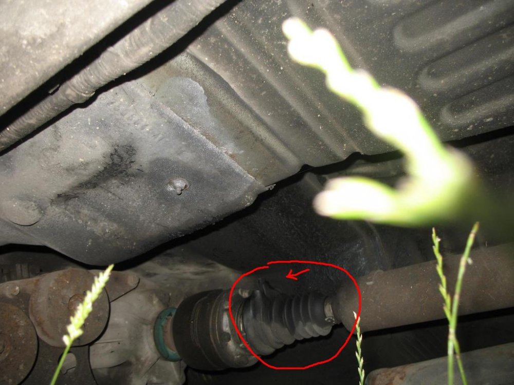

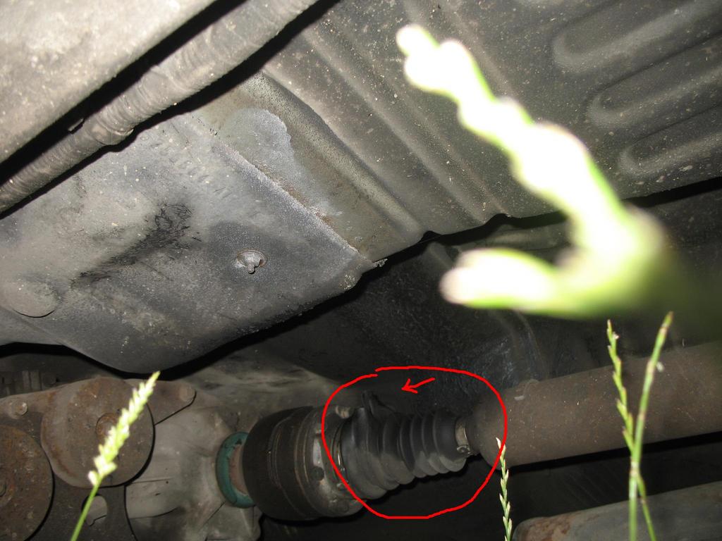

JeepDriver Postat Iunie 16, 2011 Autor Partajează Postat Iunie 16, 2011 Re: Problems with the front drive shaft, Grand Cherokee 2001 WJ, 3.1TD. Many thanks for the replays. Its good to see here are real Mates around. So now to the Problem. The Kardan is still on the car, its the Plastik how is broken and i dont think like this its so good to drive and i know i can kill the cardan with this. The next problem, i was at a few mechanics here around but not one is a jeep specialist. I like to make a service on the car, to change a few parts and also the oil, but only to change the oil is a big problem, they dont know Mopar here around:grin: I found one similar jeep as mine for parts, problem is i dont know if i can use all the parts because mine is a Right Hand drive the other one is LHD. Soooo my big question, i am located in Jud Hunedoara, maybe someone knows here around a jeep pro or can tell me where i can drive to find one. And its not a problem to went somewhere else here in Romania when i know i get help:)Here is also a picture from my small problem with the cardan. And one thin i like to do, at the moment the car is stock, but i like to build from it a Expedition Car, with all you need, new Tiers, Snorkel ect.... So maybe someone knows where to start....... Und nun noch an alle die hier deutsch verstehen, dann sag ich mal nett Hallo und freu mich auf neue Freunde.....:tk Link spre comentariu Distribuie pe alte site-uri Alte opțiuni partajare...
Heavy D. Postat Iunie 16, 2011 Partajează Postat Iunie 16, 2011 Re: Problems with the front drive shaft, Grand Cherokee 2001 WJ, 3.1TD. Hallo, John ! Mach erstmal die Kardanwelle runter, so darfst Du nicht rumfahren, ist kein Fett mehr drin und geht alles kaputt, wenn es nicht sogar schon ist... Da kann man eine Gummi-Manschette von irgendein anderes Fabrikat nehmen, muss nicht unbedingt Jeep sein, Hauptsache der Durchmesser stimmt. Gruss, Dragos Link spre comentariu Distribuie pe alte site-uri Alte opțiuni partajare...

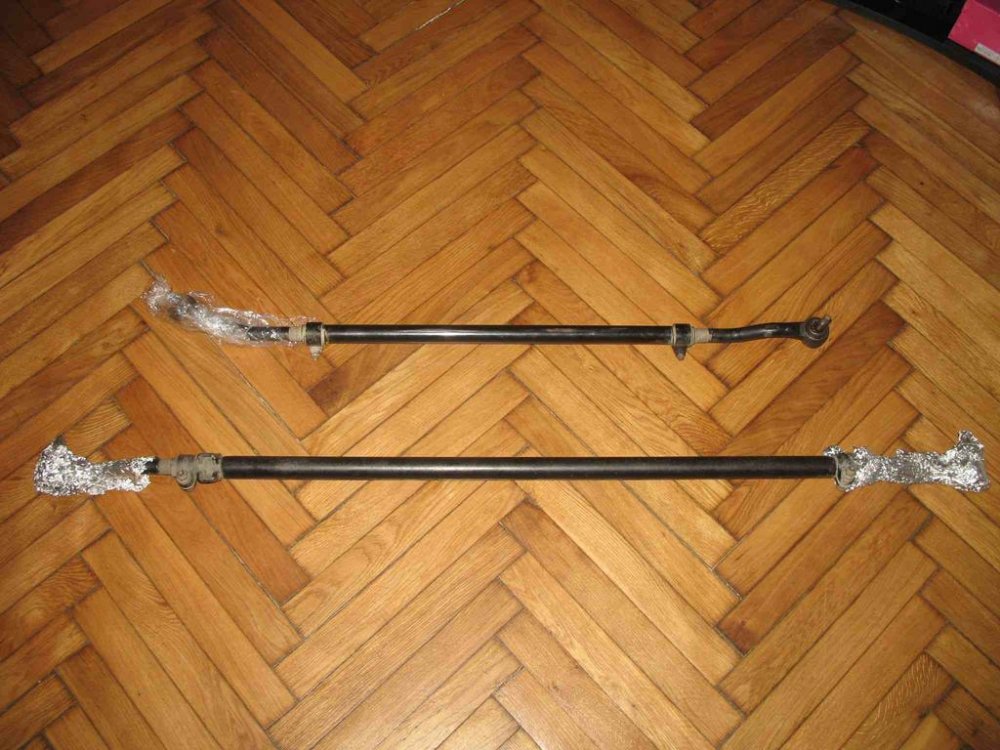

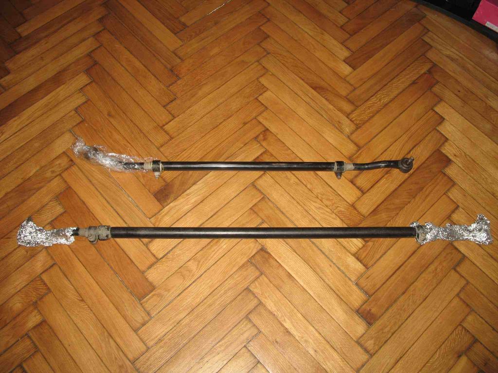

JeepDriver Postat Iunie 18, 2011 Autor Partajează Postat Iunie 18, 2011 Re: Problems with the front drive shaft, Grand Cherokee 2001 WJ, 3.1TD. Hello, this 2 Parts i take out from my parts Jeep and like to build them in my Jeep. The long one looks matching the short one is on one side differend. what of this fits in my Lefthand Jeep? Thanks. Link spre comentariu Distribuie pe alte site-uri Alte opțiuni partajare...
Heavy D. Postat Iunie 18, 2011 Partajează Postat Iunie 18, 2011 Re: Problems with the front drive shaft, Grand Cherokee 2001 WJ, 3.1TD. Hallo, Jos ! Lenkgestänge, also. Beide Stangen sind gleich, ob links oder rechts gesteuert, soweit Ich das Foto in Betrachtung nehme. Wenn die Lenkköpfe in Ordnung sind, leg los, einbauen. Und danach Achsvermessen nicht vergessen. Gruss, Dragos Link spre comentariu Distribuie pe alte site-uri Alte opțiuni partajare...
JeepDriver Postat Iunie 18, 2011 Autor Partajează Postat Iunie 18, 2011 Re: Problems with the front drive shaft, Grand Cherokee 2001 WJ, 3.1TD. Hallo Walter, dank dir. Gleich sind die, nur ist bei der kurzen auf einer Seite der Kopf in die andere Richtung, als den einfach tauschen? Link spre comentariu Distribuie pe alte site-uri Alte opțiuni partajare...
Heavy D. Postat Iunie 18, 2011 Partajează Postat Iunie 18, 2011 Re: Problems with the front drive shaft, Grand Cherokee 2001 WJ, 3.1TD. Bei der kurzen Stange kann man sowieso nur einen Kopf wechseln. Wieso hast Du nicht neue Stange oben und neue Köpfe unten eingebaut ? Es kann sein dass auch die Köpfe vom Rechtslenker schon ausgelutscht sind, und dann hast Du mehr gearbeitet als es sich gelohnt hat. Gruss, Dragos Link spre comentariu Distribuie pe alte site-uri Alte opțiuni partajare...
