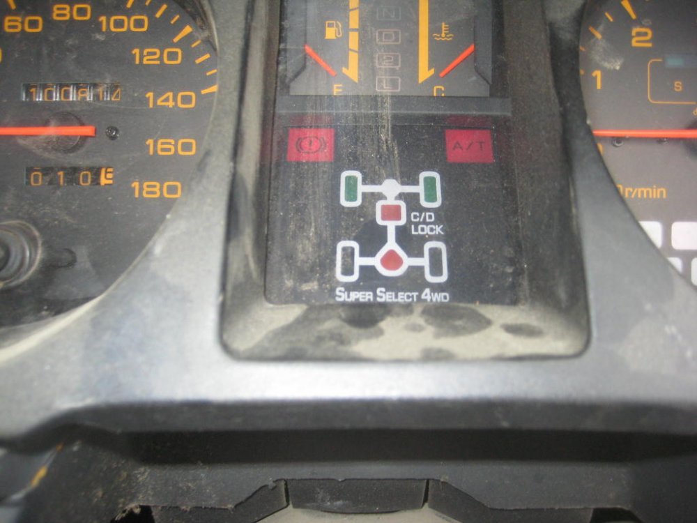

jighi Posted October 10, 2011 Share Posted October 10, 2011 salutare.........stie cineva unde e situata siguranta pentru r/d lock pajero 2 scurt 2.5td..pe capac nu se mai distoinge nimic.....o poza ar fi super misto..... multumesc..... pregatim masina ta pentru off road www.modificarioffroad.ro modificarioffroad@yahoo.com dezmembrari pajero mk2. 0730678039 Link to comment Share on other sites More sharing options...

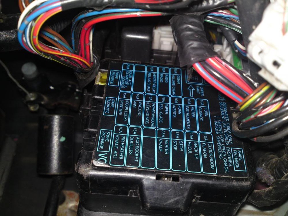

verssatu Posted October 10, 2011 Share Posted October 10, 2011 Re: blocant spate la buton pajero2....unde gasesc siguranta..... poate ajuta... Pajero 2,5 tdi SWB '95 BMW 330i sedan 2001 Suzuki SV650s 2004 Link to comment Share on other sites More sharing options...
jighi Posted October 10, 2011 Author Share Posted October 10, 2011 Re: blocant spate la buton pajero2....unde gasesc siguranta..... multumesc pentru poze......o sa verific maine... pregatim masina ta pentru off road www.modificarioffroad.ro modificarioffroad@yahoo.com dezmembrari pajero mk2. 0730678039 Link to comment Share on other sites More sharing options...

jighi Posted October 12, 2011 Author Share Posted October 12, 2011 Re: blocant spate la buton pajero2....unde gasesc siguranta..... merci versatule pentru poza ....era arsa siguranta...merge blocantu de rupe hamu...... pregatim masina ta pentru off road www.modificarioffroad.ro modificarioffroad@yahoo.com dezmembrari pajero mk2. 0730678039 Link to comment Share on other sites More sharing options...
