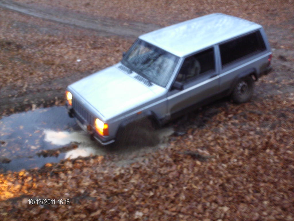

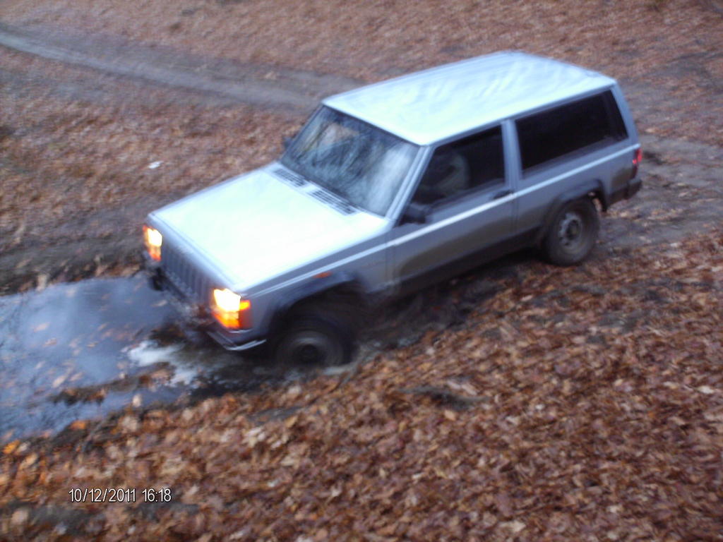

Chiar cu ceva timp in urma am vorbit cu proprietarul si i-am spus ca eu am reusit sa i-o innamolesc ,lucru care si l-ar fi dorit si el HPIM9104.thumb.jpg.3313056c8daa52b21f873549cbbd95a6.jpgHPIM9108.thumb.jpg.2ed0f627a5b42ea7c26ba97a9be0f273.jpgHPIM9110.thumb.jpg.d76e509ed4658e41fcf201b6199adc20.jpgHPIM9131.thumb.jpg.940c313c64511ebf3f614079e56cfc80.jpg

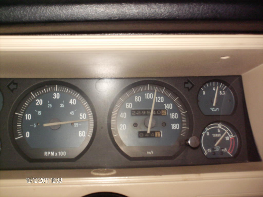

Nu luati in seama turometrul -,,a arde aiurea"
