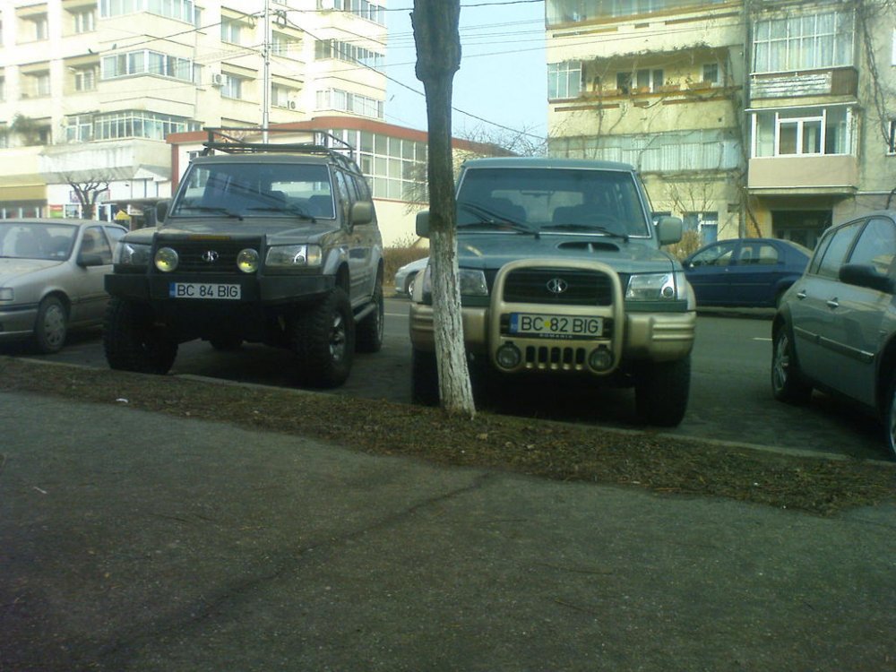

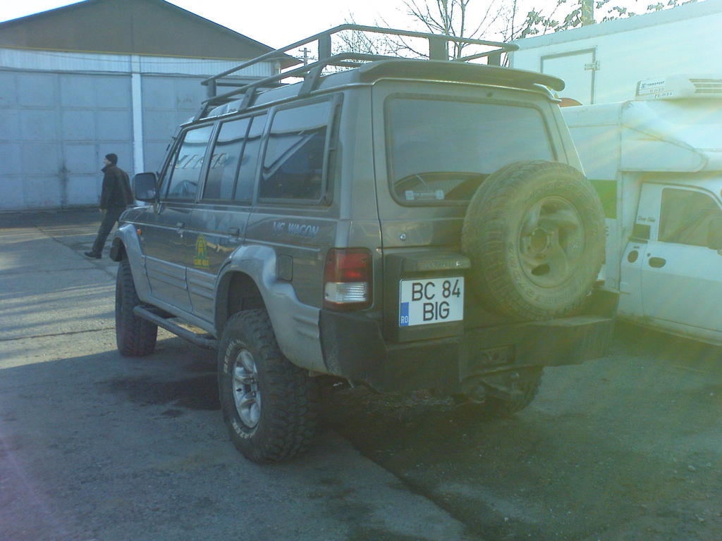

ghostface Posted December 30, 2011 Author Share Posted December 30, 2011 Re: mica mea herghelie pt inceput... "don't get scared, be prepared for the worst" frontera pregatita de razboi Link to comment Share on other sites More sharing options...
ghostface Posted December 30, 2011 Author Share Posted December 30, 2011 Re: mica mea herghelie si inca... "don't get scared, be prepared for the worst" frontera pregatita de razboi Link to comment Share on other sites More sharing options...
pescarul Posted December 30, 2011 Share Posted December 30, 2011 Re: mica mea herghelie Intr-un cuvant: BRAVO!! MA RAD DE MA STRIC:ypu Link to comment Share on other sites More sharing options...
macfero Posted December 30, 2011 Share Posted December 30, 2011 Re: mica mea herghelie si inca... [ATTACH=CONFIG]126492[/ATTACH][ATTACH=CONFIG]126493[/ATTACH][ATTACH=CONFIG]126494[/ATTACH] arata super misto. astept sa o vad live. daca si merge pe cat de bine arata, in teren, bineinteles, ai facut o supertreaba cu masina. sau poate o tii doar de plimbat in oras...:grin: Link to comment Share on other sites More sharing options...
