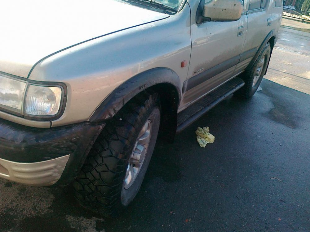

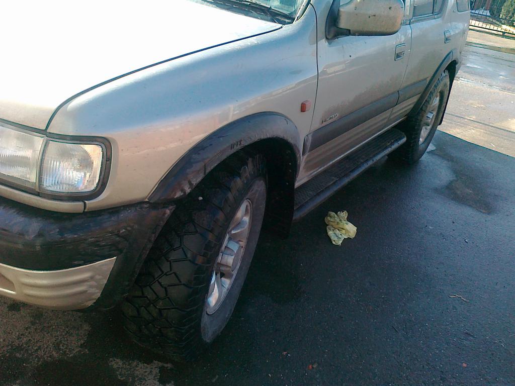

Pai la 32" trebuie ridicata de fata din bari, dar proba adevarata o faci in teren...
Uite cum vine cu 265/ 75 R16 ( ~ 32x 10.50 R16):
24022012331.thumb.jpg.2ec6d799e0f44b48fb596f899ab0a064.jpg24022012330.thumb.jpg.99e589456a4729ae7e69b0bbdea24c59.jpg24022012329.thumb.jpg.2c197de2eb3846c5782b8c4065836272.jpg
Si astea sunt resapate, deci probabil putin mai mari...
