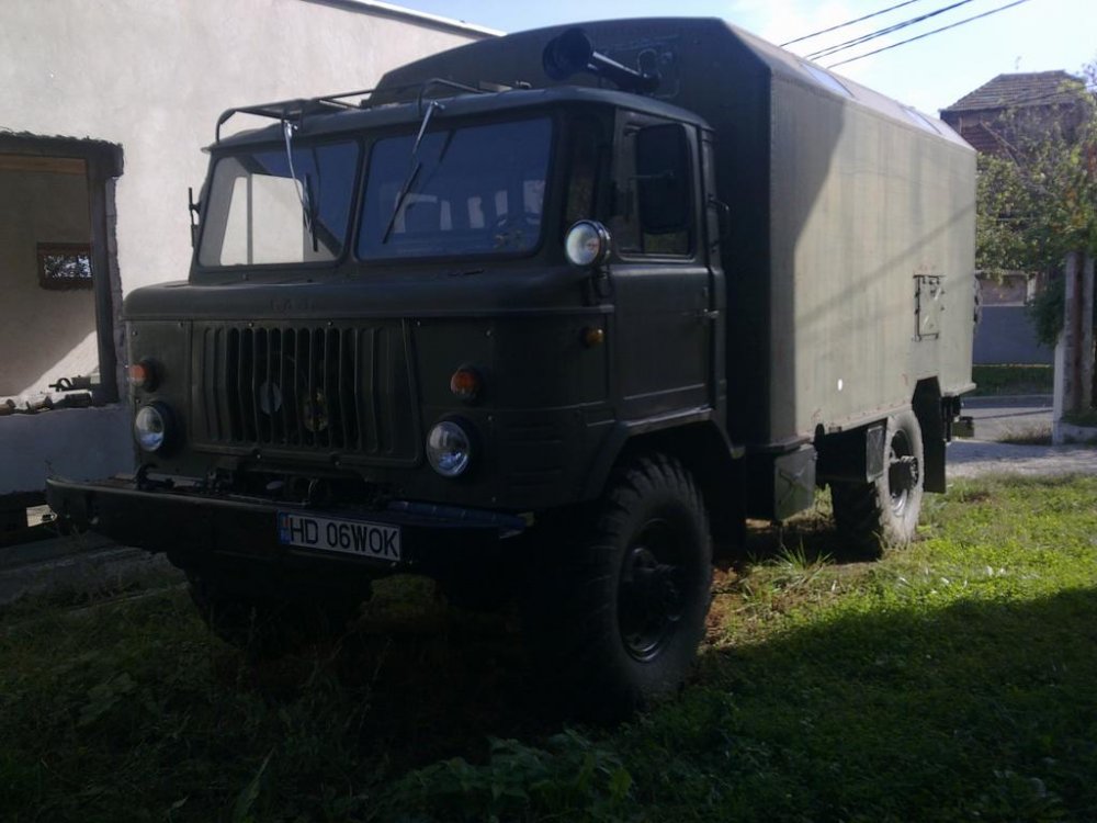

mihai ionescu Posted February 4, 2012 Share Posted February 4, 2012 (edited) Camionul a fost cumparat de la armata romana este fabricat in 1982 si are 1200 Km. Urmeaza sa fie transformat si amenajat autorulota expeditii Edited February 5, 2012 by mihai ionescu Link to comment Share on other sites More sharing options...
