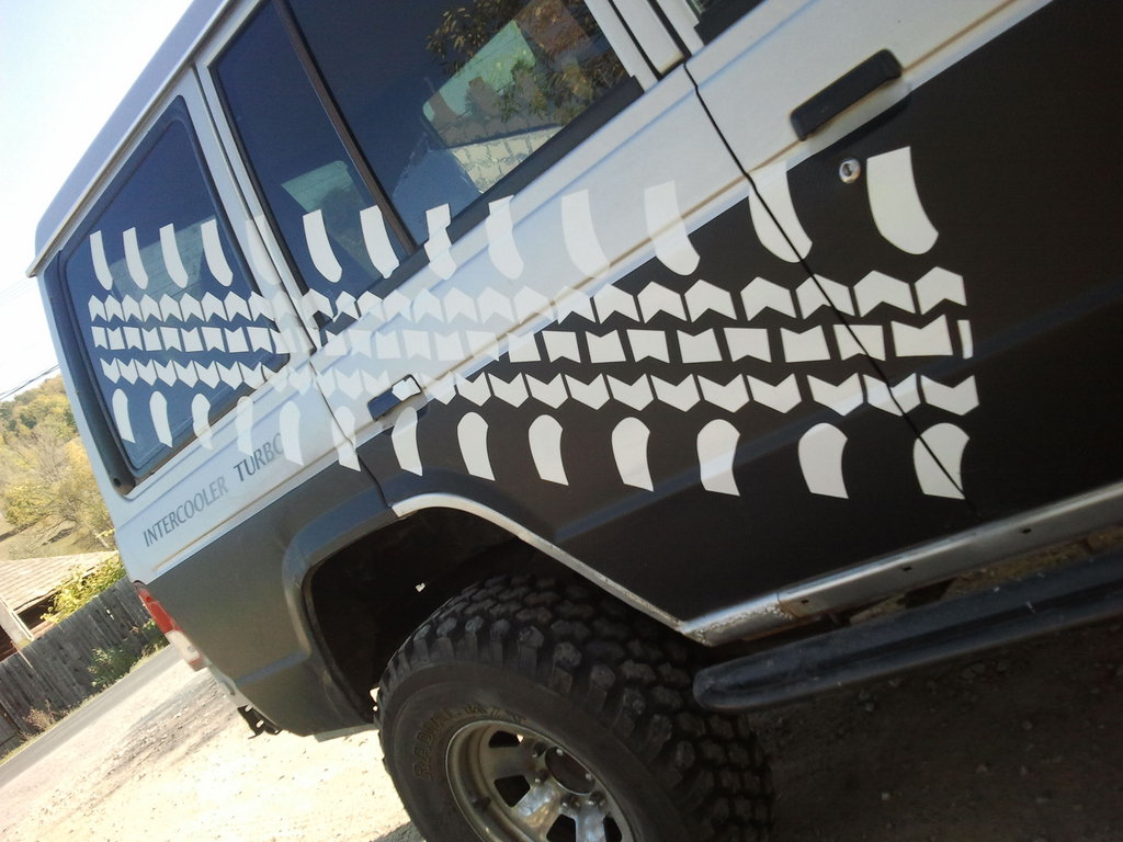

cobrra Posted September 4, 2012 Share Posted September 4, 2012 Re: Vreau sa o "cocostircesc" sa-ti spun doar ce am facut eu la al meu. un BL varianta ruseasca adica secvential .5,5cm fata si scazut treptat spate la 2,5 cm. pe spate arcuri de nissan patrol swb y60 fara nici o modificare si pe fata foarte putin din barile de torsiune. acum am anvelope 265/75/16 de la insa turbo si incap sigur si 33x12,5x15 at ca am avut si din acelea pe masina :h5 trebuie putin coafat la levierul de cuplaj 4x4 si in rest atentie la conductele de alimentare ,frana ,etc, etc, cam asa arata. http://img834.imageshack.us/img834/2654/imgp5921a.jpg Prahova 4x4 Link to comment Share on other sites More sharing options...

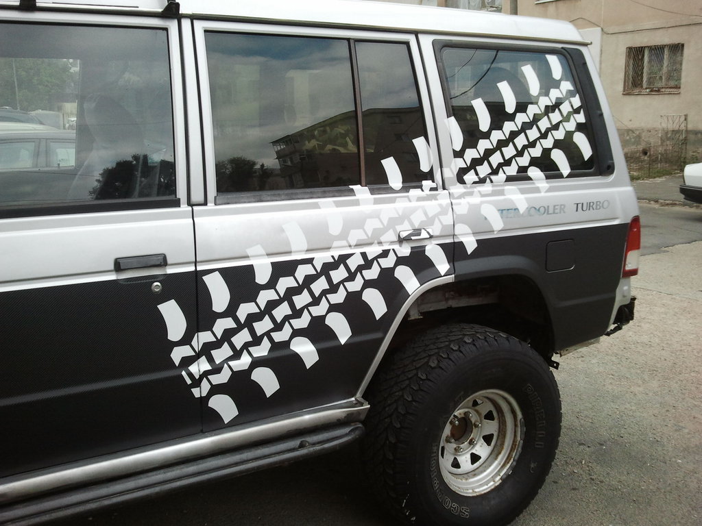

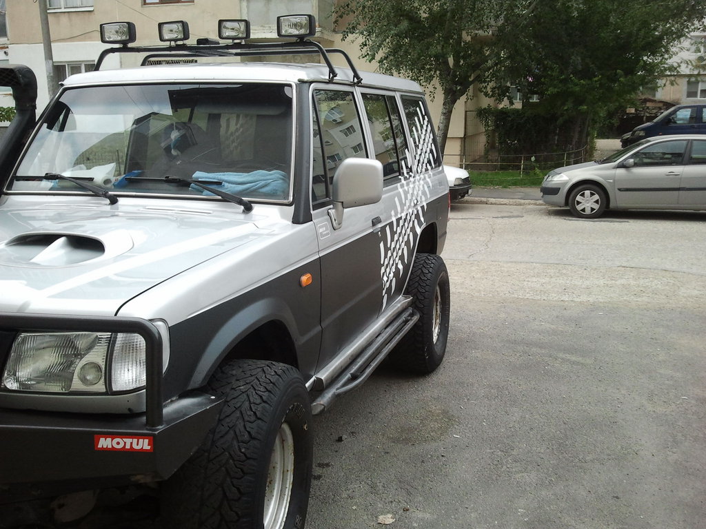

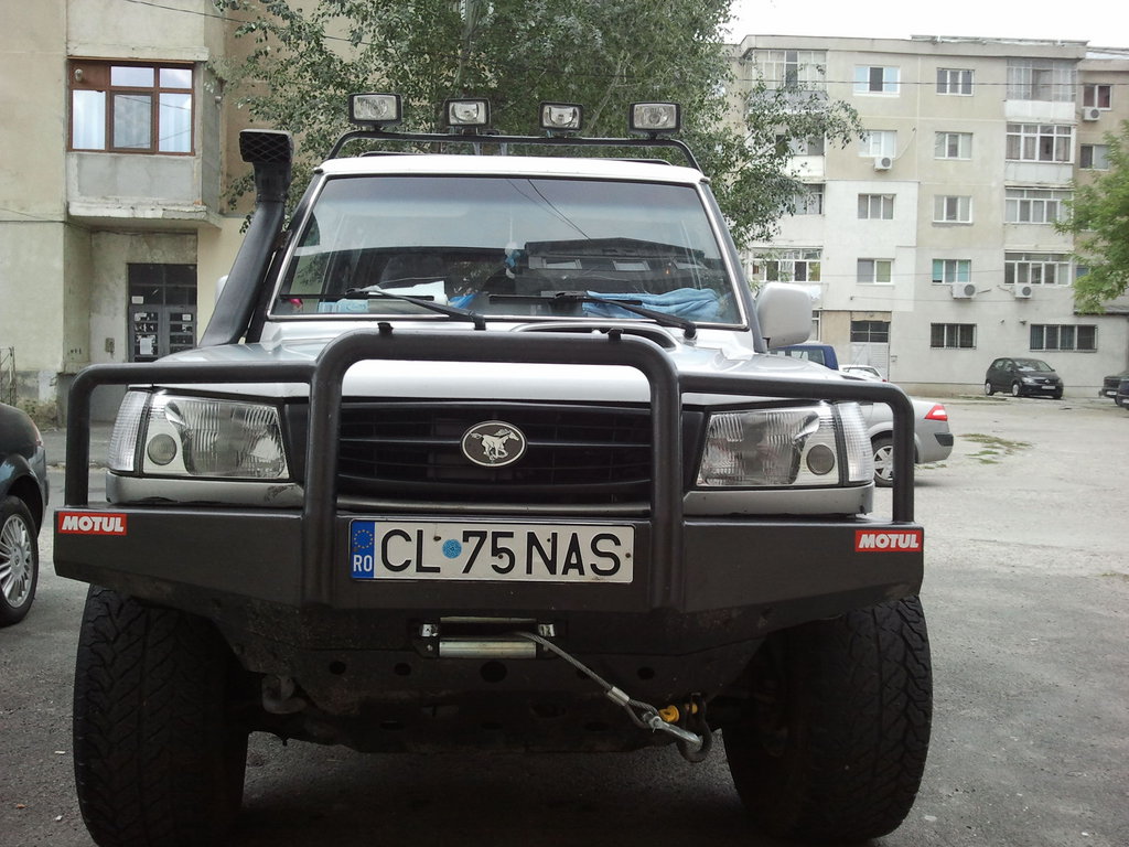

gigi_naste Posted September 5, 2012 Share Posted September 5, 2012 Re: Vreau sa o "cocostircesc"-inaltare Galloper eu la galloper am pus pe spate arcuri de patrol, bady lift de 5cm, amortizoare +5 trail master si sa nu uit modifici lungesti conductele de frana..........acum mam apucat sa dau plasticile jos poze mai tarziu cand termin Link to comment Share on other sites More sharing options...

gigi_naste Posted October 3, 2012 Share Posted October 3, 2012 Re: Vreau sa o "cocostircesc"-inaltare Galloper Link to comment Share on other sites More sharing options...
gigi_naste Posted October 3, 2012 Share Posted October 3, 2012 Re: Vreau sa o "cocostircesc"-inaltare Galloper asa arata tractorasul meu Link to comment Share on other sites More sharing options...
CatalinU Posted October 3, 2012 Share Posted October 3, 2012 Re: Vreau sa o "cocostircesc"-inaltare Galloper arata demential,imi place la nebunie.si eu ma uitam la telescoapele trailmaster,insa nu stiu ce arcuri sa pun Ever tried.Ever failed.Try again.Fail again.Fail better Link to comment Share on other sites More sharing options...
