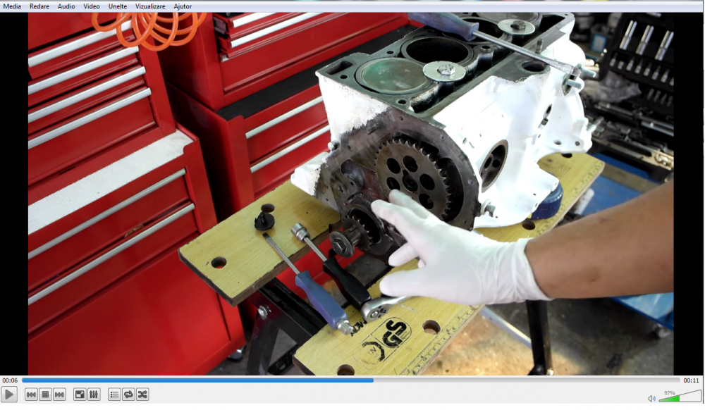

icXu Posted September 20, 2014 Author Share Posted September 20, 2014 Re: ARO Spartana Offroad. Treaba grea ,dar cu rabdare se face. Asteptam si un filmulet cu masina in actiune . [video=youtube;P7Jv8K-PUws] My Build: ARO Spartana Offroad Link to comment Share on other sites More sharing options...

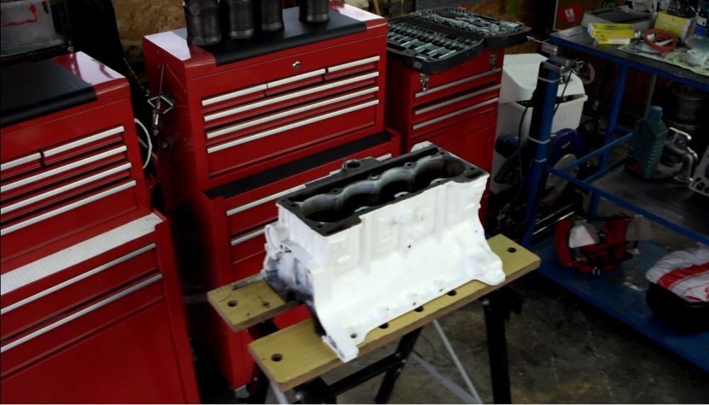

icXu Posted October 30, 2014 Author Share Posted October 30, 2014 Re: ARO Spartana Offroad. Motorul asteapta linistit sa fie terminat, a primit si un kit pentru racirea uleiului, mai trebuie sa ii pun la punct injectia. http://i1106.photobucket.com/albums/h367/icXu/Pe%20net/20141005_165837_zpsb032900f.jpg Poze de la ultimele iesiri: http://i1106.photobucket.com/albums/h367/icXu/Pe%20net/20141012_154948_RichtoneHDR_zps99662ef5.jpg http://i1106.photobucket.com/albums/h367/icXu/Pe%20net/20141019_145801_RichtoneHDR_zps87be5faa.jpg http://i1106.photobucket.com/albums/h367/icXu/Pe%20net/20141012_154831_RichtoneHDR_zps7e91bdd4.jpg My Build: ARO Spartana Offroad Link to comment Share on other sites More sharing options...

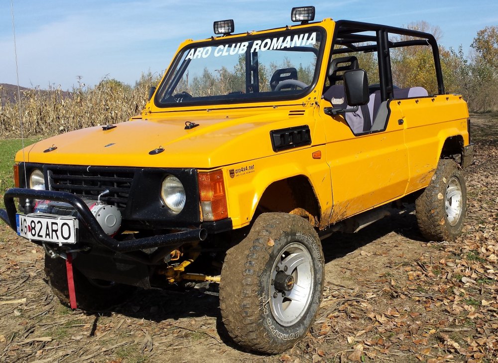

icXu Posted February 13, 2015 Author Share Posted February 13, 2015 Re: ARO Spartana Offroad. Am umblat iar la cutia cu maimute si am schimbat sigurantele de capota cu unele AeroCatch : http://i1106.photobucket.com/albums/h367/icXu/Pe%20net/20150202_165649_Aleea20Republica_zps7vnuozmi.jpg http://i1106.photobucket.com/albums/h367/icXu/Pe%20net/20150203_163532_Aleea20Republica_zpsc7aypxv5.jpg http://i1106.photobucket.com/albums/h367/icXu/Pe%20net/20150205_164353_Aleea20Republica_zpsznvh6itb.jpg?t=1423252569 http://i1106.photobucket.com/albums/h367/icXu/Pe%20net/20150205_164717_Aleea20Republica_zpstdk84yrm.jpg Cand imi va permite vremea o sa le vopsesc in culoarea caroseriei. http://i1106.photobucket.com/albums/h367/icXu/Pe%20net/20150209_143208_zpswx4098bb.jpg?t=1423413198 My Build: ARO Spartana Offroad Link to comment Share on other sites More sharing options...
Liviu-San Posted February 13, 2015 Share Posted February 13, 2015 (edited) Re: ARO Spartana Offroad. E chestie de gust,dar eu le-as lasa negre,daca tot le-ai montat,macar sa se vada:wink: L.E.- Daca vrei sa le vopsesti,sa le dai inainte cu solutie pentru plastic,sa nu ti se cojeasca vopseaua. Edited February 13, 2015 by Liviu-San Link to comment Share on other sites More sharing options...
wolfman Posted February 13, 2015 Share Posted February 13, 2015 Re: ARO Spartana Offroad. Arata bine dar sa vezi injuraturi iarna cand vor ingheta. Si o intrebare: la ce folosesc? "Majoritatea oamenilor se tem atat de mult sa piarda ceva incat toata viata au grija sa nu aiba ce sa piarda." Link to comment Share on other sites More sharing options...
Liviu-San Posted February 13, 2015 Share Posted February 13, 2015 Re: ARO Spartana Offroad. Arata bine dar sa vezi injuraturi iarna cand vor ingheta. Si o intrebare: la ce folosesc? Raspunsul la intrebarea ta ti l-ai dat singur in prima fraza. Daca ipotetic vorbind,prin nu stiu ce imprejurari si ghinion ti se strica incuietoarea originala a masinii si carligul de siguranta,la o viteza supersonica,te poti trezi cu capota pe parbriz(s-a mai intamplat si chiar destul de des) Oricum,mie imi place cum arata si cred ca se potrivesc cu "stilul"masinii. Cat despre injuraturi iarna...s-au inventat spray-urile de dezghetat yalele,e acelasi lucru ca si la usa.(numai sa nu-l uiti in masina:grin:) Link to comment Share on other sites More sharing options...
wolfman Posted February 13, 2015 Share Posted February 13, 2015 Re: ARO Spartana Offroad. Aha...m-am prins. Am intrebat deoarece indifferent de conditiile in care am abuzat masina, nu am patit sa se deschida capote singura. "Majoritatea oamenilor se tem atat de mult sa piarda ceva incat toata viata au grija sa nu aiba ce sa piarda." Link to comment Share on other sites More sharing options...
Liviu-San Posted February 13, 2015 Share Posted February 13, 2015 Re: ARO Spartana Offroad. Aha...m-am prins. Am intrebat deoarece indifferent de conditiile in care am abuzat masina, nu am patit sa se deschida capote singura. Chiar am intalnit cativa posesori de turisme carora li s-a deschis capota pe autostrada si nu numai.S-a lasat cu parbrize sparte si stalpi indoiti.Sa nu mai pomenesc de sperietura in sine.De obicei se intampla fenomenul,cand sunt masinile lovite frontal si nu sunt reparate cum trebuie. Link to comment Share on other sites More sharing options...

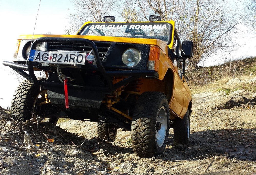

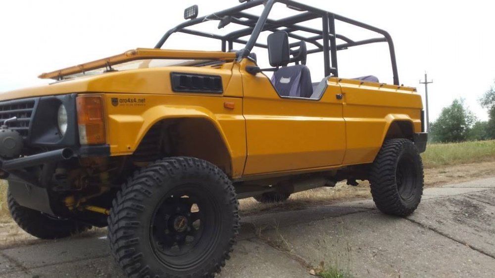

icXu Posted February 13, 2015 Author Share Posted February 13, 2015 (edited) Re: ARO Spartana Offroad. E chestie de gust,dar eu le-as lasa negre,daca tot le-ai montat,macar sa se vada:wink: Mi-ar place sa le vopsesc pentru ca este cam incarcata capota, are pe ea suportii pe care se rabateaza parbrizul, are aerisirile laterale si acum are si sigurantele astea care sar in ochi. Dar la sfatul publicului cred ca o sa le las asa. Arata bine dar sa vezi injuraturi iarna cand vor ingheta. Si o intrebare: la ce folosesc? Nu mai am incuietoarea originala a capotei din cauza ca am montat un radiator mai mare, mi-a fost mai usor sa montez sigurante de capota decat sa adaptez vechea incuietoare. In toamna a primit si distaniere de 300mm: Edited February 13, 2015 by icXu My Build: ARO Spartana Offroad Link to comment Share on other sites More sharing options...
Liviu-San Posted February 13, 2015 Share Posted February 13, 2015 Re: ARO Spartana Offroad. Negrul se "asorteaza" la fix cu galbenul,nu conteaza cat si cum, pt ca face parte din combinatie. Atat timp cat nu mai exista o a 3-a culoare,nu-i problema.:wink: Radiatorul l-ai pus pe cel marit de 1.6 de Nova cu termocupla si electroventilatoare? Link to comment Share on other sites More sharing options...
icXu Posted February 14, 2015 Author Share Posted February 14, 2015 (edited) Re: ARO Spartana Offroad. Am pus radiatorul de berlina 1.6 injectie (cu termocupla si GMV) pentru ca am pastrat sistemul clasic de racire; cu toate ca raditorul este nou o sa il schimb cu cel de pe 10.4 - 1.9Diesel pentru ca mult mai mare (in configuratia actuala se cam incinge in offroad mai hard, poate si datorita troluiului care ii mai ia din aer. Edited February 14, 2015 by icXu My Build: ARO Spartana Offroad Link to comment Share on other sites More sharing options...

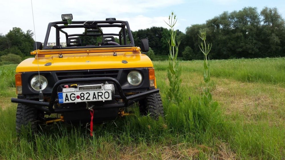

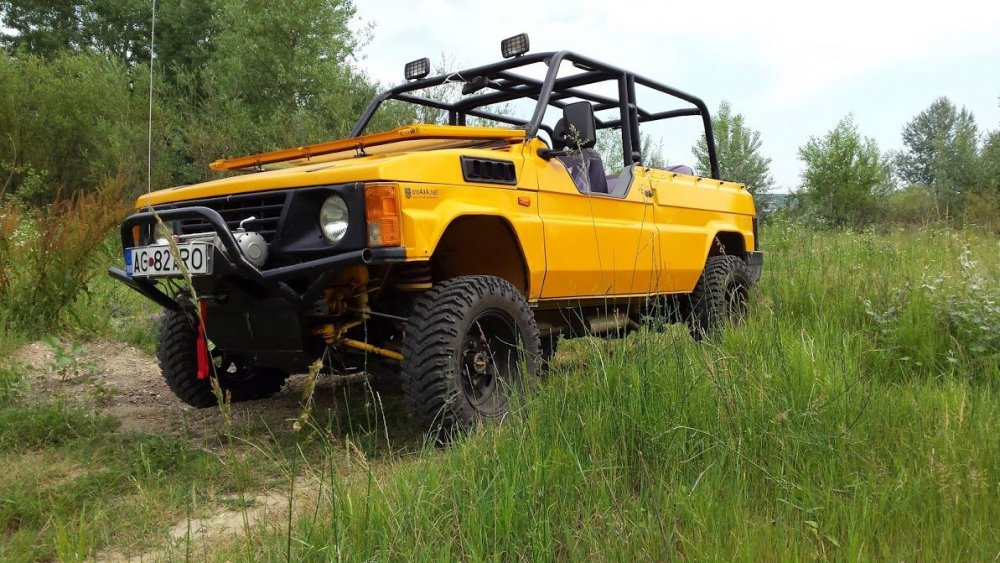

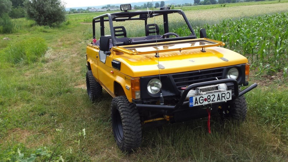

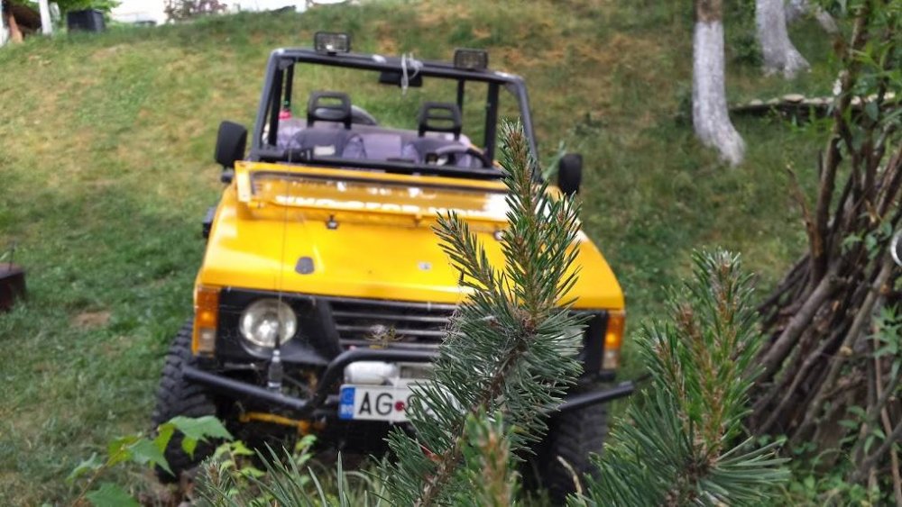

icXu Posted June 24, 2015 Author Share Posted June 24, 2015 Re: ARO Spartana Offroad. Ultima iesire, cu wheel spacers de 30mm si jantele intoarse: My Build: ARO Spartana Offroad Link to comment Share on other sites More sharing options...
