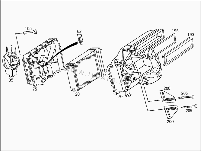

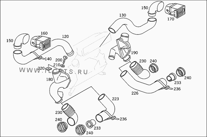

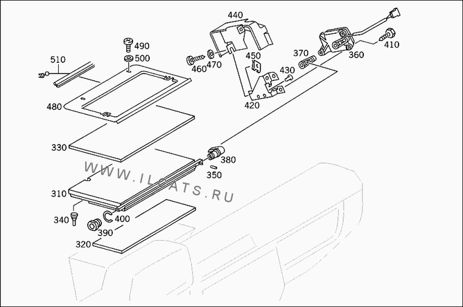

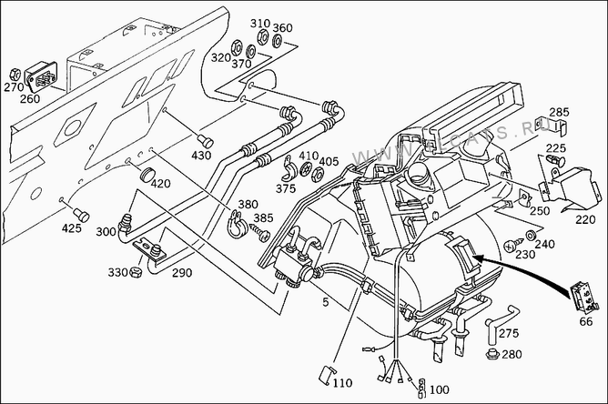

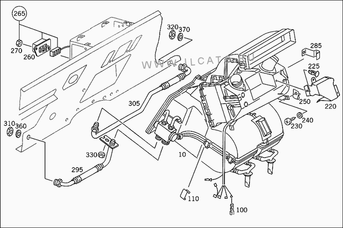

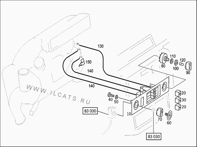

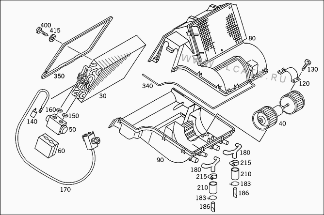

Din culegerea mea de date am strans cateva scheme cu instalatia de incalzire a masinii si pun cateva poze ,poate mai ajuta pe cineva.
indexaa_php.gif.f3baf516d7b1e324a874eadc5d041028.gifindex5_php.gif.c3aec23990bba16c3ed391d2b02d2602.gifindex000_php.gif.b9aa949862761238b8f0daee5df0e90a.gifindex7_php.gif.f8d92c46dc97c27208e165854d014048.gifindex78_php.gif.ee13f59c07cad9899d6d1f4d0811f4ce.gifindex1111_php.gif.0da0c635c6a52d0ef8957d00e079ac03.gifindex_php.gif.101e2b761852e6af51ce8e8dc393131a.gif
