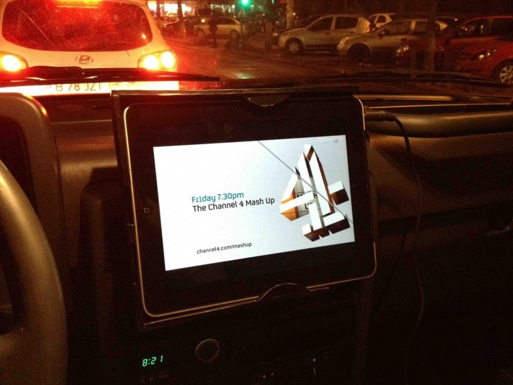

2pac Posted January 5, 2013 Share Posted January 5, 2013 Re: GPS Harti offroad poti folosi un IPAD pe care sa ai instalat program gps................gps track------motion x uite ce am facut eu: http://forum.club4x4.ro/showthread.php?76087-Vreau-sa-instalez-ipad-ul-in-bord-la-nissan-patrol-y60&p=852259#post852259 [ATTACH=CONFIG]163127[/ATTACH] HURT ME WITH THE TRUTH DON`T CONFORT ME WITH A LIE. Link to comment Share on other sites More sharing options...
