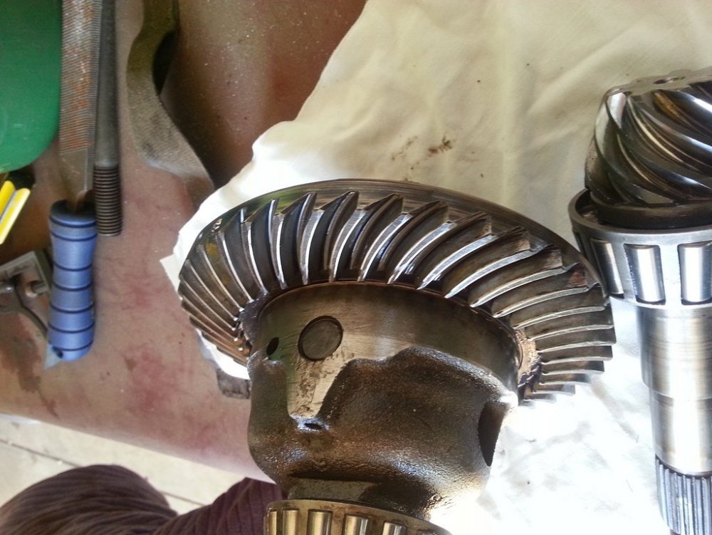

I'm in Australia and have the only road registered ARO 10.1 4x4's.

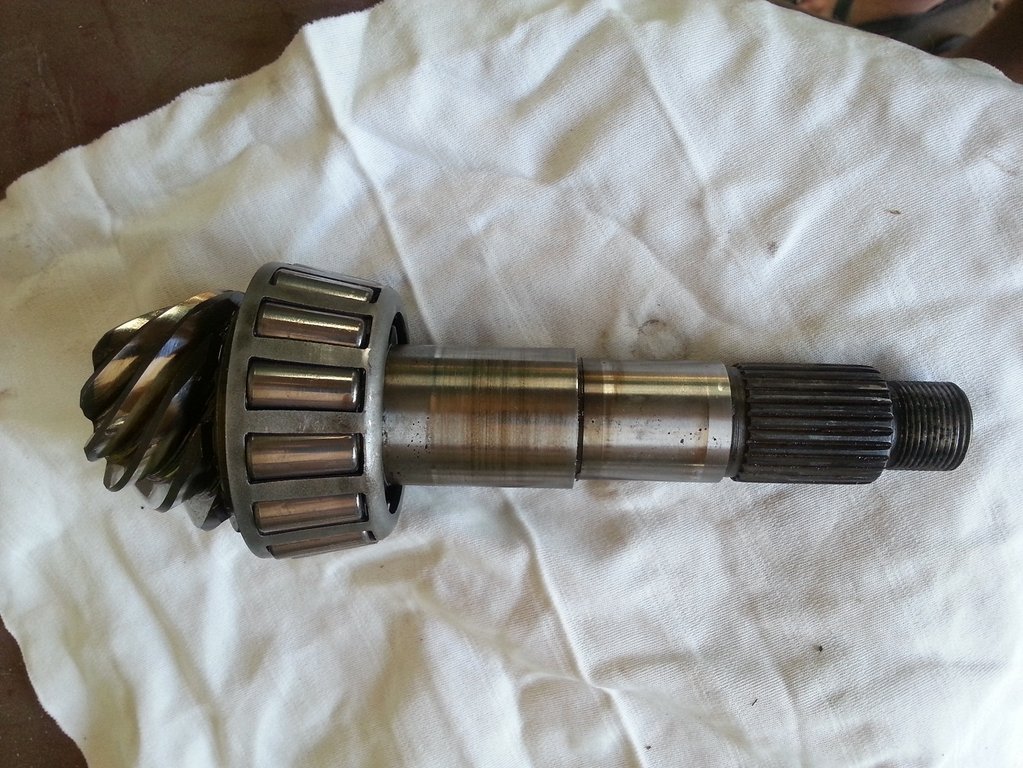

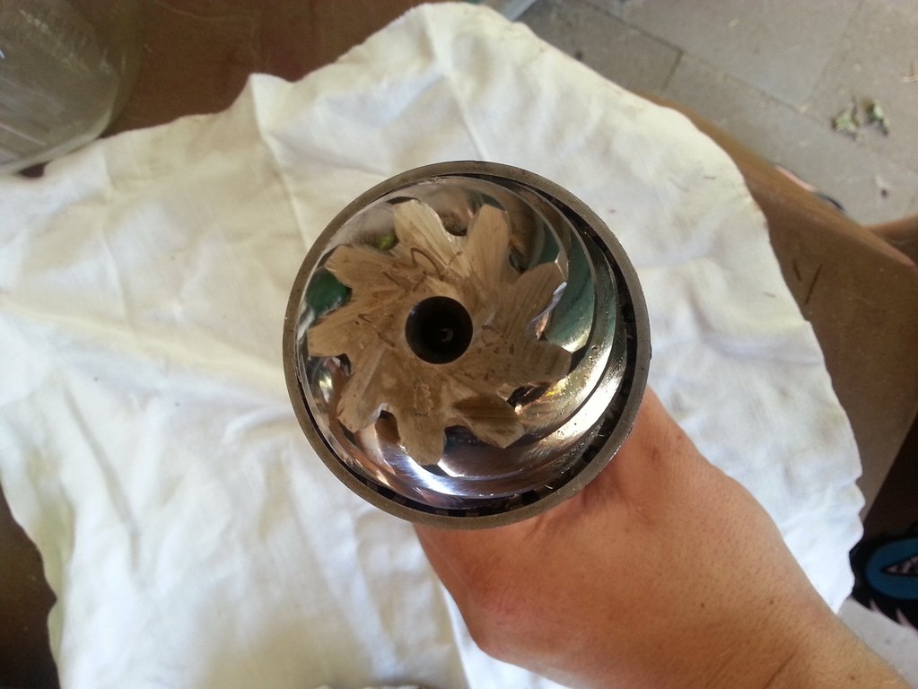

I have had a pretty bad rear differential whine and had the diff looked at by a diff builder, turns out there is a pretty bad wear mark on the crown wheel & pinion.
So I'm looking for a crown and pinion to suit a 1984 ARO 10.1 1.3litre 4 speed. The crown wheel has 41 teeth & the pinion had 9 teeth.
Can anyone please help.

Thanks pinti. Let me know how you go. Its for a petrol 1.3litre. You should be able to see what direction crown and pinion needs to be off the pictures.
