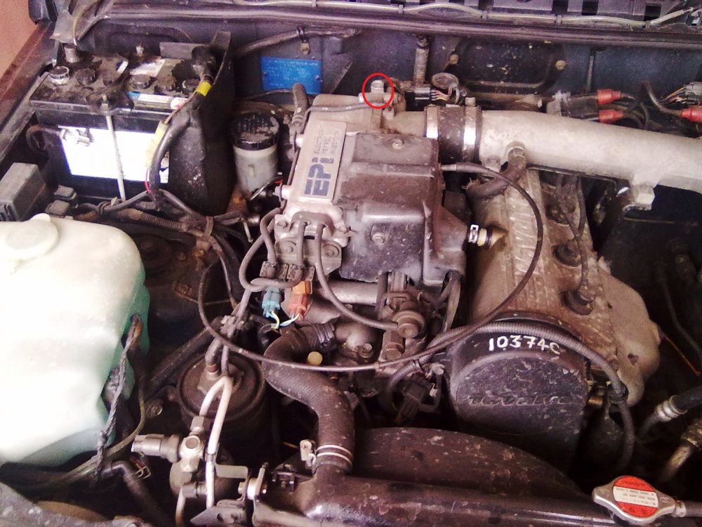

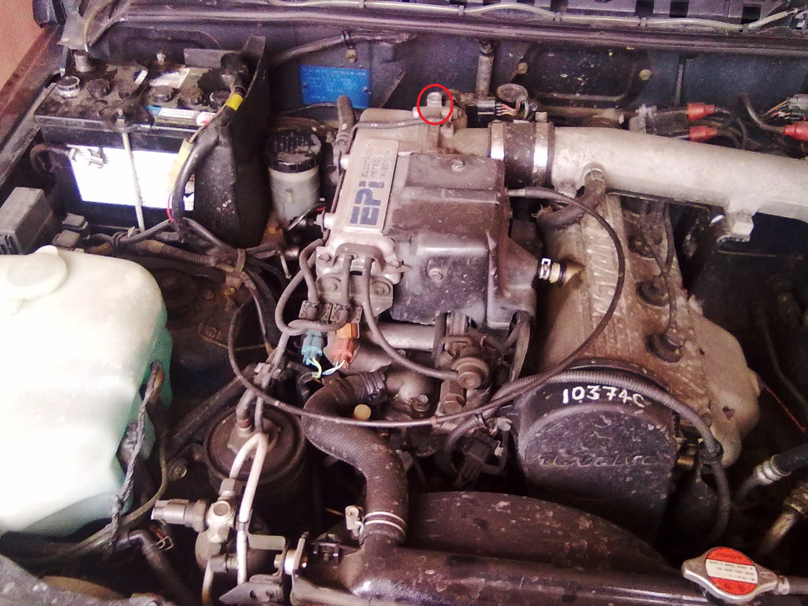

Laurentiu L Posted February 17, 2014 Author Share Posted February 17, 2014 Re: noua achizitie - vitara 96 sincer parca nu mai face asa rau, e o inbunatatire pe acolo pe undeva, spune-mi te rog de unde ai reglat aerul, la mine am observat ca bujiile dupa 1000 km sunt fara culoare, din ce stiu eu trebuiau sa fie maronii, posibil sa mearga sarac si de aia sa am impresia de ezitare la turatia aia. you can go faster .. but i can go everywhere Link to comment Share on other sites More sharing options...
vlad.ioan Posted February 19, 2014 Share Posted February 19, 2014 Re: noua achizitie - vitara 96 ma scuzi. acum am vazut ca ai intrebat. ai cu rosu incercuit surubul. in sensul de desfacere ii dai mai mult aer si invers e invers. In prezent: Suzuki Escudo LWB 1.6 16v 101 cp, 1993, RHD In trecut: Vitara SWB 1.6 8v 80 cp, 1993, cabrio, injectie - stock Link to comment Share on other sites More sharing options...

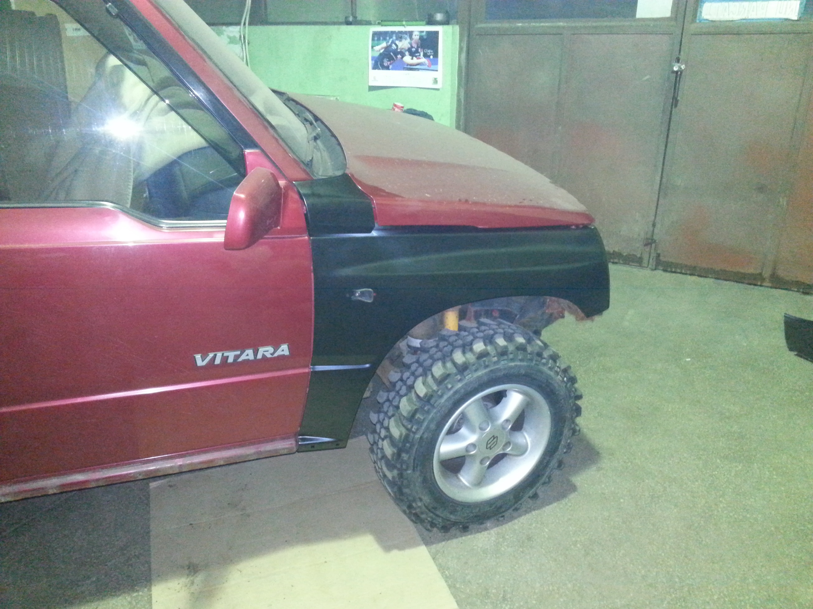

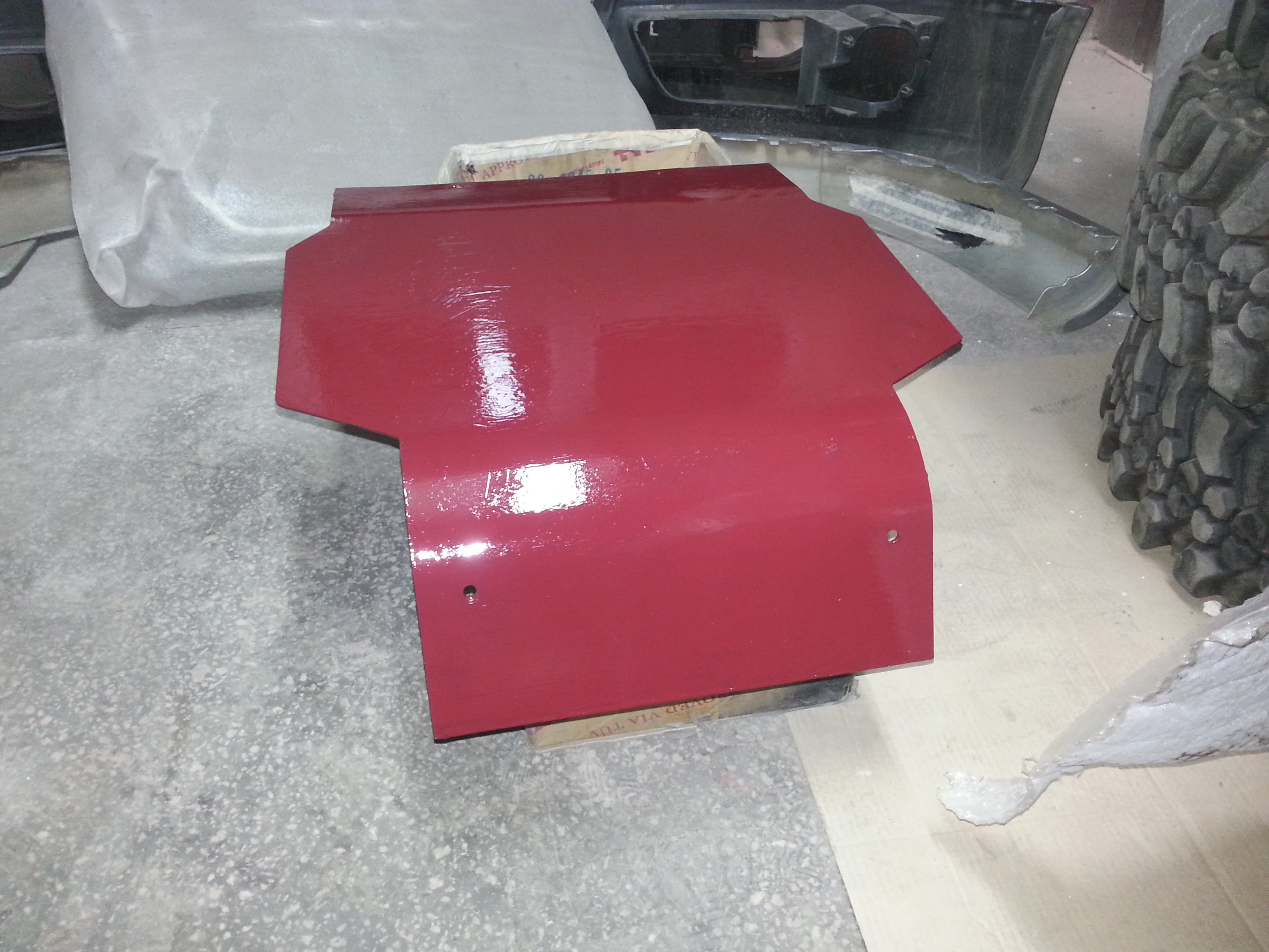

Laurentiu L Posted February 22, 2014 Author Share Posted February 22, 2014 Re: noua achizitie - vitara 96 azi am montat scutul fata [ATTACH=CONFIG]205553[/ATTACH] you can go faster .. but i can go everywhere Link to comment Share on other sites More sharing options...

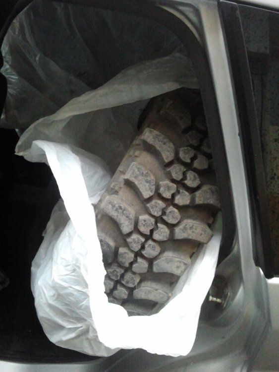

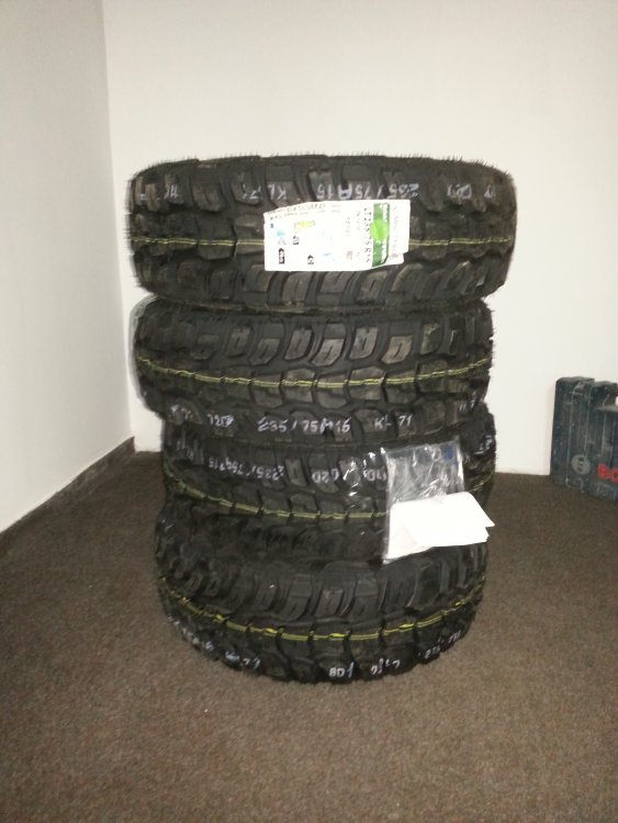

Laurentiu L Posted March 4, 2014 Author Share Posted March 4, 2014 Re: noua achizitie - vitara 96 :al am primit incaltarile, sper sa imi fac timp sa le montez pana in weekend sa facem un road/offroad test you can go faster .. but i can go everywhere Link to comment Share on other sites More sharing options...

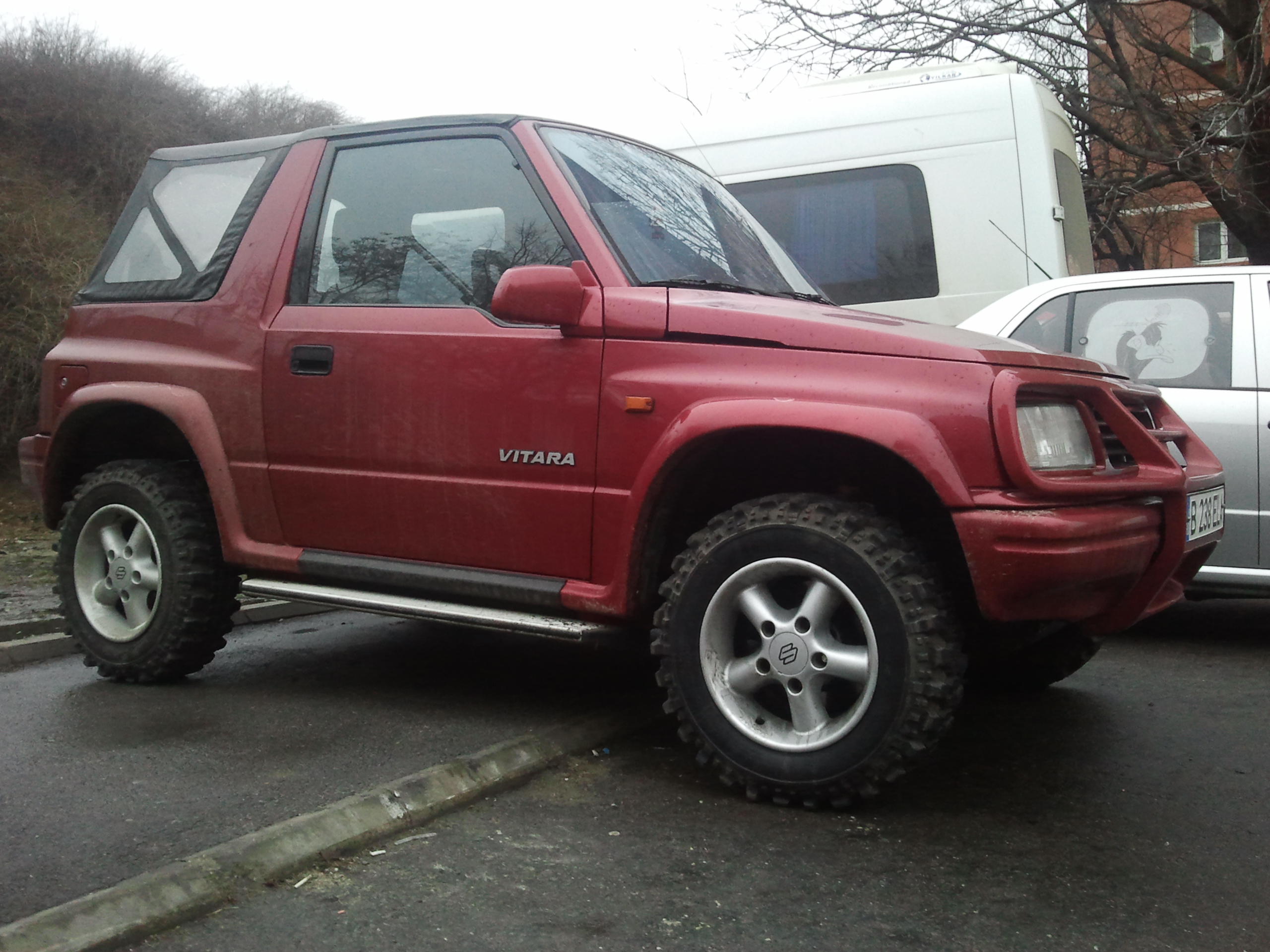

Laurentiu L Posted March 9, 2014 Author Share Posted March 9, 2014 Re: noua achizitie - vitara 96 :care [ATTACH=CONFIG]207333[/ATTACH] you can go faster .. but i can go everywhere Link to comment Share on other sites More sharing options...

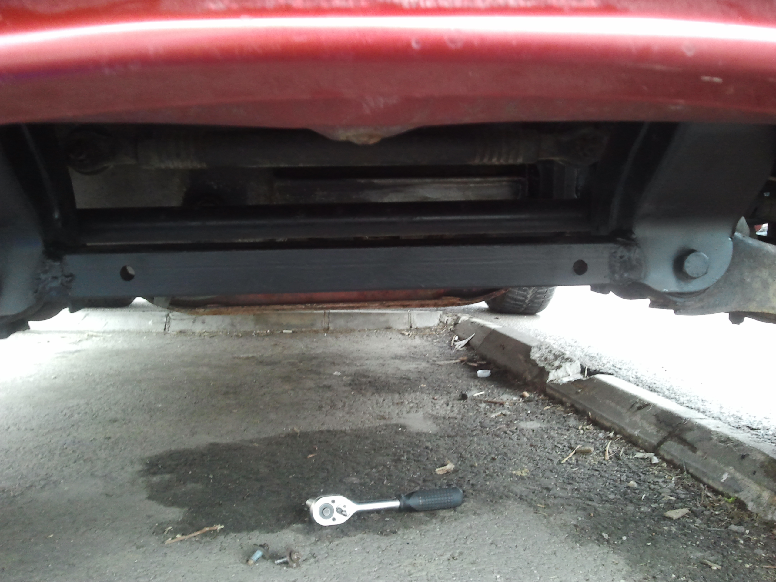

Laurentiu L Posted March 27, 2014 Author Share Posted March 27, 2014 Re: noua achizitie - vitara 96 S-a facut proba la agregat cu ocazia iesirii la Doftana, o mica problema a aparut sau ma rog era deja, semeringul de la cutia de transfer varza, l-am inlocuit si completat uleiul pierdut, in rest a mers exemplar masina. S-a reglat dinnou avansul de data asta cu strobo. niste poze: you can go faster .. but i can go everywhere Link to comment Share on other sites More sharing options...

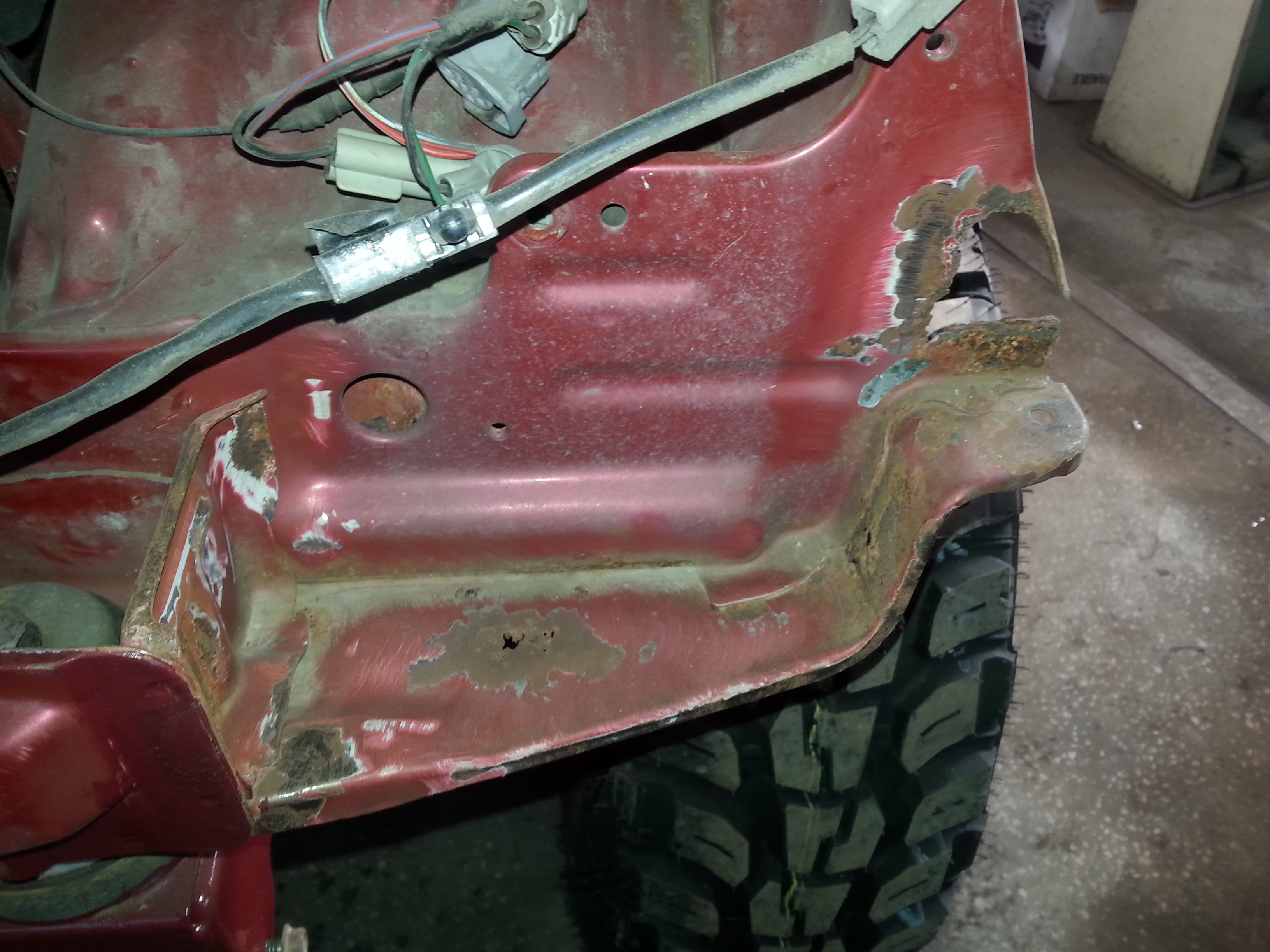

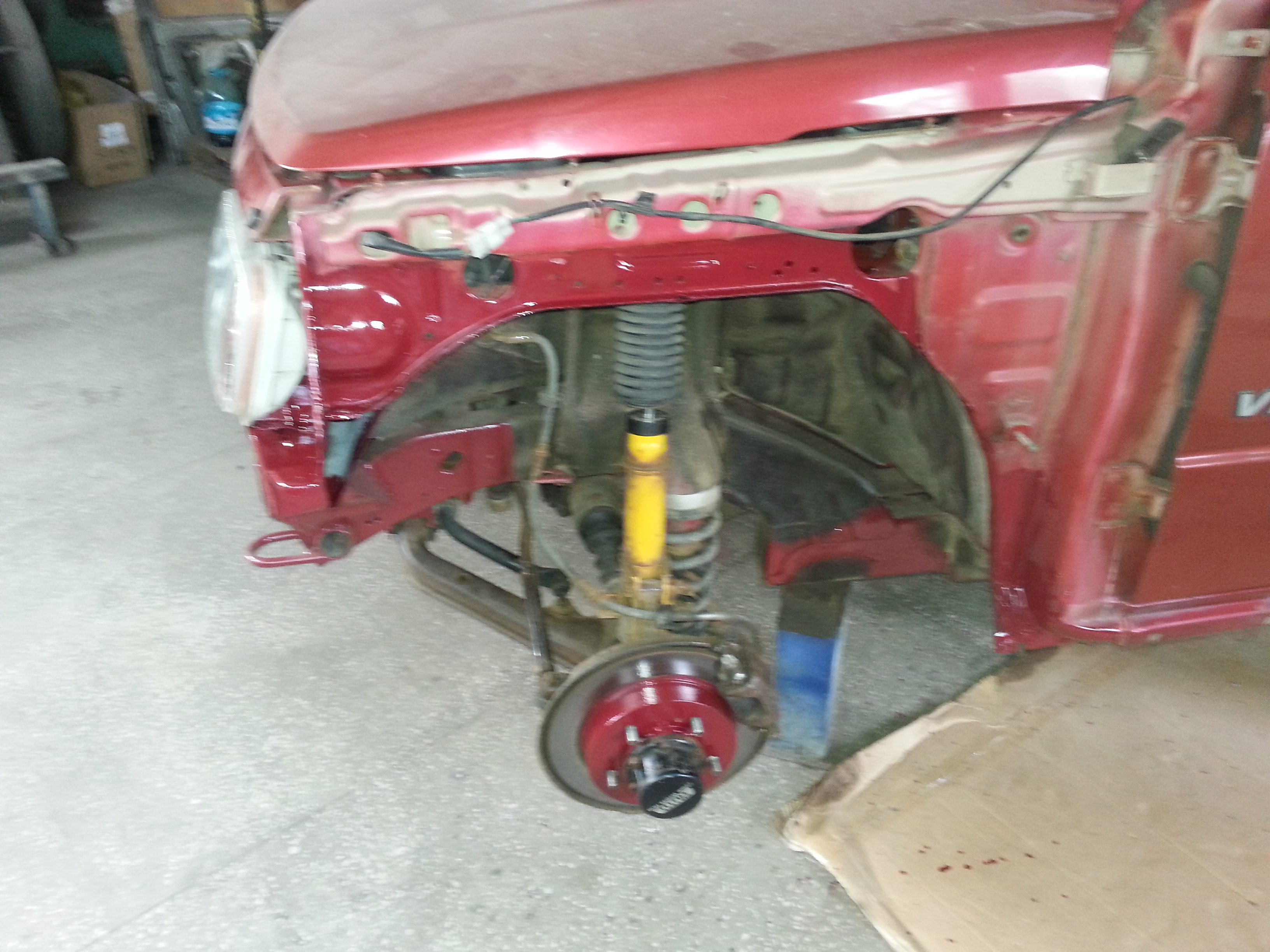

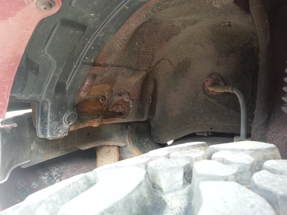

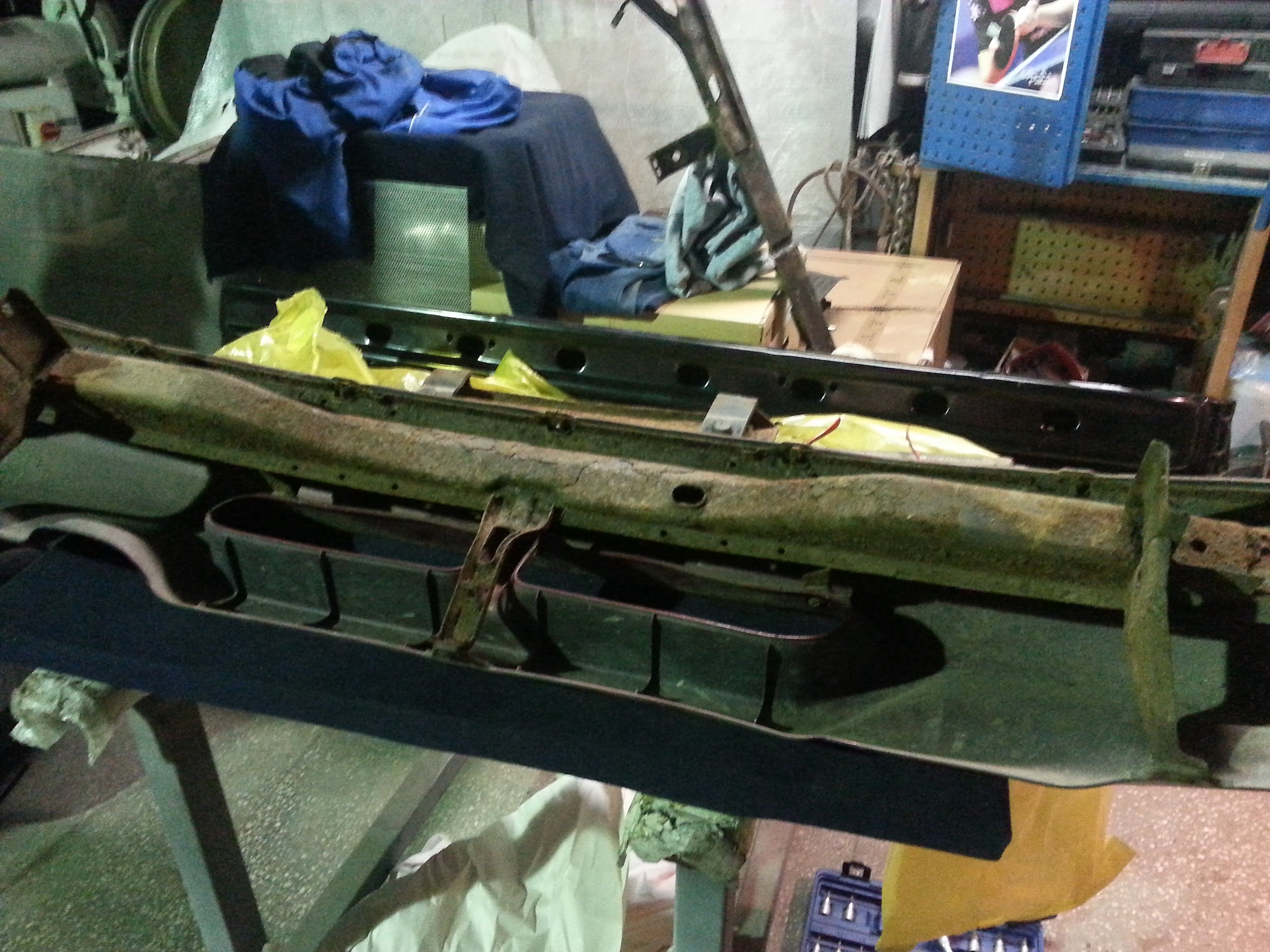

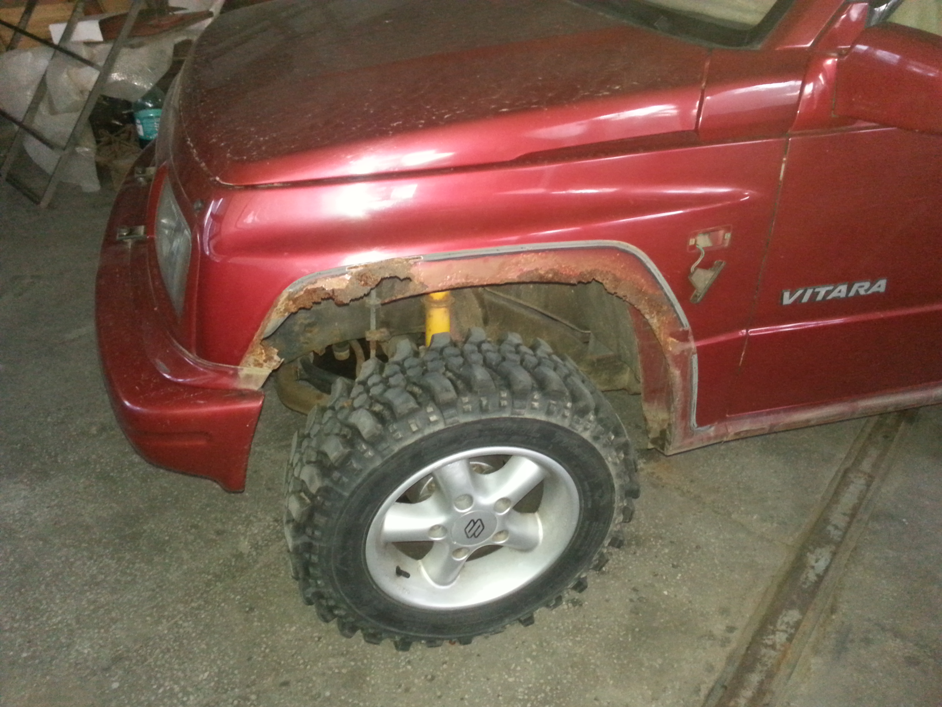

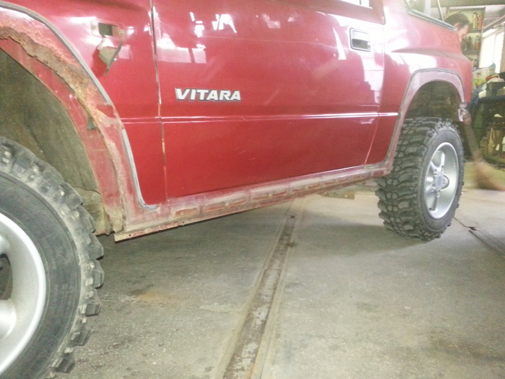

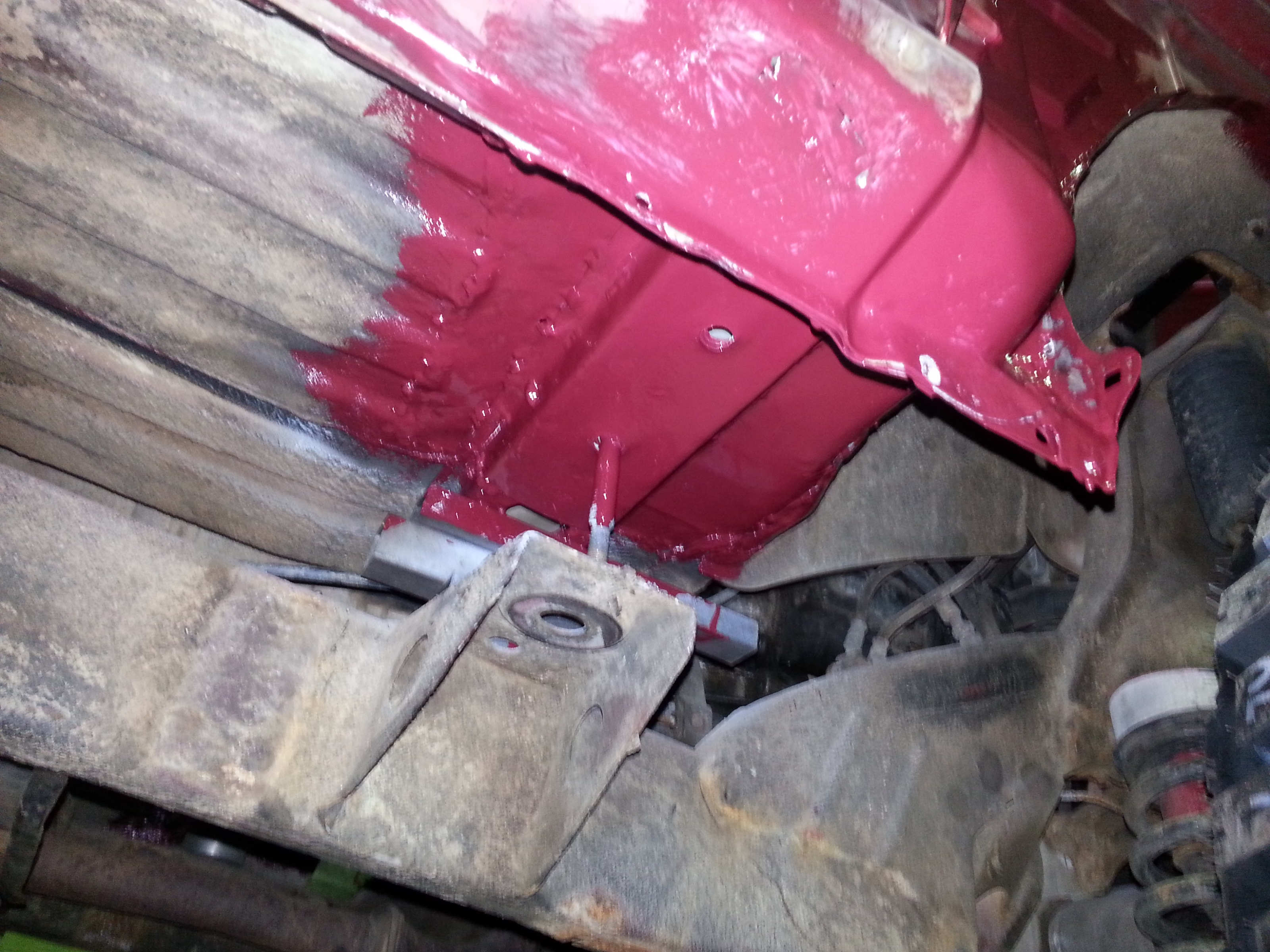

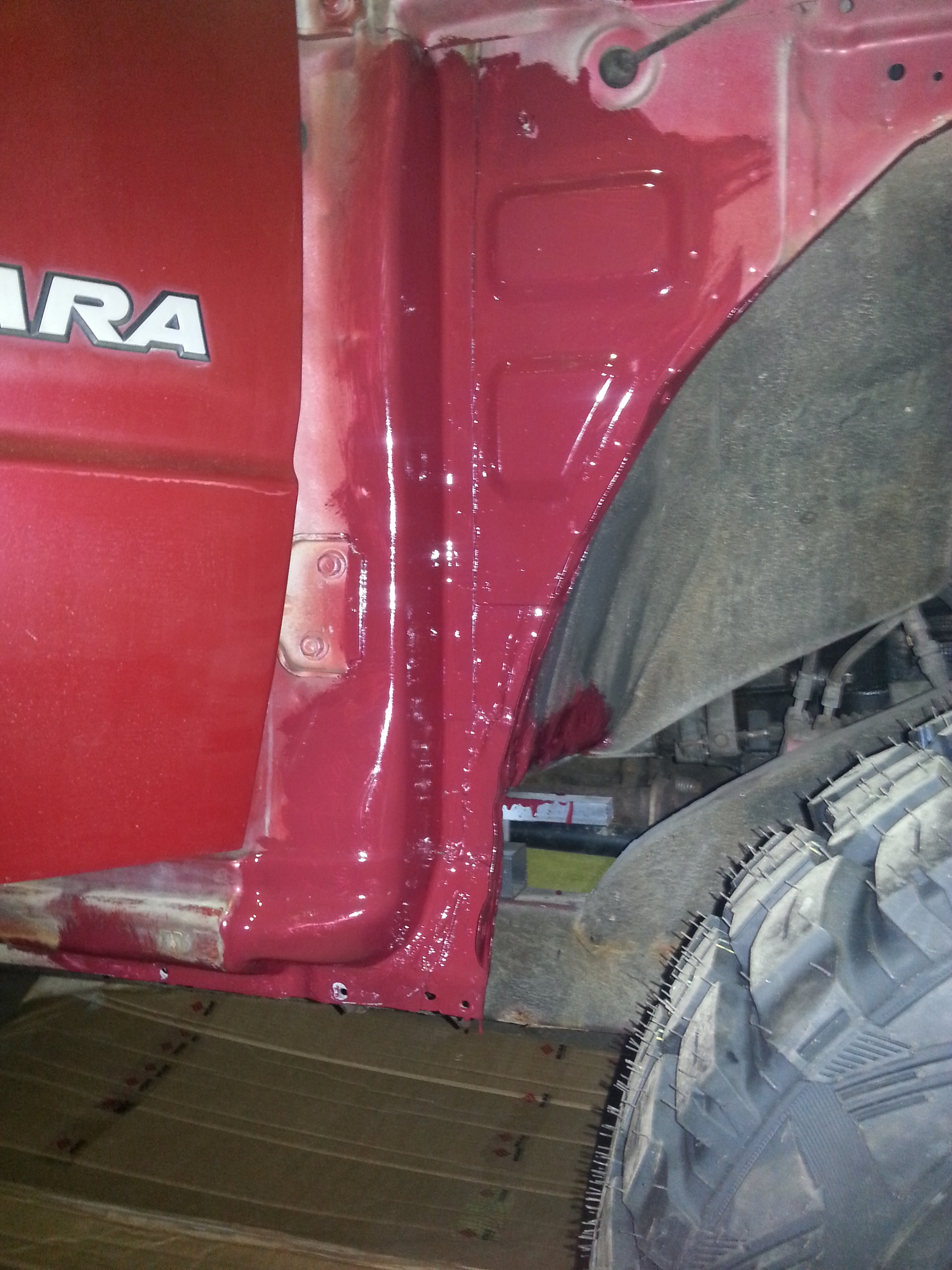

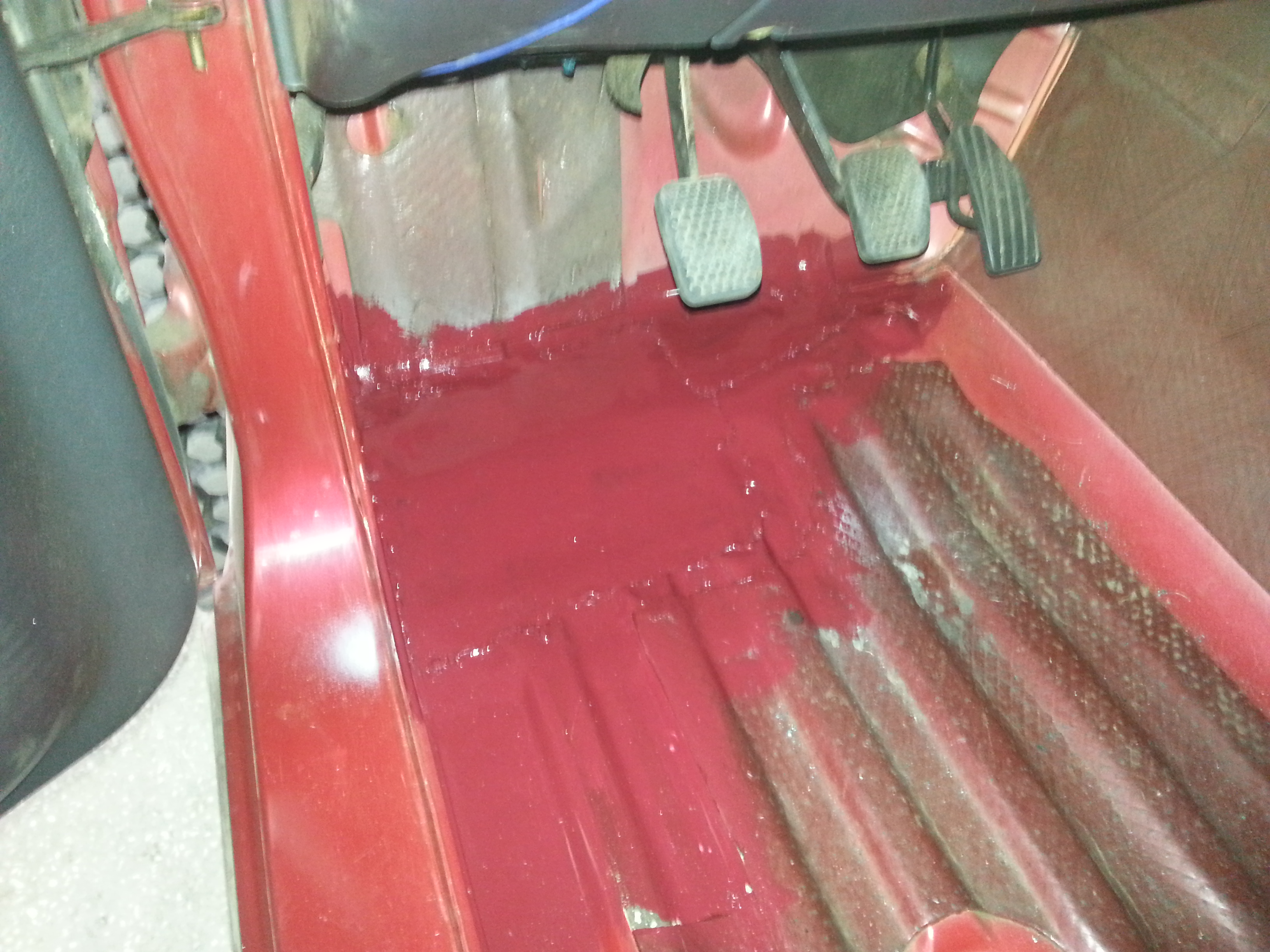

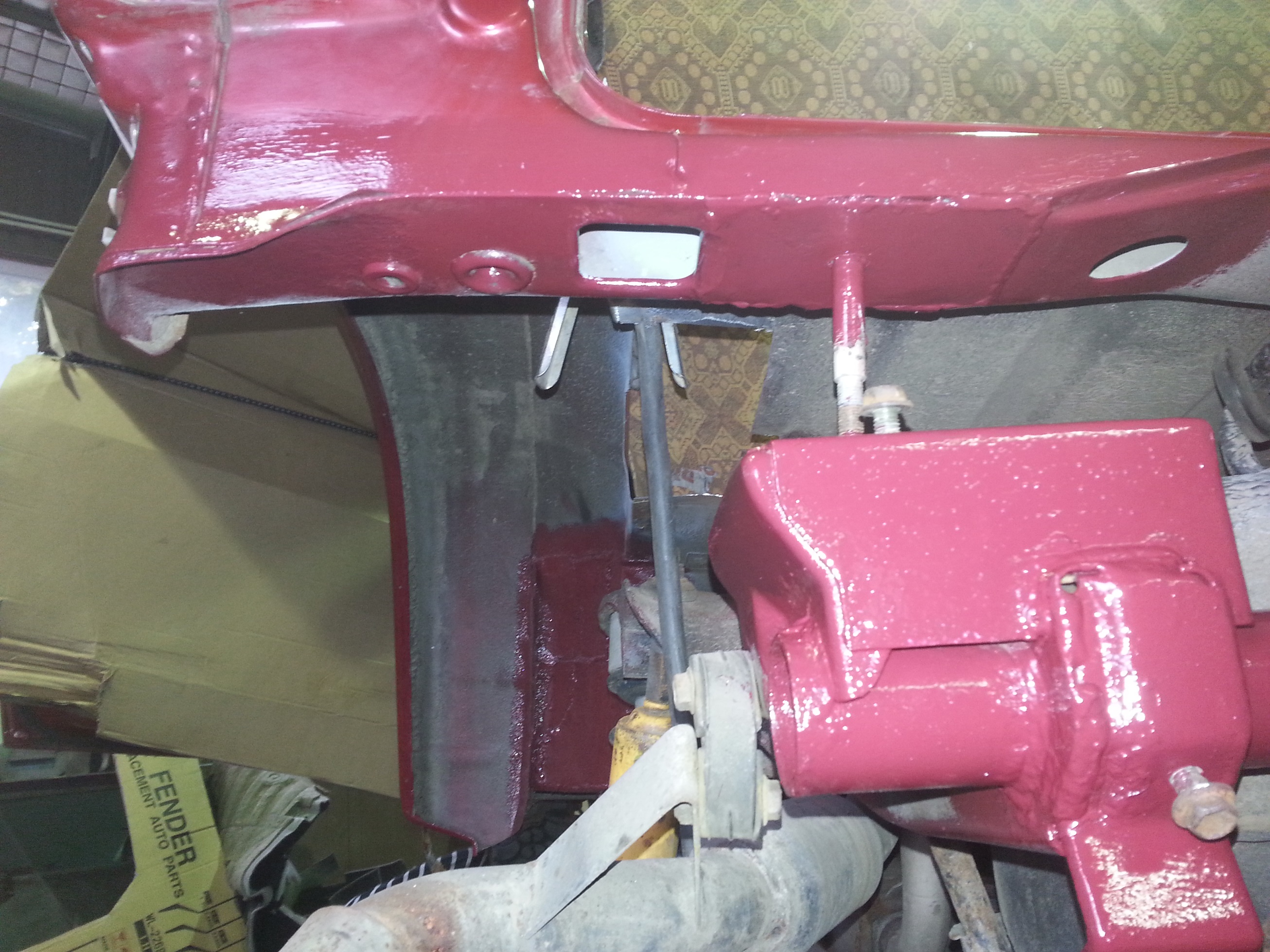

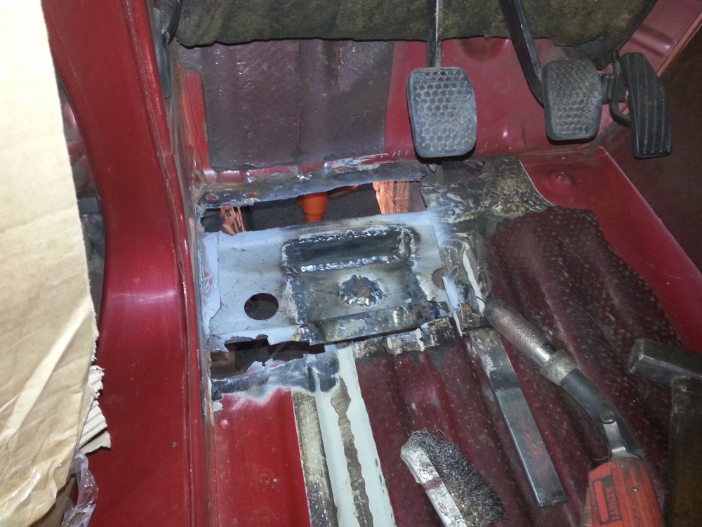

Laurentiu L Posted May 27, 2014 Author Share Posted May 27, 2014 Re: noua achizitie - vitara 96 Tinichigerie day 1: timpul scurt am demontat doar partea stanga si spatele constatari -aripa stanga fata muci -prag stanga si aripa spate fara pic de rugina -niste gauri de astupat la semiaripi you can go faster .. but i can go everywhere Link to comment Share on other sites More sharing options...

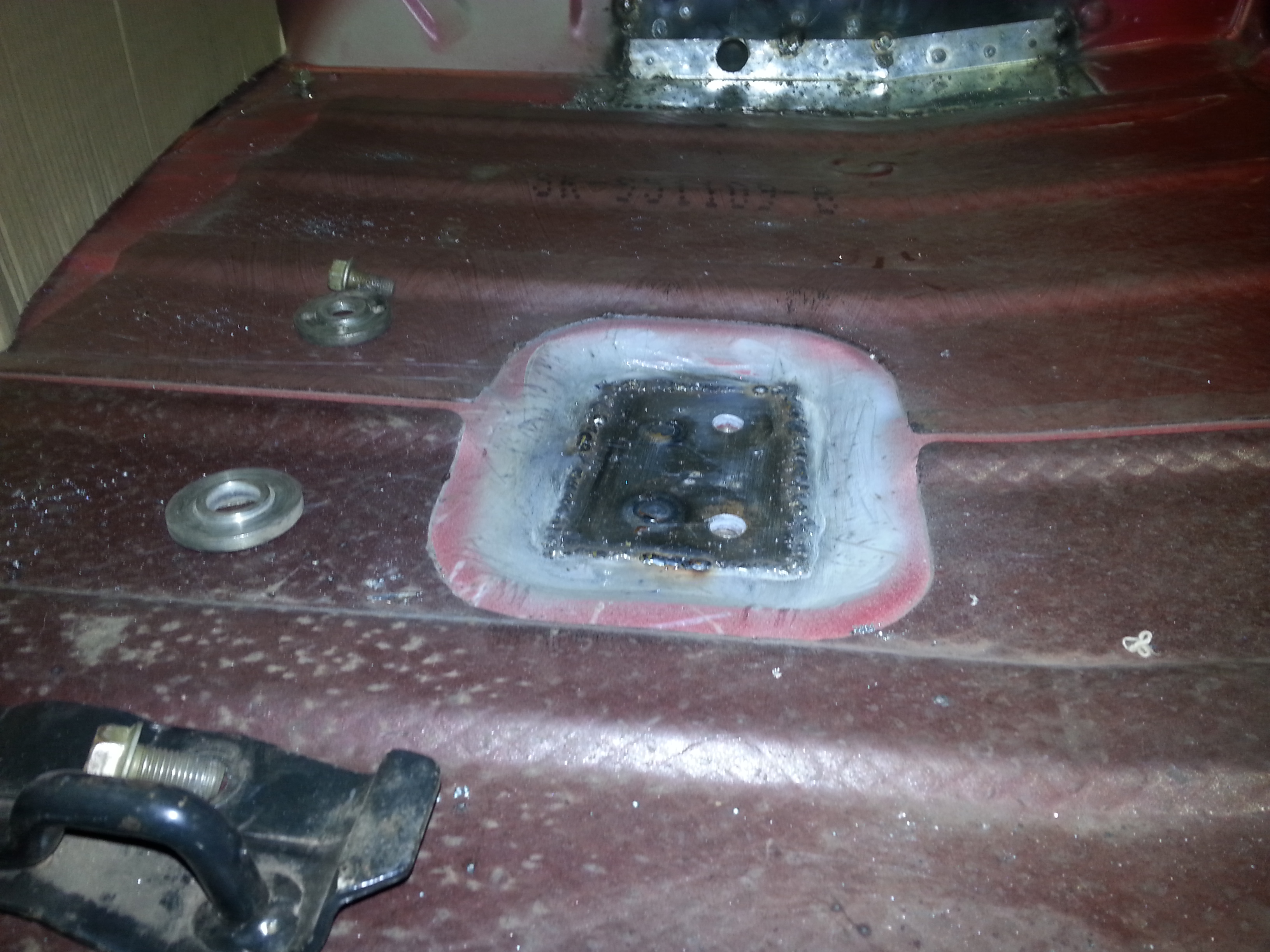

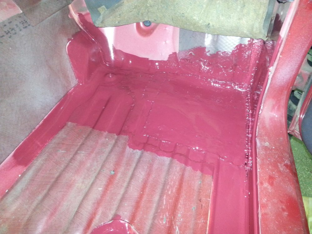

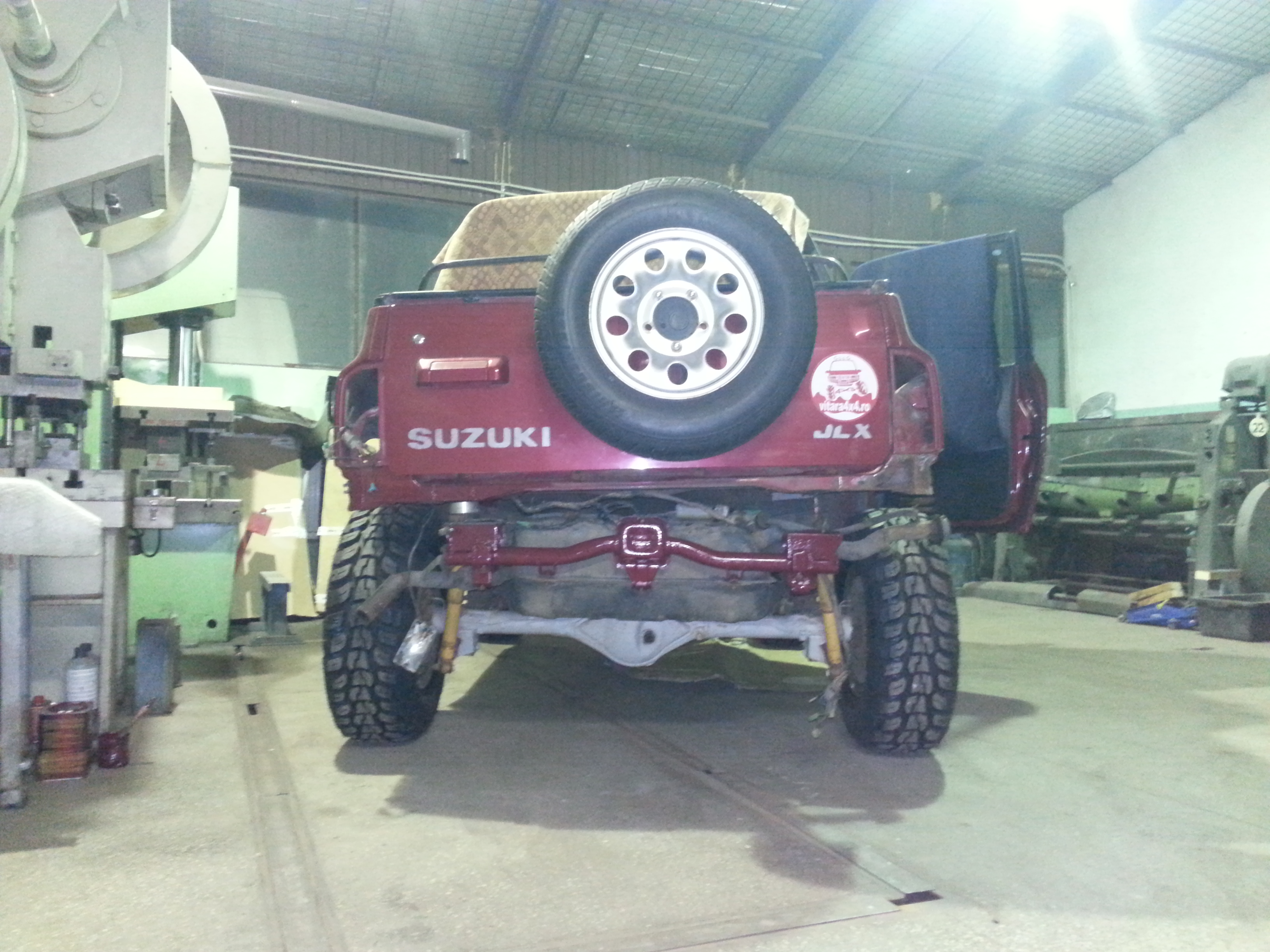

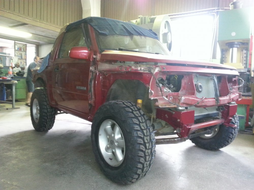

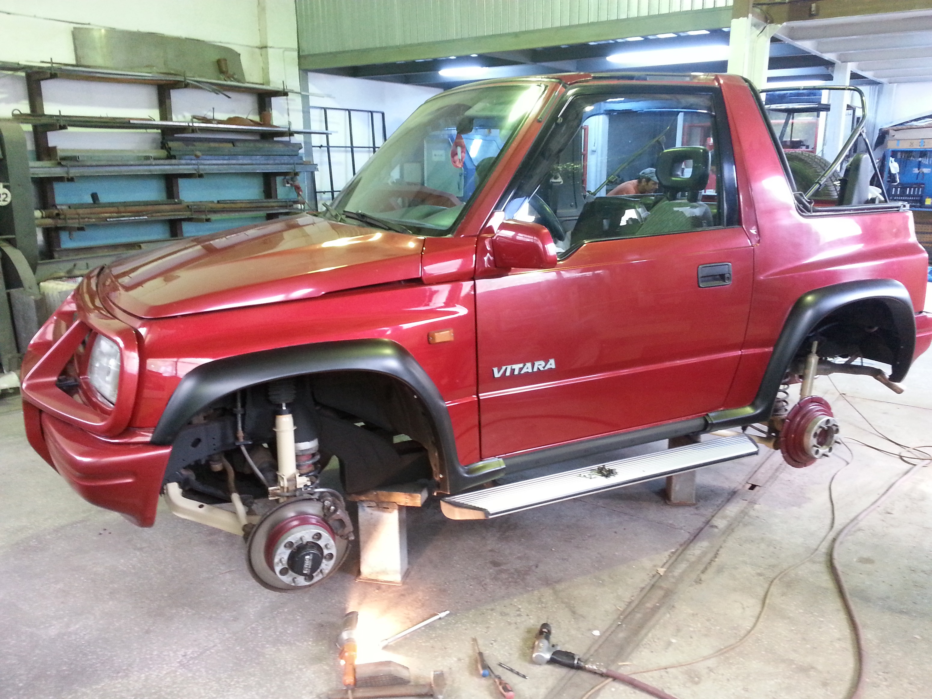

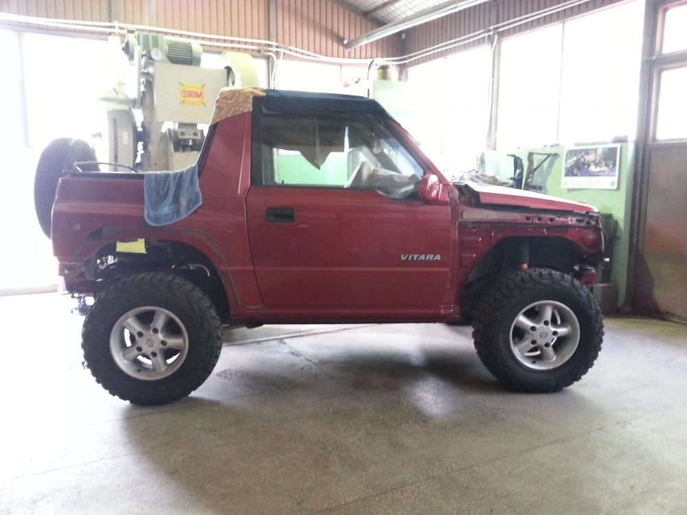

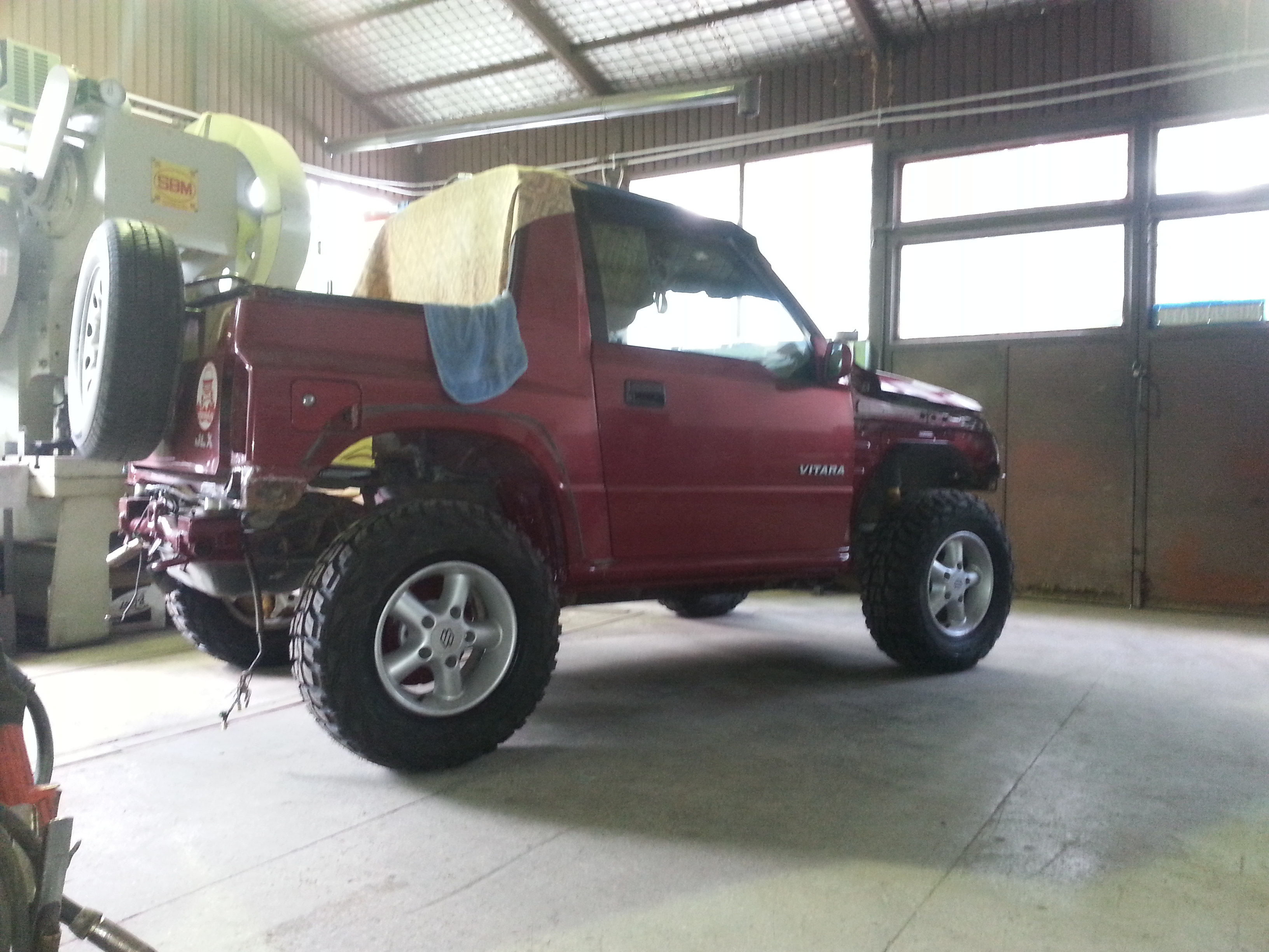

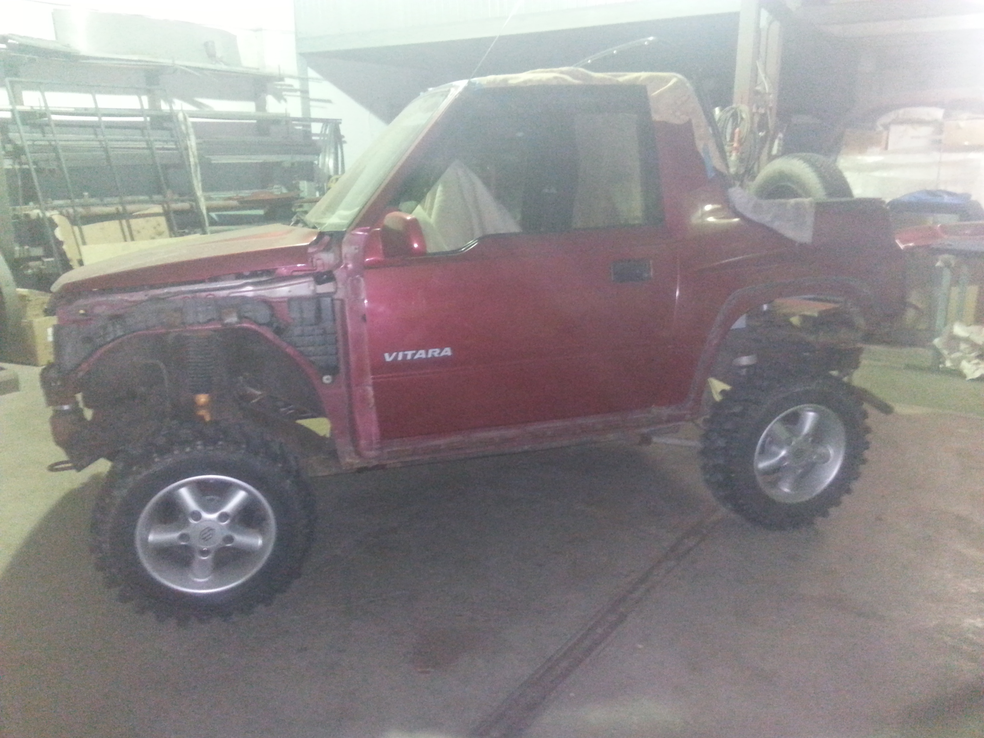

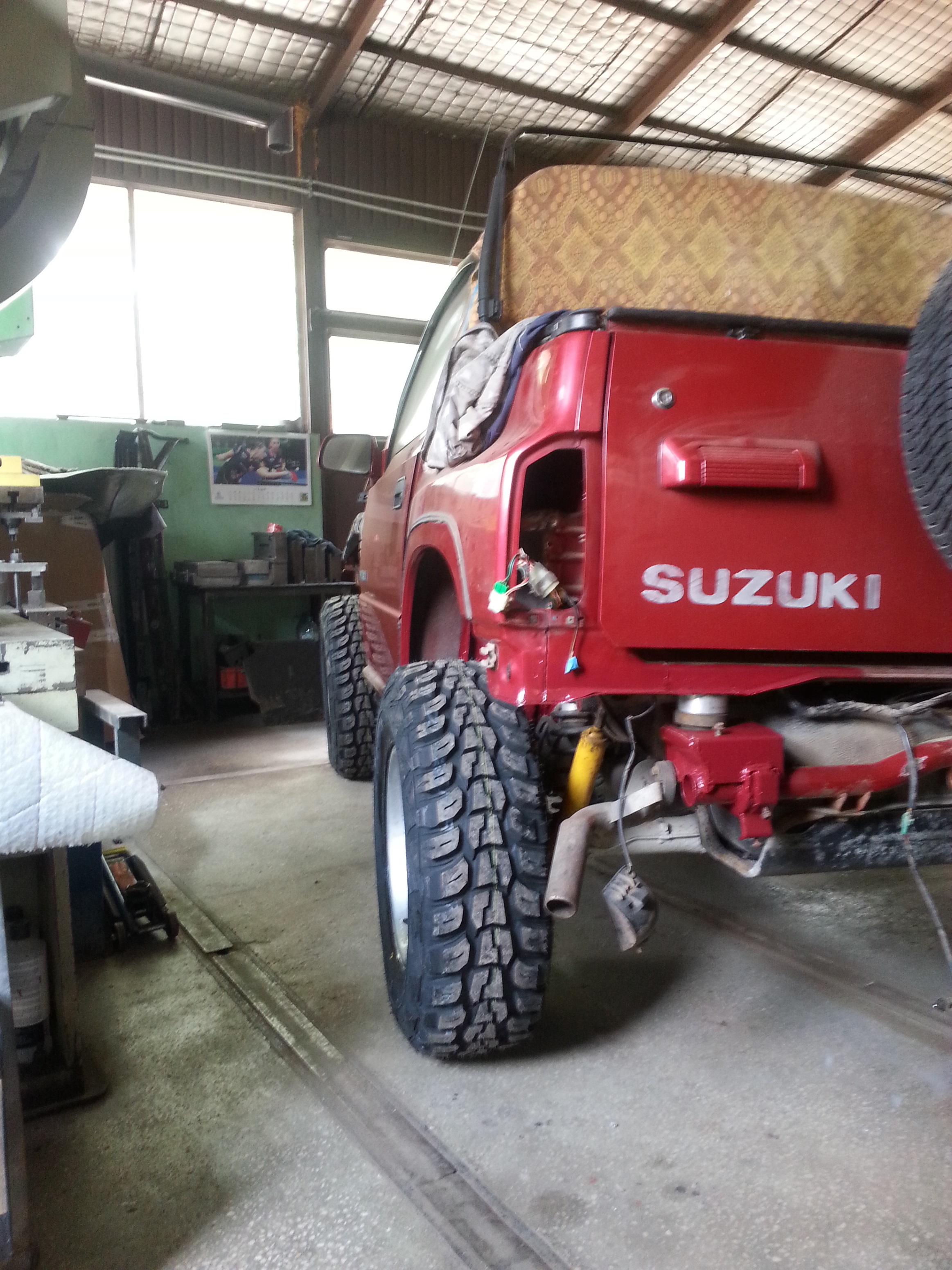

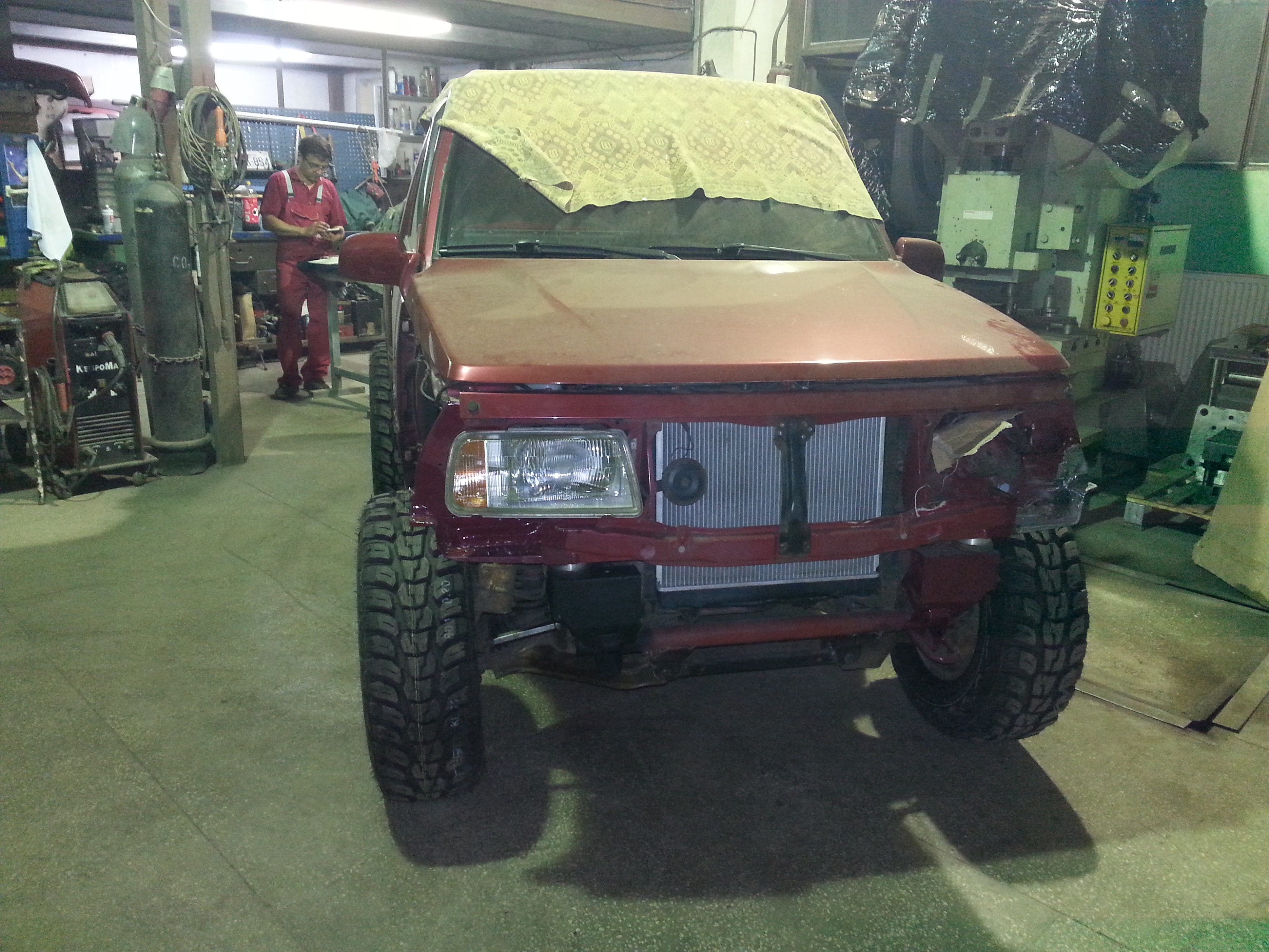

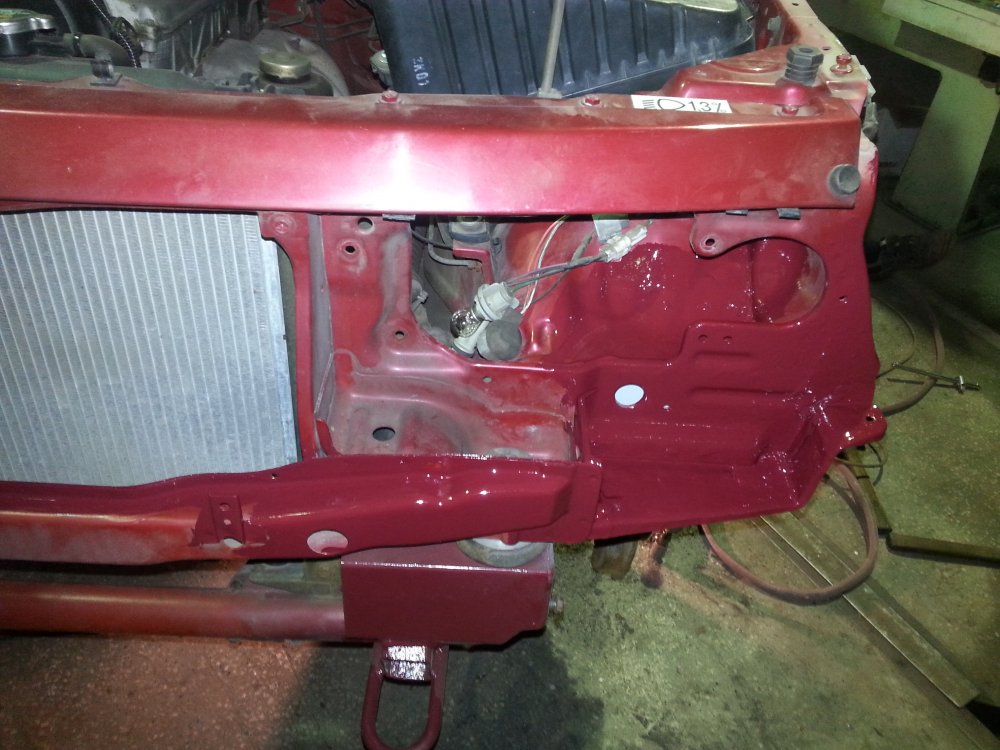

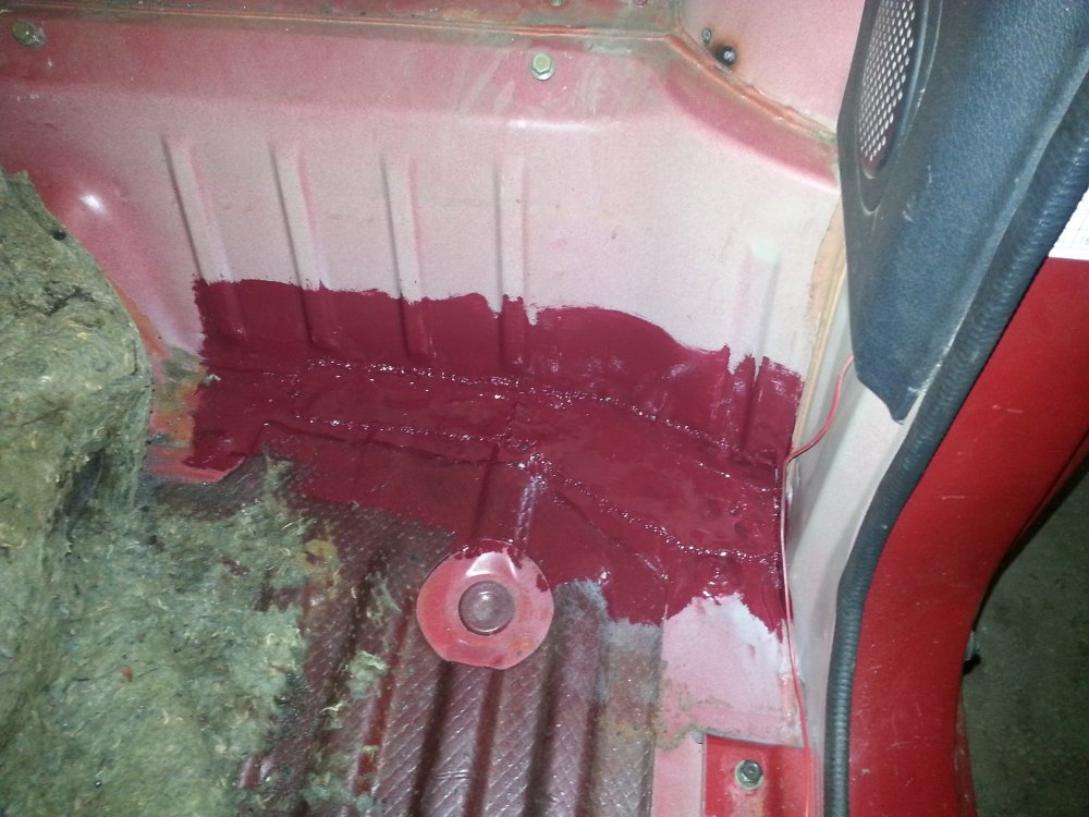

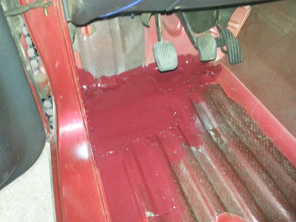

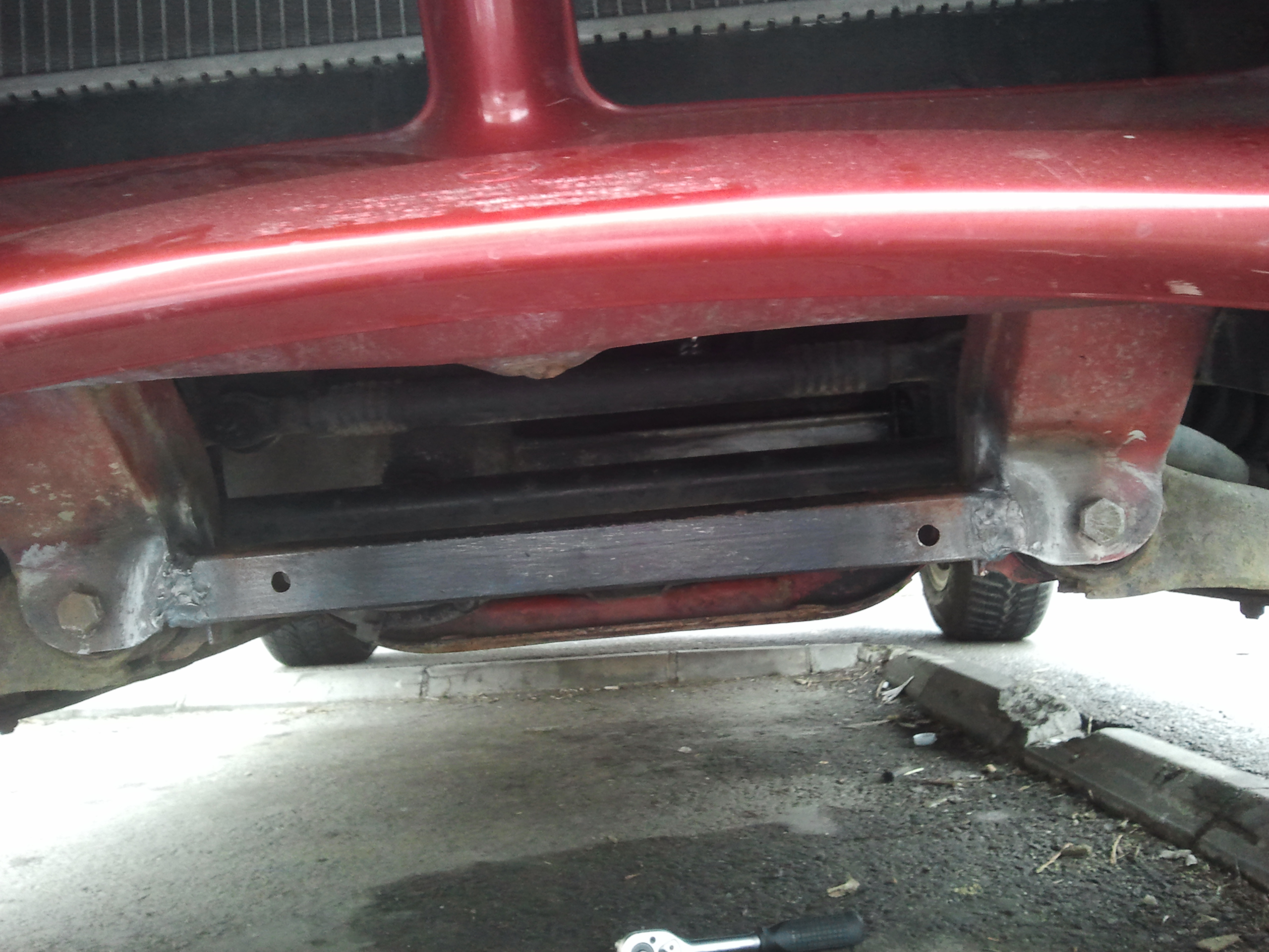

Laurentiu L Posted June 2, 2014 Author Share Posted June 2, 2014 (edited) Re: noua achizitie - vitara 96 poze de la locul faptei .... flex, sudura si protecta 3in1 si noul set de incaltari :D Edited June 2, 2014 by Laurentiu L you can go faster .. but i can go everywhere Link to comment Share on other sites More sharing options...
Laurentiu L Posted June 3, 2014 Author Share Posted June 3, 2014 Re: noua achizitie - vitara 96 mai... you can go faster .. but i can go everywhere Link to comment Share on other sites More sharing options...
Laurentiu L Posted June 5, 2014 Author Share Posted June 5, 2014 (edited) Re: noua achizitie - vitara 96 inca in lucru :wi Edited June 5, 2014 by Laurentiu L you can go faster .. but i can go everywhere Link to comment Share on other sites More sharing options...
Laurentiu L Posted June 7, 2014 Author Share Posted June 7, 2014 Re: noua achizitie - vitara 96 Si dai si lupta, si lupta si dai... Pfff 1 you can go faster .. but i can go everywhere Link to comment Share on other sites More sharing options...
Laurentiu L Posted June 12, 2014 Author Share Posted June 12, 2014 Re: noua achizitie - vitara 96 mai avem... mult a fost putin a ramas you can go faster .. but i can go everywhere Link to comment Share on other sites More sharing options...

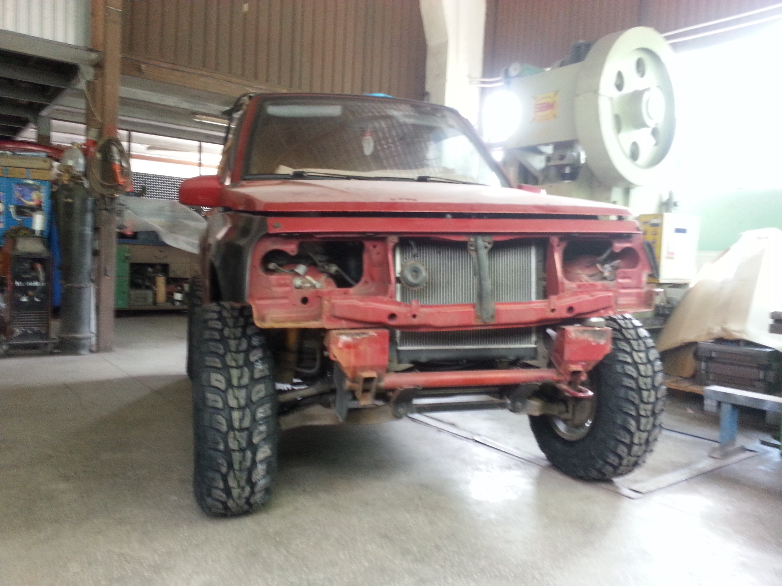

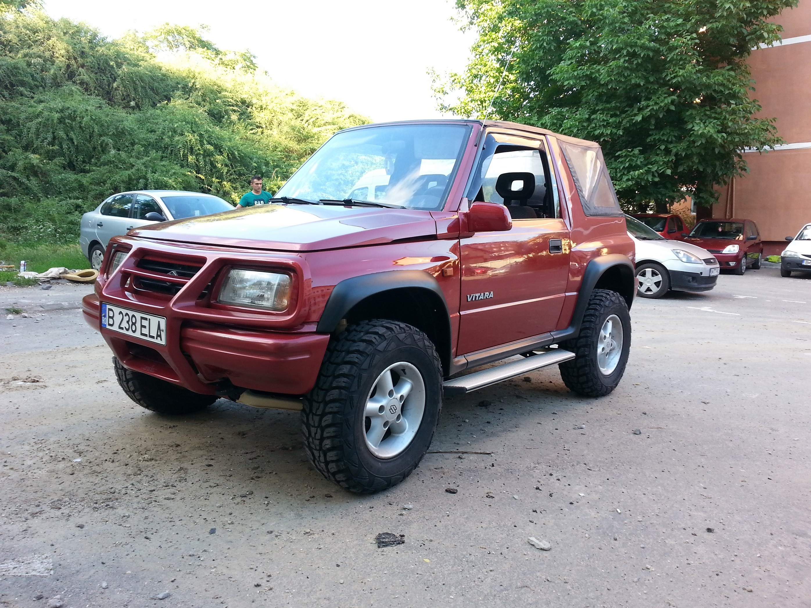

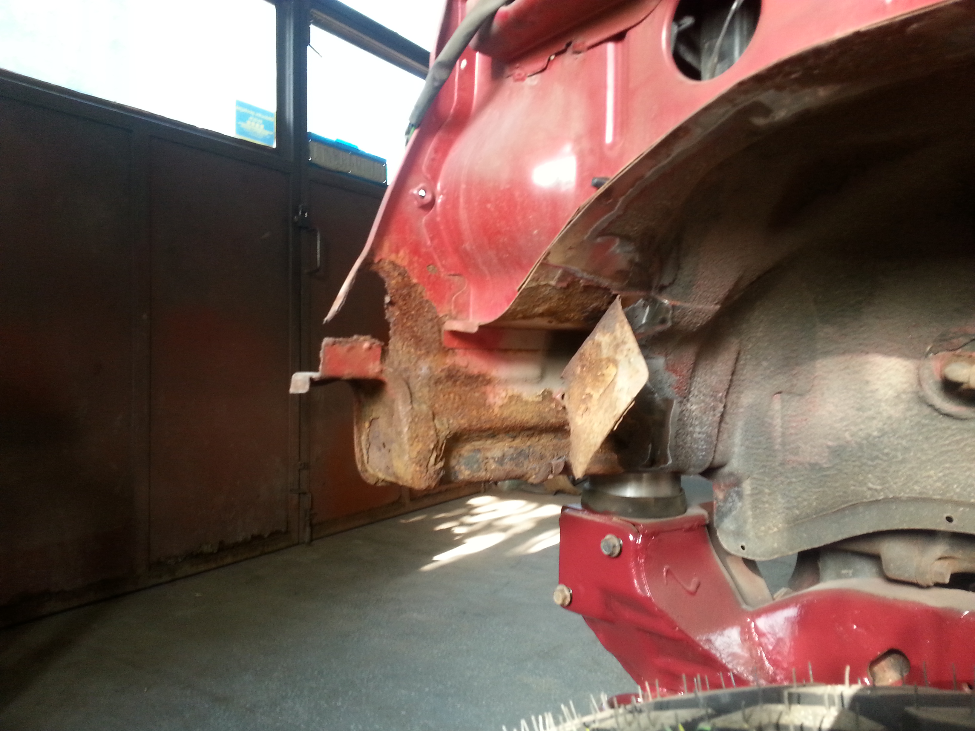

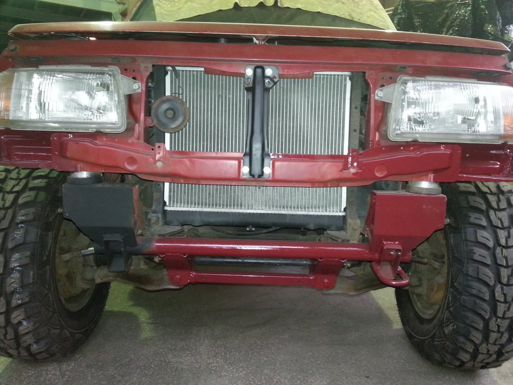

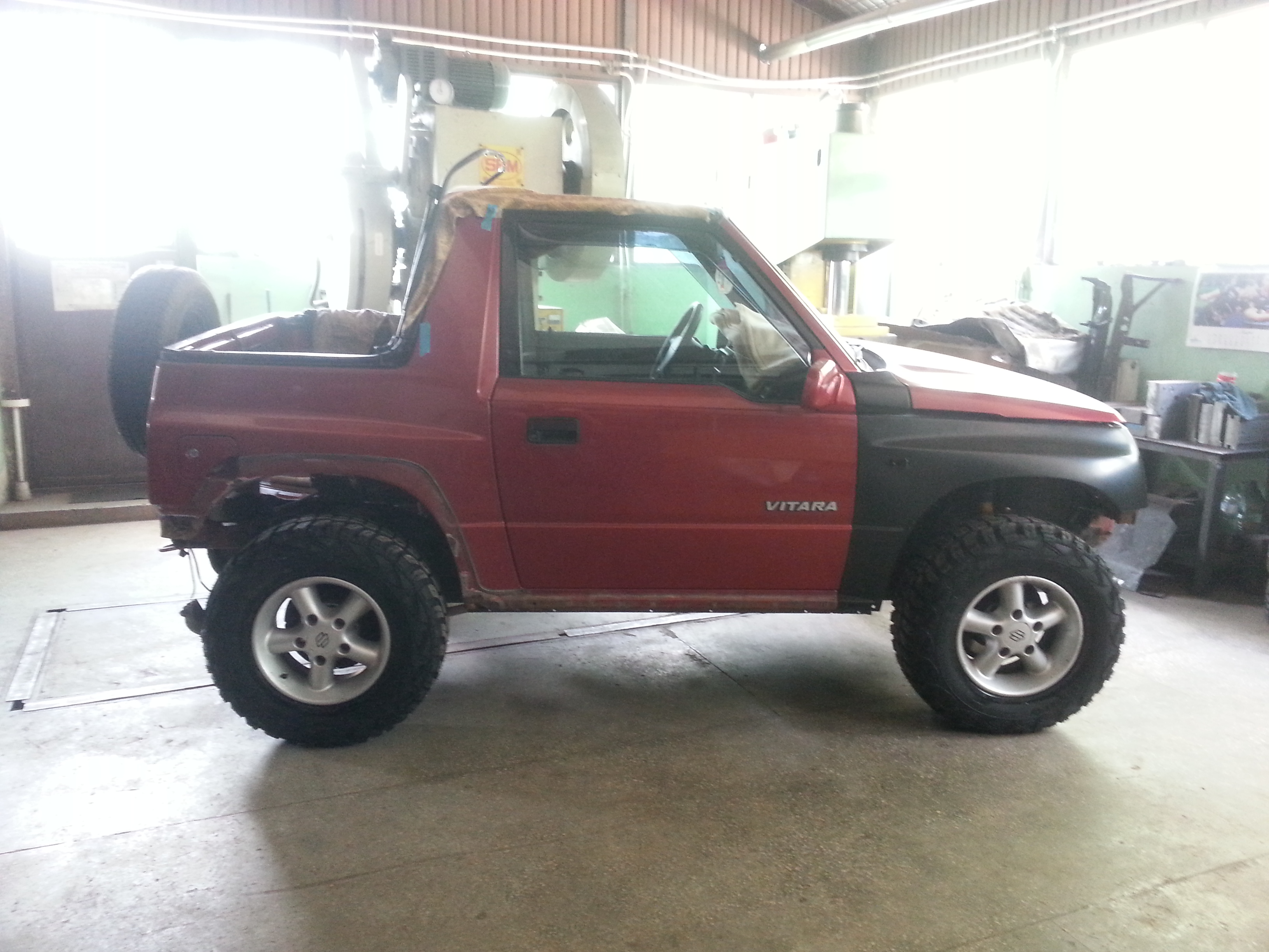

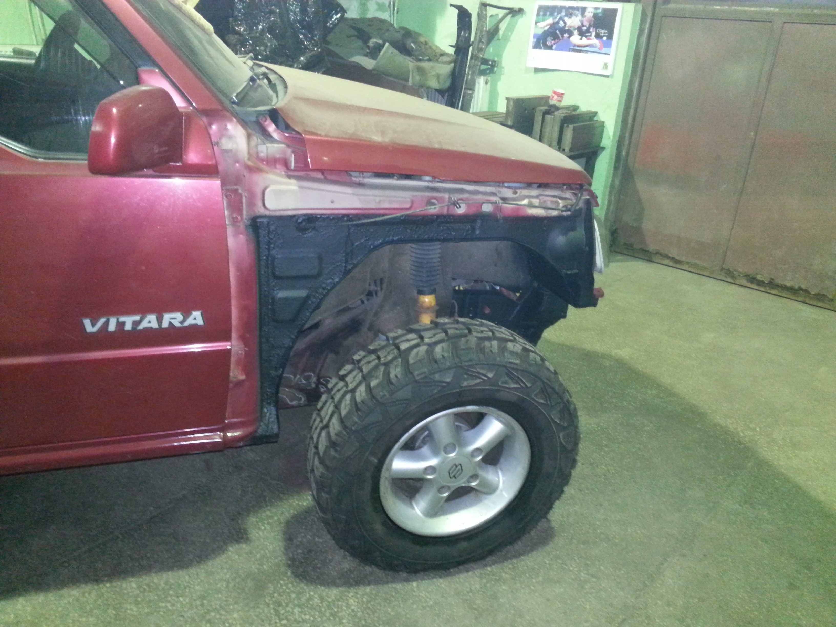

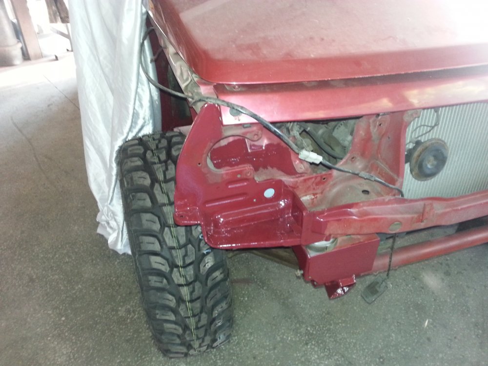

Laurentiu L Posted June 16, 2014 Author Share Posted June 16, 2014 Re: noua achizitie - vitara 96 mai avem doar o contraaripa de refacut si gata... poze... you can go faster .. but i can go everywhere Link to comment Share on other sites More sharing options...

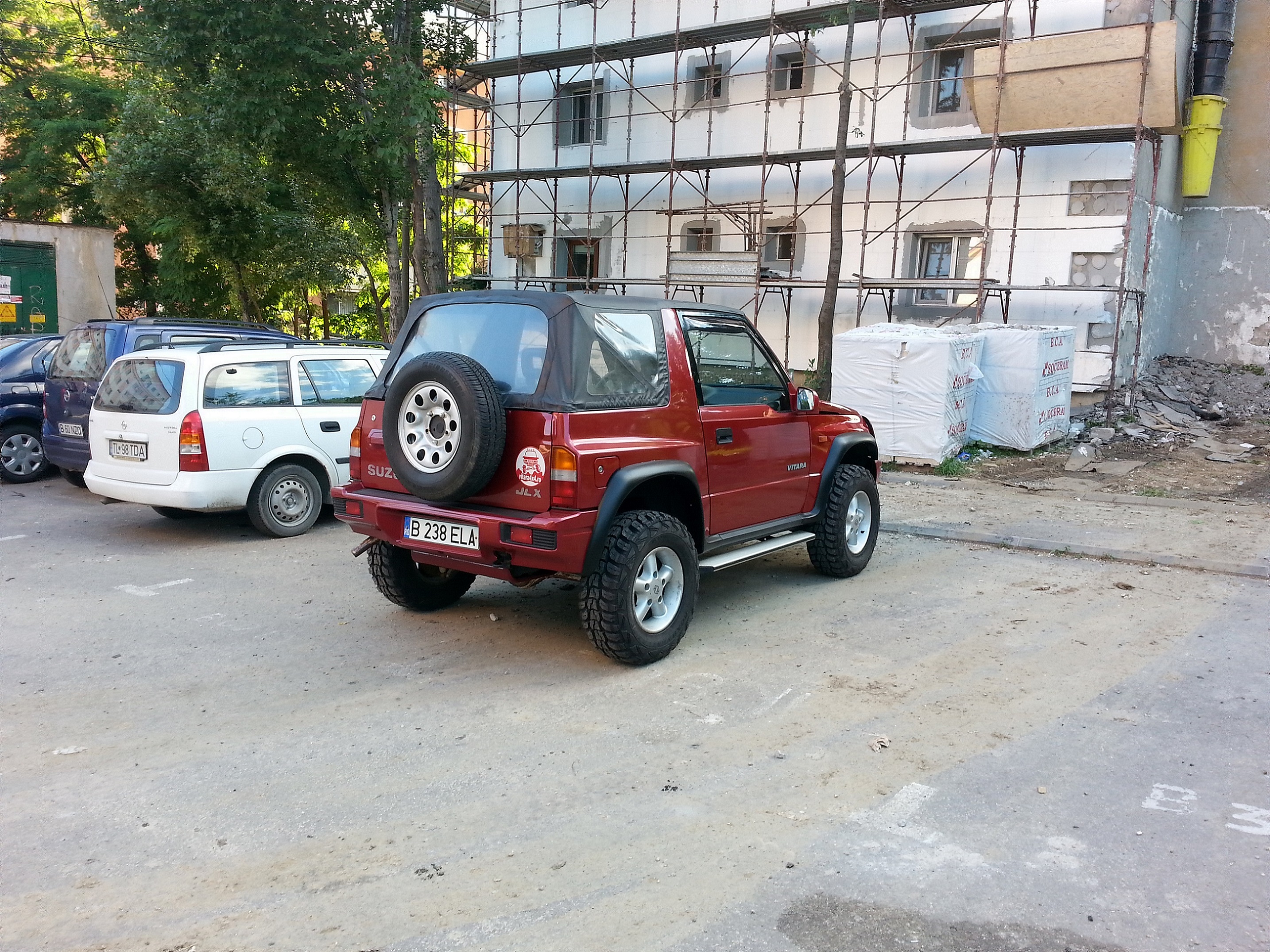

Laurentiu L Posted June 23, 2014 Author Share Posted June 23, 2014 Re: noua achizitie - vitara 96 finally, mai sunt mici piese de cosmetizat, brate and shit.... dar e gata... woohoo you can go faster .. but i can go everywhere Link to comment Share on other sites More sharing options...
