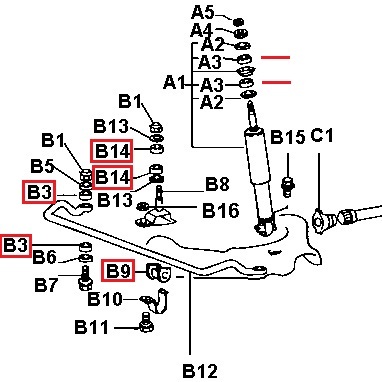

Suspensie fata
Bucse bara stabilizatoare si amortizoare
B3: MB176368 - RUBBER-STABILIZER - 4 buc
B9: MB573783 - BUSHING-STABILIZER - 2 buc
B14: MA410532 - RUBBER-BUSHING - 4 buc
A3: MA410532 - RUBBER-BUSHING - 4 buc

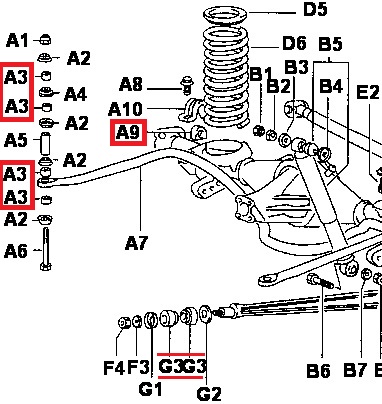

Suspensie spate
Bucse suspensie spate
[ATTACH=CONFIG]193842[/ATTACH]
A3: MW024526 - BUSHING-RUBBER - 8 buc
A9: MB338596 - BUSHING(B) - 2 buc
G3: MB584146 - BUSHING - 4 buc
