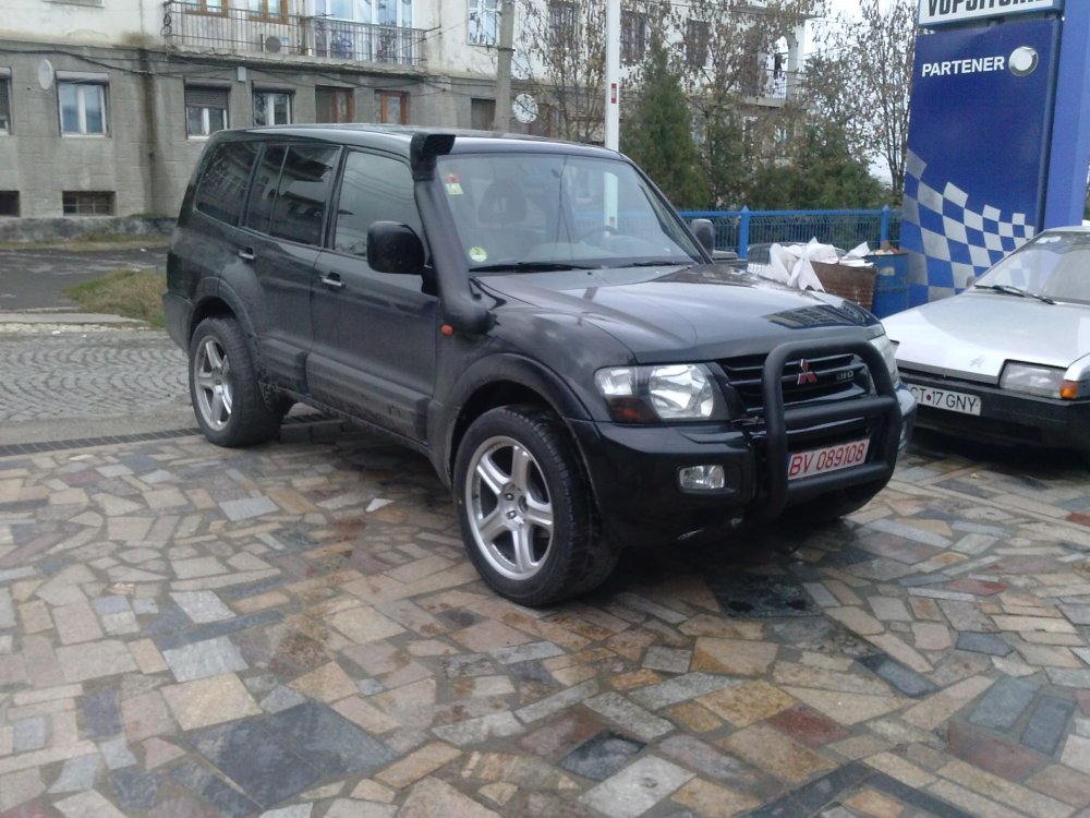

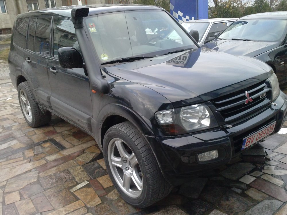

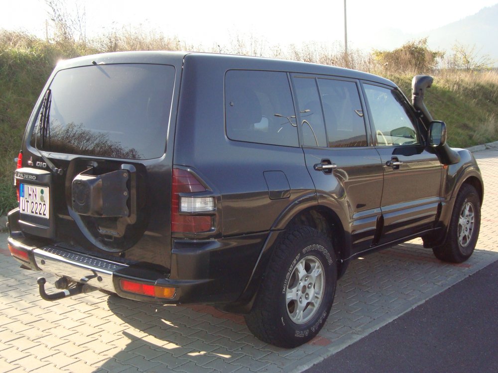

Acum cateva 5 zile am achizitionat un pajero v60 lwb 3,2 did......revenind astfel la prima dragoste, dupa o pribegie urmata de dezamagire pe la firme nemteshti si japoneze concurente.

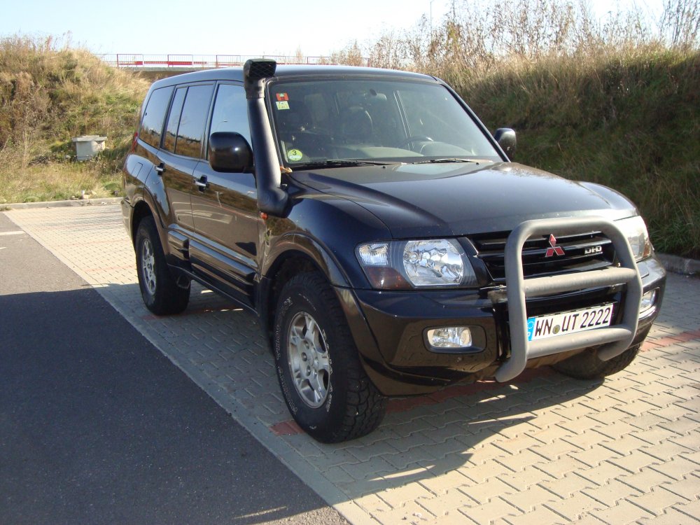

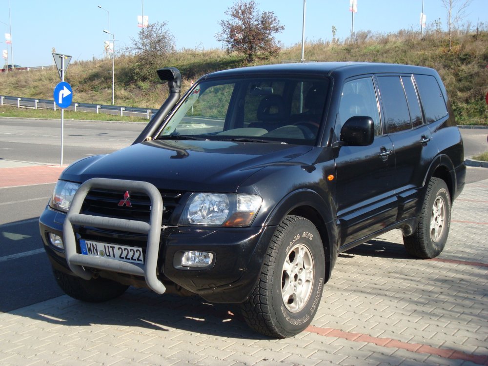

Utilajul l-am luat de la un coleg de pe forum, iar in momentul achizitiei avea primii pasi spre un offroad-usor facuti deja.
Avea deja montat un Safari Snorkel, anvelope AT MICKEY TOMPSON BAJA ATZ 265/75R16 si distantiere de 5cm la roti.
Iata si primele poze:
1805153654_DSC08495(1).thumb.JPG.2009515d5900e2d451f4af7895f1ee0f.JPGDSC08497.thumb.JPG.18603d2e0fc0d3e7671f6f172e376d89.JPGDSC08502.thumb.JPG.24a59a1d694436ad71869e15a18687d0.JPGDSC05309.thumb.jpg.ee15eccf044bef3feda558bc83e1dde2.jpg

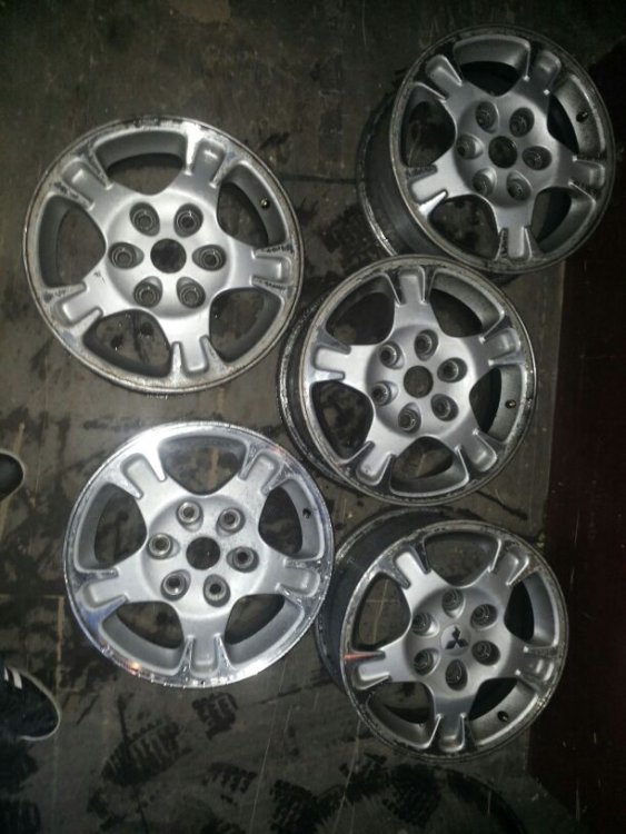

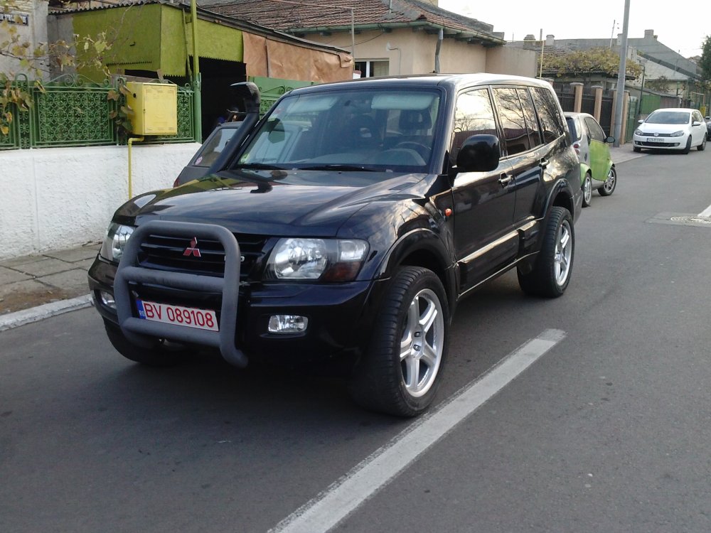

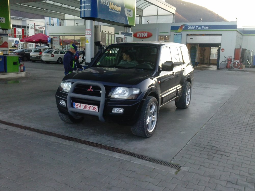

In aceeasi zi si chiar din acelasi orash....adik BRASOV, am gasit la un prieten ff bun un set de roti pe 20" pentru pajero si binenteles ca nu am rezistat sa nu le iau.....
Asa arata masina la numai 1 ora dupa achizitie
CAM00017.thumb.jpg.eac61a91416f9d8849dbfbbce1351a8c.jpgCAM00028.thumb.jpg.bd9acfc87bba5c4aa70b67730ad913cd.jpg

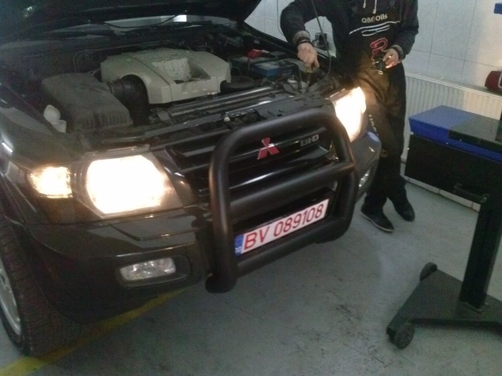

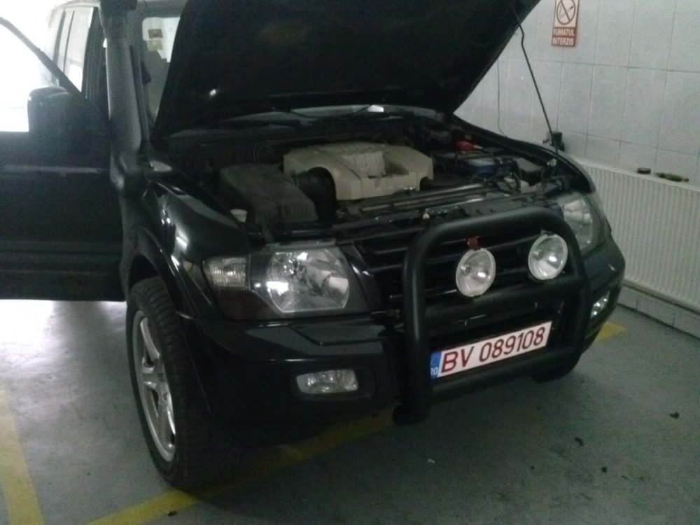

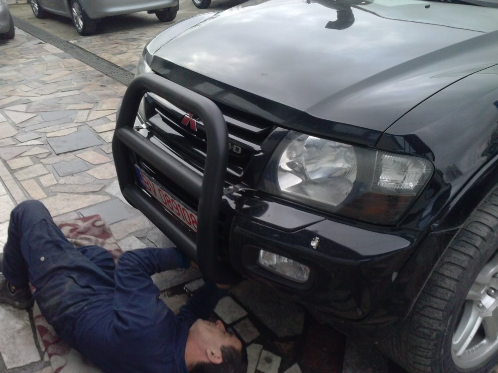

imediat dupa ce am ajuns acasa am vopsit bullbarul in culoarea negru mat
CAM00033.thumb.jpg.715f1904a1ee03220786113704617d89.jpgCAM00034.thumb.jpg.4a5382f9af98942f38c692a91f037d6b.jpgCAM00038.thumb.jpg.7e26493e396cb681f651166fa063f756.jpgCAM00041.thumb.jpg.7a9868739b66bd7e46ef45905b62d028.jpg

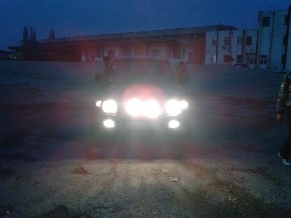

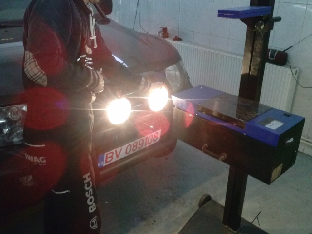

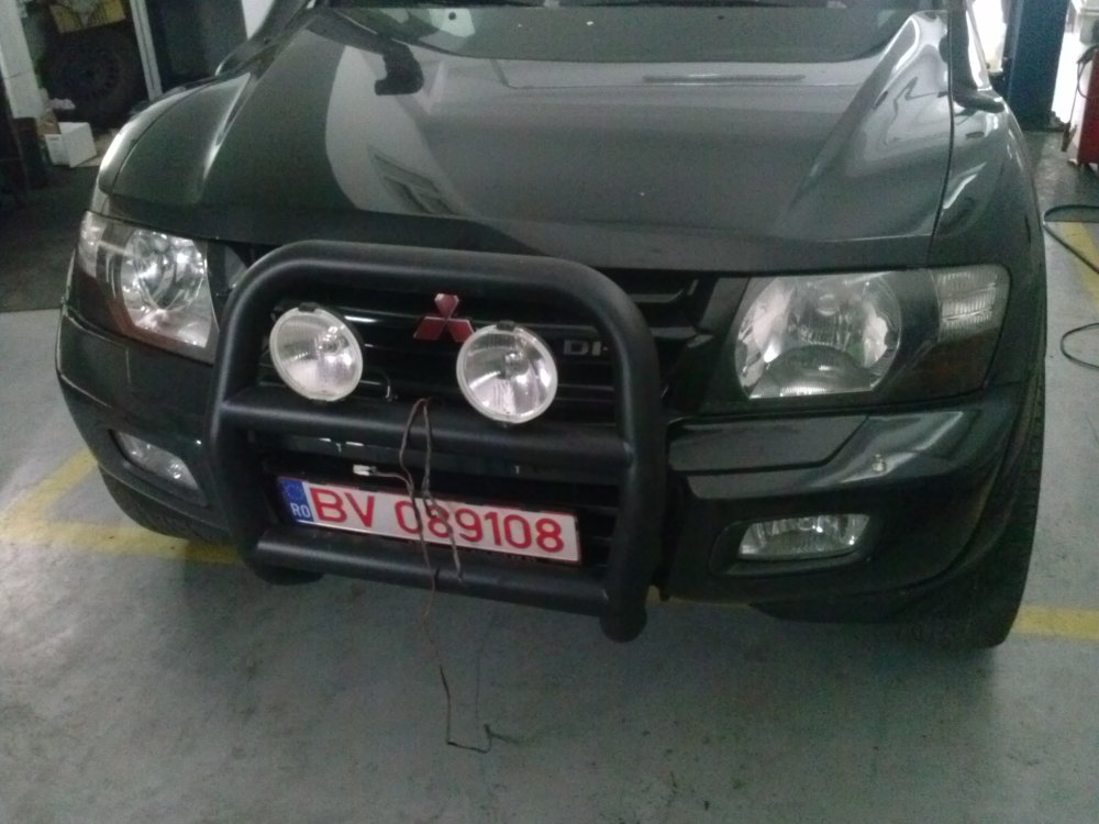

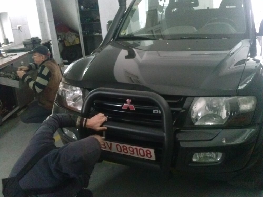

am montat proiectoare pe bullbar
CAM00050.thumb.jpg.aa0394952a98b48a01d133d12338b330.jpgCAM00046.thumb.jpg.90a0cf9ed435515a8650897fb954c4ae.jpgCAM00043.thumb.jpg.a44a9a43f232a4a3731460482514b13c.jpgCAM00052.thumb.jpg.bea626248f2098a507eaf369504a9b1b.jpg

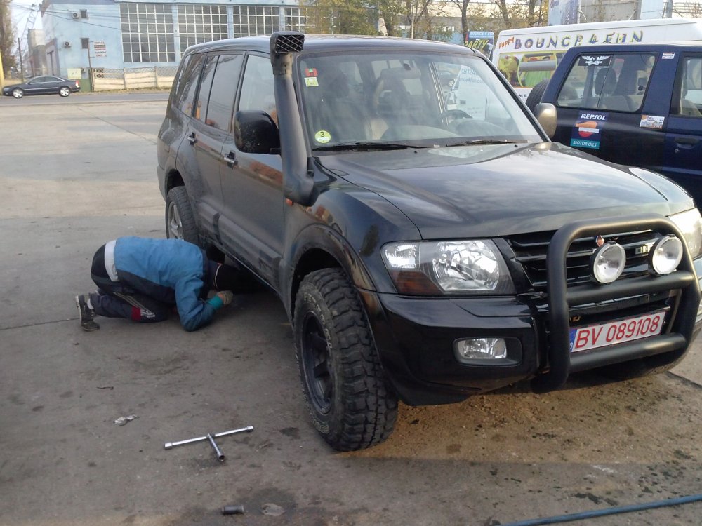

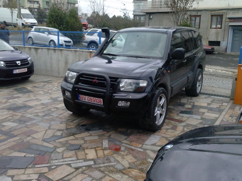

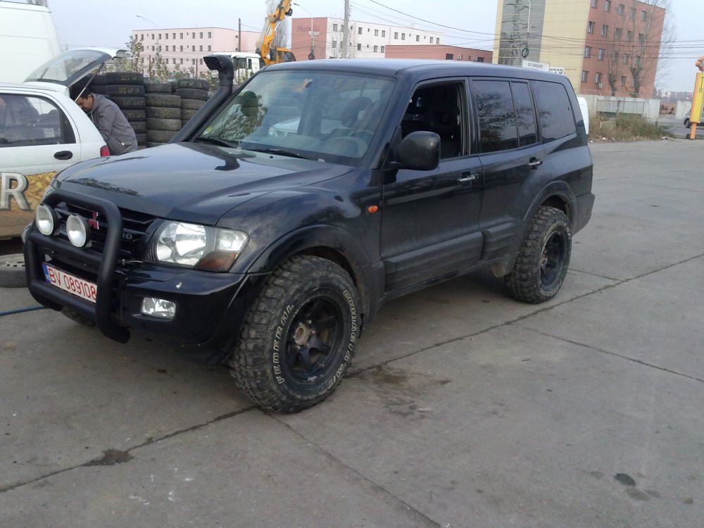

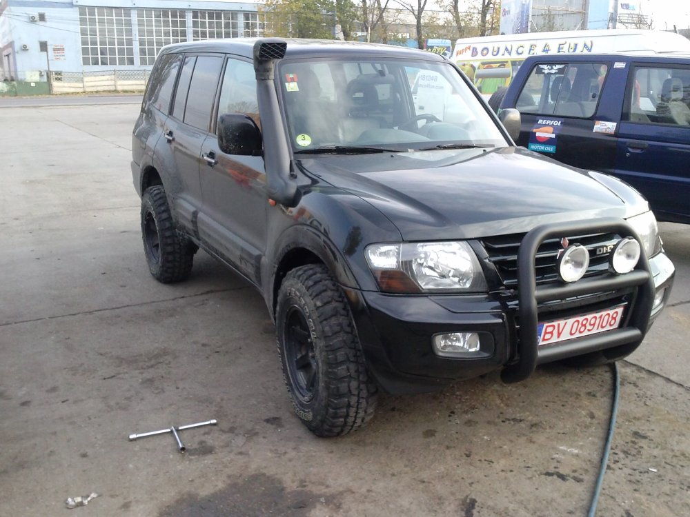

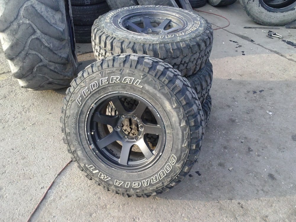

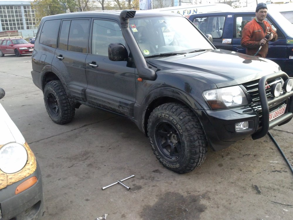

i-am facut cadou un set de roti cu anvelope MT........jante 16" aluminiu et negativ + anvelope 265/75R16 FEDERAL COURAGIA MT
le-am monatat pe masina
CAM00060.thumb.jpg.a234f5049bb32e10d57313d693c300ef.jpgCAM00058.thumb.jpg.b674dbf9d2b337fe750eea7302d98528.jpgCAM00056.thumb.jpg.11d2df01213e45573ab55d63164eb520.jpgCAM00061.thumb.jpg.b96eee205551e4bbd23eccc039520c7e.jpg

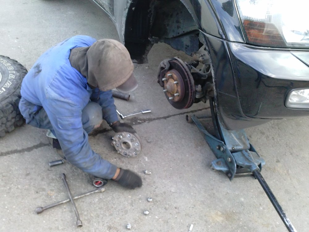

binenteles ca nu mi-au placut cum stau si am dat flansele jos

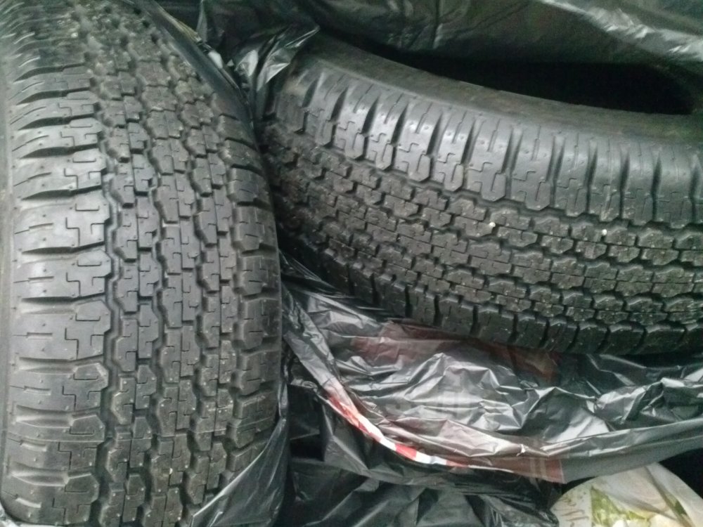

intre timp am trimis jantele originale la curatat sablat si vopsit pentru ca si ele au primit un set de anvelope de iarna BRIDGESTONE.......
IMG-20131118-WA0000.thumb.jpg.4aeeb4c2106c061a34c4377847115245.jpgCAM00035.thumb.jpg.9716dde43efa25dd772d624008cb309f.jpg
Atfel utilajul meu a ajuns sa detina 3 seturi de roti: cele pe 20" pentru vara, cele pe 16"originale cu anvelope de iarna de mers toata ziua si un set de MT pentru iesiri la plimbari offroad usoare.

DAR: da-mi voie sa-mi permit sa-ti spun si tie ce i-am spus si altui (fost) coleg de forum care din pacate a inteles si a reactionat gresit... sper ca tu sa o interpretezi ca si un sfat prietenesc si sa tii cont de el sau nu: jantele negre cu MT-uri nu sunt tocmai indicate pentru masina ta, datorita faptului ca au gaura de centrare mai mare si nu se centreaza pe mijloc, se centreaza si sprijina doar in prezoane in care apar in cazul asta solicitari mai mari si exista riscul sa ramai fara roti pe drum! In cazurile astea se fac de obicei la strung niste inele adaptatoare (daca janta permite) care fac legatura intre inelul discului de frana si gaura jantei.

mersi de sfat dar, am comandat deja acele inele.....se lucreaza la ele.....desi nu am asa de multe comenturi....nu sunt chiar nou in breasla:tk
oricum nu am de gand sa fortzez la iesiri....am un baietel de 5 ani car vine cu mine...asa ca...mai usor.
