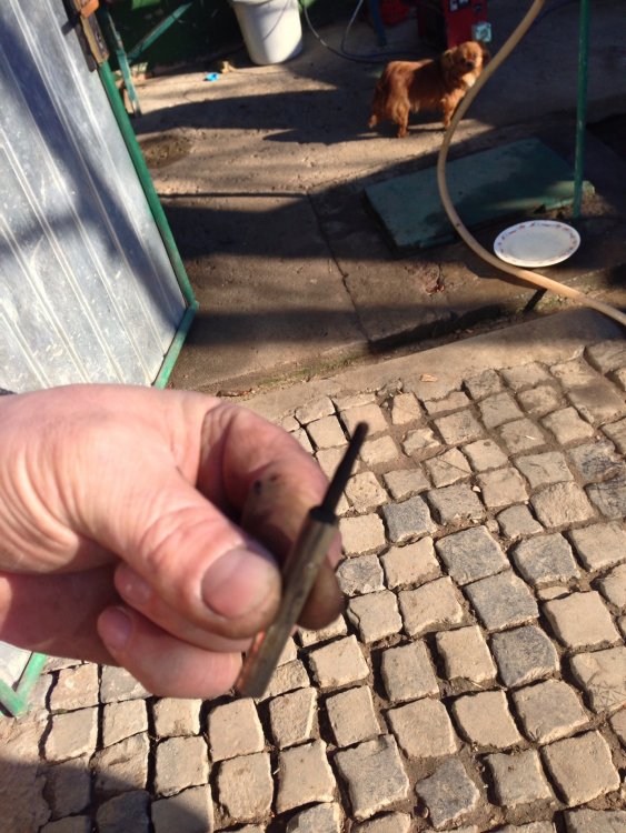

crystyy Posted January 11, 2014 Author Share Posted January 11, 2014 (edited) Re: Bujie rupta in chiulasa! Pun si o poza cu restu de bujie, din pacate la taroDul rupt in bujie nu am facut poza! Edited November 20, 2017 by Astral Ssangyong Rexton si Nissan patrol y61 scurt Link to comment Share on other sites More sharing options...
