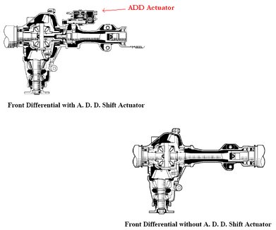

Flow Postat Mai 15, 2014 Partajează Postat Mai 15, 2014 Re: Hilux Double Cab - intrebari diverse 2011 facelift On 13 July 2011, Toyota announced that the Hilux would receive an upgrade, including a redesigned front end and other external styling changes, changes to the interior and a new turbocharged diesel engine capable of 106 kW (142 hp) and 343 N·m (253 lb·ft) of torque, as well as lower fuel consumption compared to the previous model. Add decupleaza planetara mai lunga de pe fata, atunci cand nu este cuplat 4x4, pentru un consum mai mic, uzura mai mica etc. (este practic un vacum disconect utilizat la marea majoritate a 4x4 rilor de teren numit diferit de fiecare constructor) Nu ADD permite trecerea din 2x4 in 4x4 si invers in mers ci cutia de transfer. How does the Toyota ADD System Work? There is a pneumatic device called an "actuator" attached to the front differential that effectively slides the driver side shaft out of the differential. On trucks that have ADD Toyota uses "live hubs" (see hubs section below). This means that both front half shafts and the front diff spin even in 2WD (but not the front drive shaft). There are a set of air bags inside the actuator that control the position of the ADD sleeve. This actuator will stay in it's current position until vacuum is applied to change it's position even if there is no vacuum at all. For 2WD operation vacuum is applied to driver side tube of the actuator and it holds the sleeve in the out position. When you engage 4WD a switch on the transfer case changes a set of air valves under the hood. This causes vacuum to be applied to the passenger side tube of the actuator and it pulls the sleeve over to the right and connects the drivers side axle shaft to the differential. Once the splines on the sleeve and the splines on the shaft are aligned the sleeve slides toward the passenger side and the front drive is engaged There are two switches that must be in the closed position for the 4WD light to come on. The first switch is controlled by the position of the transfer case shift lever. The second light is on the ADD actuator and it turns on after the sleeve has moved into the right (locked) position. Cu siguranta este un mare plus diferential blocabil spate, daca il platesti separat il poti avea pe oricare dintre versiuni. Exista masini fara nici o dotare cu diferential blocabil spate si tot asa exista si masini full cu sau fara diferential blocabil spate. Toate acestea pentru ca asa a configurat o cumparatorul de noua. Da, fara nici o problema poti cupla 4x4 fara a bloca spatele, ulterior blochezi spatele daca o impun conditiile din teren. Prea mult timp liber dauneaza mintii si asa odihnite. Link spre comentariu Distribuie pe alte site-uri Alte opțiuni partajare...
