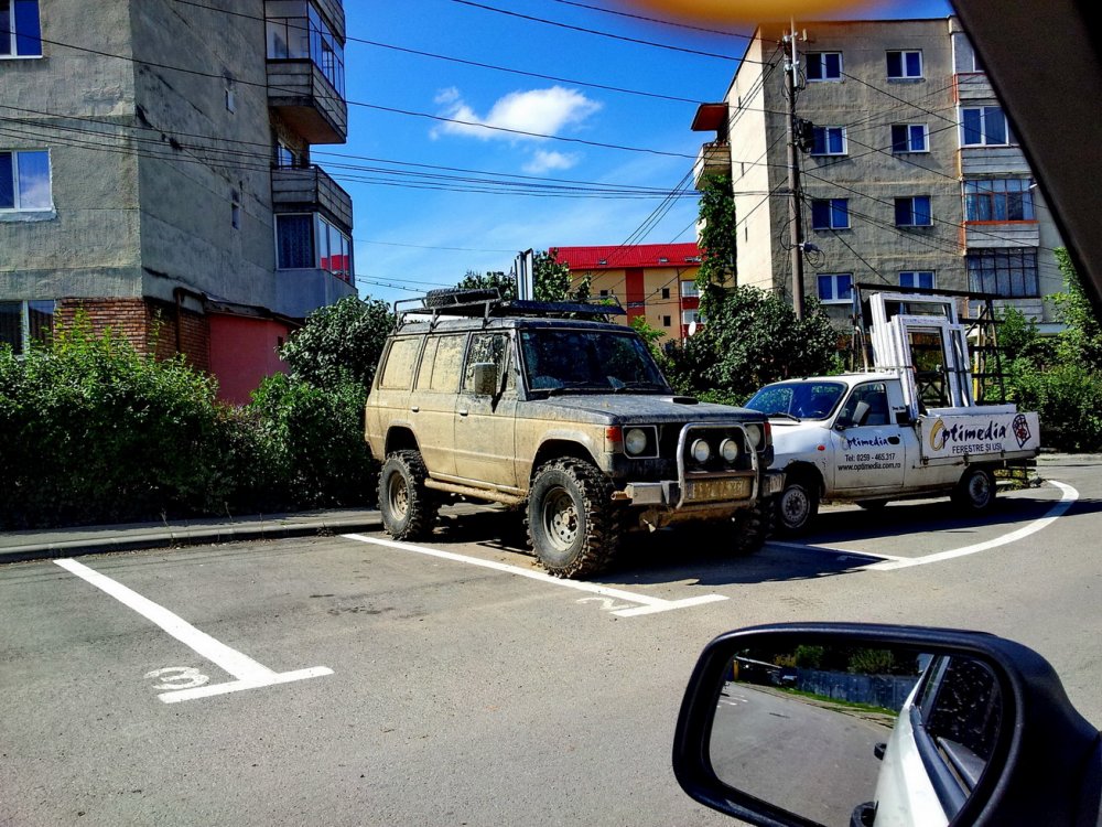

vas_adam2000 Posted December 14, 2014 Share Posted December 14, 2014 Re: Am restaurat si eu un Mk1 :) Masinuta din Marasti :) Link to comment Share on other sites More sharing options...
Irod Posted December 14, 2014 Share Posted December 14, 2014 Re: Am restaurat si eu un Mk1 :) foarte frumos! de ce ii puntea fata? Nissan Terrano R20 Panzer II BFG MT Nissan Patrol Y61 Panzer IV BFG MT Natura si aventura Link to comment Share on other sites More sharing options...

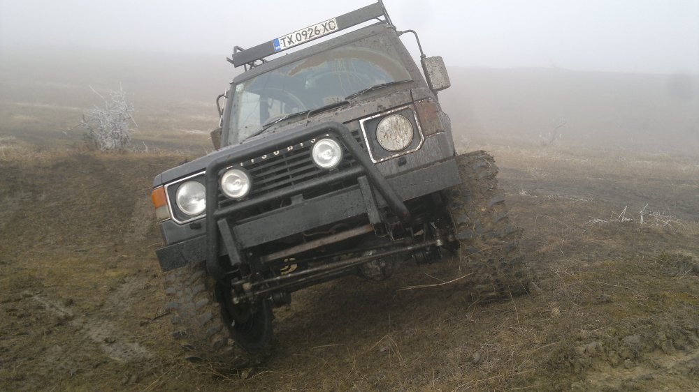

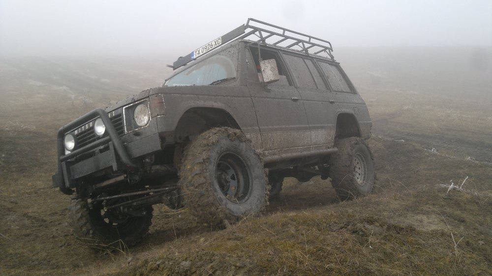

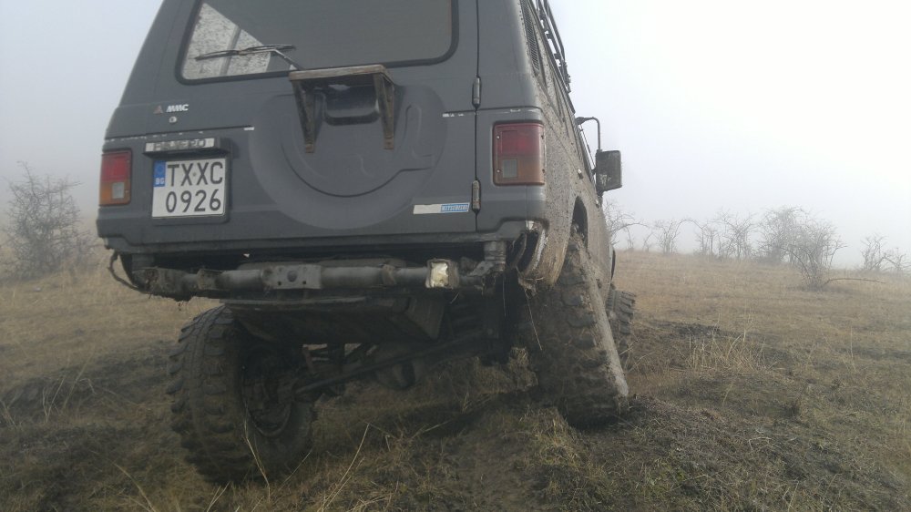

vas_adam2000 Posted December 14, 2014 Share Posted December 14, 2014 Re: Am restaurat si eu un Mk1 :) Doua poze "spion" :grin: Am vrut sa fac poze normale dar o doamna m-a atentionat sa nu indraznesc. Link to comment Share on other sites More sharing options...

CatalinU Posted December 15, 2014 Share Posted December 15, 2014 Re: Am restaurat si eu un Mk1 :) foarte frumos! de ce ii puntea fata? si eu is curios?tentant si pt mine Ever tried.Ever failed.Try again.Fail again.Fail better Link to comment Share on other sites More sharing options...
Remus Posted December 15, 2014 Author Share Posted December 15, 2014 Re: Am restaurat si eu un Mk1 :) I punte de IMS cu discuri ventilate de vitara (cam mici, da tine frana) masina nu i gata numa sambata am probato sa vedem daca sa rupe ceva :)) mai am umpic de lucru la ea da manca pamantu :)) Link to comment Share on other sites More sharing options...

Remus Posted December 18, 2014 Author Share Posted December 18, 2014 (edited) Re: Am restaurat si eu un Mk1 :) motor de 2.5 diesel raport 39/8 spate si pe fata am pus 33/7. Modificari la masina nu am prea facut am taiat toti suporti de pe sasiu, bascule, desfacut bari torsiune tot ce mo deranjat :). oale pentru arcuri am confectionat si prindere pentru tendoane atat am modificat la masina si o traversa intre lonjeroane am sudat acolo, sii la mine i volanu pe dreapta si am pus o caseta de nissan y61 tot pe dreapta Am intarit sasiu fata ca i subtire acolo in fata la pajero In rest modificari la punte,suporti pentru etrieri sa pui discuri,flanse pentru tendoane, oale pentru arcuri,suporti pentru telescoape,levier pentru directie si detalii :)) Edited December 18, 2014 by Remus Link to comment Share on other sites More sharing options...

Remus Posted March 6, 2015 Author Share Posted March 6, 2015 (edited) Re: Am restaurat si eu un Mk1 :) mai multe! :)) 1- din cauza terenului so forfecat boltu de la panhard si so smuls omocinetica din punte :)! 2 - rupt planetara scurta care i taiata si adaugata ca sa pot pune blocant. in rest merge bine Edited March 6, 2015 by Remus Link to comment Share on other sites More sharing options...
