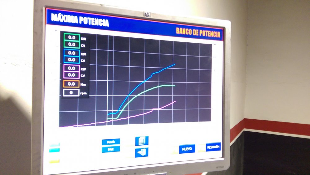

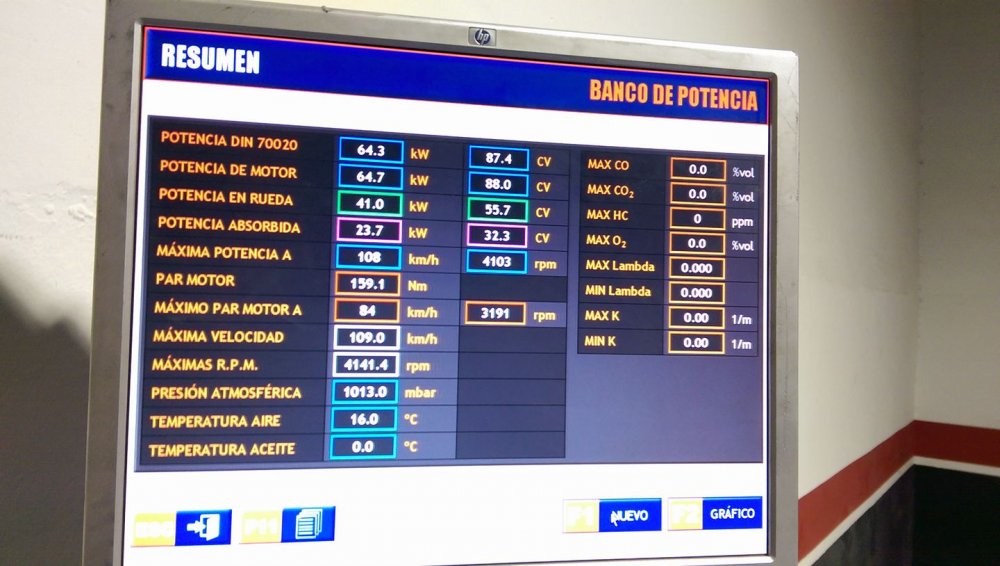

Teodor4x4 Posted February 25, 2017 Author Share Posted February 25, 2017 Re: Tractorasul - Vitara 1.9 TD '00 Dyno test cu motorul ei de 75 CP: 4x4, Way of Life ! Link to comment Share on other sites More sharing options...
