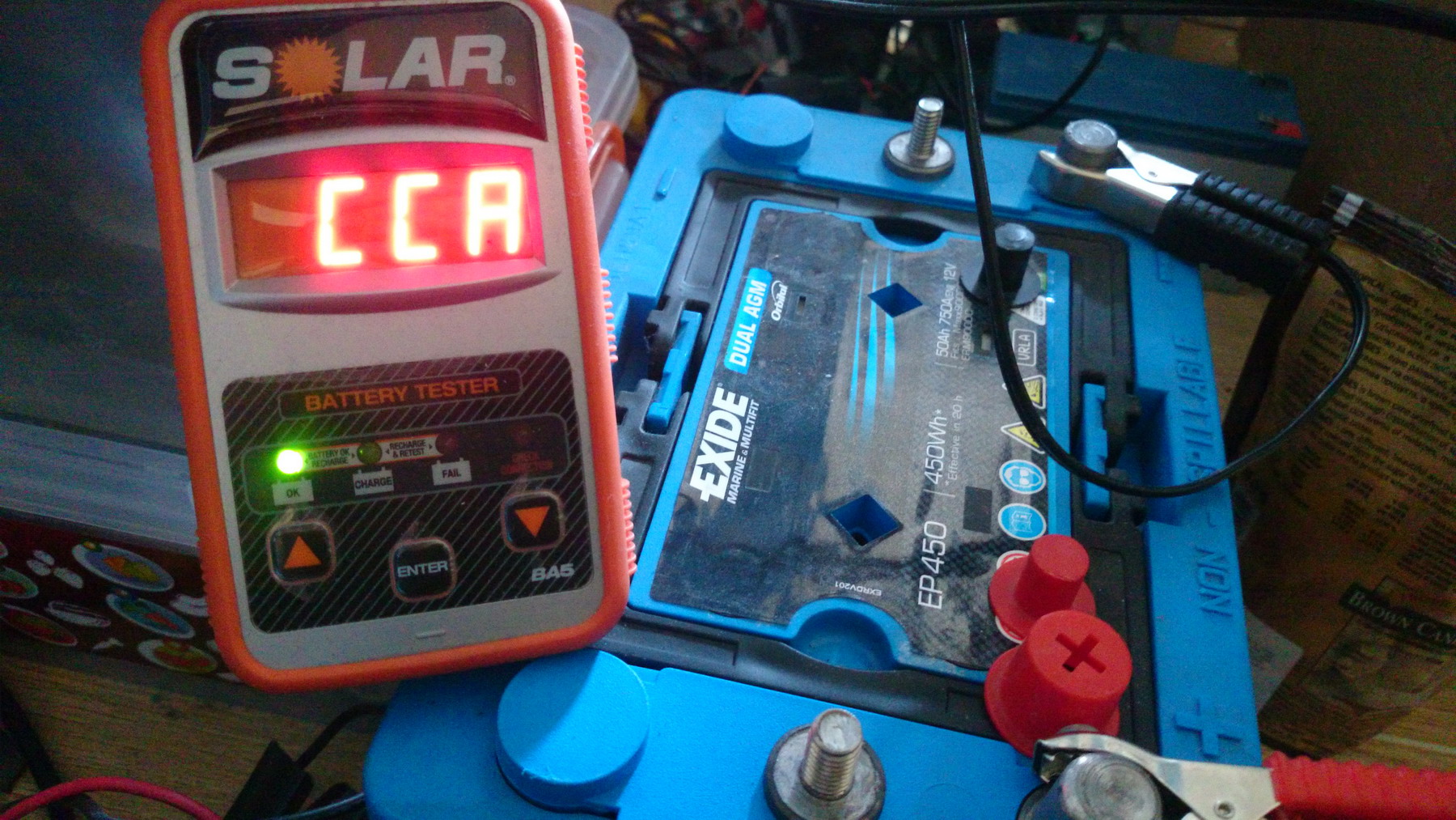

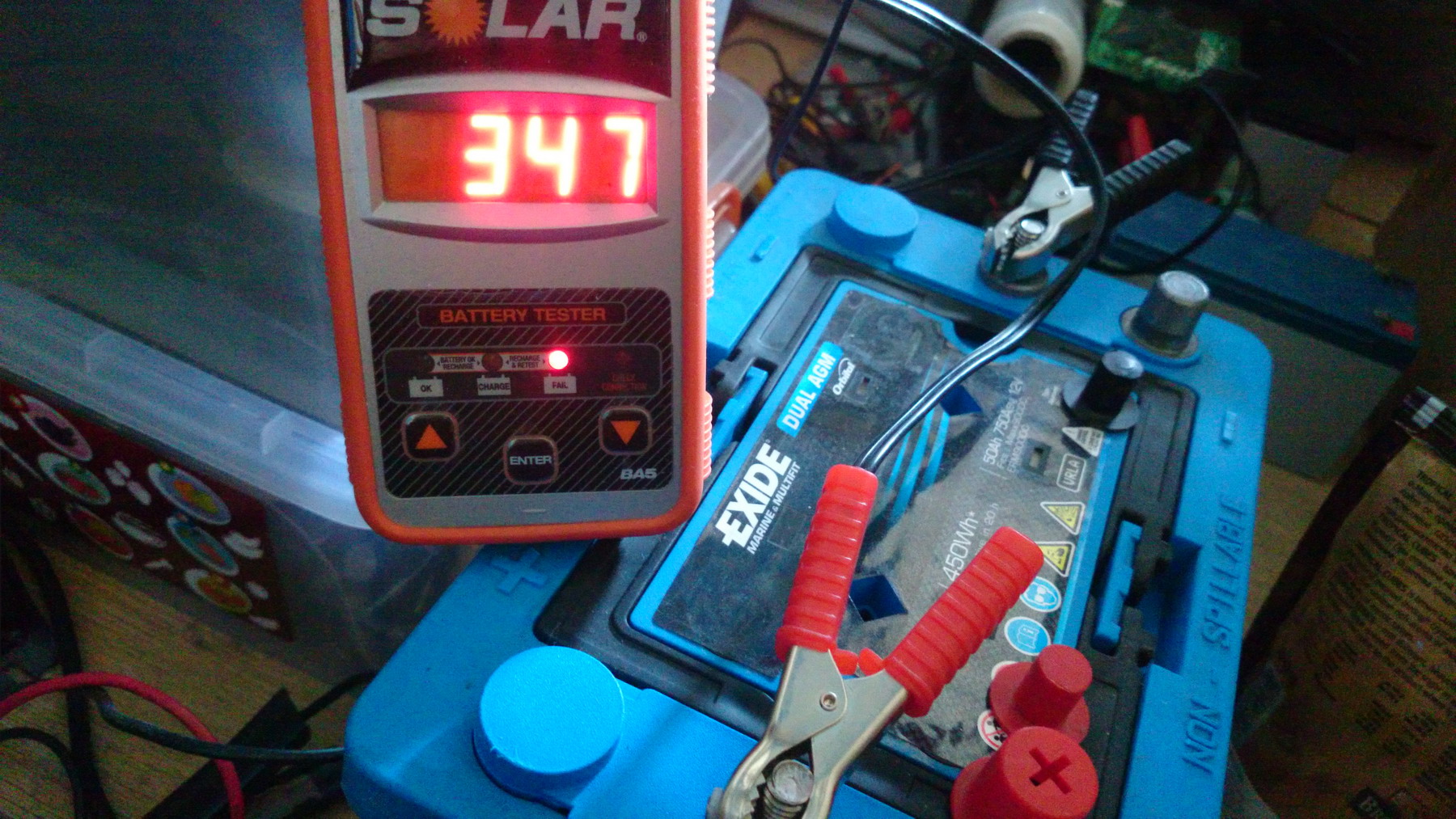

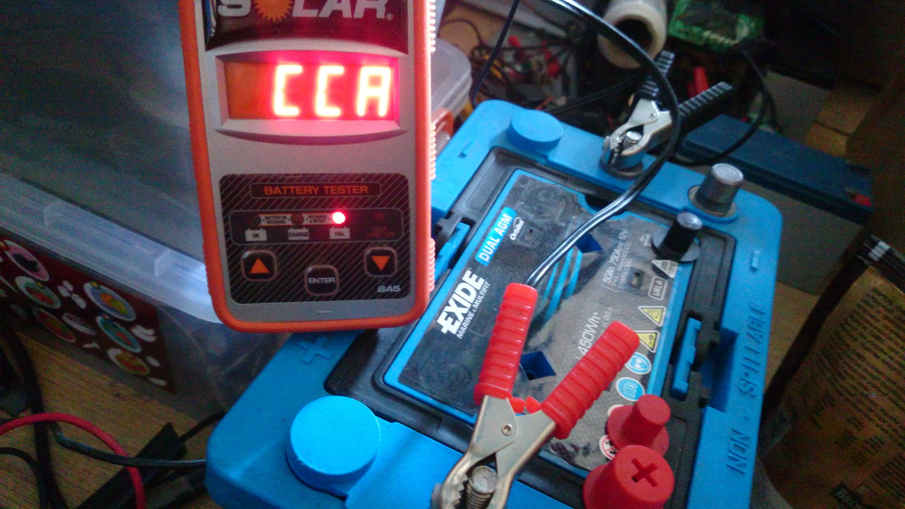

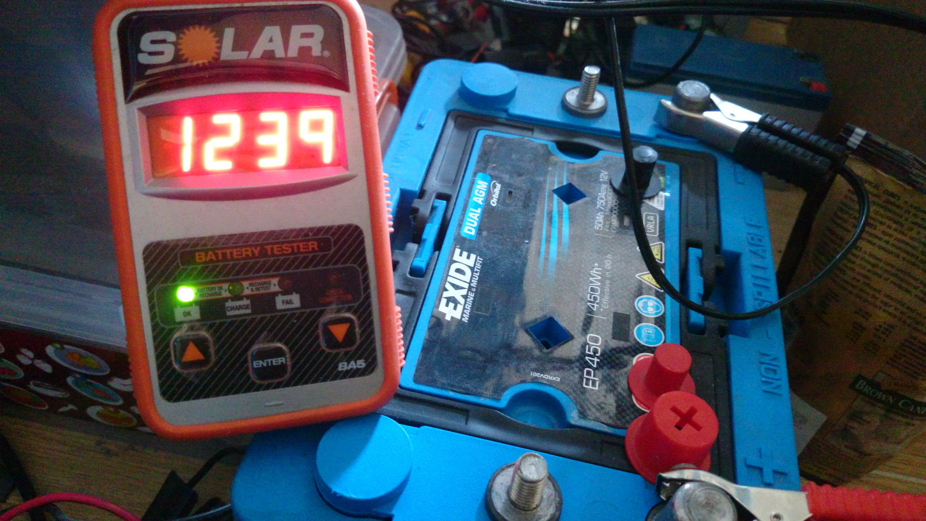

Salut, am cumparat o baterie de backup, un deep-cycle, si am constatat ca are doua perechi de borne. Masurand tensiunea si CCA (Cold Crancking Ampers) am observat ca la bornele mai mici desi sunt tot 12V, CCA este mult redus! Intrebarea mea: la ce se pot folosi bornele suplimentare in acest caz?DSC_0792.thumb.jpg.d43b28f231411769ad01ccd9e2e3a3ba.jpgDSC_0791.thumb.jpg.a61ad68cac02f6dfe874549db4e4cfcb.jpgDSC_0790.thumb.jpg.161384796111fc10a1e2c6f1d04c73b3.jpgDSC_0789.thumb.jpg.af35dabe4eaa36dd0345520e01338bc1.jpg

Bornele mari ca borne de startup de curent mare pentru pornirea motorului iar cele mici pentru consumatori obisnuiti folositi pe timpul zilei astfel incat sa poti porni motorul si dupa ce ai ascultat la radio toata ziua.:wink:
"Dual Supply Need
Starting engine in combination with the supply to other
electrical equipment requires not only high peaks of power
but also a variable power drain, causing battery discharge
during the journey. The electrical unit used to measure dual
supply need is Wh*"
http://www.exide.com/Media/files/Downloads/TransEuro/ML/Exide_Marine%20leaflet%202015_Europe_EN.pdf
