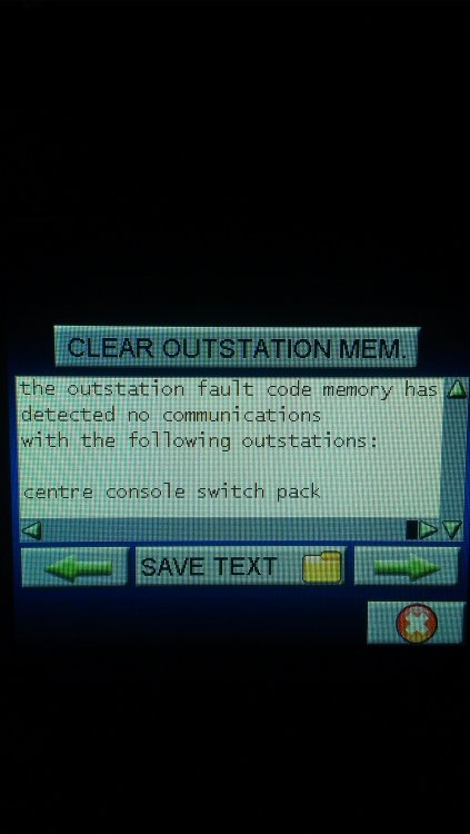

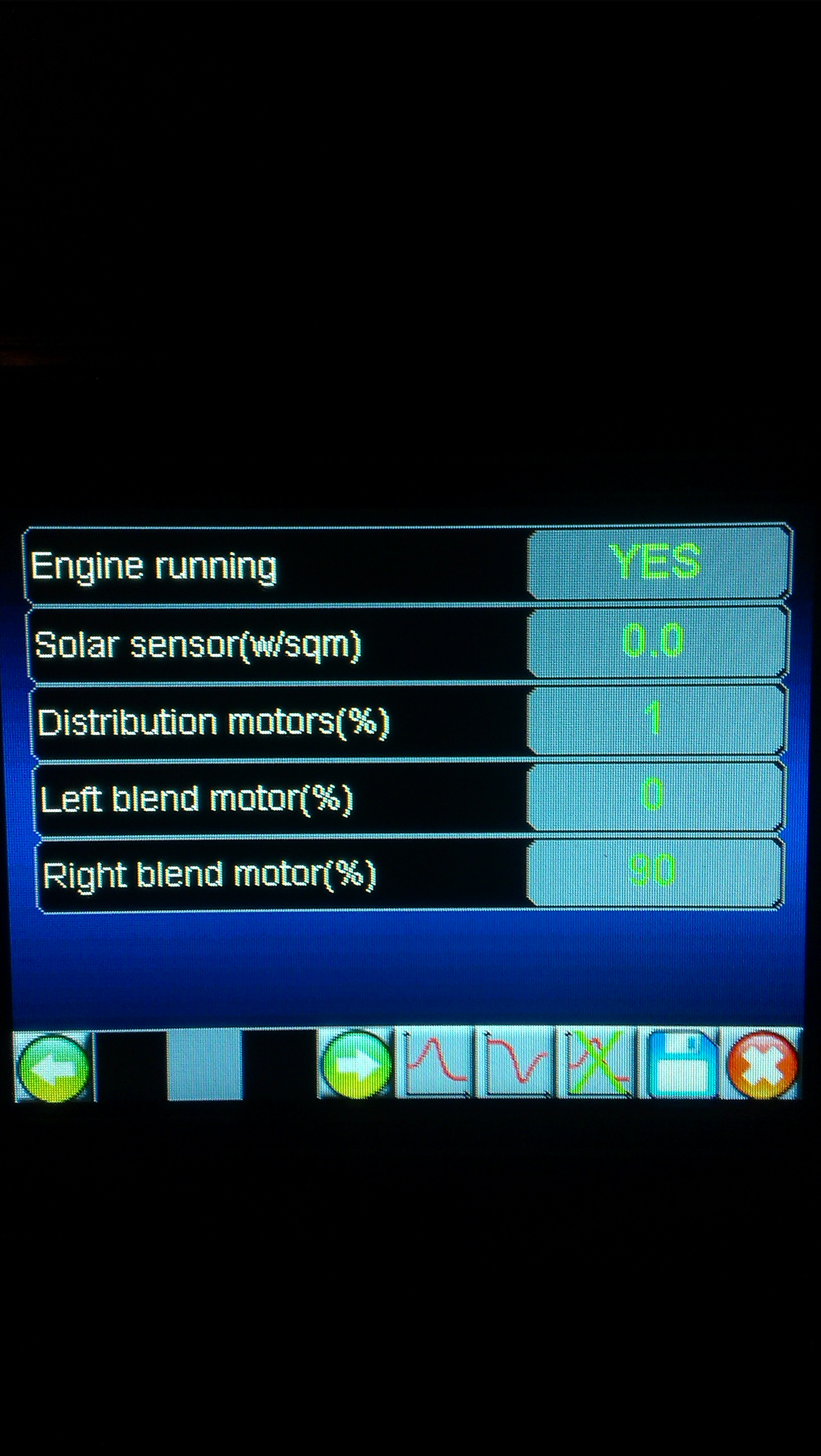

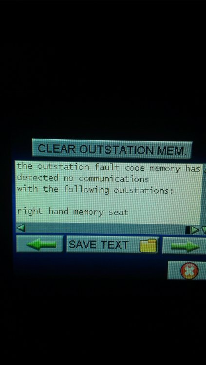

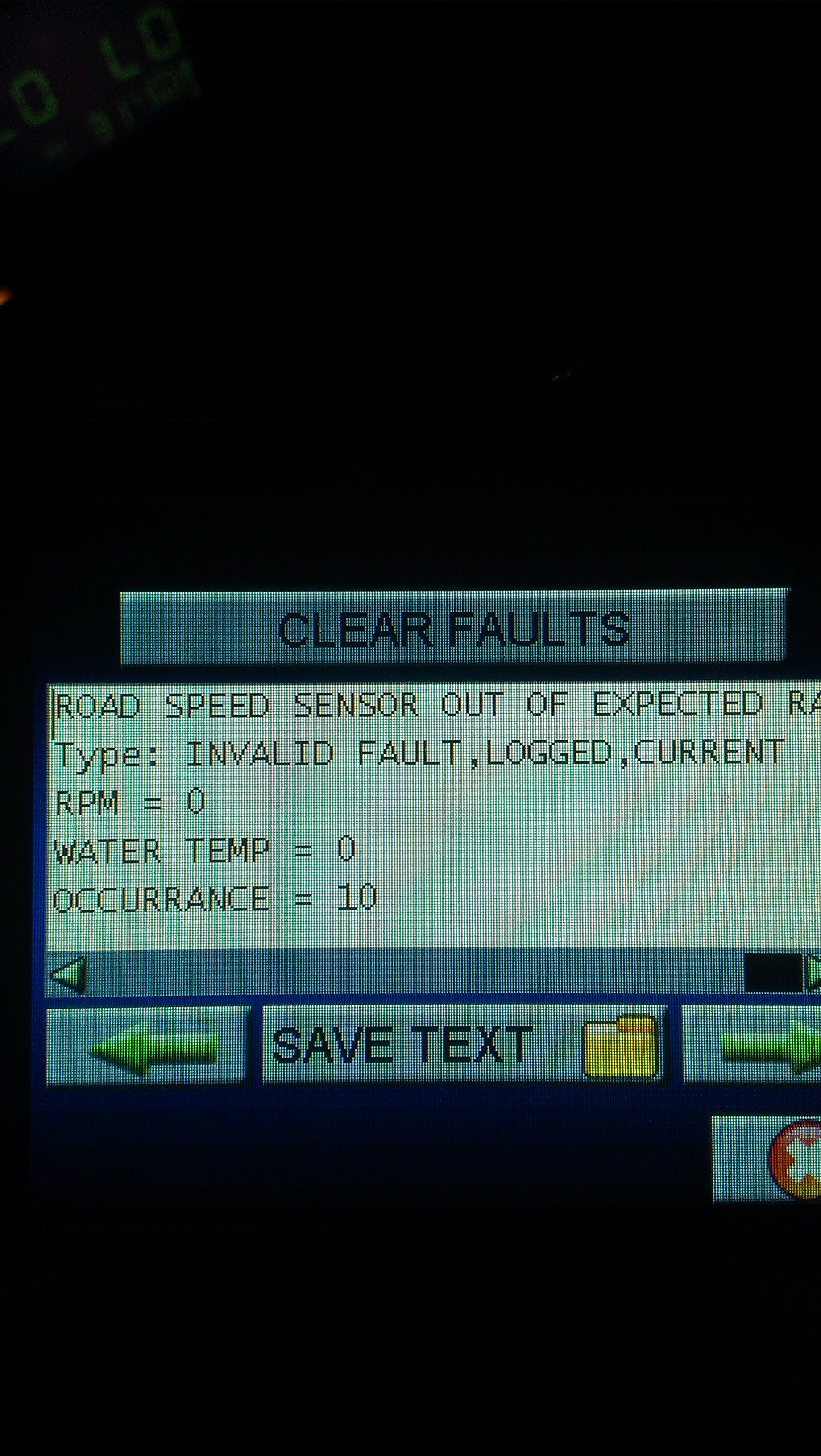

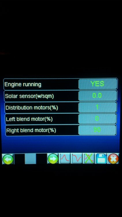

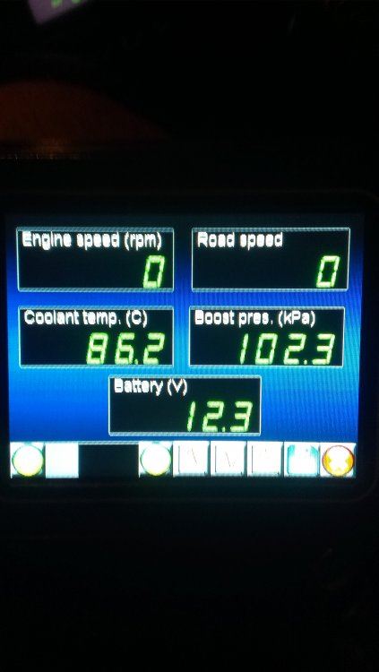

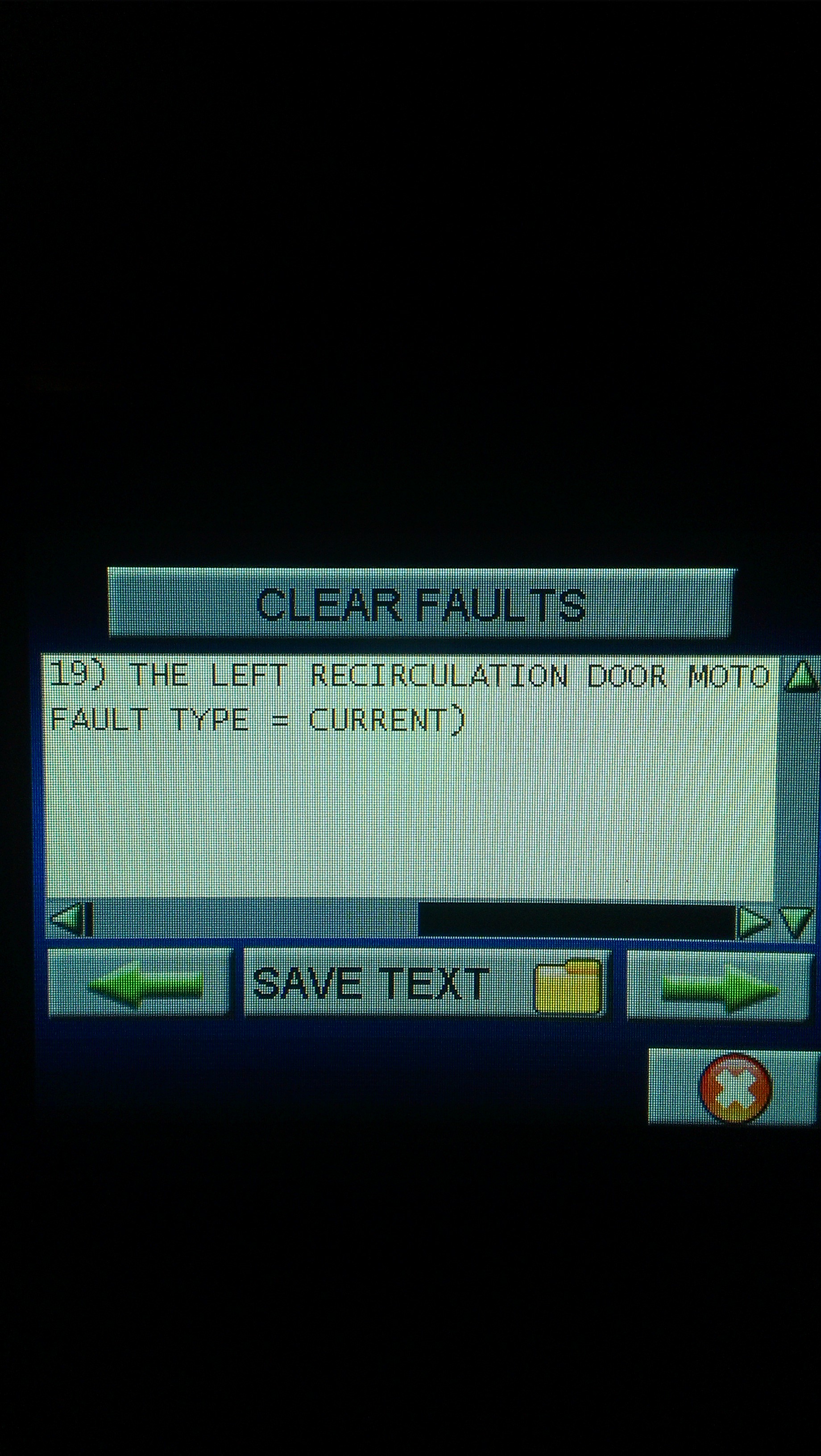

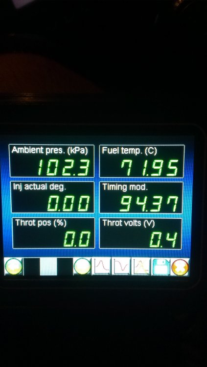

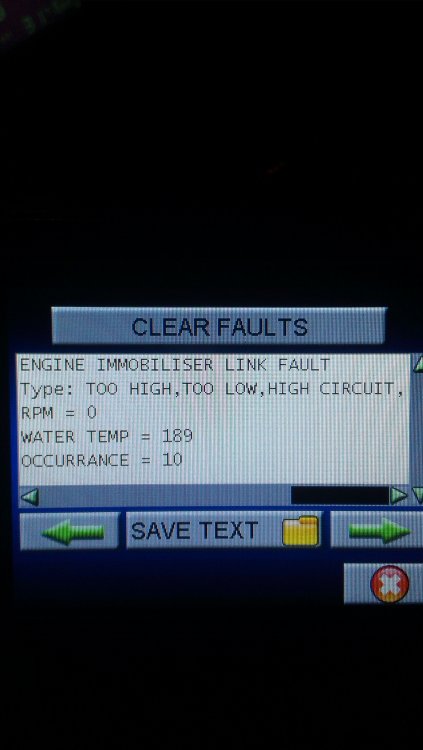

dupa cum spuneam acu o vreme ... iata si cateva poze.
IMAG0399.thumb.jpg.dc7075ae6aa6109ff15f893f121ecac4.jpgIMAG0407.thumb.jpg.8d54f6df2b9b3ddda0f7ee3358498ed7.jpgIMAG0406.thumb.jpg.416cdcb0d6496ab772b046924283abc4.jpgIMAG0405.thumb.jpg.678af903aa5fdaea4e5abd5b9b6c8eea.jpgIMAG0404.thumb.jpg.9b8b4330dbe5e0aa7aab27c454ba4674.jpgIMAG0403.thumb.jpg.3e4b10785846153f0fcb08fa6bce09b7.jpgIMAG0402.thumb.jpg.059c8115ff4ada5c066e55a9c6e4be86.jpgIMAG0401.thumb.jpg.12d6e2e93ccfecc47d4709a77b339526.jpgIMAG0400.thumb.jpg.6e91d18436c578daa8ae34e7b3c601a3.jpgIMAG0388.thumb.jpg.0e877e55a2b37f2c245f1a887b5d008e.jpgIMAG0390.thumb.jpg.c0cc30804c31e30d91c72bf1dd560679.jpgIMAG0391.thumb.jpg.fba71cd95ad273f88f2ead080742d49b.jpgIMAG0392.thumb.jpg.bc7bb0aee6a7b14c56d10aa977058cf4.jpgIMAG0393.thumb.jpg.03737d5adbbf97c1f15a47236e9e3795.jpgIMAG0395.thumb.jpg.969a489967fc55574488ca5a40292966.jpgIMAG0396.thumb.jpg.edcf23fb5b6696e32d2037e518a18ae2.jpgIMAG0397.thumb.jpg.1df7ea0064427c948f1bf6e6628d2201.jpgIMAG0398.thumb.jpg.3bb28765e5b1b00e04b6c9207448331a.jpgIMAG0408.thumb.jpg.d4c92fae83cd2c760f205ff8217e6418.jpg

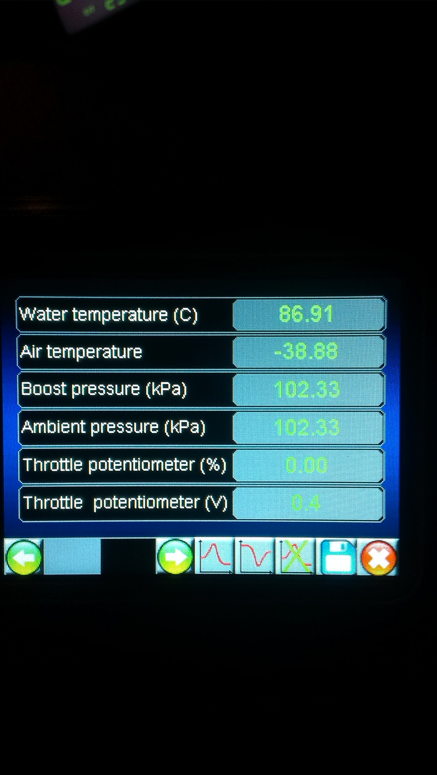

Chiar erau -38*C cand ai facut testarea?, coroborat cu inca o citire dubioasa as zice sa pui un senzor nou de temperatura
Re: Nanocom NCOM06 - Sfaturi ... contraindicatii... ETC
salutare.
din cate m-am documentat faza cu -38-ul ala e de la lipsa senzorului de pe galeria de admisie ... care este prezent doar la modelele fara EGR. cum la mine este prezent egr-ul nu mai este loc pt acel senzor si implicit arata -38.
cel putin asa am descoperit pe alte forum-uri.
