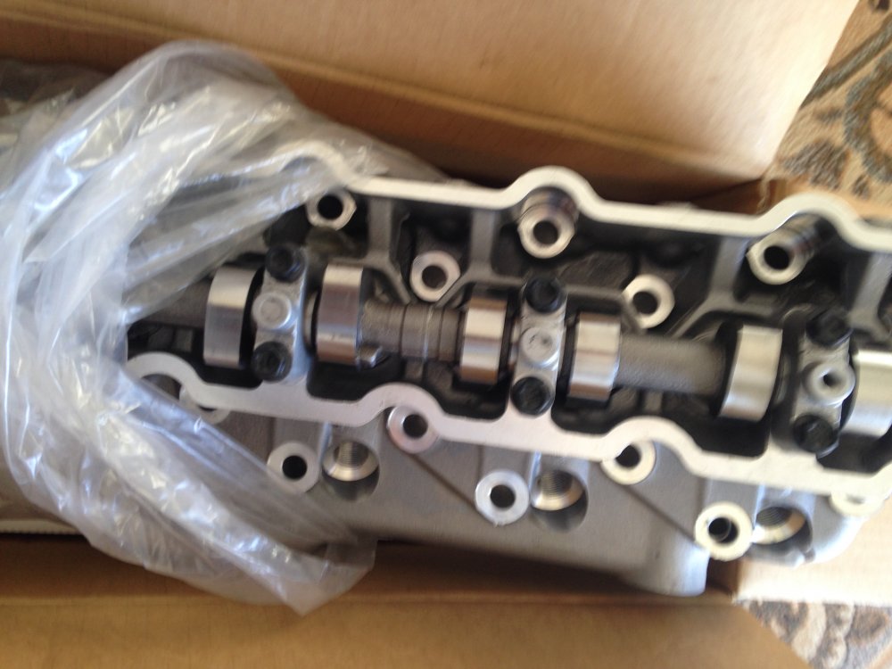

bogdan mihai Posted February 1, 2017 Author Share Posted February 1, 2017 Re: mk2 2.8 hidramat nu se tureaza si se opreste cateva imagini de la schimbarea chiuloasei si demontarea pompei denjectie pentru schimbarea garniturilor [ATTACH=CONFIG]275463[/ATTACH][ATTACH=CONFIG]275464[/ATTACH][ATTACH=CONFIG]275465[/ATTACH][ATTACH=CONFIG]275466[/ATTACH][ATTACH=CONFIG]275467[/ATTACH][ATTACH=CONFIG]275468[/ATTACH][ATTACH=CONFIG]275469[/ATTACH][ATTACH=CONFIG]275470[/ATTACH][ATTACH=CONFIG]275471[/ATTACH][ATTACH=CONFIG]275472[/ATTACH][ATTACH=CONFIG]275473[/ATTACH][ATTACH=CONFIG]275474[/ATTACH][ATTACH=CONFIG]275475[/ATTACH][ATTACH=CONFIG]275476[/ATTACH][ATTACH=CONFIG]275477[/ATTACH][ATTACH=CONFIG]275478[/ATTACH][ATTACH=CONFIG]275479[/ATTACH][ATTACH=CONFIG]275480[/ATTACH][ATTACH=CONFIG]275481[/ATTACH][ATTACH=CONFIG]275482[/ATTACH] Link to comment Share on other sites More sharing options...
