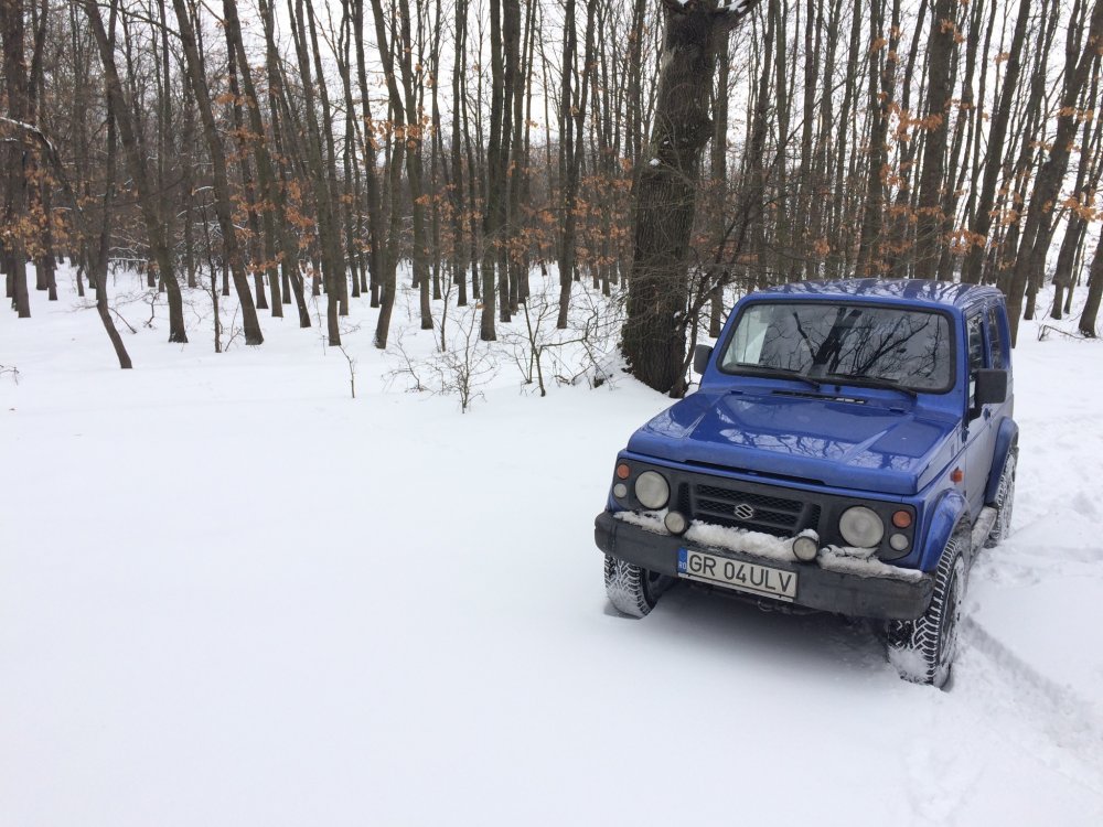

MudMan Posted February 21, 2017 Author Share Posted February 21, 2017 Re: Sfat achizitie Samurai In final am ajuns la un SJ80, fabricat in 1998. Am scos-o de doua ori la cafea (la padure) si incepem sa ne cunoastem :grin: Deja se profileaza in minte niste modificari pe care domnisoara le va "suferi". Mud treatment is the best treatment! Link to comment Share on other sites More sharing options...
