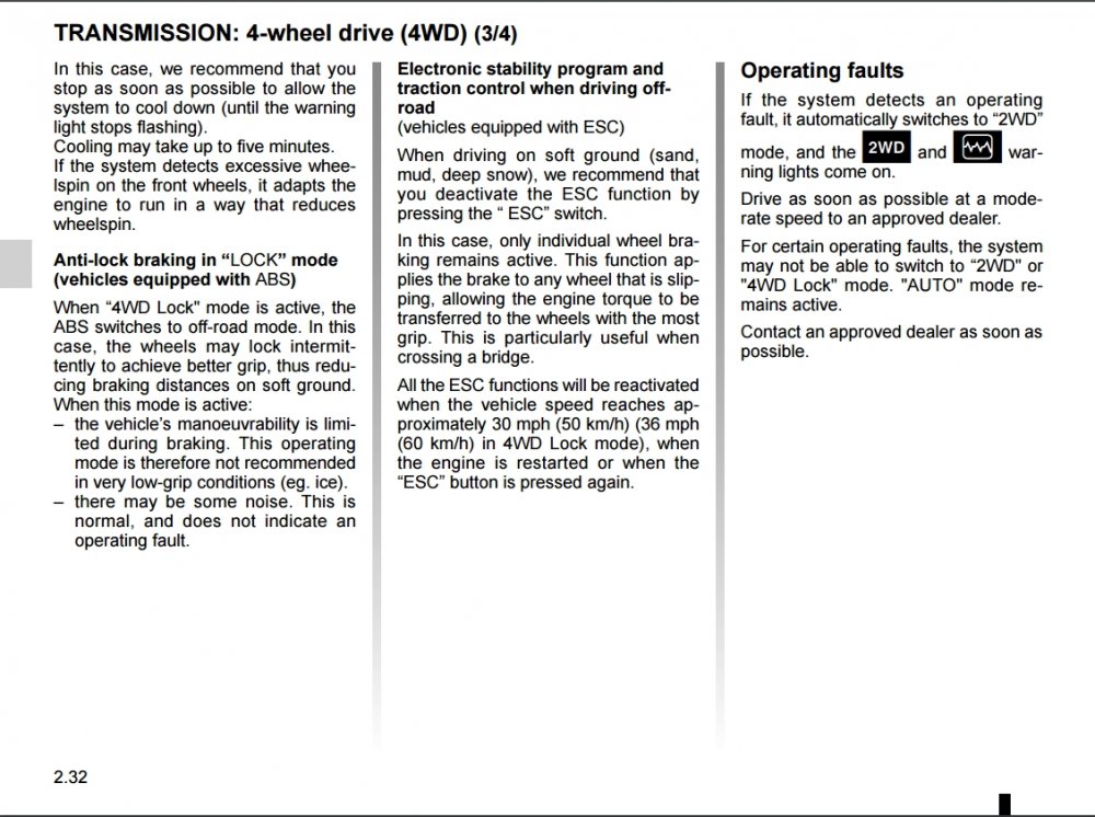

B0GD4N Posted May 31, 2017 Share Posted May 31, 2017 Re: Diferential autoblocant Duster arata si mie unde ai citit ca nu are:) cu esp off cine franeaza roata? Link to comment Share on other sites More sharing options...
dragos.b Posted May 31, 2017 Share Posted May 31, 2017 Re: Diferential autoblocant Duster De prin manual, coloana din mijloc. Functia e prezenta si pe PH1 :) Link to comment Share on other sites More sharing options...
B0GD4N Posted May 31, 2017 Share Posted May 31, 2017 Re: Diferential autoblocant Duster deci are edl si ph1 si ph2.. Link to comment Share on other sites More sharing options...
dragos.b Posted May 31, 2017 Share Posted May 31, 2017 Re: Diferential autoblocant Duster Are. Bine... functionalitatea lui e limitata in teren, mai mult zgomot decat actiune, dar poate sa reprezinte micul impuls necesar pentru a iesi din situatii cacacioase. Nu poate fi comparat cu EDL/traction control al SUV-urilor consacrate. Link to comment Share on other sites More sharing options...

B0GD4N Posted May 31, 2017 Share Posted May 31, 2017 (edited) Re: Diferential autoblocant Duster abs = lucreaza la franare. abs nu franeaza roata cand nu apesi pedala.... la accelerare are fix edl, indiferent cum l-ar numi producatorul. apropo are si descend hill electronic, are probabil softul de quasquai. va zic ce am testat, voi nu si nu repet intrebarea, la ph1 se comporta la fel? Edited May 31, 2017 by B0GD4N Link to comment Share on other sites More sharing options...
