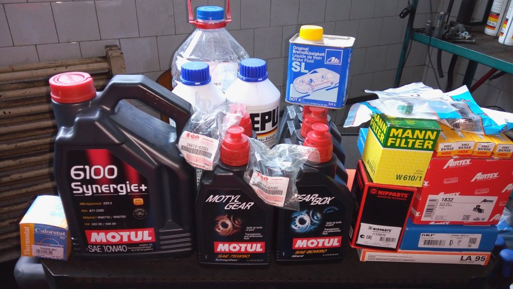

kimi Posted January 10, 2017 Author Share Posted January 10, 2017 Re: Noul meu Jim Sa incepem . Link to comment Share on other sites More sharing options...
minitehnicusro Posted January 10, 2017 Share Posted January 10, 2017 Re: Noul meu Jim Filtrul de combustibil Nipparts sunt curios unde o sa-l montezi, ca de fabrrica nu exista asa ceva, singurul filtru de benzina este in rezervor langa pompa de benzina si este de tip cartus. Decat sa pui termostatul ala, mai bine lasa-l pe cel original. Am intalnit nenumarate termostate NOI de la firme mult mai spalate care nu se inchideau complet, nu se deschideau complet sau au personalitate proprie. Daca tii neaparat sa-l schimbi, pune original. 3x Suzuki Jimny 1x Suzuki Samurai Dacia DoubleCab 4x4 Link to comment Share on other sites More sharing options...
kimi Posted January 10, 2017 Author Share Posted January 10, 2017 Re: Noul meu Jim S-a notat . Multumesc . Link to comment Share on other sites More sharing options...
