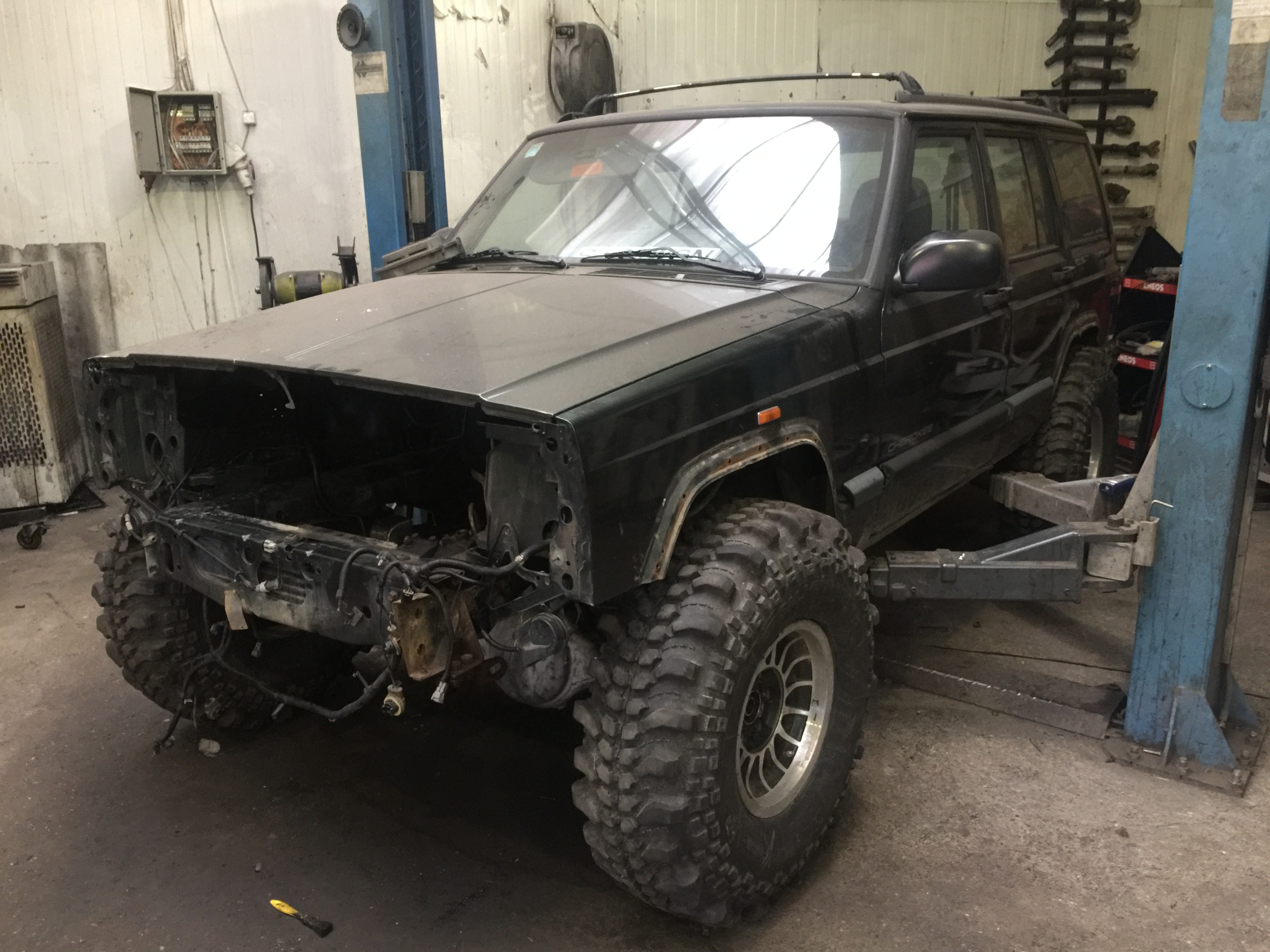

alin-jeep Posted March 3, 2017 Share Posted March 3, 2017 Masina este din 2000 ,are motor de 4000 cmc ,cutie automata ,cutie transfer 242 , punte spate Chrysler8.25 ,fata Dana 30 ,roti originale,rapoarte 3,55 LSD spate Urmeaza: -inlocuire punti cu punti de Nissan Patrol Y 60 -rapoarte 4,62 -blocant spate in prima faza -4 link fata +Panhard -4 link spate dublu triangulat -brate lungi -cutie transfer DANA 300 -cardane Patrol y61 lung -roti 38x12,5x15 -CST by Maxxis Link to comment Share on other sites More sharing options...

alin-jeep Posted April 2, 2017 Author Share Posted April 2, 2017 (edited) Re: XJ cu 38-uri Am inceput si al doilea proiect in aproape aceeasi configuratie ,in plus mai montam blocant ARB fata si motor de 5,2 V8 si cutie automata 46 RH . Pacientul a sosit : Edited April 2, 2017 by alin-jeep Link to comment Share on other sites More sharing options...
alin-jeep Posted May 23, 2017 Author Share Posted May 23, 2017 Re: XJ cu 38-uri Treaba merge bine dar incet . Am avut de facut fendere si praguri ( care nu erau in proiectul initial ) . Lucrand la praguri am dat de ceva rugina si a trebuit sa o eliminam chestii care modifica termenul de finalizare prevazut initial . La cel de-al doilea XJ am renuntat la ideea de 5,2 V8 si am hotarat sa montam 1,9 TDI de VW si sa incerc sa il omologhez ( simt ca o sa reusesc ) Va tin la curent :wink: Link to comment Share on other sites More sharing options...

alin-jeep Posted May 25, 2017 Author Share Posted May 25, 2017 Re: XJ cu 38-uri Primii si cei mai importanti pasi : :h5 Link to comment Share on other sites More sharing options...
Chronos Posted May 26, 2017 Share Posted May 26, 2017 Re: XJ cu 38-uri Primii si cei mai importanti pasi : :h5 Salut, Ne poti ilumina, te rog, cu marimea reala a cauciucurilor ? Link to comment Share on other sites More sharing options...
alin-jeep Posted May 26, 2017 Author Share Posted May 26, 2017 Re: XJ cu 38-uri Salut, Ne poti ilumina, te rog, cu marimea reala a cauciucurilor ? 90 cm montate pe janta de 10 J si 1.5 bari presiune ,sub o caroserie de Jeep cu motor de 4000 :h5 Link to comment Share on other sites More sharing options...
