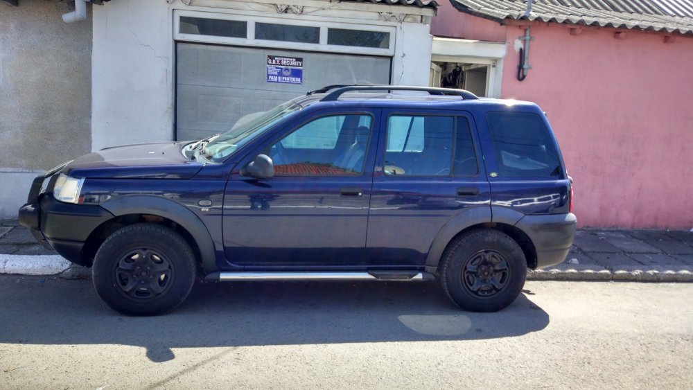

IMG_20170427_211051_HHT.thumb.jpg.59965d242d9b8bdd6e6a230cfa3a1dce.jpgIMG_20170427_211108_HHT.thumb.jpg.ec3c277900879ef93d32686db5c77d8e.jpgIMG_20170428_143157_HDR.thumb.jpg.3080ae2dd03c11036ec38193e7d5895c.jpg
Cam asa arata, cand era curat, Tractorasul!!!
