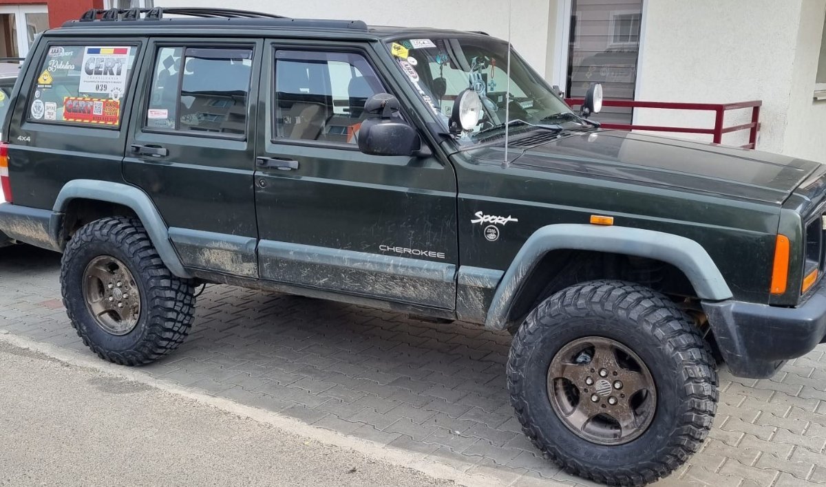

irinel_g Posted September 4, 2022 Share Posted September 4, 2022 (edited) De curand am achizitionat si eu un Cheerokee xj 2.5i 1998 si as vrea sa i cumpar printre altele anvelope pentru jantele de 15. Oare daca folosesc un kit de inaltare cu 5 cm (de genu: https://www.jeepmania.ro/kituri-inaltare-distantiere/Kit-Inaltare-5-cm-cu-distantiere-RUGGED-RIDGE-ORVpt-84-01-Jeep-Cherokee-XJ-3872.html) as putea sa folosesc anvelope BF GOODRICH All Terrain T-A KO 2 235/75 R15 ? Oare se merita deranjul cu inaltarea? De fapt pe mine m-ar interesa niste anvelope mai putin late dar mai inalte, dar nu prea gasesc. Edited September 4, 2022 by irinel_g Link to comment Share on other sites More sharing options...
irinel_g Posted September 4, 2022 Share Posted September 4, 2022 Adica as vrea sa arate ceva de genul https://www.theautopian.com/someone-is-offering-me-the-perfect-jeep-cherokee-xj-two-door-manual-but-i-dont-know-if-i-can-buy-it/ Link to comment Share on other sites More sharing options...
CatalinU Posted September 24, 2022 Share Posted September 24, 2022 Da, la inaltare de 5 cm incap si cauciucuri de 31. Asa am eu, azi am montata gumele Ever tried.Ever failed.Try again.Fail again.Fail better Link to comment Share on other sites More sharing options...
