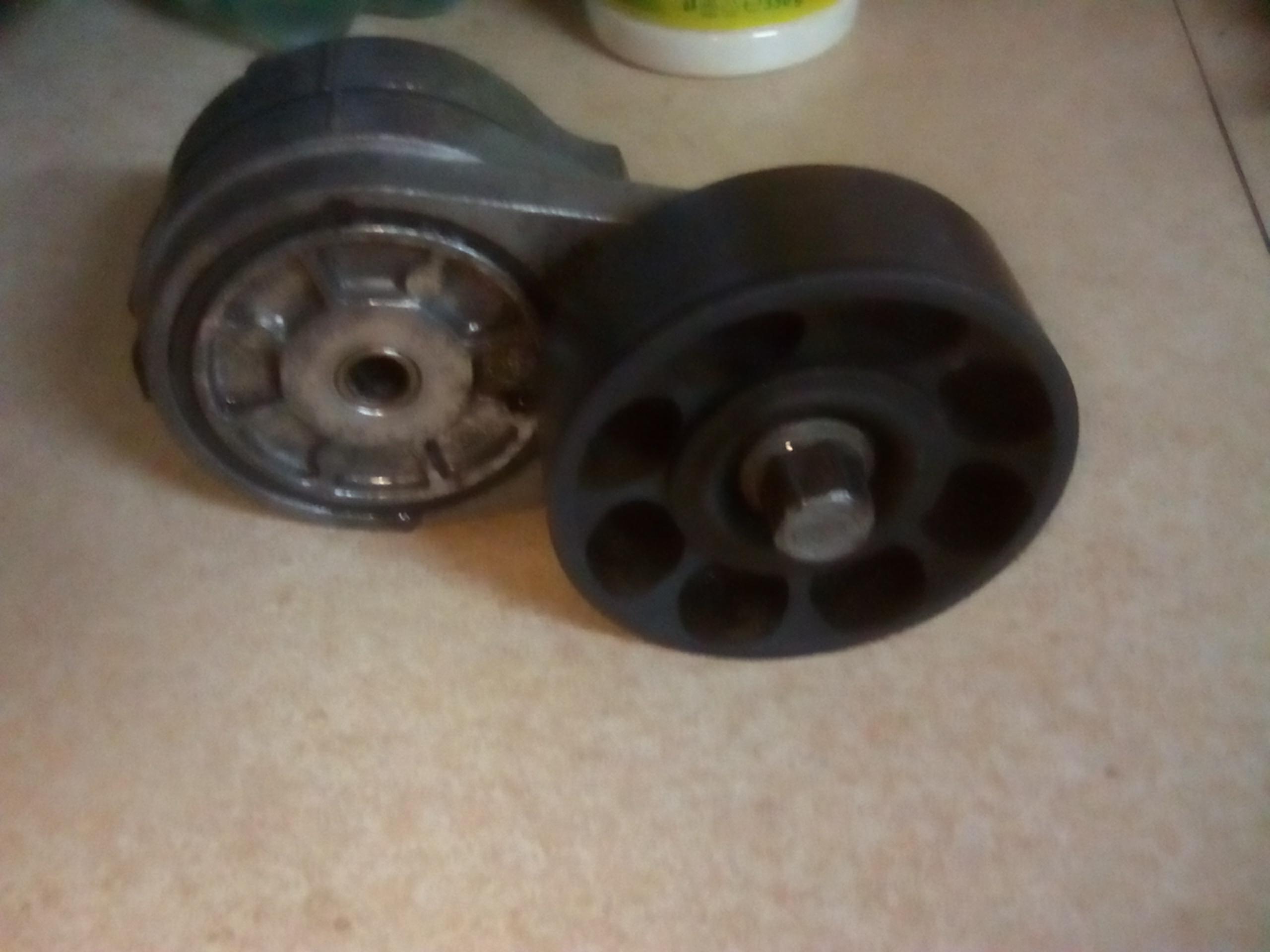

27836234_1452594821529763_1045849720_o.thumb.jpg.e5f390a5514720b27e5589563714fd2b.jpg

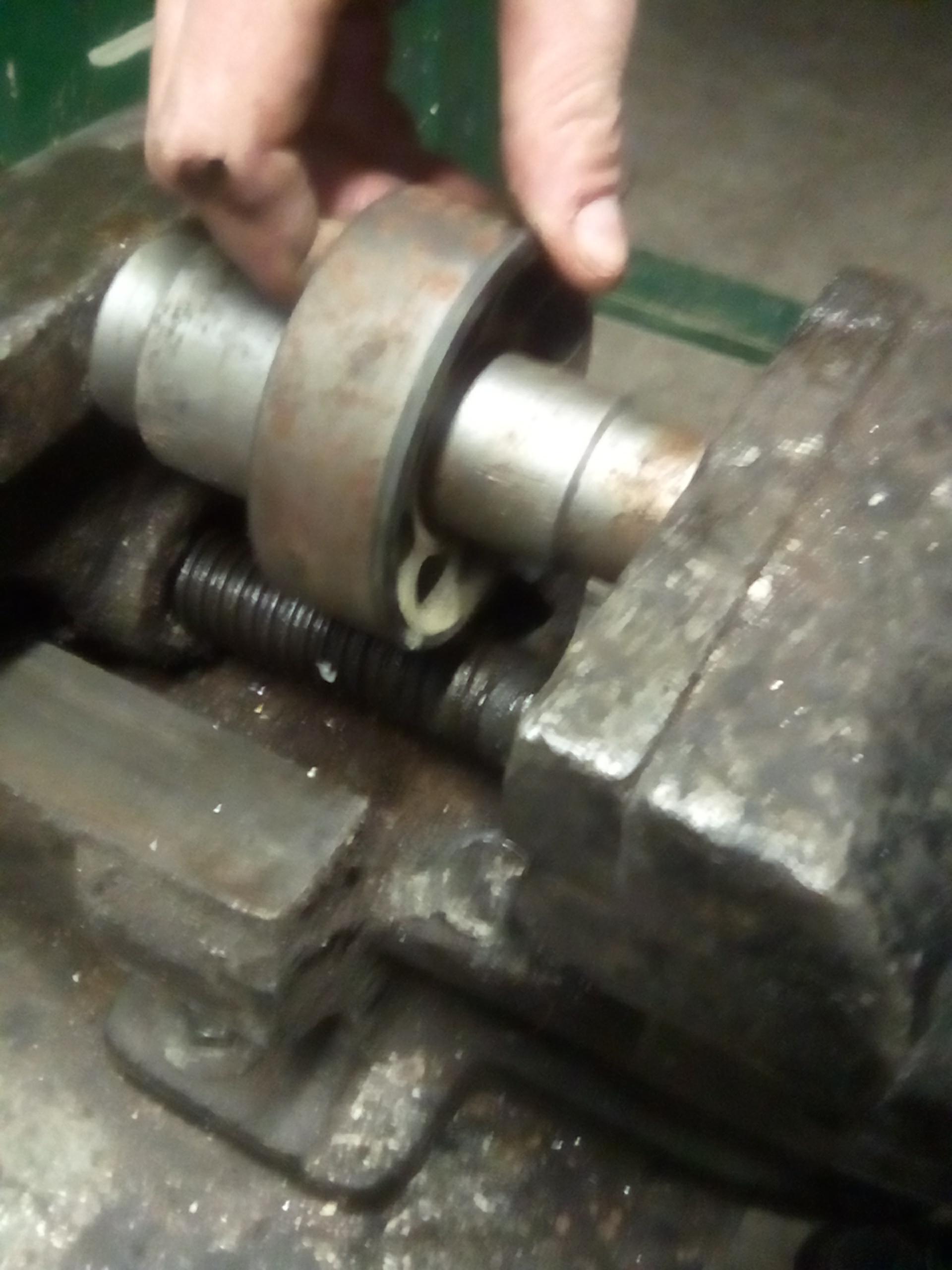

27835479_1452594811529764_659086226_o.thumb.jpg.0637ae05d3ed20aee1251847af81fd6b.jpg Desfacut surub rola (FILET INVERS!)

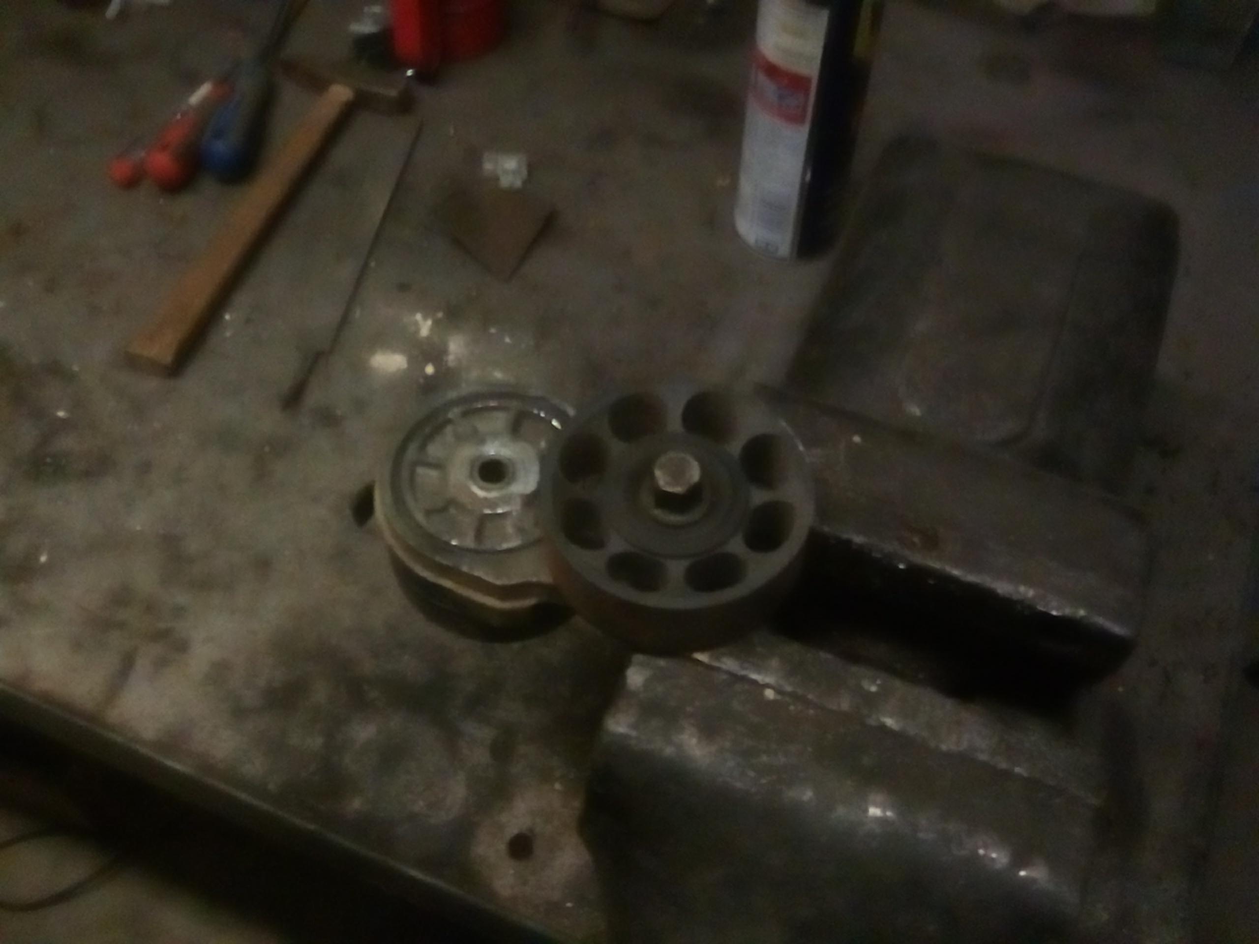

27907055_1452594751529770_2011910411_o.thumb.jpg.fcff9b69d8e06b1ea5f8967442610e79.jpg cu grija scos sicuranta de la rulment

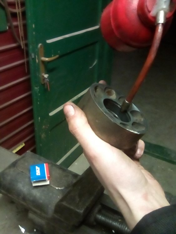

27901972_1452594721529773_2080521680_o.thumb.jpg.991ace7056246e2125217dd8d31f0e32.jpg o menghina, doua tubulare si eject rulmentul vechi ..

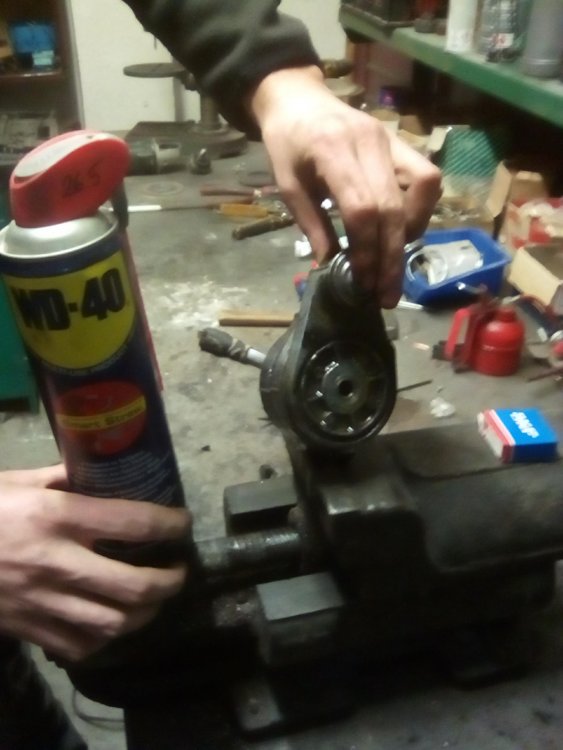

27835557_1452594604863118_191206363_o.thumb.jpg.1466935d2535a72666cd0c76c7cf637b.jpg pregatit rulment nou SKF cod : 6203-2RSH ( o cota foarte usor de gasit , diam int 17mm, diam ext 40 mm )

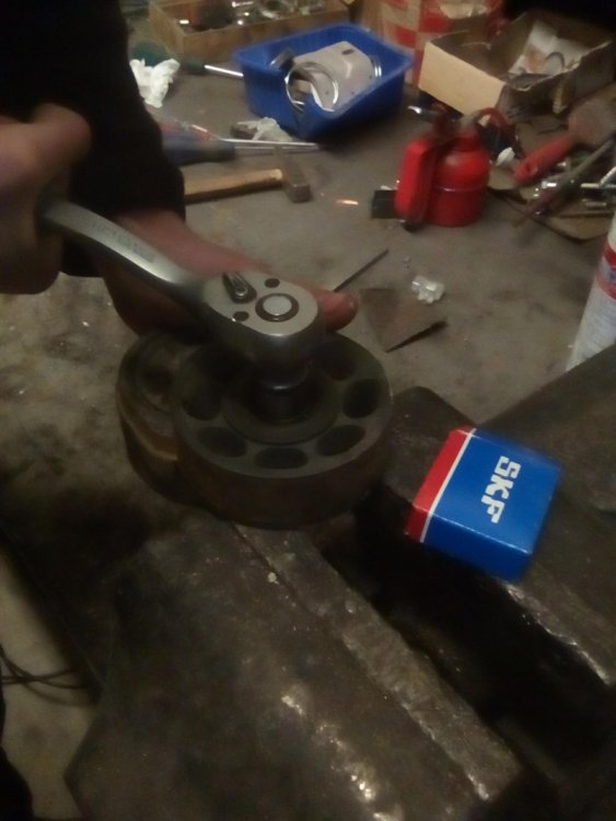

27846186_1452594654863113_1163166336_o.thumb.jpg.7b4f3863222be43c3ad4328782fafbc9.jpg
27901531_1452594588196453_61756043_o.thumb.jpg.f98aa80b159caba033f9f1afad15dee4.jpg putin probabil de a il baga stramb deoarece are canal , se centreaza singur, ii facut pentru a se schimba, stiu englezii de capu lor:dr2
27901358_1452594531529792_1581124327_o.thumb.jpg.c95c3552018d678af58770ee066c66b4.jpg Gata ! Treaba buna si o bere pe langa :x
