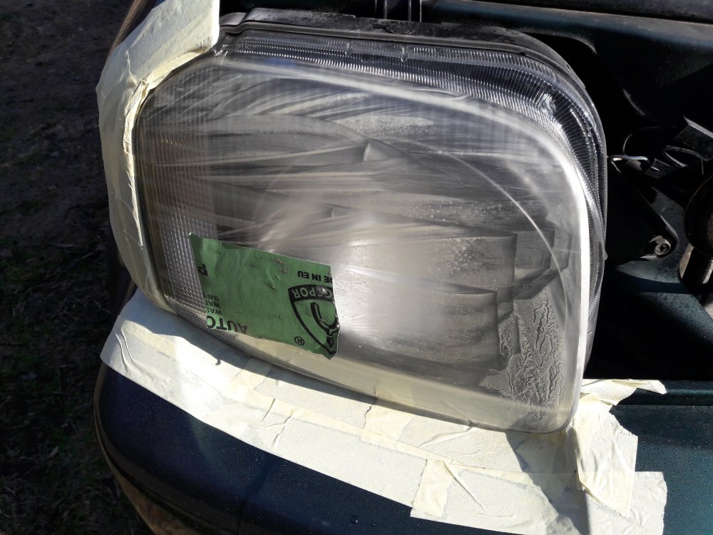

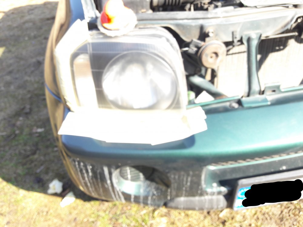

Aici va atasez si poza ca sa vedeti cum au iesit farurile inainte si dupa polish. 20190303_110440.thumb.jpg.d4726543047e916086f9ce085545450a.jpgpoza.thumb.jpg.18de586dcbd81b3bf11108726403c228.jpg20190303_110446.thumb.jpg.923f214442f7a1840a1d7fff8f7fd00a.jpg

20190303_124540.thumb.jpg.4666192594723d63ce5a454ce5f959e2.jpg20190303_125117.thumb.jpg.f898408435dbc41763f89832b8462342.jpgInked20190303_122939_LI.thumb.jpg.db542eebd79c044f25773007222549da.jpgInked20190303_124900_LI.thumb.jpg.8c5294d9d75a546cf519b0a4e097742f.jpgInked20190303_125030_LI.thumb.jpg.9be898abcb9c3665c894b1f322fd724b.jpgpoza.thumb.jpg.55825e12452cc521155b94bb02e33100.jpg
Asa arata farurile polishate scuze pentru ca ultima poza este prima inainte de slefuire farurile si celelalte sunt polisate produs final.
