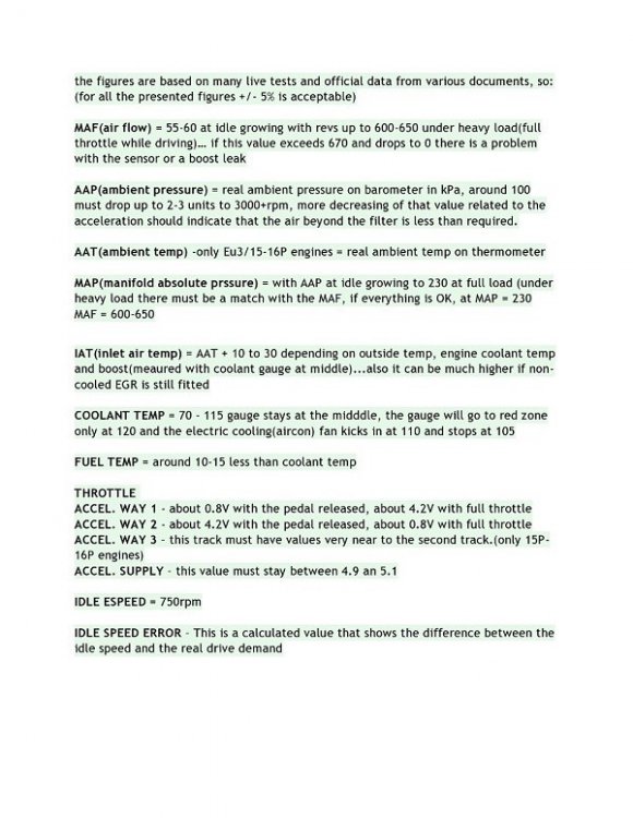

sierrafery Posted January 4, 2021 Share Posted January 4, 2021 Stergi tate erorile dn toate sistemele si citesti din nou dupa un drum ca multe pot fi istorice , despre date live am facut eu o sumarizare in engleza 1 NU RASPUND USERILOR CU PROFIL INCOMPLET LA MASINA(model, an, motor, transmisie), NU RASPUND PE PM LA PROBLEME TEHNICE SAU DE INTERES GENERAL Discovery Td5 ES , "00. manual, ECU tunat, intercooler marit...merge de rupe Link to comment Share on other sites More sharing options...
