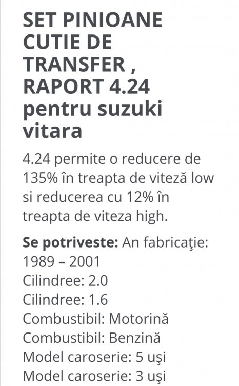

cmarin Posted September 9, 2021 Share Posted September 9, 2021 O varianta, la o simpla căutare pe net. Link to comment Share on other sites More sharing options...
