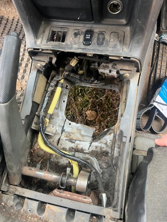

Masina cu superselect  si switch electronic la reductor
Orificiul cutiei din caroserie cu superselect

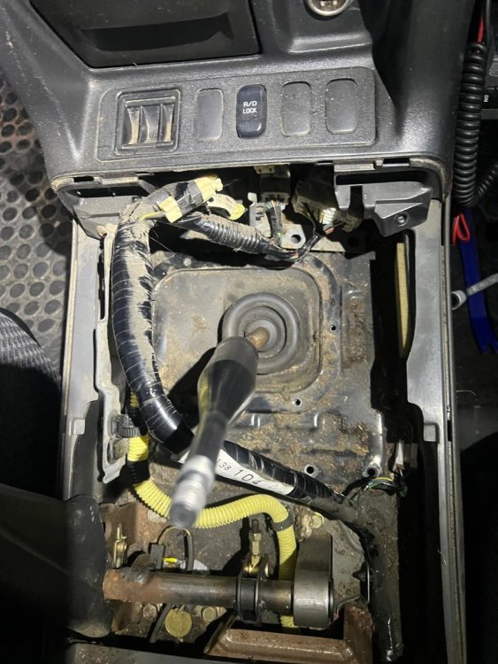

Orificiul cutie de la masina donatoare fara Super select
437471512_WhatsAppImage2025-02-03at15_18_54.thumb.jpeg.77f1d62bfdffa2bfc6a48491120c177f.jpeg

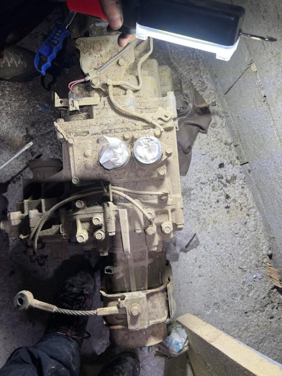

Cutia fara super select
1571119835_WhatsAppImage2025-02-03at15_18.54(2).thumb.jpeg.6b9df0c489965f4ec76b8f88263ed2ef.jpeg

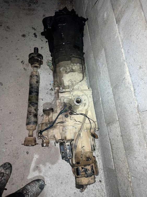

Cutia cu superselect ( se observa si diferenta de lungime, de aceea e nevoie si de alte cardane)
270482056_WhatsAppImage2025-02-03at15_18.54(6).thumb.jpeg.a48fb50e4a2bff0b8be7c9dc17291de0.jpeg

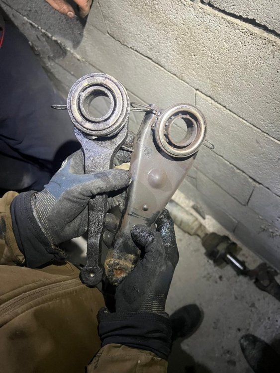

Diferenta intre furci si rulmenti
1076255189_WhatsAppImage2025-02-03at15_18.54(5).thumb.jpeg.0e84872aeb27ce7d4091aa8e03f0905d.jpeg
