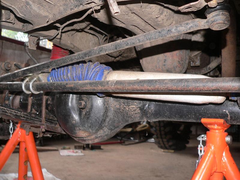

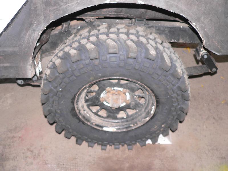

Cateva poze:
P1210801.thumb.jpg.670e6b2ddd1d7b91569655be269277b4.jpgP1210797.jpg.89b449bdbb0aa125abc29fc954575387.jpgP1210794.jpg.f6b111e928928d3208bb3a548c7abdd3.jpg
P1210798.jpg.cb98cf7a67707706cdc490545efe2152.jpgP1210799.jpg.a3d2cf1eaa640da524ffb5fc9c896a22.jpg

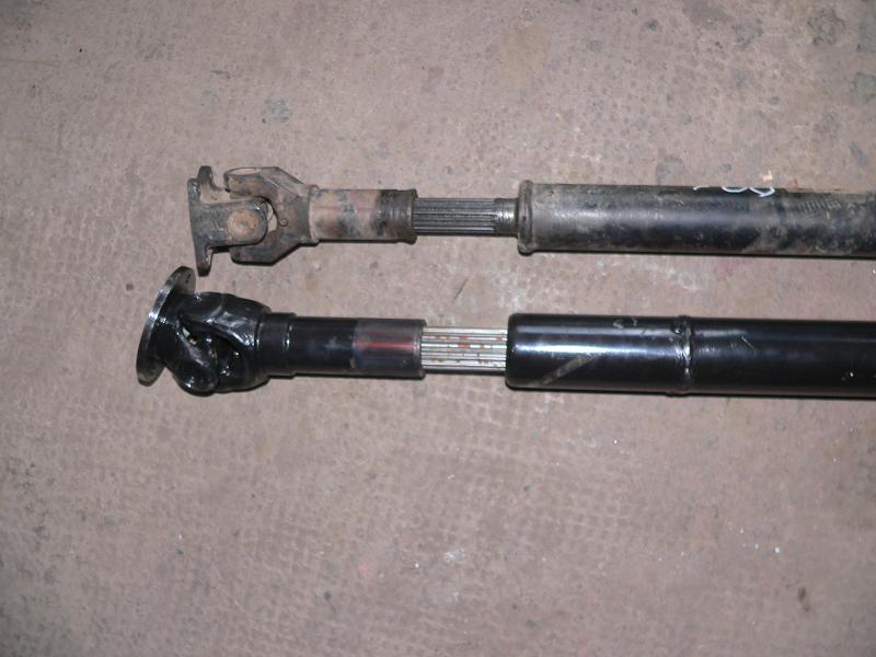

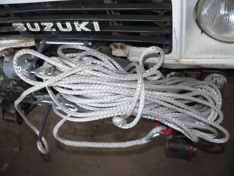

P1210800.jpg.28dea8c7cf3978cbfac2da0806dd9286.jpgP1210796.jpg.cda95497e340757f1e88ebc44c812b7e.jpgP1210795.jpg.0878397498c04e89326f265ac209d452.jpgP1210793.jpg.2caa6b62a36463960eb047a705a6d41f.jpg
Dupa cum se vede si in poze au aparut tot felul de piese si up-grade-uri printre care:
-telescop directie Calmini

-plasma rope (mersi adizuz)
-cauciucuri Silverstone 31/10.5/15 (raduok mersi)
-cardan HD plus 5 cm lungime la culisanta
-troliul este un come-up nou nefolosit
