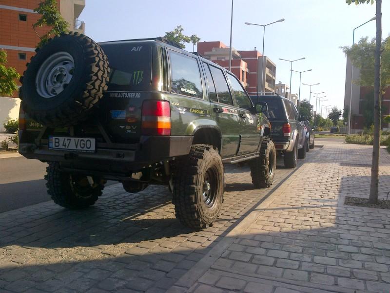

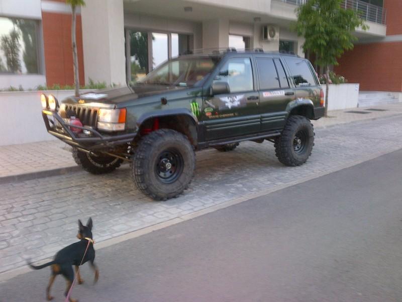

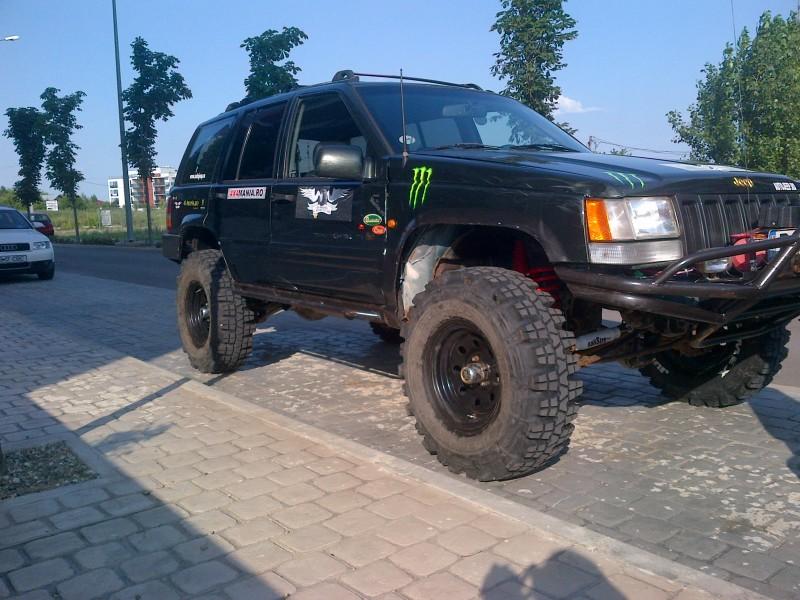

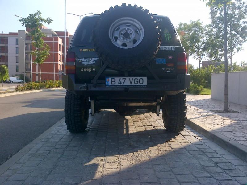

Asta este aspectul actual a masinei
1740450724_Bucure351ti-20120620-00179.jpg.f05ea8be7da34c874892d72e8c381f61.jpg1938985246_Bucure351ti-20120620-00180.jpg.43420f0ef2dd6afbeaa5e2e7d5f5730b.jpg1004505755_Bucure351ti-20120620-00181.jpg.f19063223cca11b8e5b03cbcbcfdb6e1.jpg348201368_Bucure351ti-20120620-00183.jpg.cc2ba5765795cc5bc1c3361bb8235ab2.jpg
