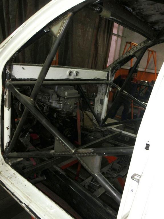

TaifunOffroad Postat Februarie 8, 2010 Autor Partajează Postat Februarie 8, 2010 (editat) Taifun T200 Am inceput lucrul la cockpit, sa fie si el in mintile lui… si la sasiu, unde am taiat toate prinderile care nu isi mai au rostul. http://i896.photobucket.com/albums/ac163/taifunoffroad2/taifun%20t200%20set4/P1130015.jpg http://i896.photobucket.com/albums/ac163/taifunoffroad2/taifun%20t200%20set4/P1140008.jpg http://i896.photobucket.com/albums/ac163/taifunoffroad2/taifun%20t200%20set4/P1140012.jpg http://i896.photobucket.com/albums/ac163/taifunoffroad2/taifun%20t200%20set4/P1150025.jpg http://i896.photobucket.com/albums/ac163/taifunoffroad2/taifun%20t200%20set4/P1150027.jpg http://i896.photobucket.com/albums/ac163/taifunoffroad2/taifun%20t200%20set4/Taifun200vederefata.jpg Editat Februarie 8, 2010 de TaifunOffroad www.taifunoffroad.ro www.teamdakarromania.ro Link spre comentariu Distribuie pe alte site-uri Alte opțiuni partajare...

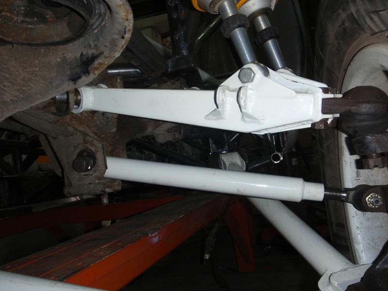

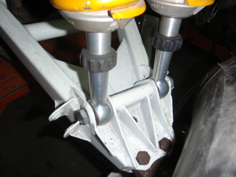

TaifunOffroad Postat Februarie 9, 2010 Autor Partajează Postat Februarie 9, 2010 Taifun T200 Prinderile de bascule de fata, pt unghiul de Caster aferent. http://i896.photobucket.com/albums/ac163/taifunoffroad2/taifun%20t200%20set5/P1140015.jpg http://i896.photobucket.com/albums/ac163/taifunoffroad2/taifun%20t200%20set5/P1150026.jpg http://i896.photobucket.com/albums/ac163/taifunoffroad2/taifun%20t200%20set5/P1150030.jpg http://i896.photobucket.com/albums/ac163/taifunoffroad2/taifun%20t200%20set5/P1180033.jpg http://i896.photobucket.com/albums/ac163/taifunoffroad2/taifun%20t200%20set5/P1180036.jpg http://i896.photobucket.com/albums/ac163/taifunoffroad2/taifun%20t200%20set5/P1180038.jpg http://i896.photobucket.com/albums/ac163/taifunoffroad2/taifun%20t200%20set5/P1180039.jpg http://i896.photobucket.com/albums/ac163/taifunoffroad2/taifun%20t200%20set5/Taifun200suspindepspateprinderi.jpg www.taifunoffroad.ro www.teamdakarromania.ro Link spre comentariu Distribuie pe alte site-uri Alte opțiuni partajare...

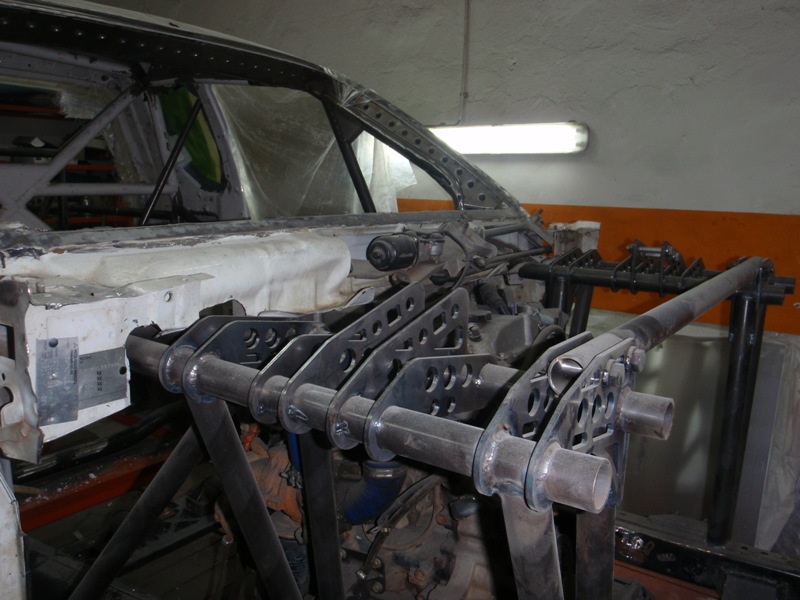

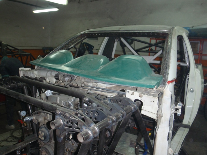

TaifunOffroad Postat Februarie 16, 2010 Autor Partajează Postat Februarie 16, 2010 Taifun T200 Am construit suportii pt motor si cutie. Suportii de cutie sunt facuti astfel incat sa se poata monta cutie manuala si secventiala. (caci FIA taman ce a schimbat regulamentul pt T1, anume nu se stie cat timp se mai poate concura cu o cutie secventiala…). Motorul si cutia sunt mult retrase, pt echilibrarea maselor, pastrand in acelasi timp cele 6 grade, cum vine el montat pe Pajero. BTW: traversa de la cutie este cel mai misto acaret facut de noi pana acum;-) Parerea noastra!;-) http://i800.photobucket.com/albums/yy282/taifunoffroad3/Taifun%20T200%20set%207/100_5090.jpg http://i800.photobucket.com/albums/yy282/taifunoffroad3/Taifun%20T200%20set%207/100_5092.jpg http://i800.photobucket.com/albums/yy282/taifunoffroad3/Taifun%20T200%20set%207/100_5093.jpg http://i800.photobucket.com/albums/yy282/taifunoffroad3/Taifun%20T200%20set%207/100_5094.jpg http://i800.photobucket.com/albums/yy282/taifunoffroad3/Taifun%20T200%20set%207/100_5095.jpg http://i800.photobucket.com/albums/yy282/taifunoffroad3/Taifun%20T200%20set%207/100_5096.jpg www.taifunoffroad.ro www.teamdakarromania.ro Link spre comentariu Distribuie pe alte site-uri Alte opțiuni partajare...

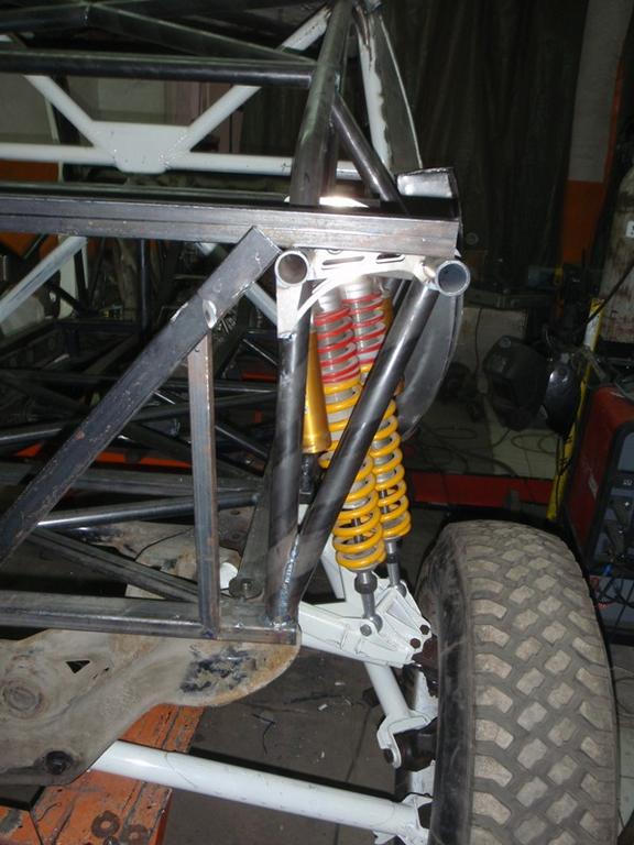

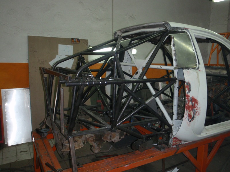

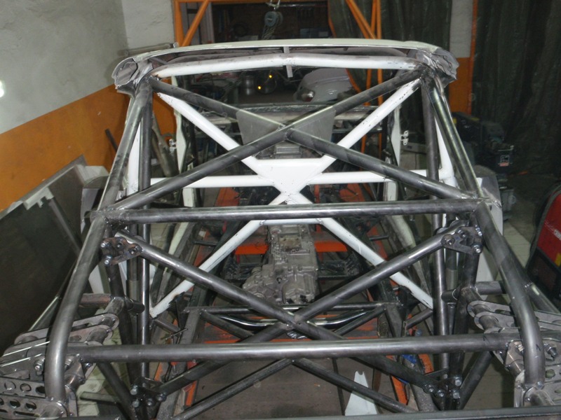

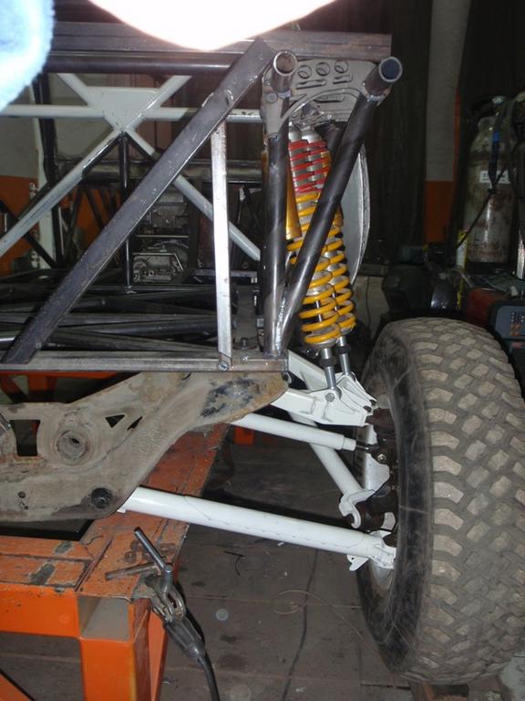

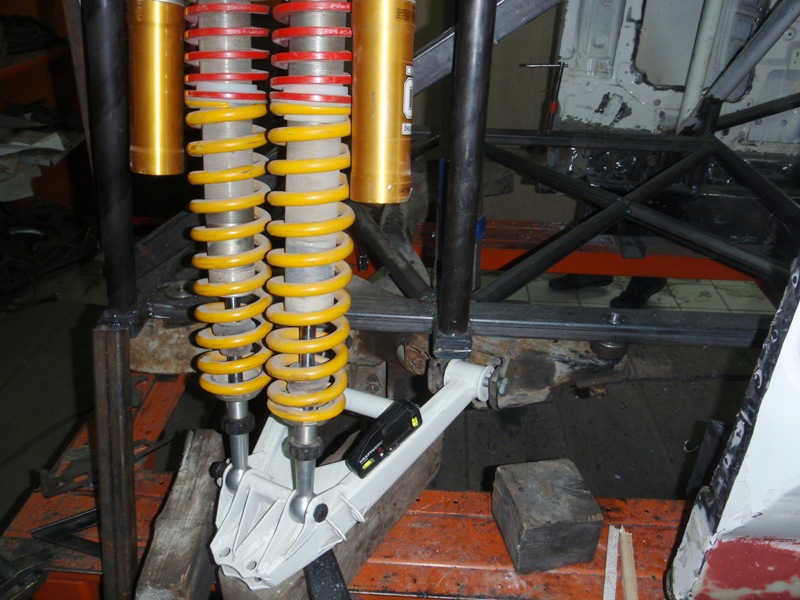

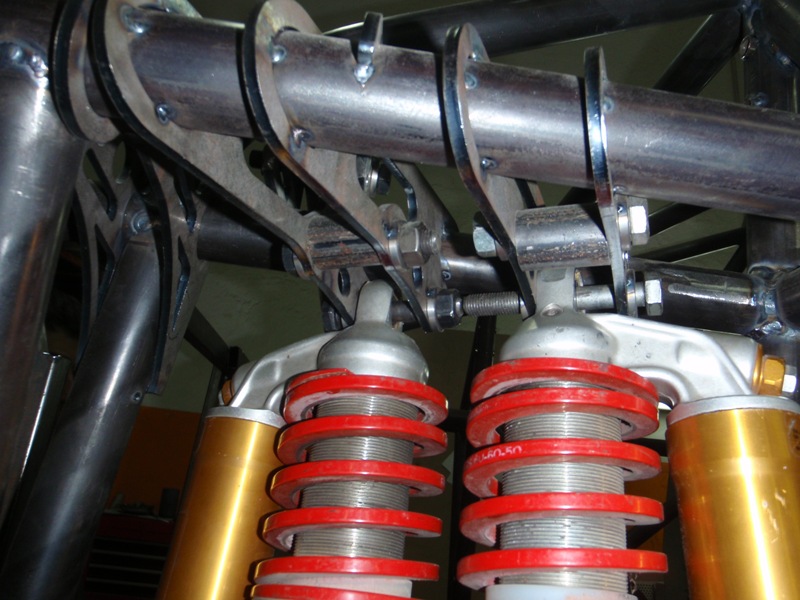

TaifunOffroad Postat Februarie 19, 2010 Autor Partajează Postat Februarie 19, 2010 Taifun T200 Am cam terminat partea de fata, cu prinderile de amortizoare, rigidizari, etc. Si am modificat si roll-cage-ul, din doua pozitii: una, ca sa corespunda cu ultimul regulament FIA pt T1, 2010 si doi, ca sa nu pierdem inutil spatiu. Asa cum era facut ne ducea cu rezervorul si cu rotile de rezerva cu vreo 270 mm mai in spate, aiurea. Traiti, spor, http://i800.photobucket.com/albums/yy282/taifunoffroad3/Taifun%20T200%20set%208/Taifun200set802.jpg http://i800.photobucket.com/albums/yy282/taifunoffroad3/Taifun%20T200%20set%208/Taifun200set803.jpg http://i800.photobucket.com/albums/yy282/taifunoffroad3/Taifun%20T200%20set%208/Taifun200set804.jpg http://i800.photobucket.com/albums/yy282/taifunoffroad3/Taifun%20T200%20set%208/Taifun200set805.jpg http://i800.photobucket.com/albums/yy282/taifunoffroad3/Taifun%20T200%20set%208/Taifun200set806.jpg www.taifunoffroad.ro www.teamdakarromania.ro Link spre comentariu Distribuie pe alte site-uri Alte opțiuni partajare...

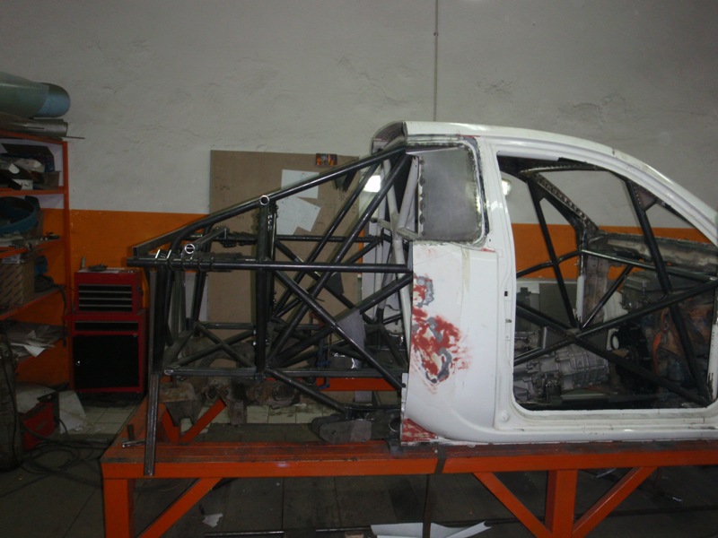

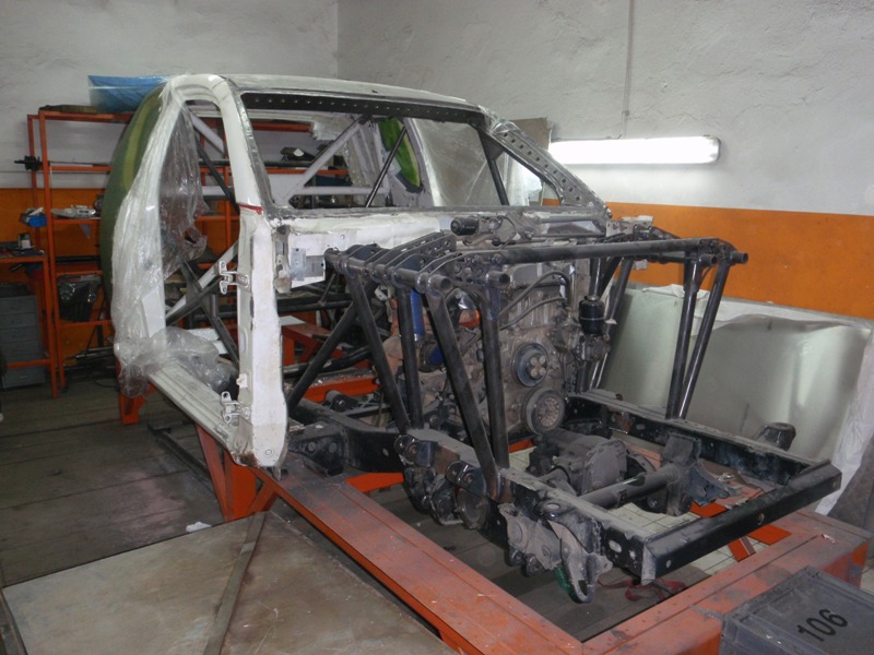

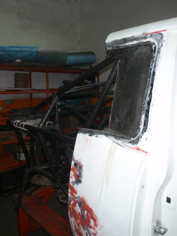

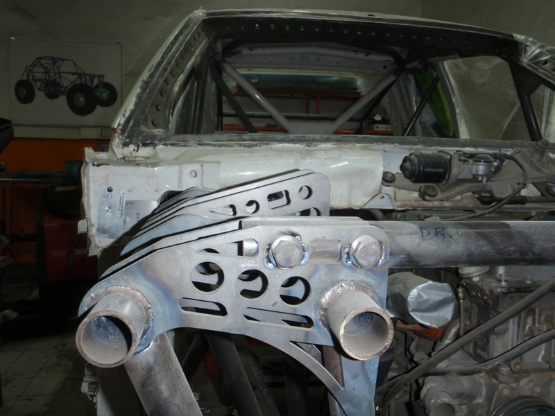

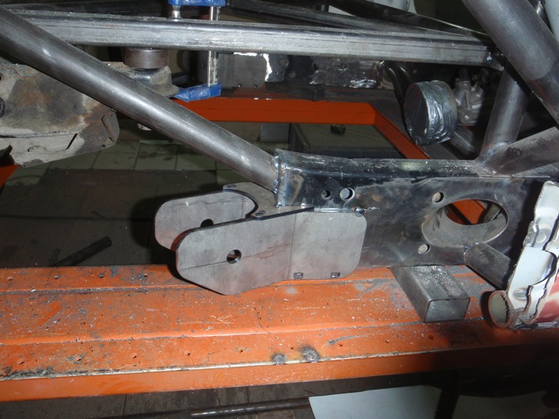

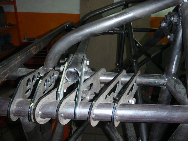

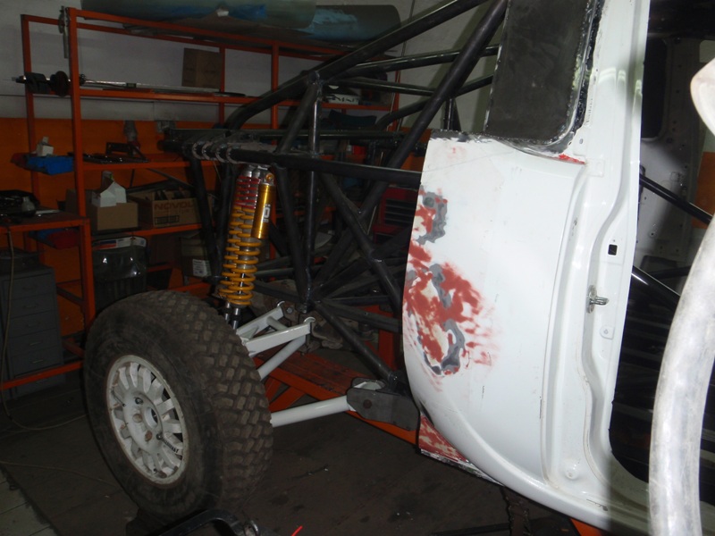

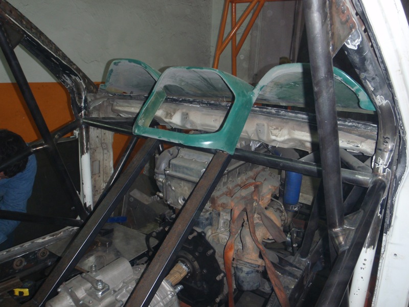

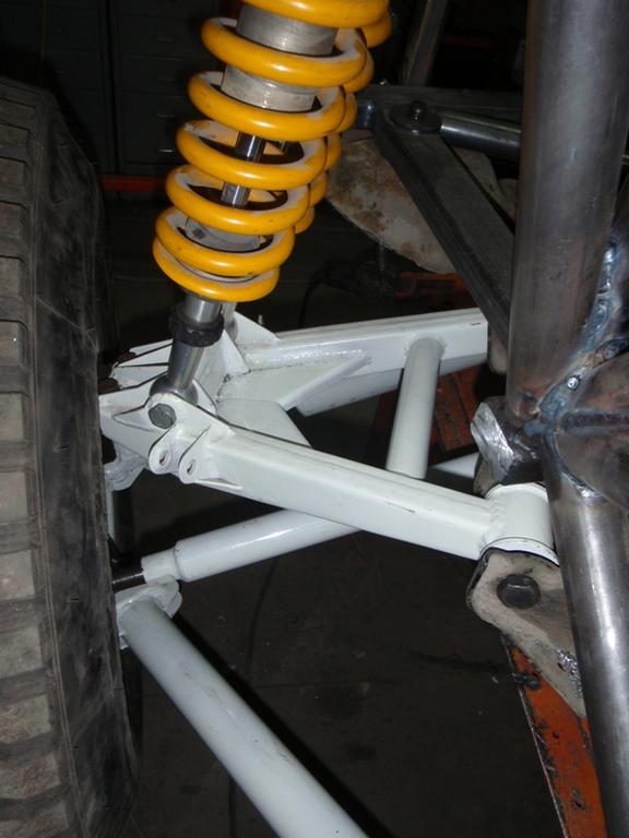

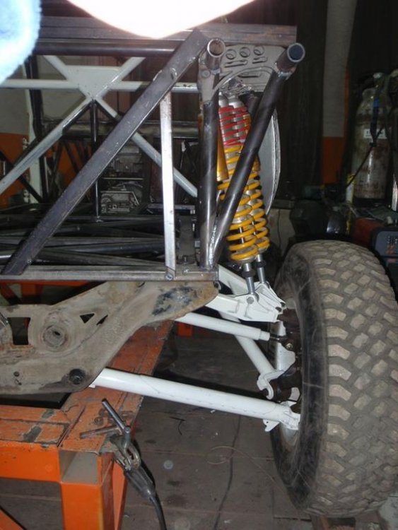

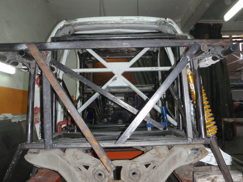

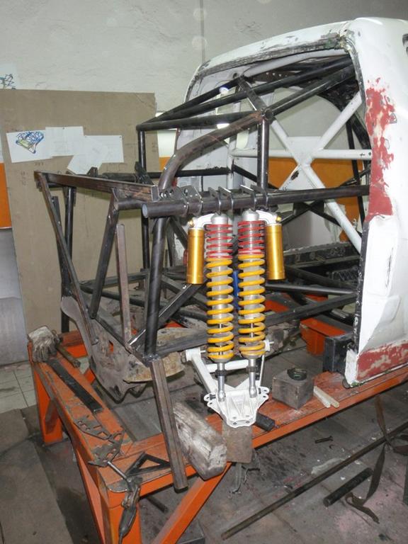

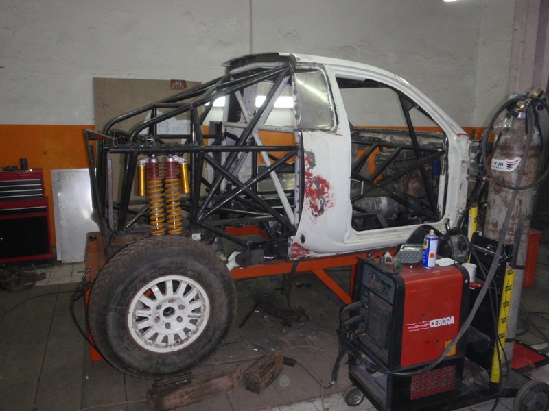

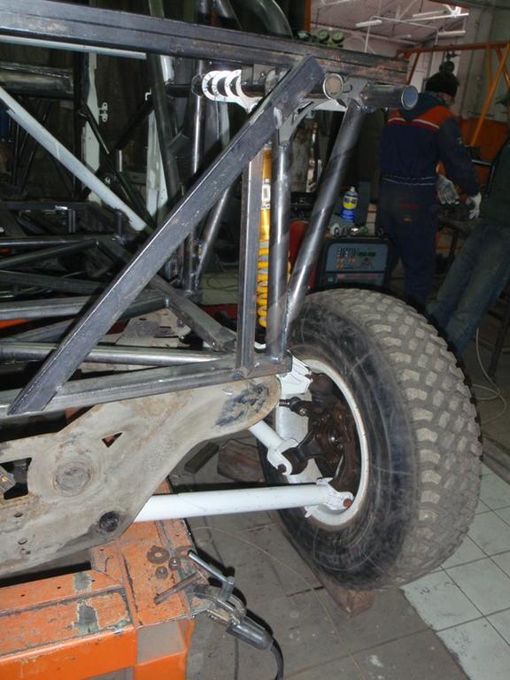

TaifunOffroad Postat Aprilie 9, 2011 Autor Partajează Postat Aprilie 9, 2011 Re: Taifun T200 Dupa o lunga pauza revenim in actiune. A trecut ceva vreme de cand nu ne-am mai ocupat de T200. Am fost prinsi cu alte proiecte. Dar de 2 saptamani ne-am concentrat din nou atentia lui. Acum ii spunem Taifun Mitsubishi L200 FIA T1.2. Uite si ultimele poze: www.taifunoffroad.ro www.teamdakarromania.ro Link spre comentariu Distribuie pe alte site-uri Alte opțiuni partajare...

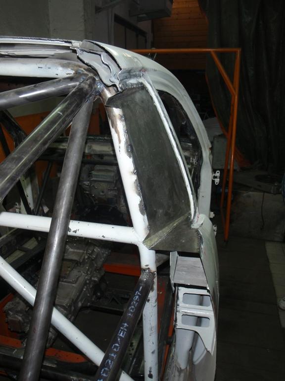

TaifunOffroad Postat Aprilie 9, 2011 Autor Partajează Postat Aprilie 9, 2011 Re: Taifun T200 alte poze, poze, poze www.taifunoffroad.ro www.teamdakarromania.ro Link spre comentariu Distribuie pe alte site-uri Alte opțiuni partajare...

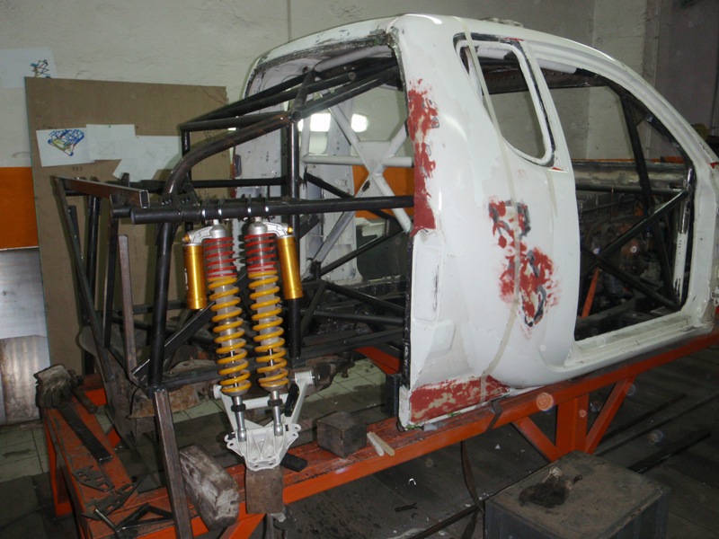

TaifunOffroad Postat Aprilie 9, 2011 Autor Partajează Postat Aprilie 9, 2011 Re: Taifun T200 si iar poze, poze, poze www.taifunoffroad.ro www.teamdakarromania.ro Link spre comentariu Distribuie pe alte site-uri Alte opțiuni partajare...

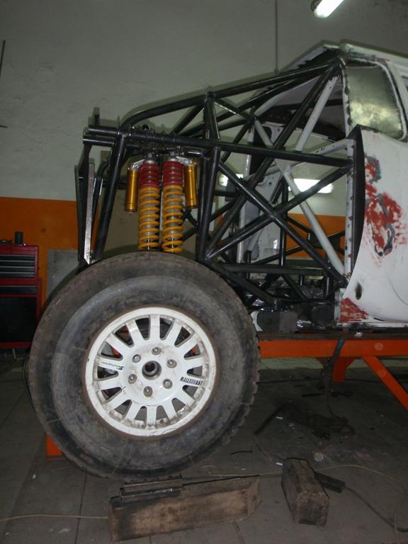

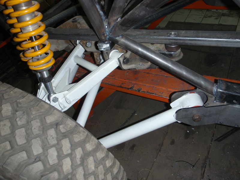

TaifunOffroad Postat Aprilie 9, 2011 Autor Partajează Postat Aprilie 9, 2011 Re: Taifun T200 si ultimele pe ziua asta. Promit! www.taifunoffroad.ro www.teamdakarromania.ro Link spre comentariu Distribuie pe alte site-uri Alte opțiuni partajare...
