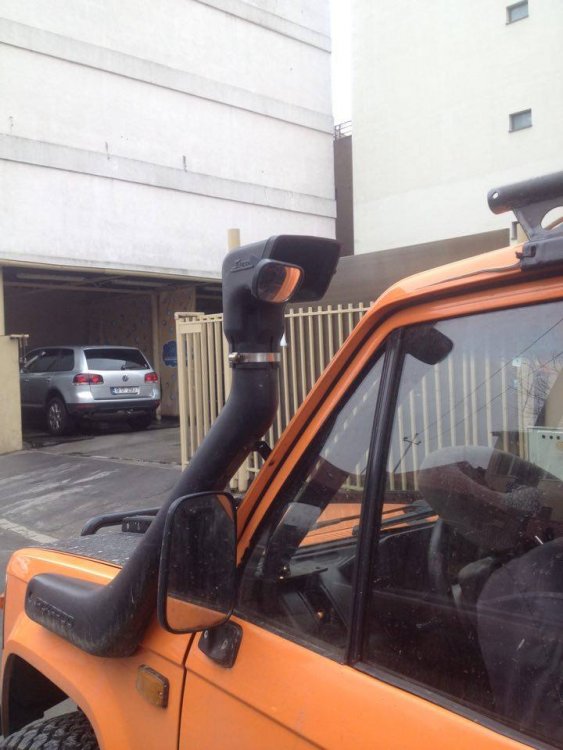

nessum Posted March 12, 2016 Share Posted March 12, 2016 Re: Intrebari generale snorkel Azi prin Bucuresti pe un Isuzu. :wtf1: Toyota LJ 70 Transsylvania Off Road Club www.helpdani.eu Link to comment Share on other sites More sharing options...
