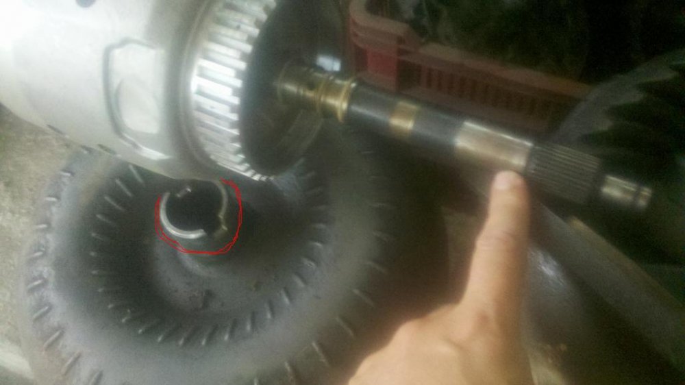

nissan4x4 Posted August 21, 2012 Share Posted August 21, 2012 Re: cutie automata Banuiesc ca ceea ce ai schimbat dumneata e simeringul ce lucreaza pe aceasta zona, vezi foto ing. Luigi PIRSU www.nissan4x4.ro service si tunning NISSAN Facebook PAGE: NISSAN4x4 SERVICE Link to comment Share on other sites More sharing options...

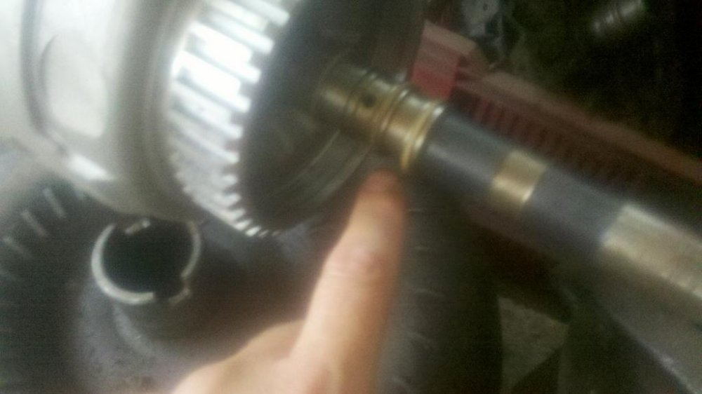

nissan4x4 Posted August 21, 2012 Share Posted August 21, 2012 Re: cutie automata etansarea de presiune se face prin intermediul oringurilor de teflon, vezi foto ing. Luigi PIRSU www.nissan4x4.ro service si tunning NISSAN Facebook PAGE: NISSAN4x4 SERVICE Link to comment Share on other sites More sharing options...

nissan4x4 Posted August 21, 2012 Share Posted August 21, 2012 (edited) Re: cutie automata Da, oringurile de teflon sunt SCHIMBABILE. PS daca te uiti atent, o sa vezi ca simeringul plasat in interiorul convertorului (marcat cu cercul rosu) lucreaza pe zona de ax indicata de mine. E un simplu simering de praf. Edited August 21, 2012 by nissan4x4 ing. Luigi PIRSU www.nissan4x4.ro service si tunning NISSAN Facebook PAGE: NISSAN4x4 SERVICE Link to comment Share on other sites More sharing options...
