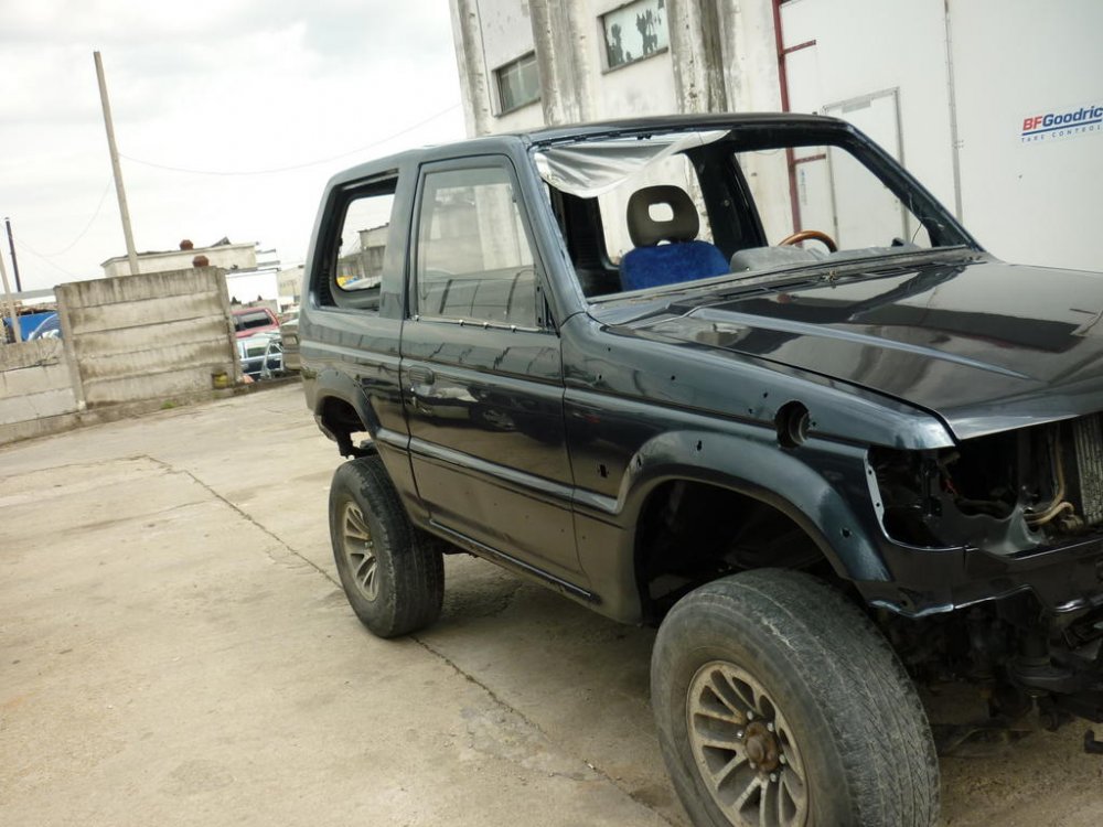

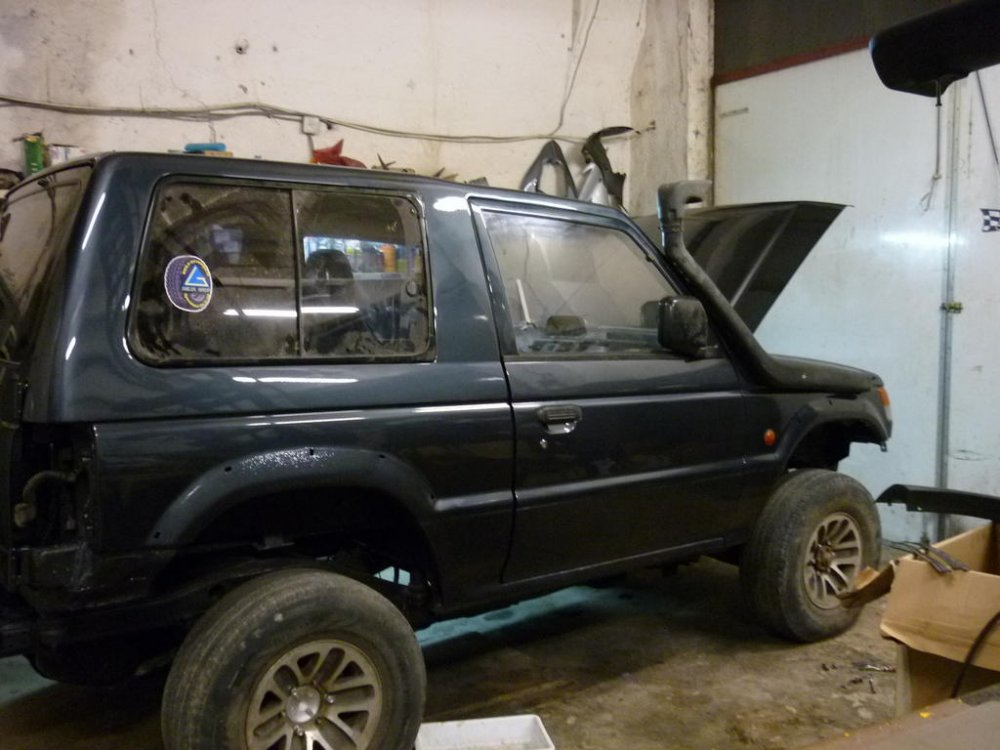

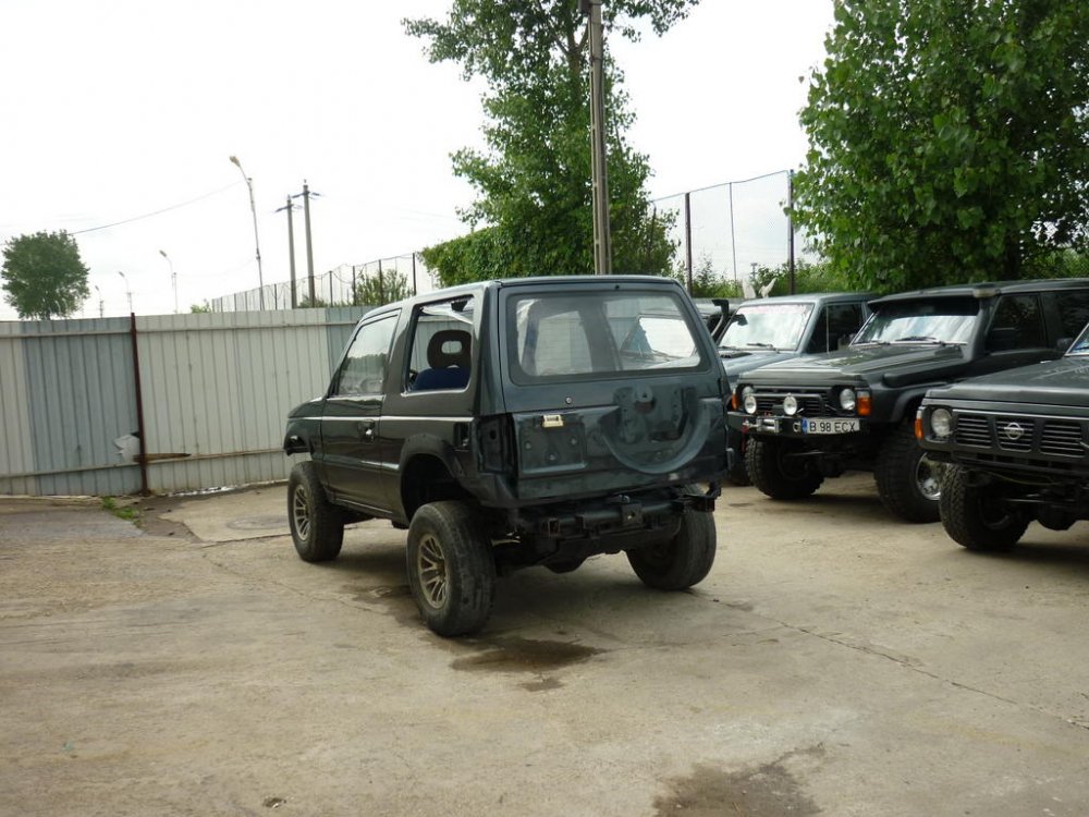

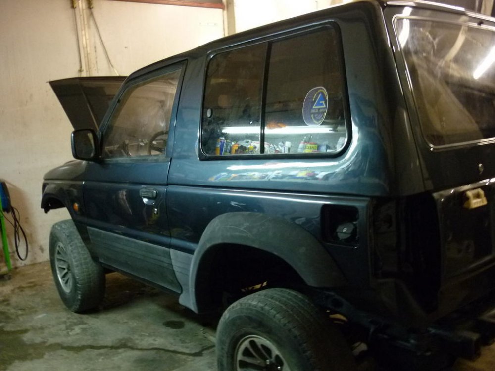

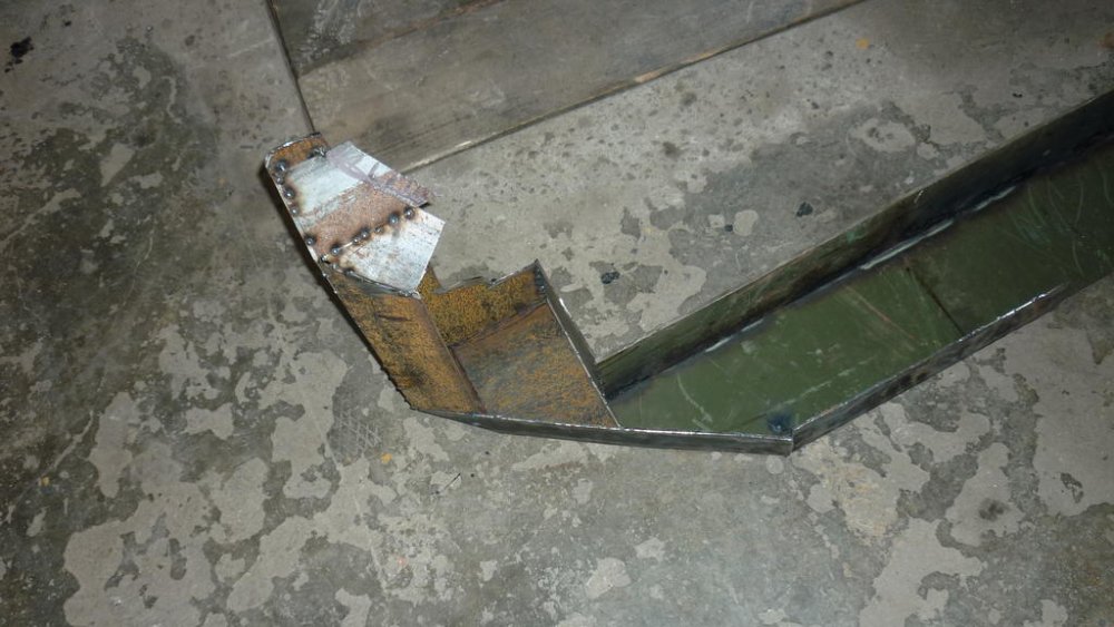

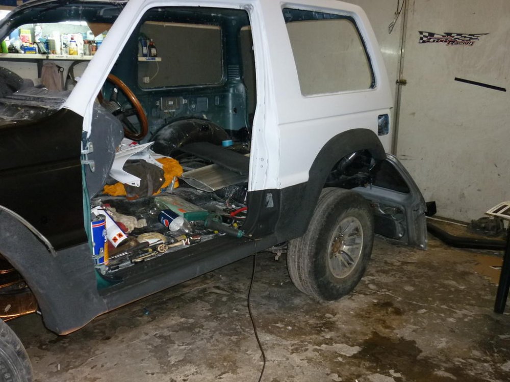

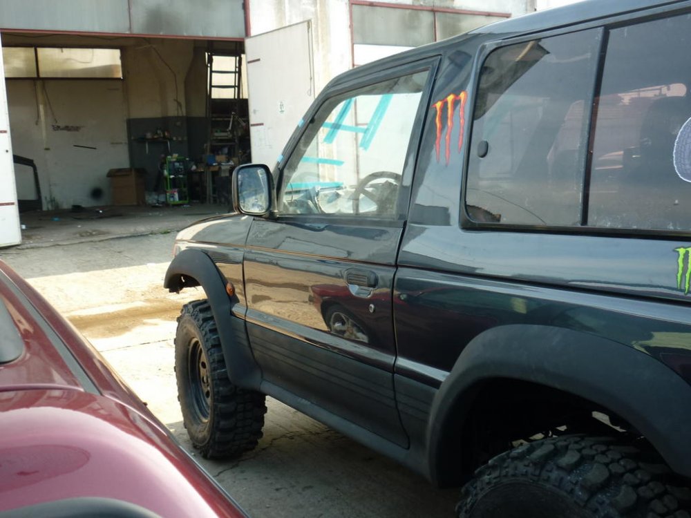

liviuoff Posted April 30, 2012 Author Share Posted April 30, 2012 Re: pajero scurt 3000 v6 12v an 93 cam asta am facut azi cu cele doua maini stangi montate invers la garaj astep cu nerabdare sa o termin sa vedem ce o iesi :ha: KAMIKAZE Off Road Team Link to comment Share on other sites More sharing options...
Astral Posted April 30, 2012 Share Posted April 30, 2012 Re: pajero scurt 3000 v6 12v an 93 cam asta am facut azi cu cele doua maini stangi montate invers la garaj astep cu nerabdare sa o termin sa vedem ce o iesi :ha: Da, e clar, de la palaria asta ti se trage harnicia ! :ha: REGULAMENT FORUM CLUB 4X4 Rescue 4x4 & MyTrip Link to comment Share on other sites More sharing options...

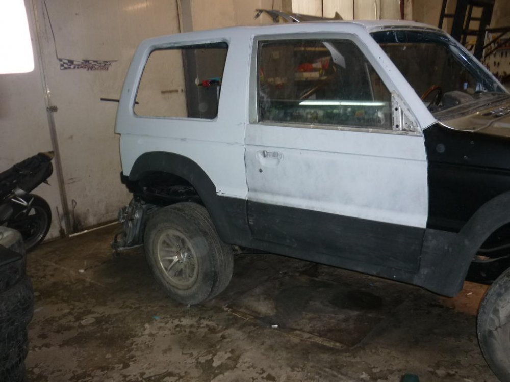

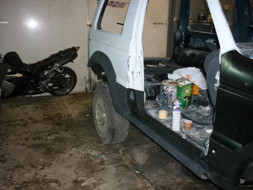

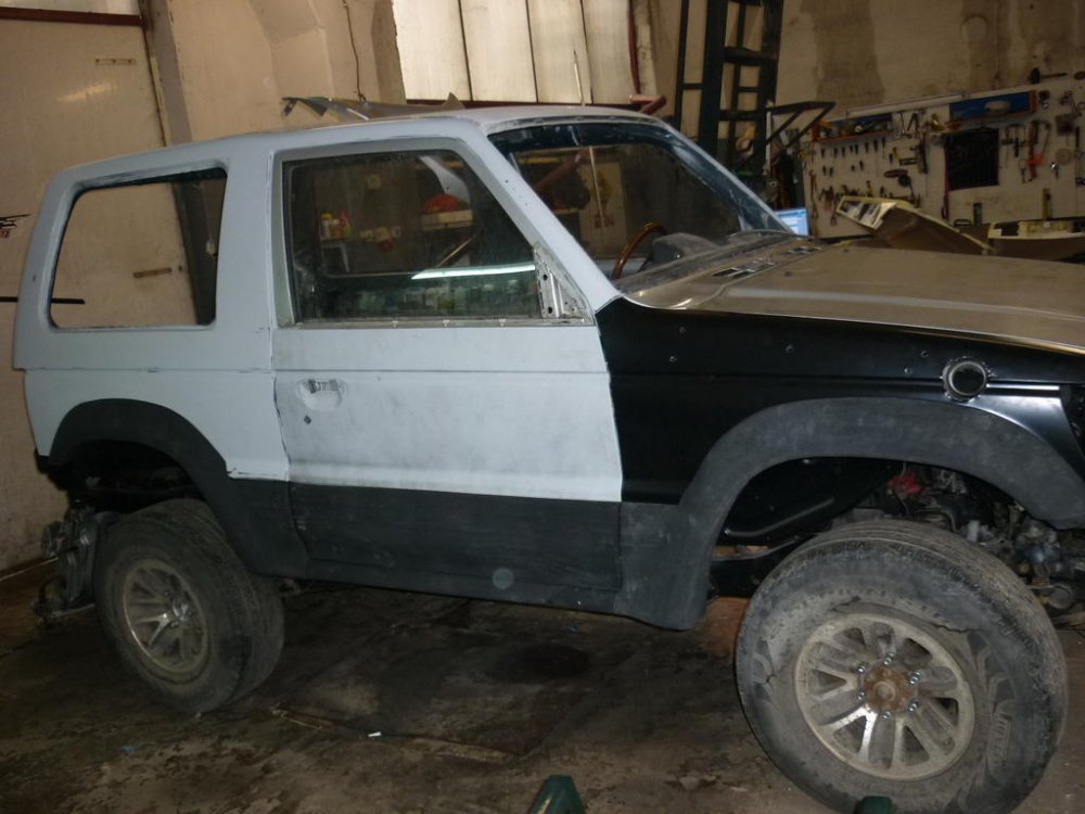

liviuoff Posted May 7, 2012 Author Share Posted May 7, 2012 (edited) Re: pajero scurt 3000 v6 12v an 93 hehe masina vineri noapte a primit 6 maini de fiuler:ha: Edited May 7, 2012 by liviuoff KAMIKAZE Off Road Team Link to comment Share on other sites More sharing options...

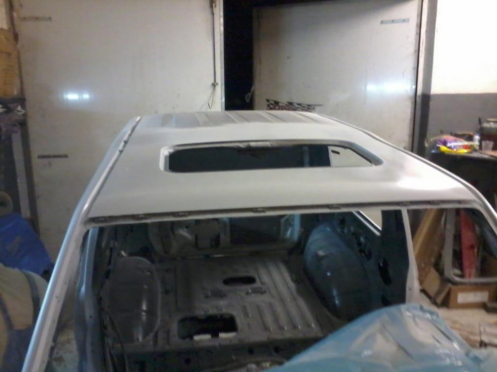

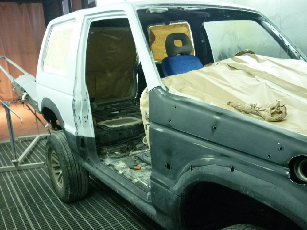

liviuoff Posted May 7, 2012 Author Share Posted May 7, 2012 Re: pajero scurt 3000 v6 12v an 93 [ATTACH=CONFIG]139487[/ATTACH] sper sa o vopsesc pana vineri :al KAMIKAZE Off Road Team Link to comment Share on other sites More sharing options...
jighi Posted May 7, 2012 Share Posted May 7, 2012 Re: pajero scurt 3000 v6 12v an 93 acuma daca i dai km la zero poti sa o vinzi ka nouo...:ha:..top zustang... pregatim masina ta pentru off road www.modificarioffroad.ro modificarioffroad@yahoo.com dezmembrari pajero mk2. 0730678039 Link to comment Share on other sites More sharing options...

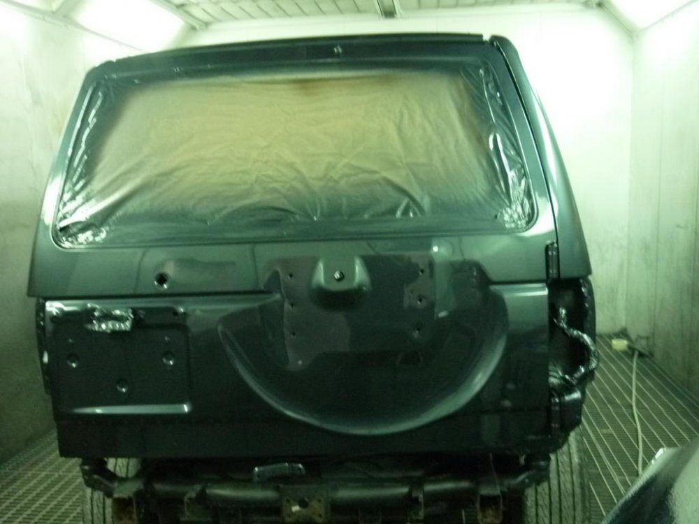

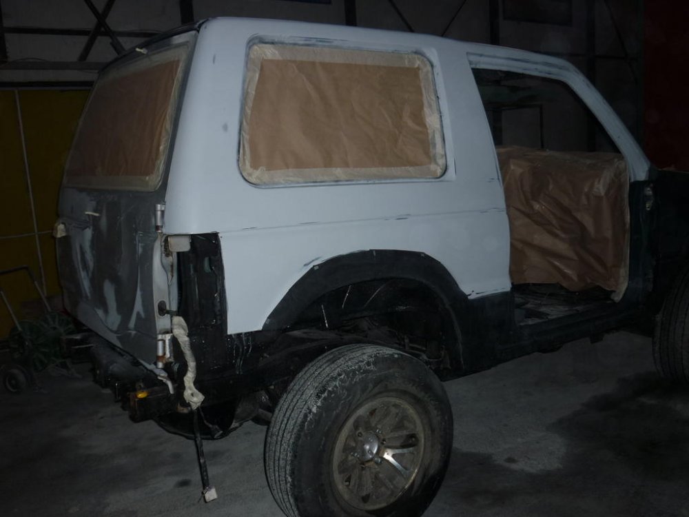

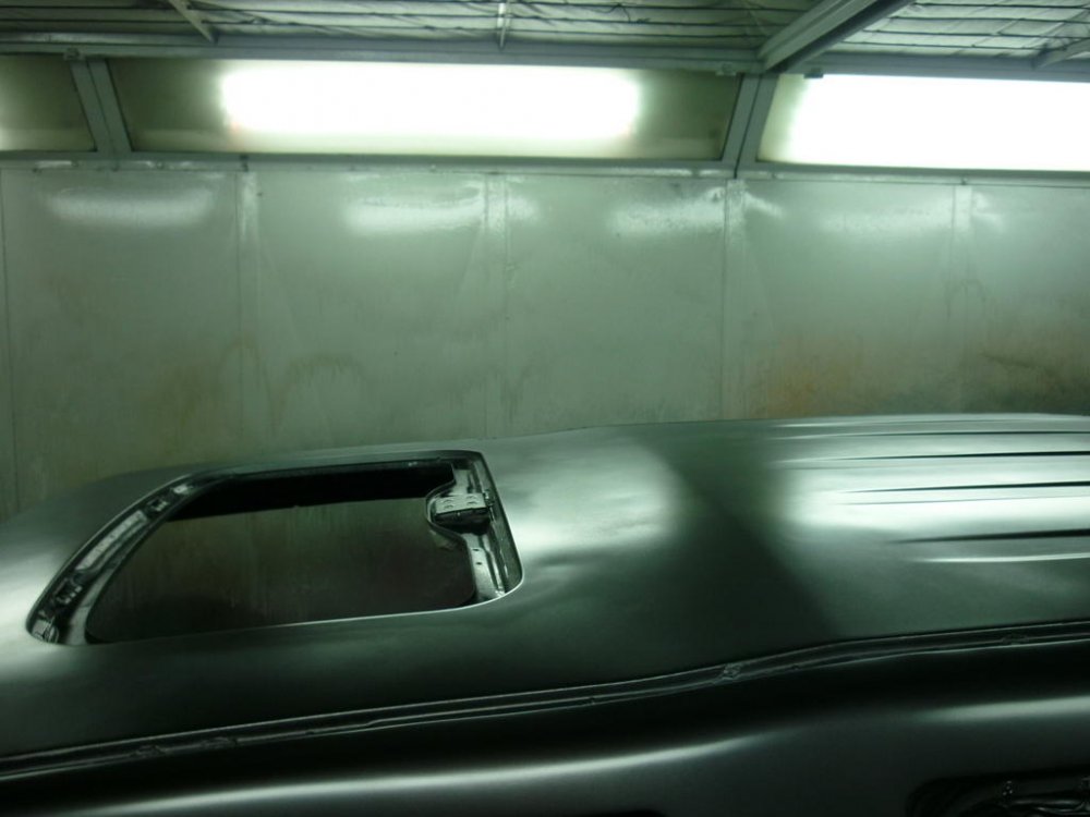

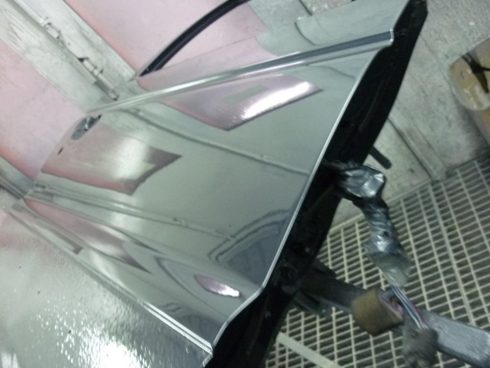

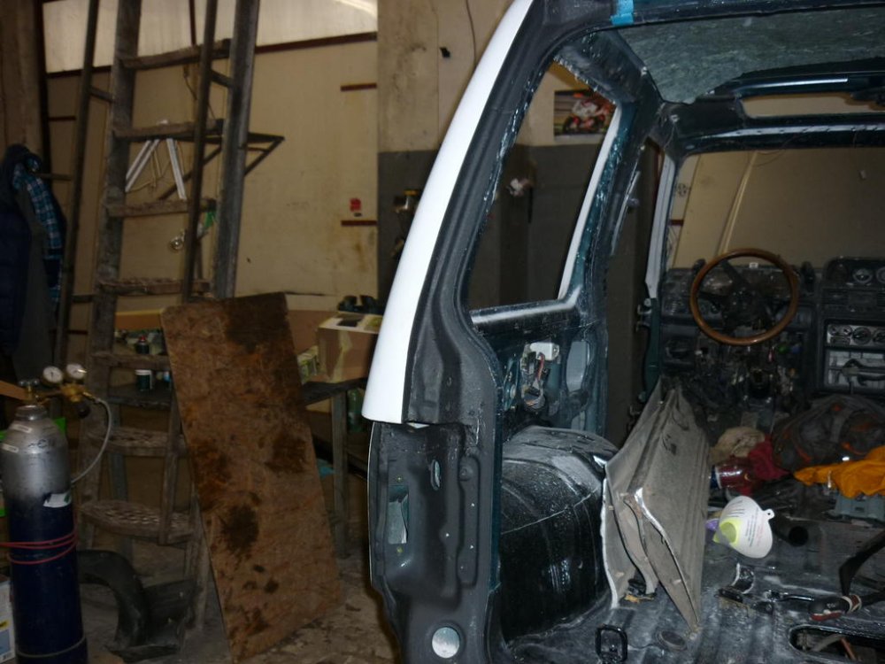

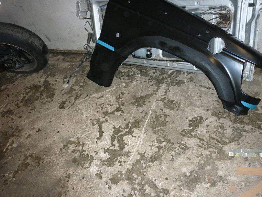

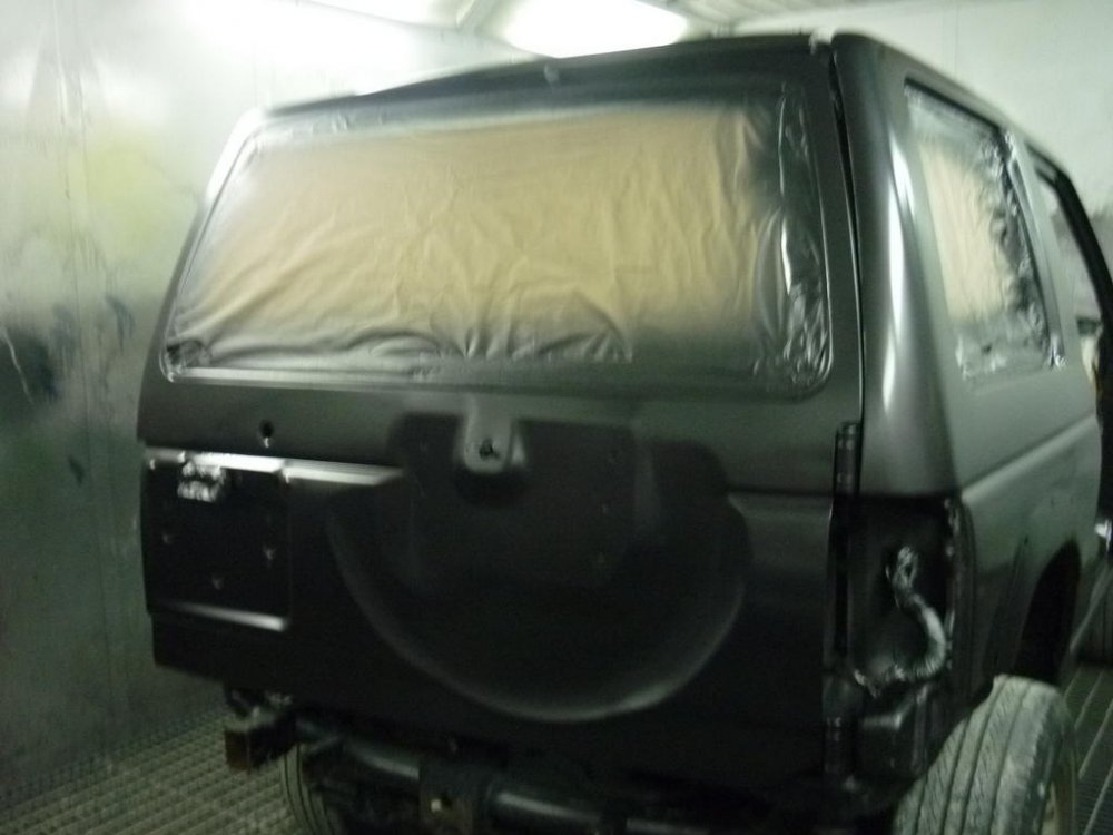

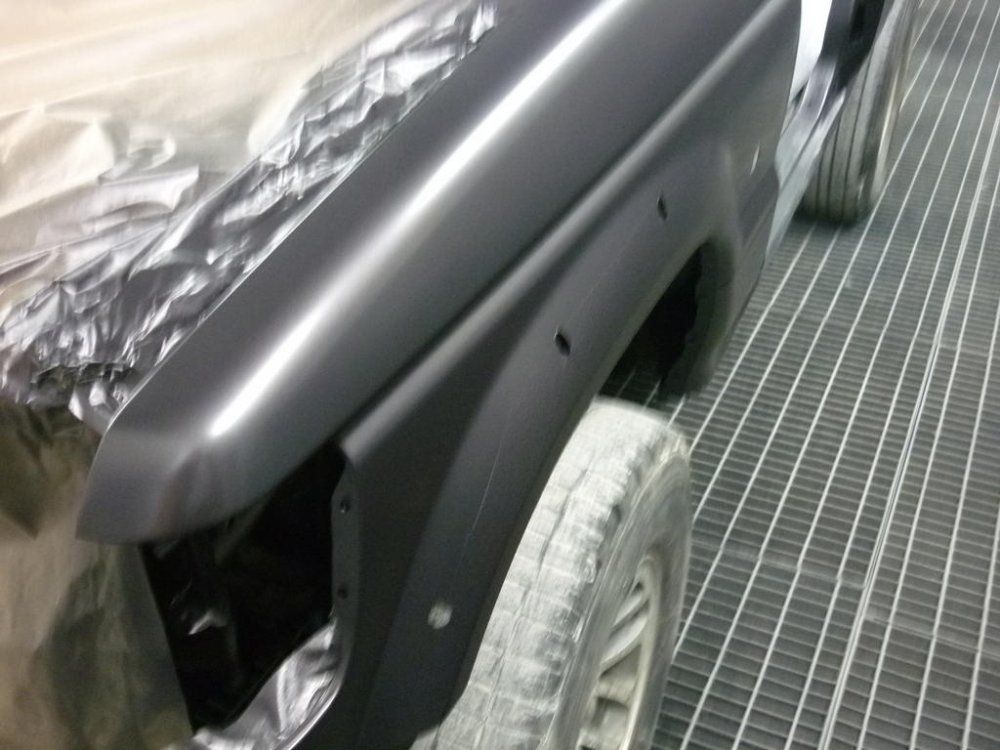

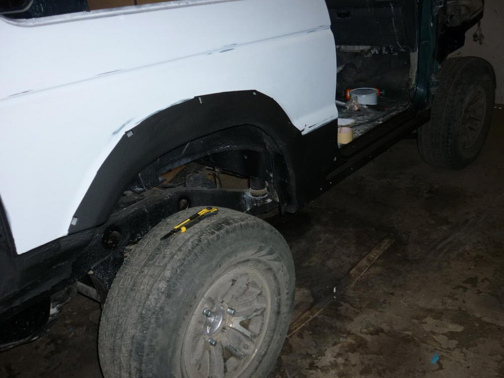

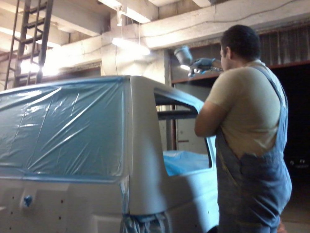

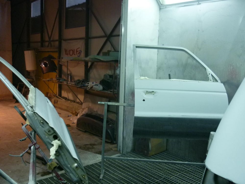

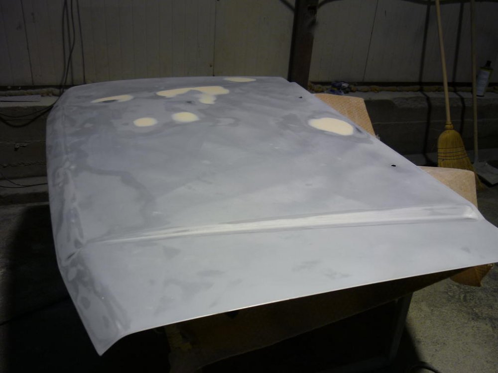

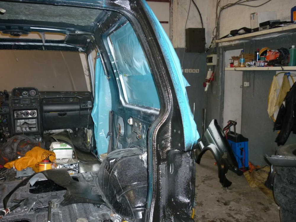

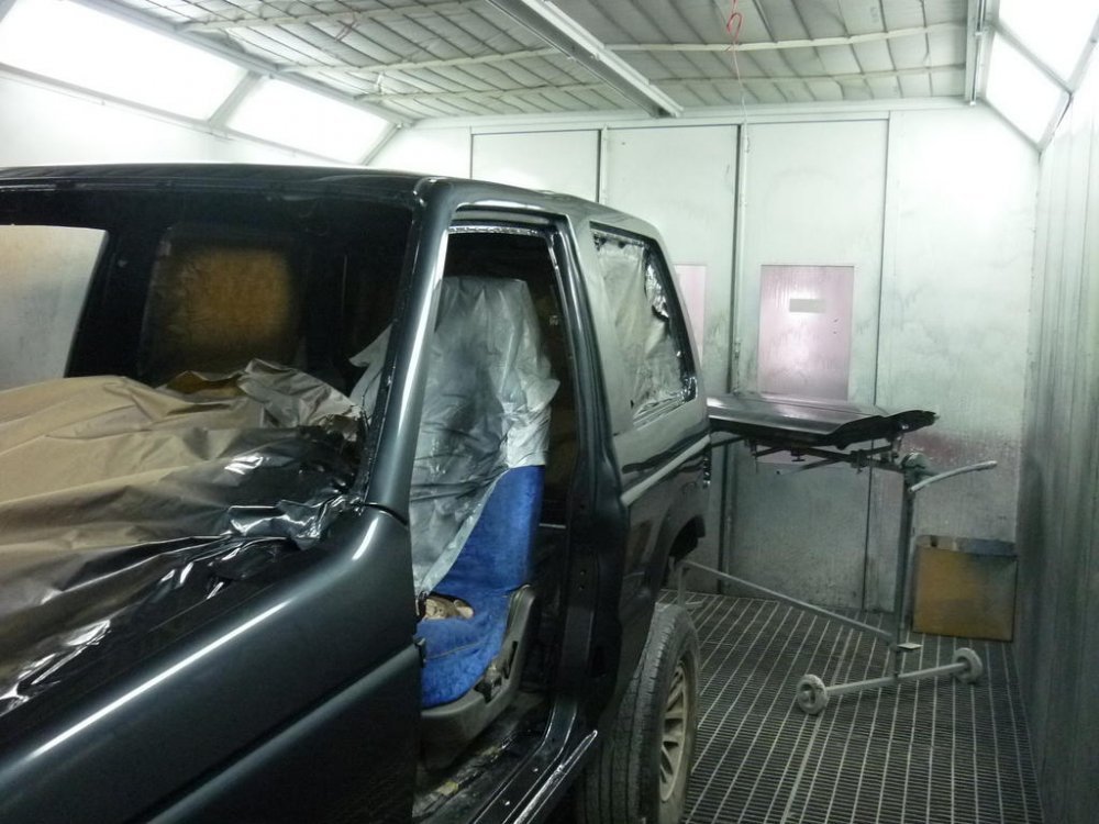

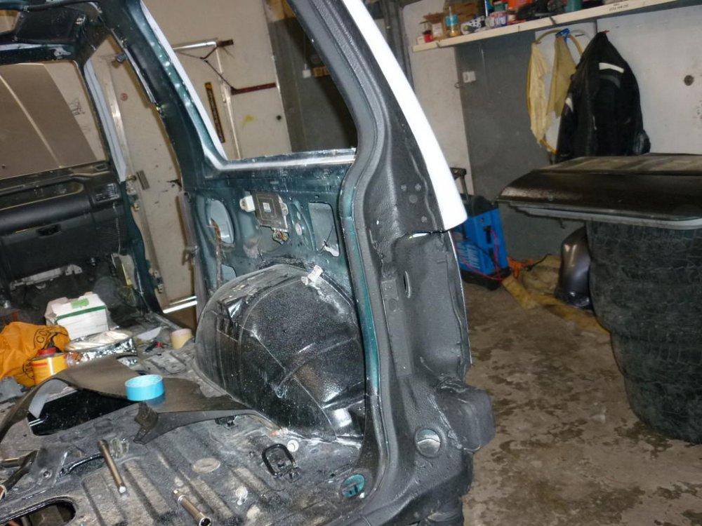

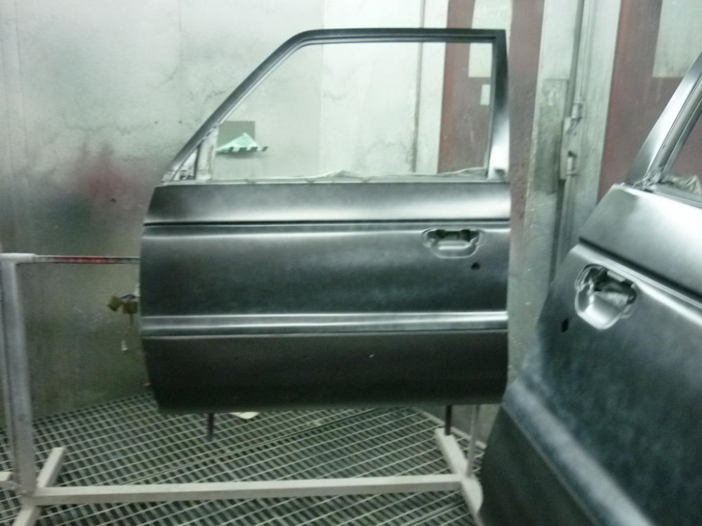

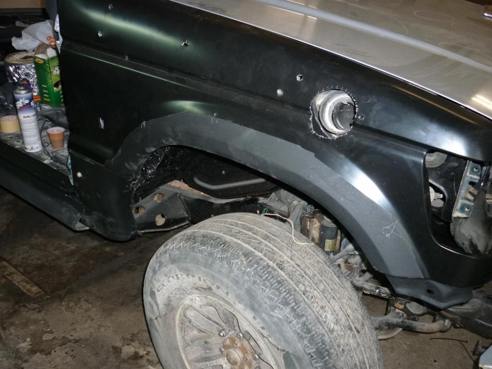

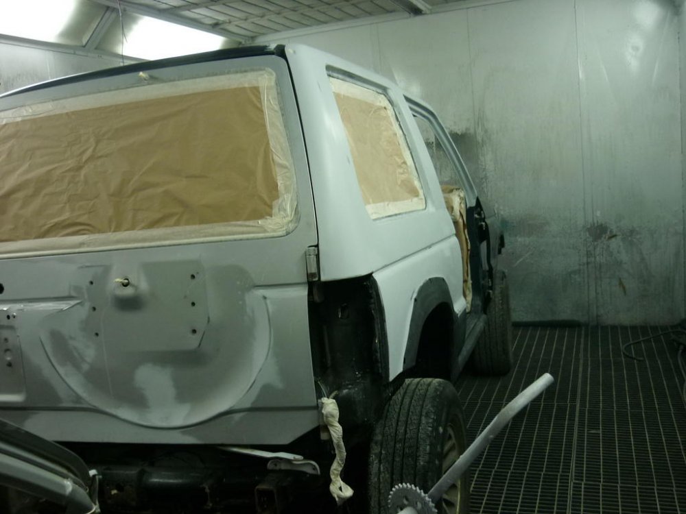

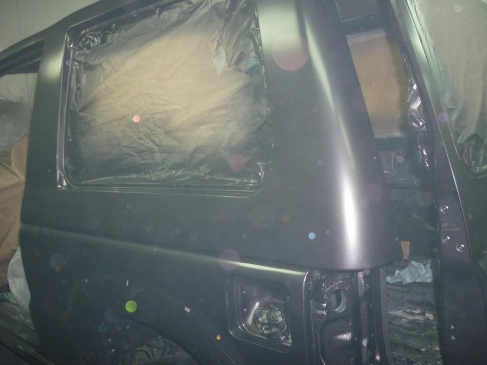

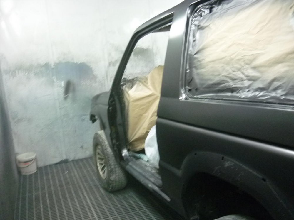

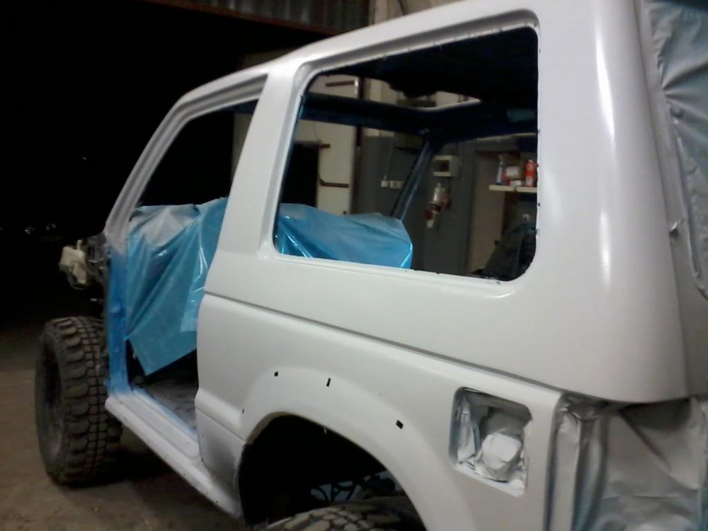

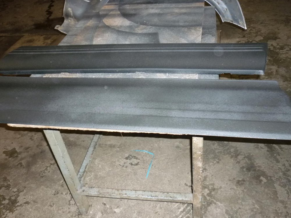

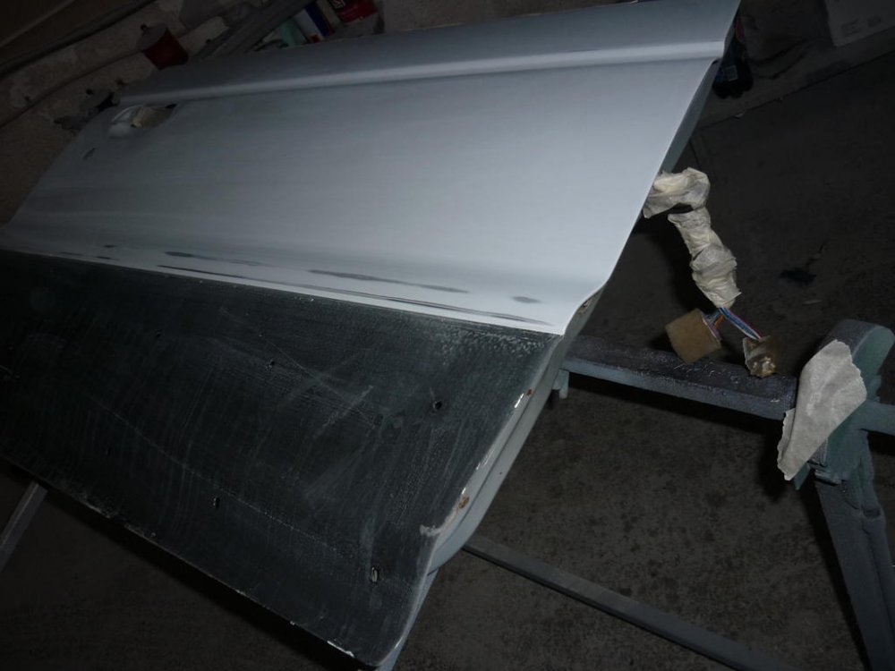

liviuoff Posted May 19, 2012 Author Share Posted May 19, 2012 Re: pajero scurt 3000 v6 12v an 93 am mai evoluat umpic si sintru in linie dreapta cu vopsitu miercuti intra la vopsit ....... acum dureaza mai mult pentru ca sunt nimicuri care iti ia timp sa iasa cat mai bine texturat la pistol la greu ..........:ha1 KAMIKAZE Off Road Team Link to comment Share on other sites More sharing options...

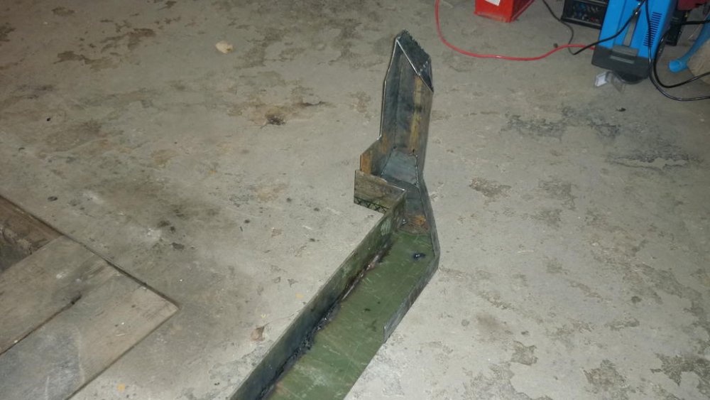

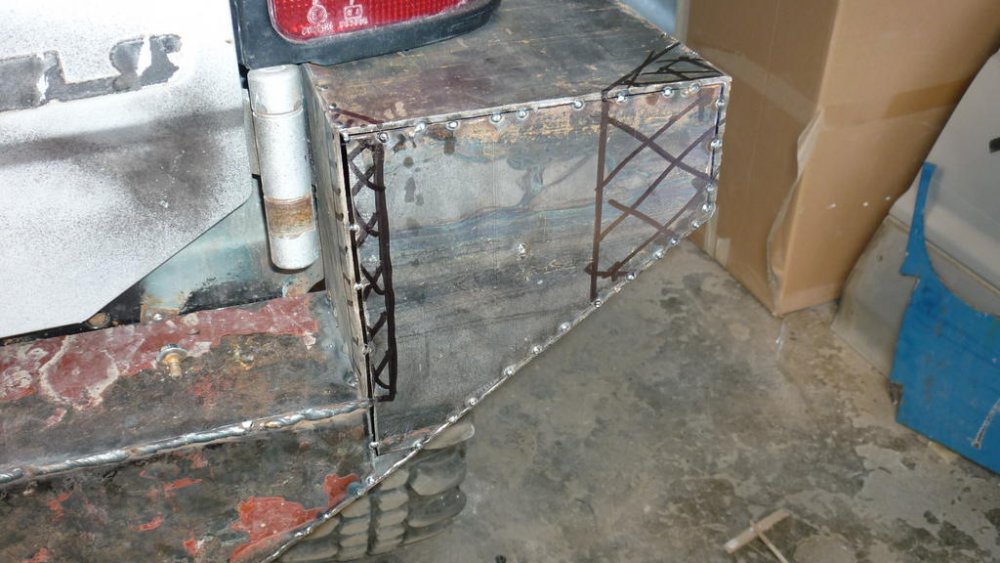

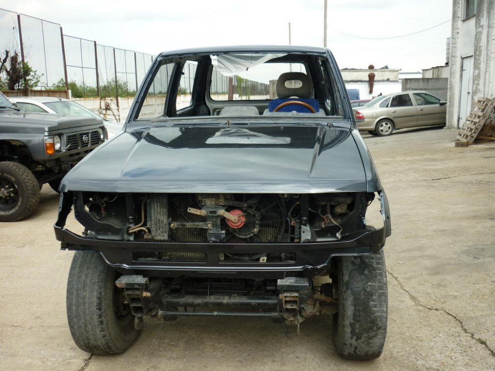

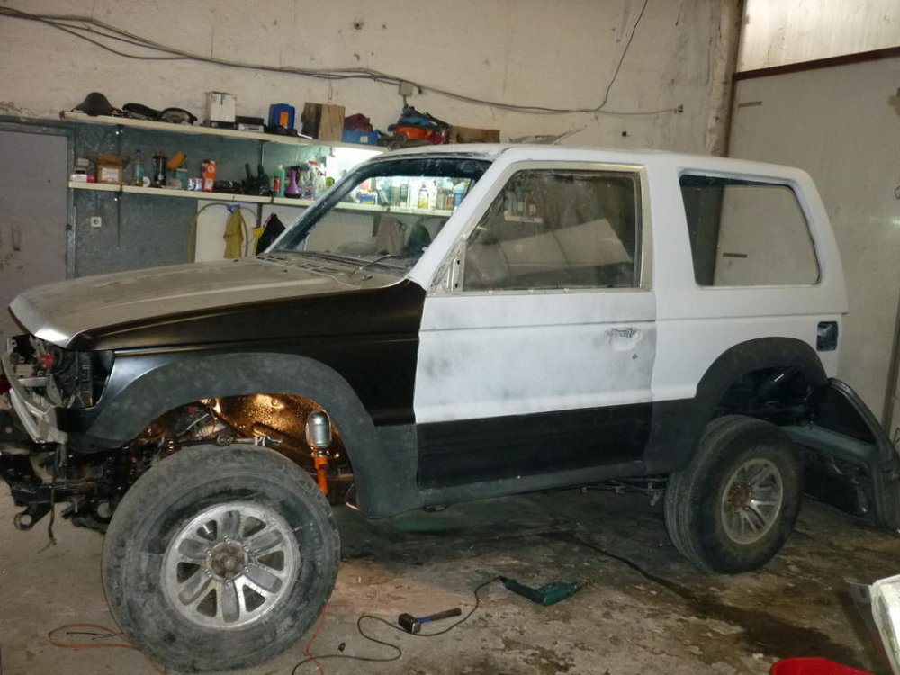

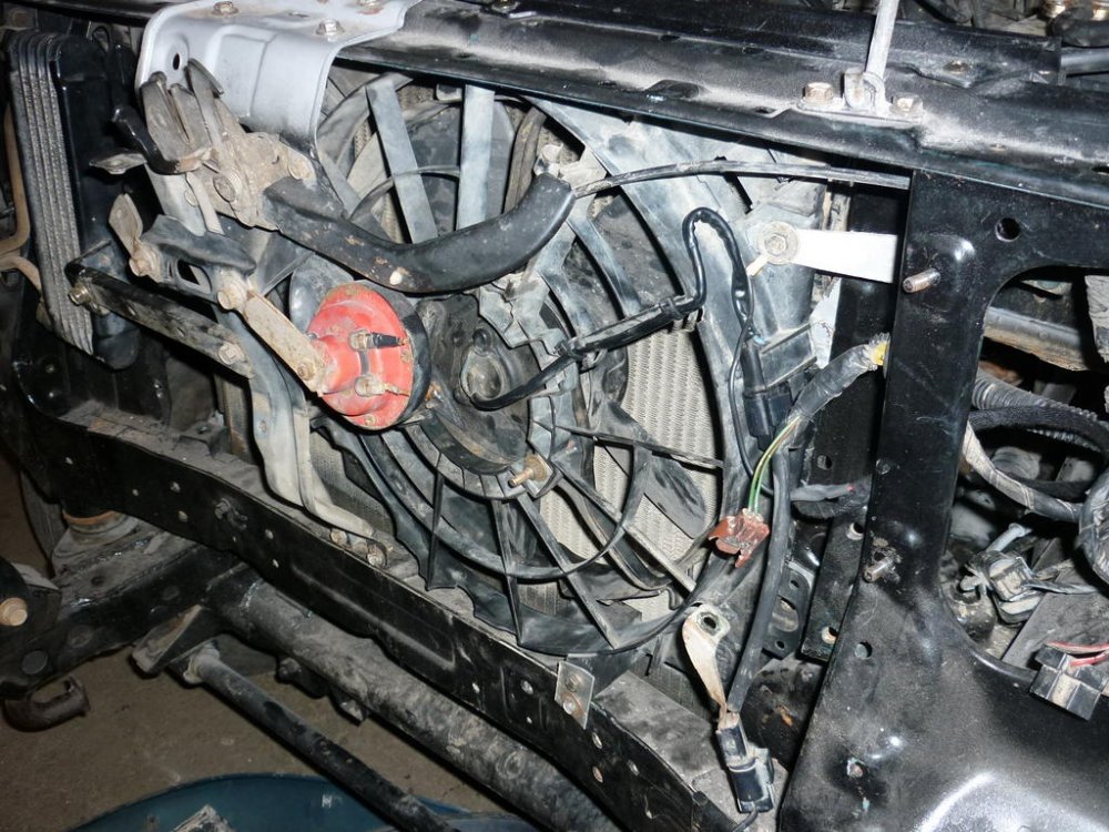

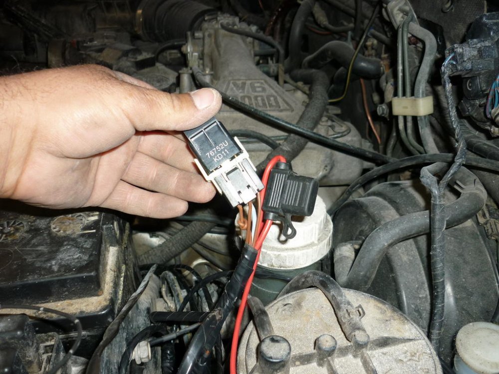

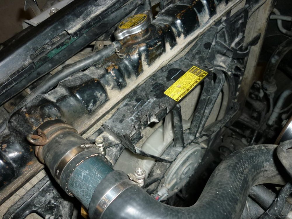

liviuoff Posted May 19, 2012 Author Share Posted May 19, 2012 (edited) Re: pajero scurt 3000 v6 12v an 93 am renuntat la vascocuplaj si am trecut pe ventilatoatre unu in fata si unu in spate am loat o sonda de apa de golf2 in fata radiatorului este ventilator de pajero de ac siar in spatele radiatorului este de renault laguna , am construit un teu din teava gaurita si am facut o piulita la strung am sutato in teu si am infiletat sonda am facut electica cu releu si sigurante ,,,,, am tras in masina un cablu care opreste ventiladoru din fata ,in mod normal daca nu puneam intrerupator pe primu ventilator cand ajungea la temperatura de 95 de grade plecau amandoua si racea prea mult asa cand imtru in teren si nu face fata unu dau drumu si la al doilea :wink::wink: Edited May 19, 2012 by Astral KAMIKAZE Off Road Team Link to comment Share on other sites More sharing options...

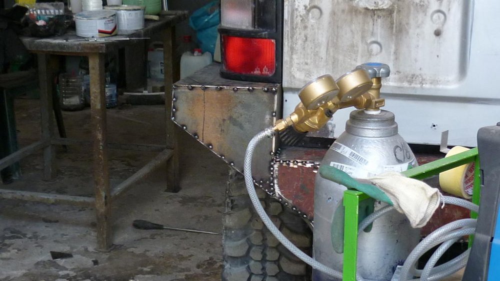

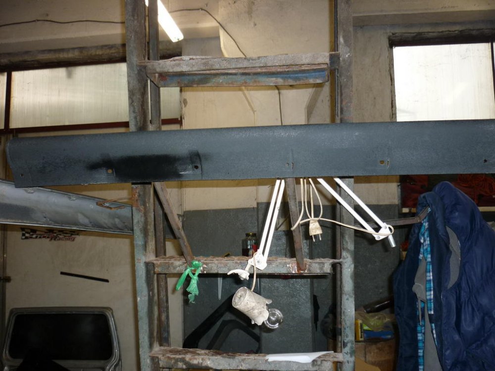

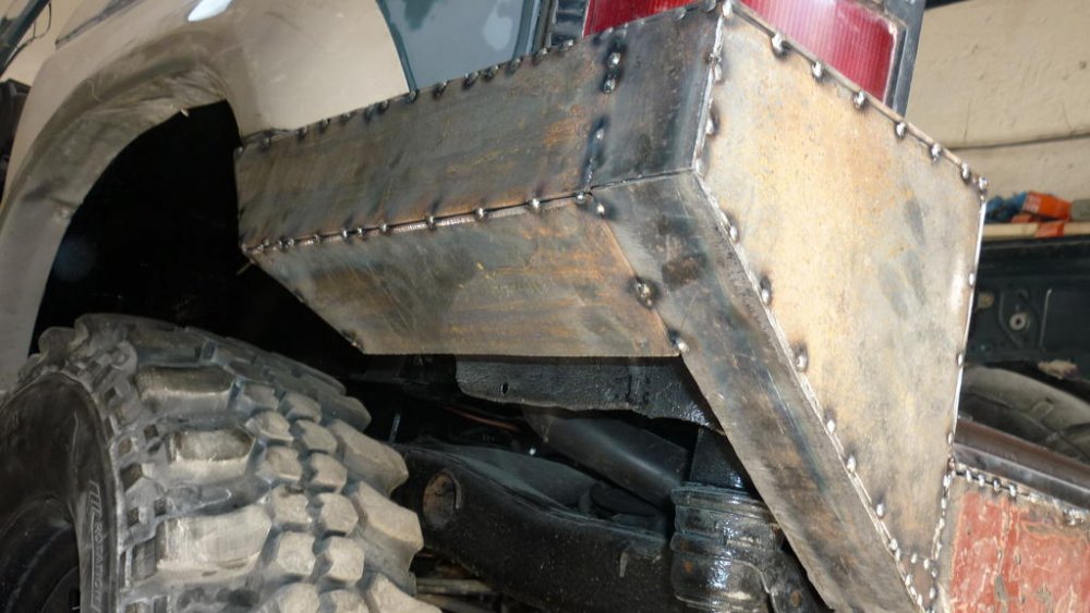

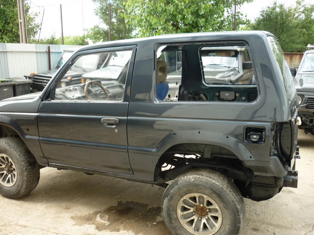

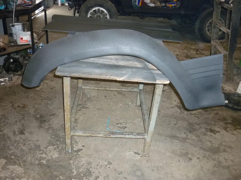

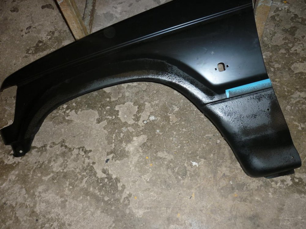

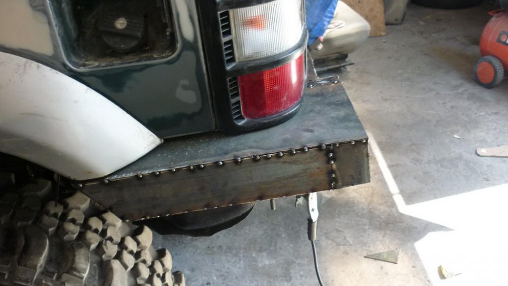

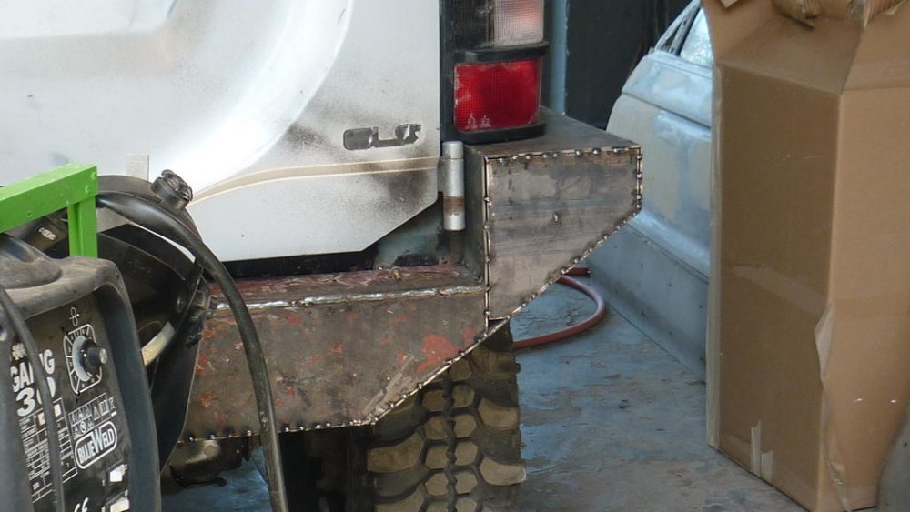

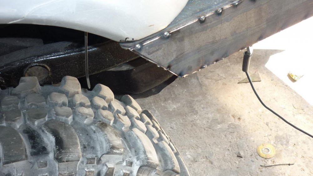

liviuoff Posted May 26, 2012 Author Share Posted May 26, 2012 Re: pajero scurt 3000 v6 12v an 93 mai atasam niste poze KAMIKAZE Off Road Team Link to comment Share on other sites More sharing options...
liviuoff Posted May 26, 2012 Author Share Posted May 26, 2012 Re: pajero scurt 3000 v6 12v an 93 KAMIKAZE Off Road Team Link to comment Share on other sites More sharing options...

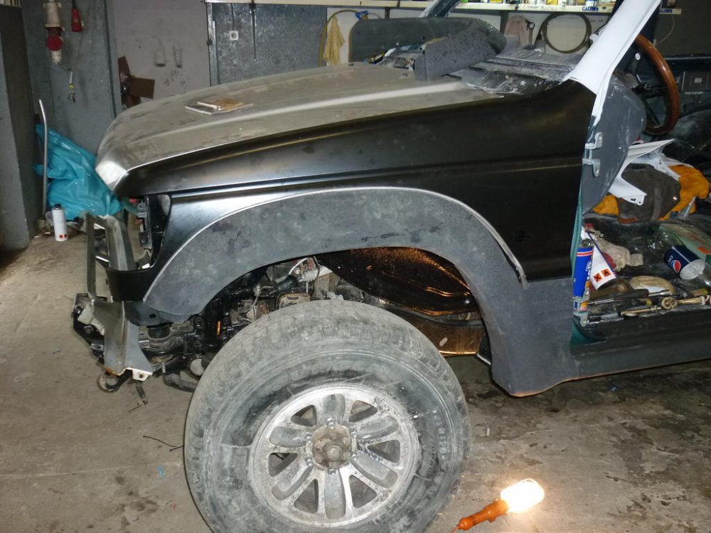

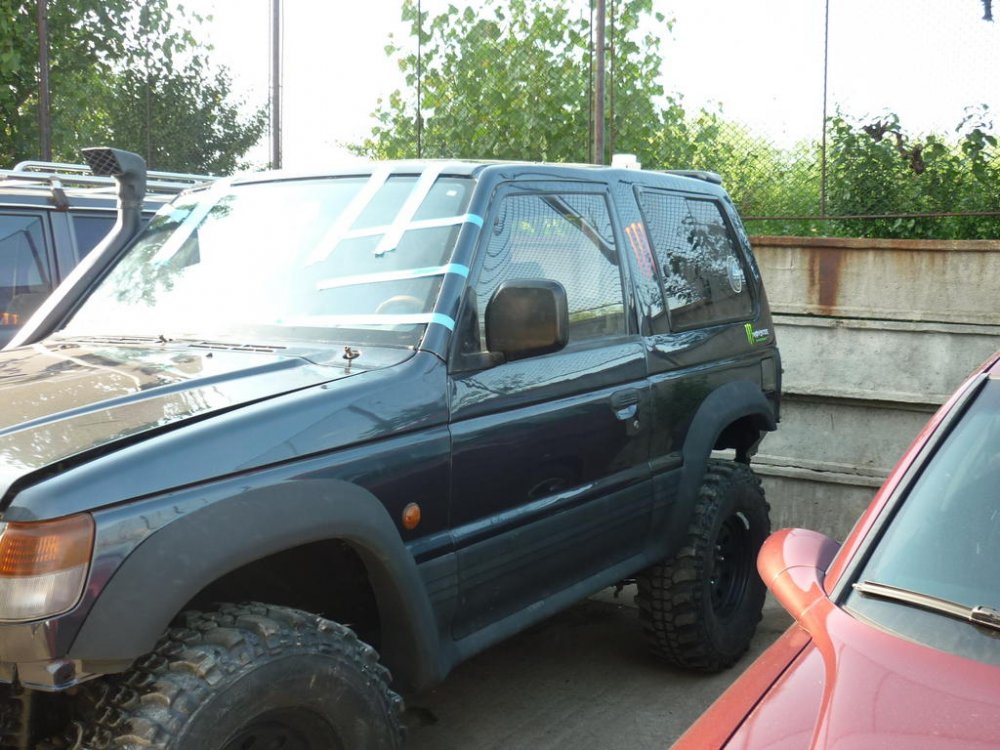

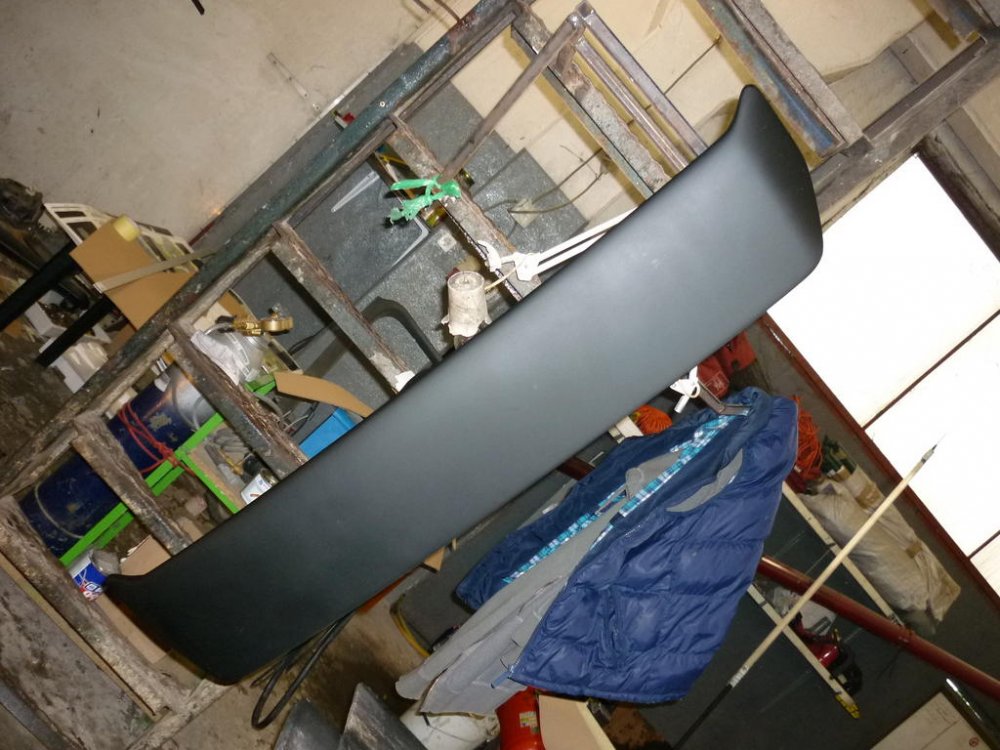

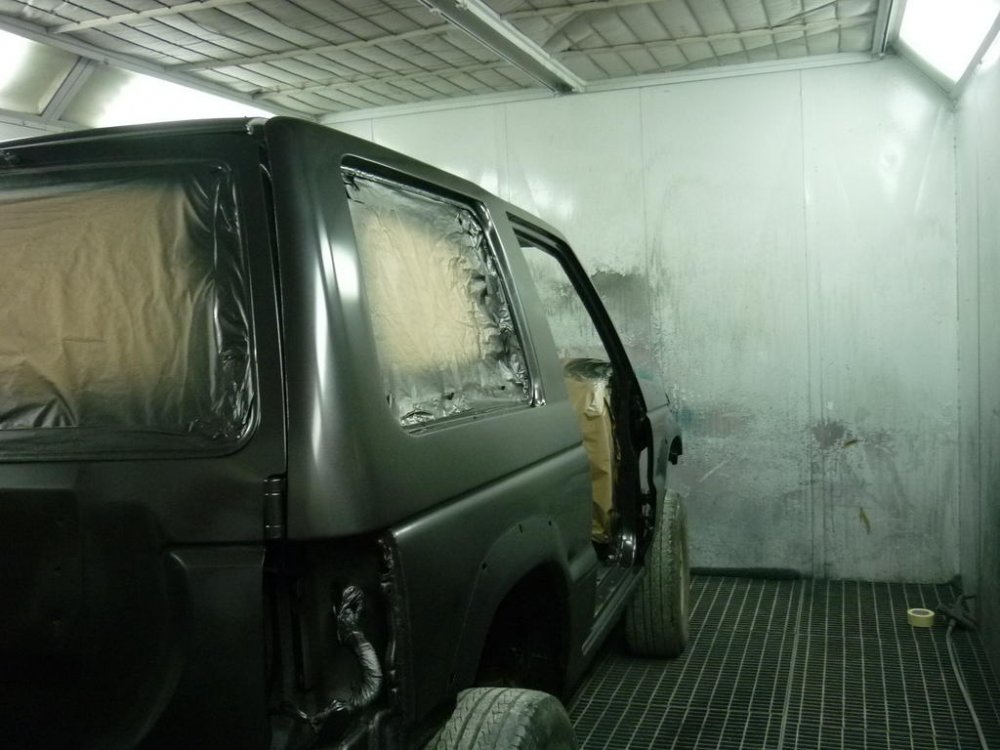

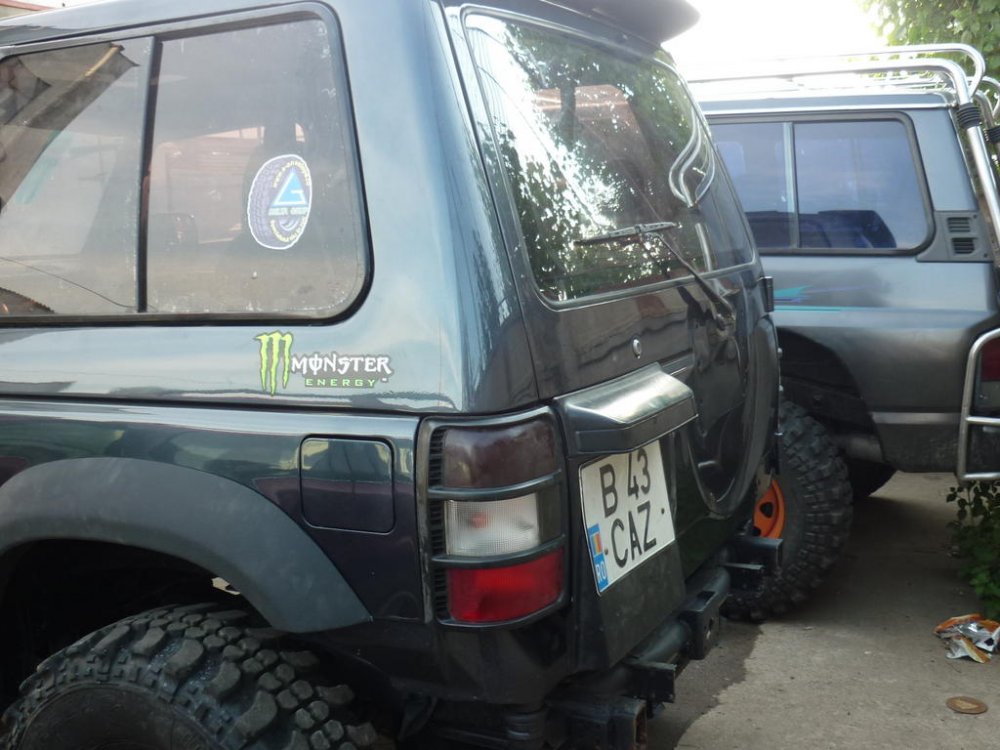

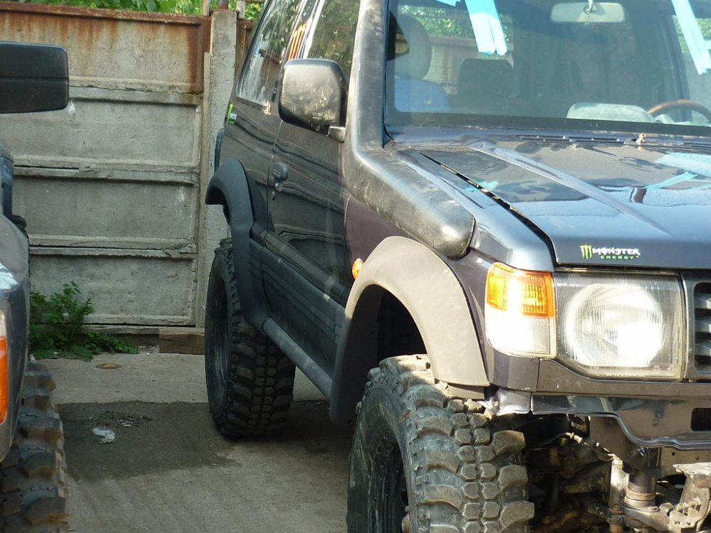

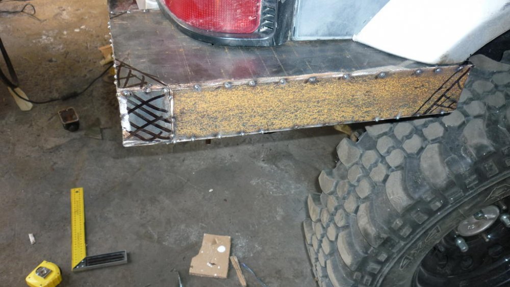

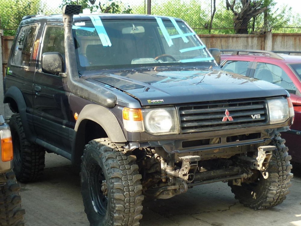

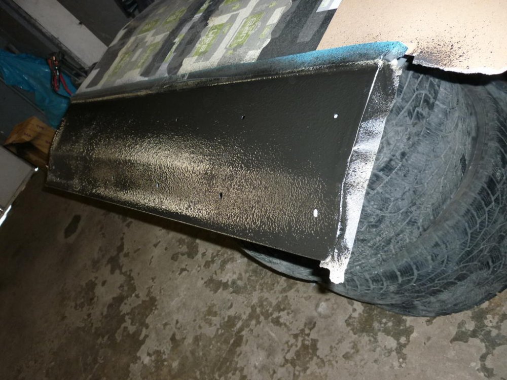

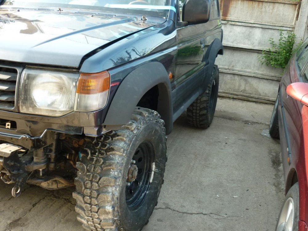

liviuoff Posted May 26, 2012 Author Share Posted May 26, 2012 (edited) cam asa arata acaretul vopsit:ha2 Edited May 26, 2012 by Astral KAMIKAZE Off Road Team Link to comment Share on other sites More sharing options...

liviuoff Posted May 26, 2012 Author Share Posted May 26, 2012 (edited) Re: pajero scurt 3000 v6 12v an 93 sunt si eu interesat in viitorul apropiat sa achizitionez un mk2 3000 v6 si nu stiu daca e o alegere mai buna decat cele diesel ...un sfat te rog ms... felicitari pt masina Salutare, depinde ce vrei sa faci cu masina ! Eu am ales benzinar ca nu suport diesel si sunt foarte multumit de ea in teren, felul cum trage si cuplul pe care il are, de consum ce sa zic consuma cat vrea el :ha2 nu este o masina de zi cu zi pt ca ajungi la ruina indiferent cati bani ai avea :ha: daca este sa iti iei diesel alege motorizarea de 2,8 :ha:NU 2,5 ca sun pacatoase rau si piesele la mitsu nu sunt tocmai ieftine ...... in rest ce sa zic are mai mereu pomleme cu regulatorul de ralanti care este de negasit nici sh nu il gasesti fisele si capacul de delco sunt cam pacatoase la mine merge acum cand in 4 cand in 5 na acum fiecare masina cu defectele ei sunt niste masini:old indiferent ce mitsu iti iei uita-te in poze la mine pe la inceput si vezi unde avea rugina nu iti lua masina de Olanda sau Austria ca sunt ruginite blana pentru ca baga barca cu ele in apa si automat intra pana aproape de jumatate sa fii foarte atent la sasiu ca altfel o sa muncesti ca mine din ianuarie :ap:ang2 in rest multa bafta daca mai este ceva vb pe pm Edited May 26, 2012 by Tavi D. KAMIKAZE Off Road Team Link to comment Share on other sites More sharing options...

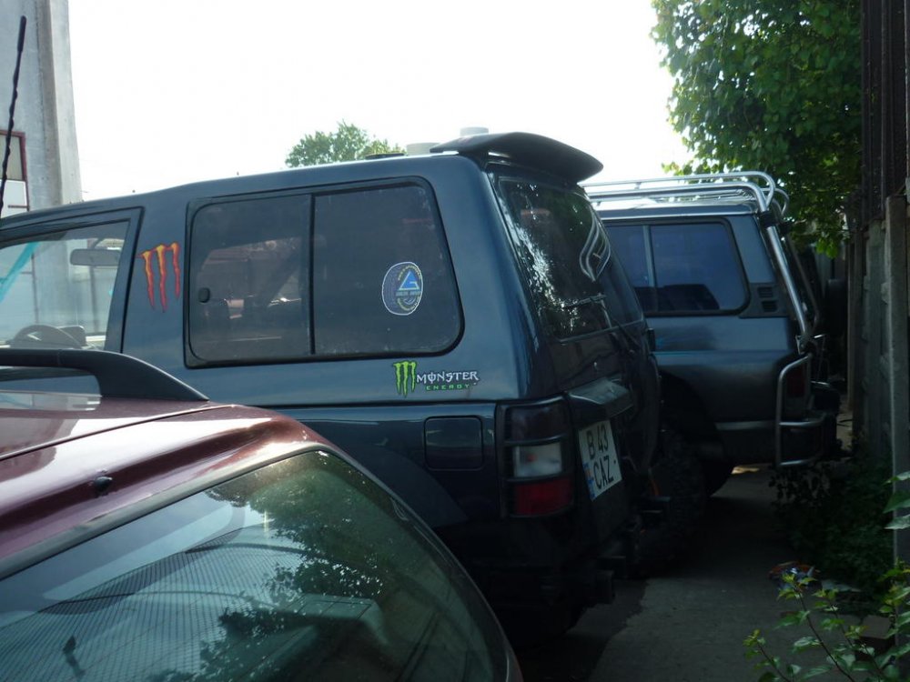

liviuoff Posted May 31, 2012 Author Share Posted May 31, 2012 Re: pajero scurt 3000 v6 12v an 93 KAMIKAZE Off Road Team Link to comment Share on other sites More sharing options...
liviuoff Posted May 31, 2012 Author Share Posted May 31, 2012 Re: pajero scurt 3000 v6 12v an 93 mda plictisitor topic mai am si io :ha: POATE DIN CAUZA TITLULUI:al:al KAMIKAZE Off Road Team Link to comment Share on other sites More sharing options...
