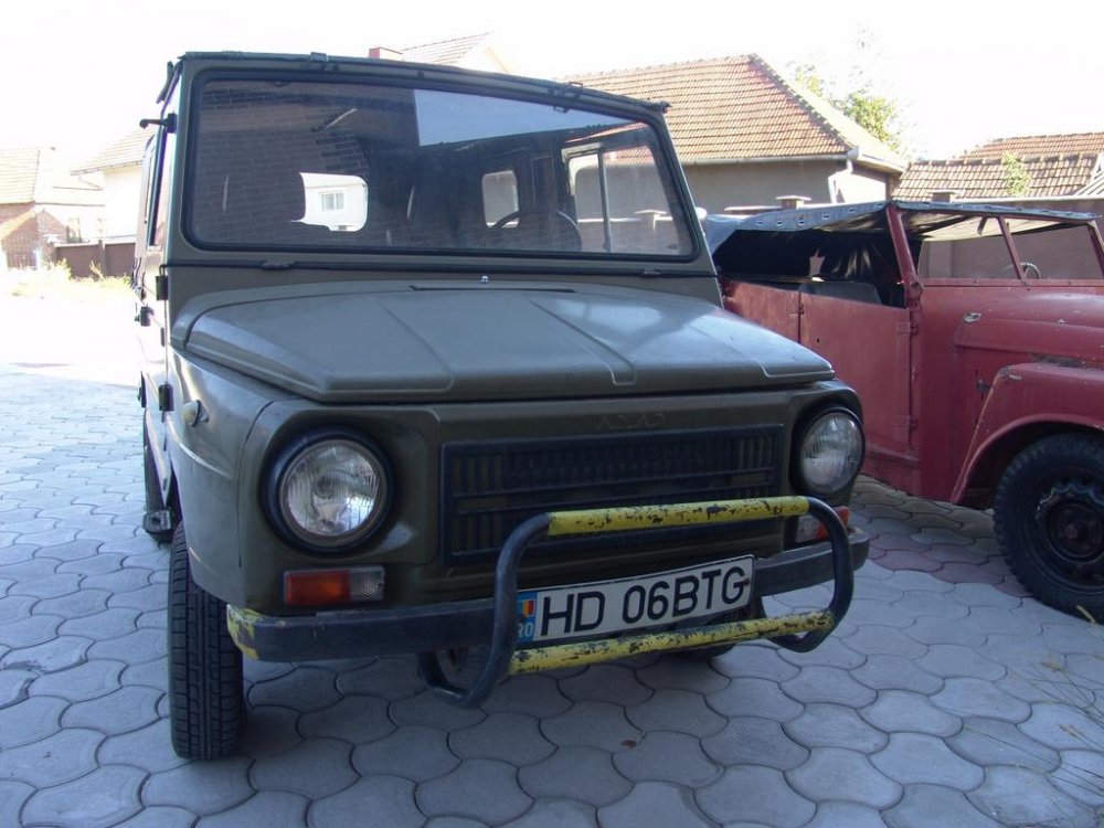

florinpp Posted November 7, 2011 Share Posted November 7, 2011 (edited) Am cumparat si eu unul mai mult din curozitate sa vad ce e de capul lor. Edited November 7, 2011 by Astral 1 GAZ 69 Link to comment Share on other sites More sharing options...

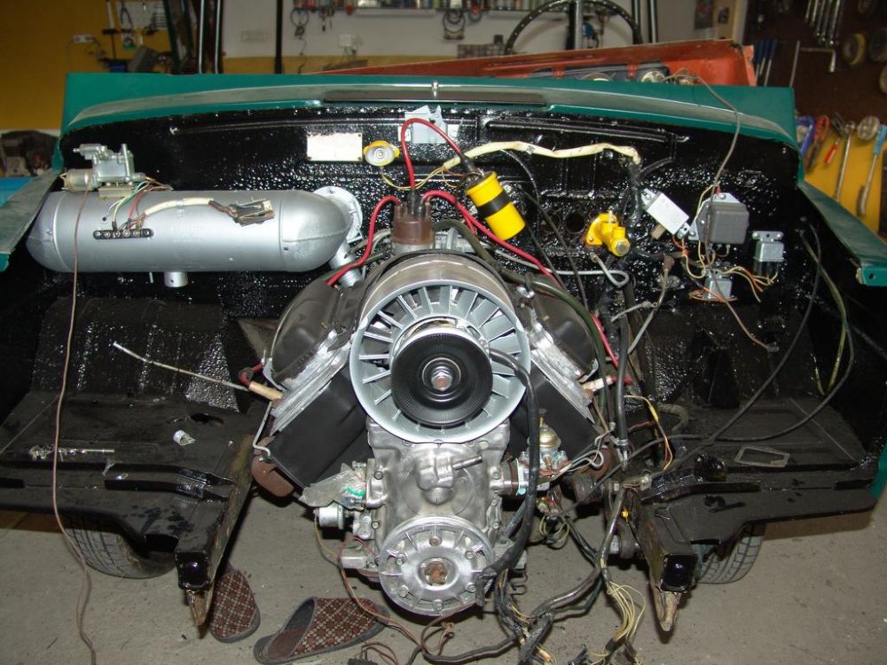

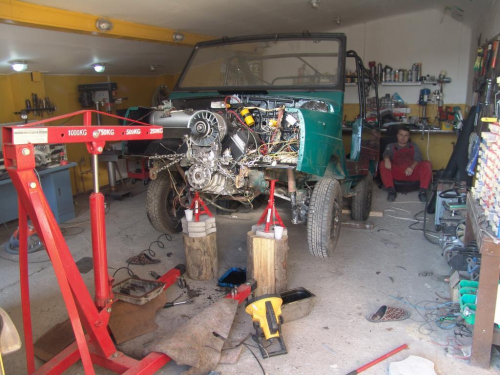

florinpp Posted November 7, 2011 Author Share Posted November 7, 2011 Re: Luaz 969 M-am apucat de el,izolat,vopsit,sistem frinare nou si multe alte maruntisuri,motorul functioneaza bine,cam asa arata acum GAZ 69 Link to comment Share on other sites More sharing options...
baghy Posted November 7, 2011 Share Posted November 7, 2011 Re: Luaz 969 Nu stiam ca au motoare in V. Ce capacitate are? Piese se gasesc pentru ele? Daihatsu Feroza, adio pietre la rinichi. Link to comment Share on other sites More sharing options...
florinpp Posted November 8, 2011 Author Share Posted November 8, 2011 Re: Luaz 969 motorul e de 1200cmc,piese se gasesc si pe la noi se potrivesc multe de pe lada si niva,eu am pe cineva din Ucraina cu un magazin in Deva si aduce piese de orice rusoaica GAZ 69 Link to comment Share on other sites More sharing options...

florinpp Posted December 13, 2011 Author Share Posted December 13, 2011 Re: Luaz 969 masina ar fi fost gata dar nu ii gasesc 2 arcuri de supapa ca sunt rupte,are arcuri duble si sau rupt cele de interior,cind le gasesc inchid motorul si pun poze cu ea GAZ 69 Link to comment Share on other sites More sharing options...
pitonul Posted December 16, 2011 Share Posted December 16, 2011 Re: Luaz 969 Daca tot esti cu ea desfacuta verifica suruburile care prind ansamblul motor-cutie de viteze de caroserie. Eu am avut doar doua montate si s-au rupt, mergand cu ansamblul sprijinit pe bara de torsiune. Rubicon 2.8 Link to comment Share on other sites More sharing options...
florinpp Posted December 18, 2011 Author Share Posted December 18, 2011 Re: Luaz 969 Mersi de sfat,dar cred ca am sa abandonez proiectul ,luni trebuia sa intru cu ea in r.a.r ,s-a rupt un culbutor si nu o mai pot duce,piesa dureaza pina o gasesc intra noua lege si nu o voi mai putea trece pe mine. GAZ 69 Link to comment Share on other sites More sharing options...

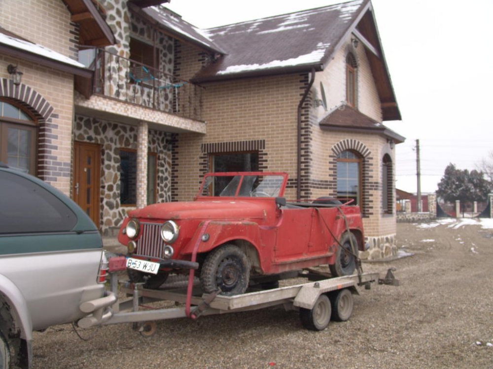

PAULD Posted March 13, 2012 Share Posted March 13, 2012 Re: Luaz 969 [ATTACH=CONFIG]133804[/ATTACH] Salut! Langa LUAZ se mai vede o alta masina....pare interesanta,ce model e? Sau mai ai vreo poza unde se vede mai bine? Merci. Link to comment Share on other sites More sharing options...
florinpp Posted April 9, 2012 Author Share Posted April 9, 2012 Re: Luaz 969 E o skoda militar 1101,cam rare si prin Europa,isi asteapta rindul la restaurare GAZ 69 Link to comment Share on other sites More sharing options...
PAULD Posted April 10, 2012 Share Posted April 10, 2012 (edited) Re: Luaz 969 De sus in jos: Skoda 110,din 1948,dar are 4x2. Skoda 973 Babeta,din 1955,cu 4x4,se vad influentele de design de la jeep-urile occidentale,mai ales de la Toyota fj40. Skoda 965 ,din 1950. Merci pt. poza. p.s. Si eu am o masina mai rara,un Aro 241. Edited April 10, 2012 by PAULD Link to comment Share on other sites More sharing options...
