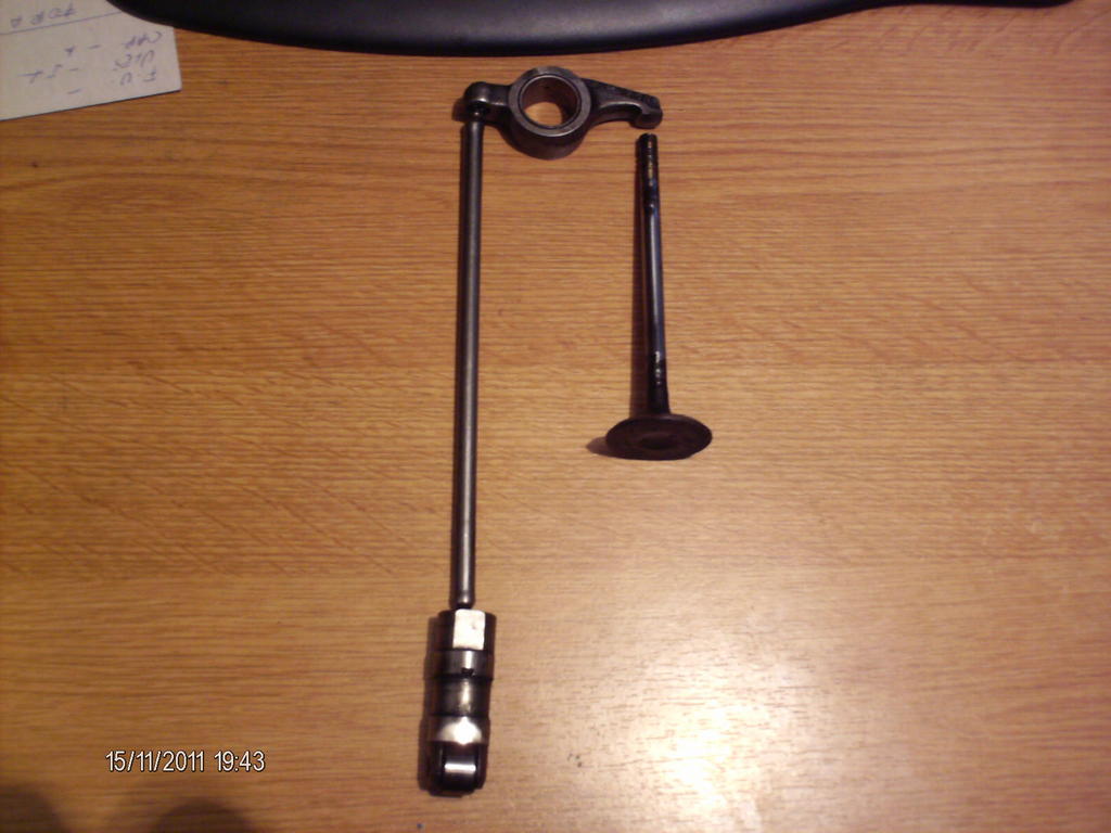

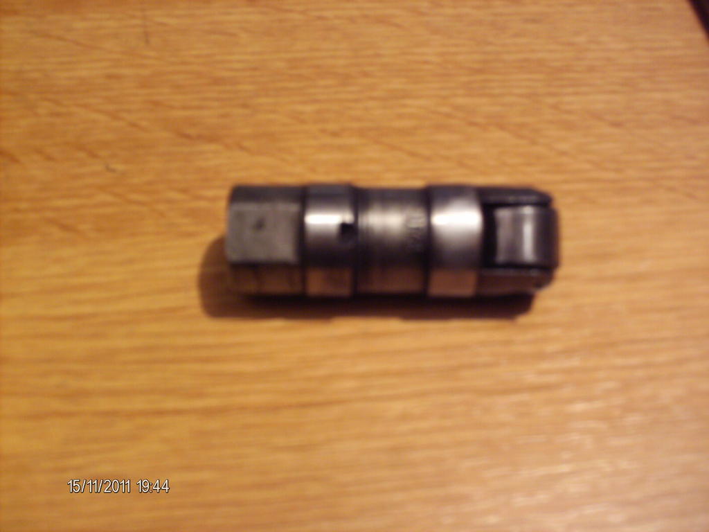

alin-jeep Posted November 15, 2011 Share Posted November 15, 2011 Re: probleme motor 2,5TD - VM Buna seara asa arata un tachet hidraulic si piesele care actioneaza supapa ALIN Link to comment Share on other sites More sharing options...
pacaliciossu Posted November 15, 2011 Author Share Posted November 15, 2011 (edited) Re: probleme motor 2,5TD - VM Exact asta am primit de la dl. Nino, caruia ii multumesc.....traiasca :cl si membrii lui Edited November 15, 2011 by pacaliciossu Link to comment Share on other sites More sharing options...
