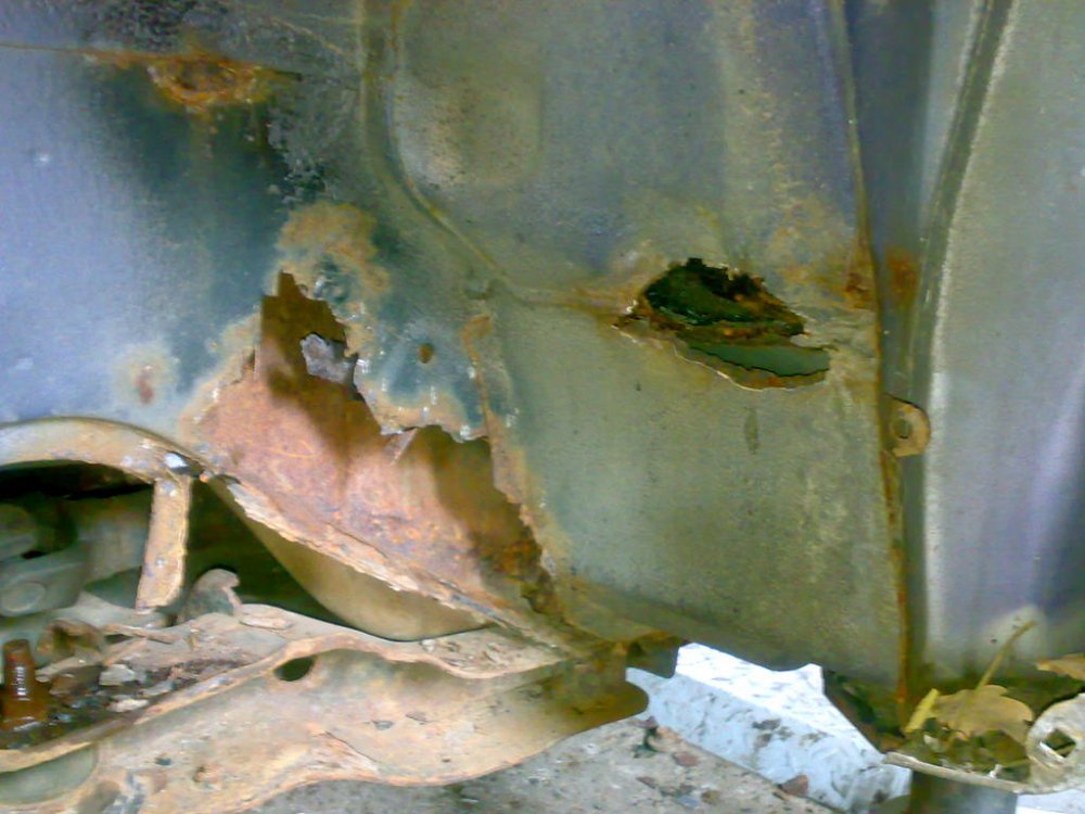

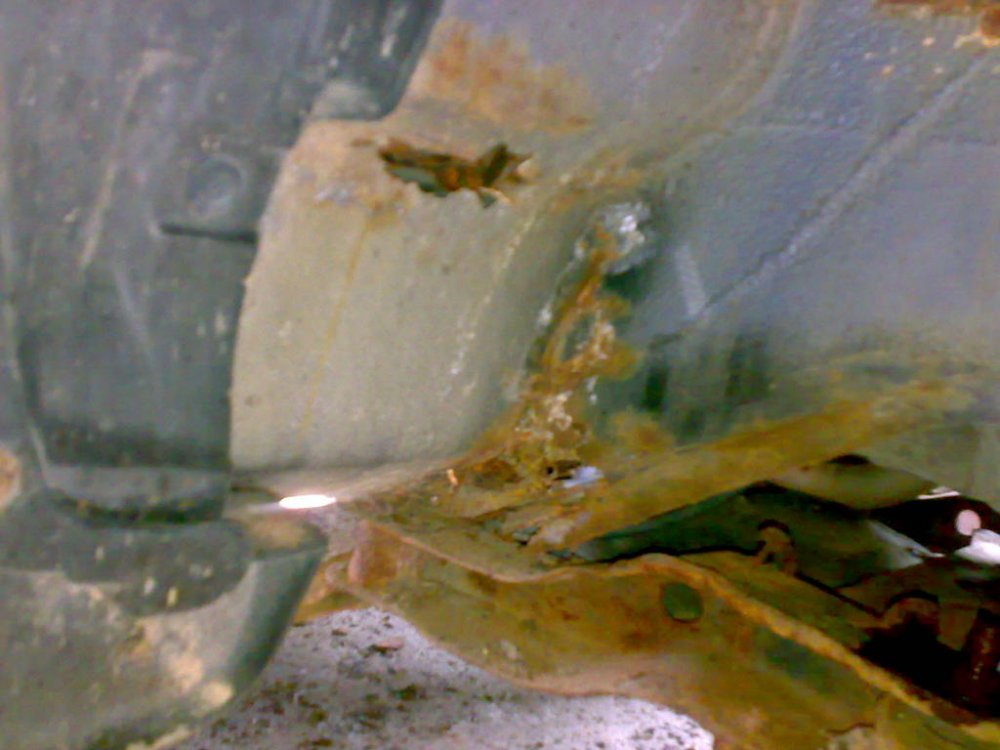

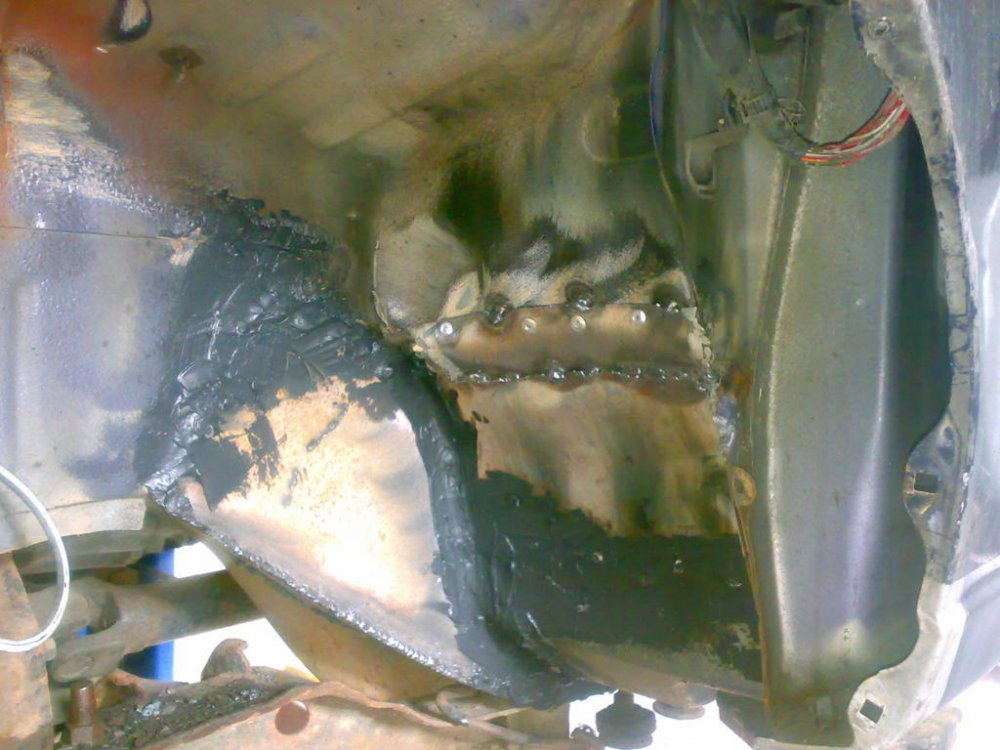

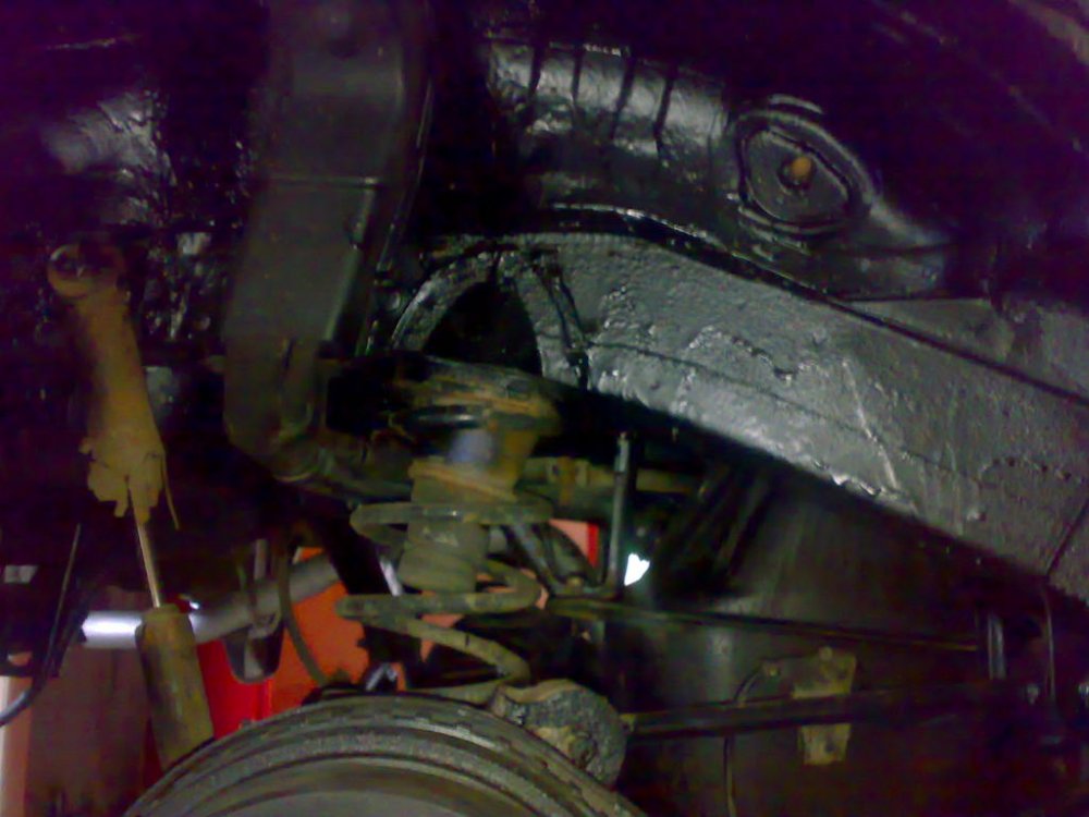

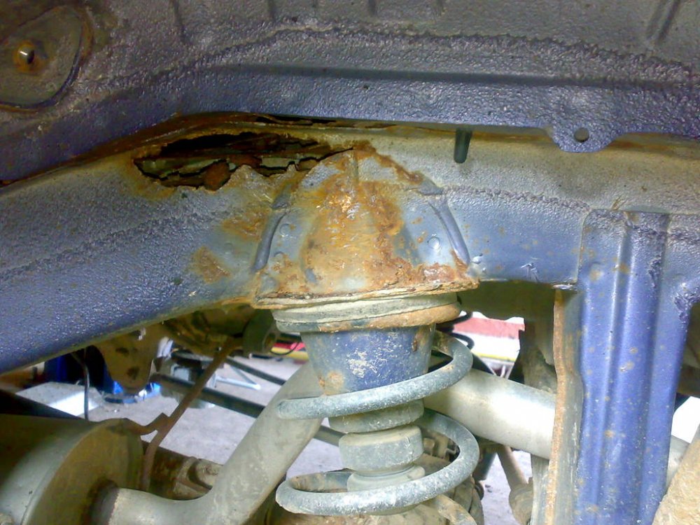

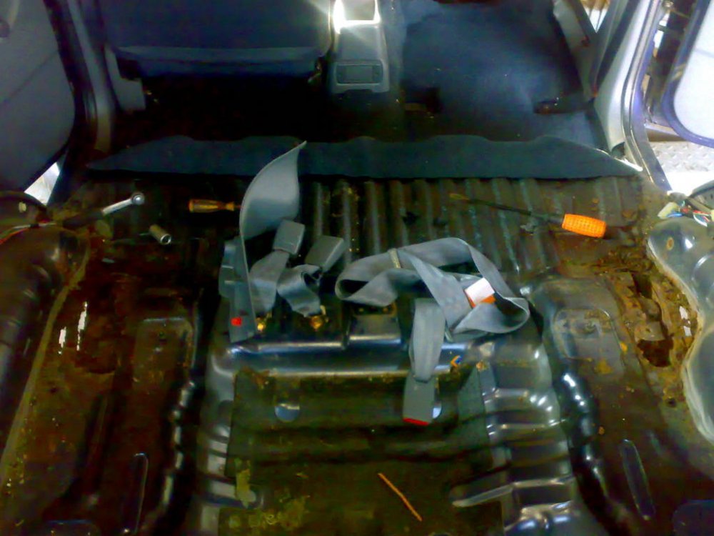

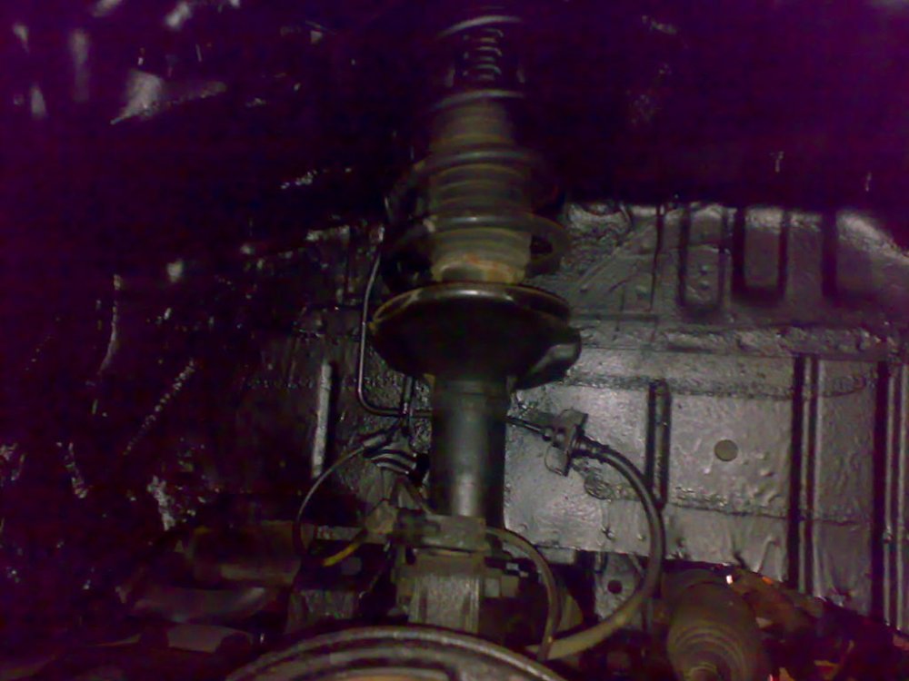

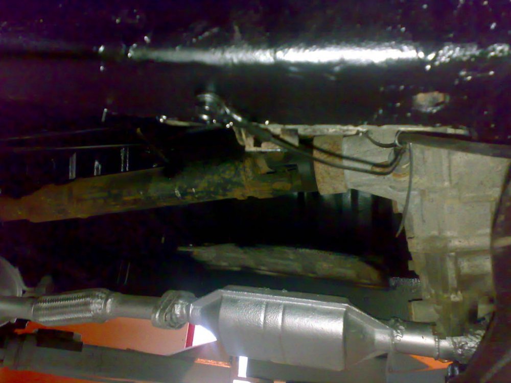

Dorin_Z Posted November 21, 2011 Share Posted November 21, 2011 (edited) Salutare tuturor!!! Daihatsu Terios 1998 61kw primul lucru rezolvat rugina: insonorizant - 26 lei cutia sprai vopsea - 80 lei tabla - 100 lei chit - 80 lei dupa care schimbat: brate fata - 250 lei bielete antirului - 173 lei (cumparat bucse de Dacie 1300 8 bucse - 8 lei - economie :wink:) facut unghi de fuga - 60 lei schimbat uleiuri Mobil1 80W90 - 25lei/litru diferentiale 75W90 - 65 lei/litru in cutia de viteze si cutia de transfer Motor ulei Centro Motorol - made in Germany 5W40 120lei/5litri filtru ulei mann - 25 lei filtru aer mann - 45lei bujii - 92 lei filtru benzina 92 - lei manopera totala 300 euro Probleme: Terios-ul este o masina cu o tabla foarte proasta, peste tot este tabla dubla, adica sunt doua table paralele intre care se face condens si putrezeste din interior spre exterior (lonjeroane, pod pedalier, aripi interioare, etc.) cand lovesti sau incerci sa cureti surpriza cade "halca". Ca sa schimbi bratele tr data bara de torsiune jos. Toate suruburile, fiind o masina veche, sunt ruginite si oricat de atent ai fi 3 din 10 se rup. Edited November 22, 2011 by Dorin_Z 2 Suzuki Vitara my offroader!!! Link to comment Share on other sites More sharing options...

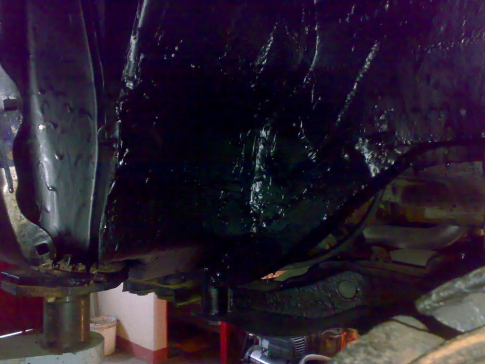

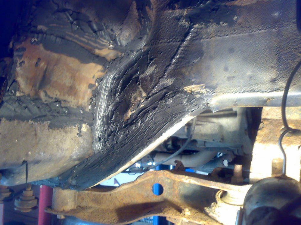

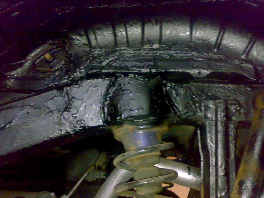

Dorin_Z Posted November 21, 2011 Author Share Posted November 21, 2011 (edited) Re: Daihatsu Terios de la A la Z Finalizare antifonare. Urmeaza vopsitul partilor exterioare afectate de rugina. Edited November 21, 2011 by Dorin_Z 2 Suzuki Vitara my offroader!!! Link to comment Share on other sites More sharing options...

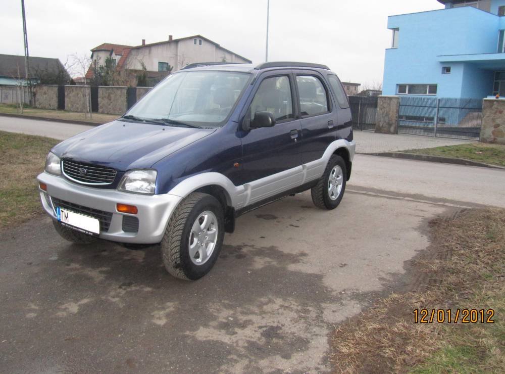

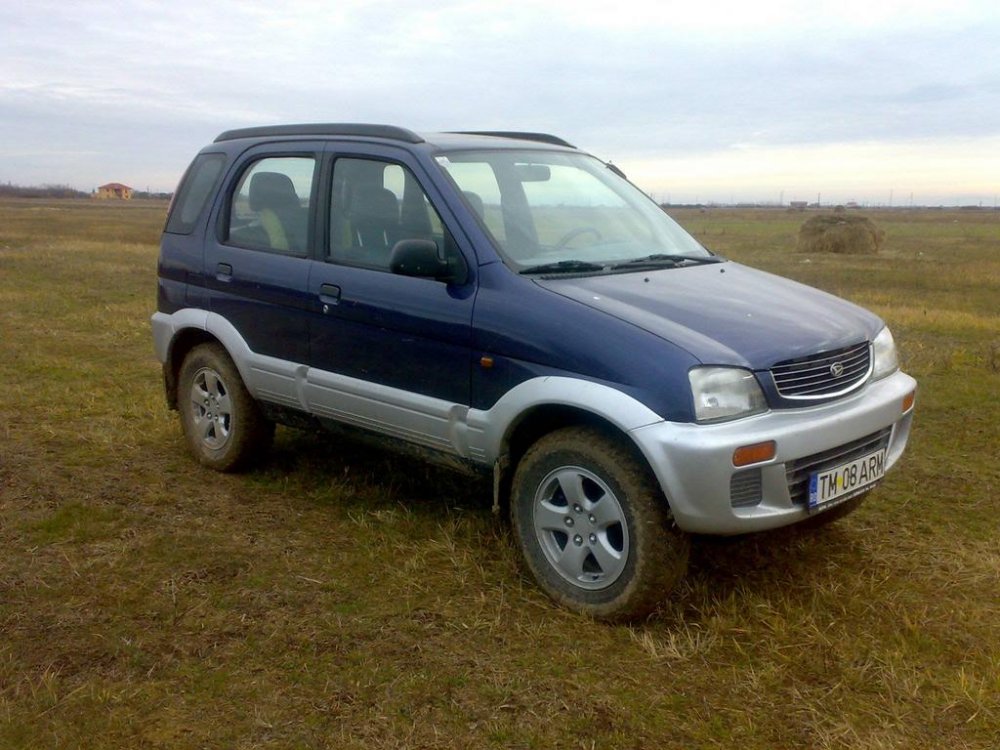

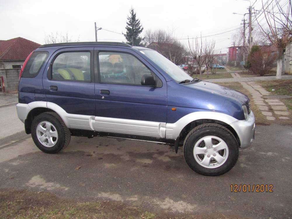

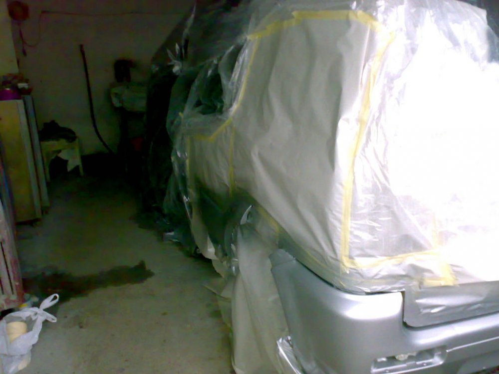

Dorin_Z Posted January 8, 2012 Author Share Posted January 8, 2012 (edited) Re: Daihatsu Terios de la A la Z Teriosul la vopsit! Au fost revopsite partile cu probleme, toate ornamentele si jantele 1000 lei cu tot cu vopsea, cuptor si manopera. Edited January 8, 2012 by Dorin_Z Suzuki Vitara my offroader!!! Link to comment Share on other sites More sharing options...

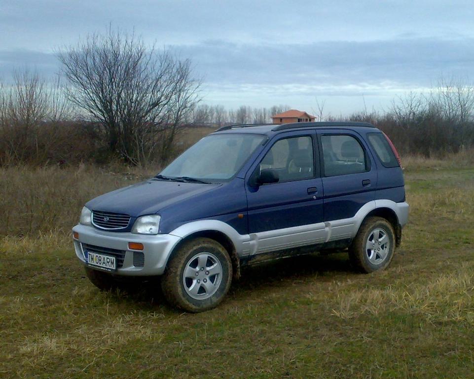

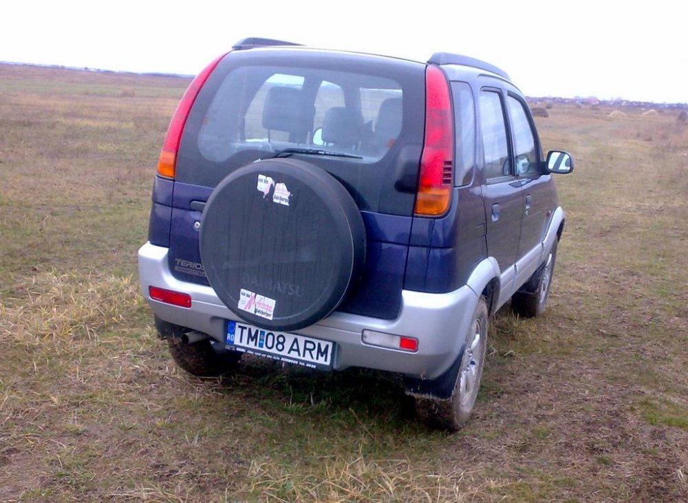

Dorin_Z Posted January 8, 2012 Author Share Posted January 8, 2012 Re: Daihatsu Terios de la A la Z Teriosul terminat mai am de schimbat telescoapele spate! A fost scos la plimbare! Suzuki Vitara my offroader!!! Link to comment Share on other sites More sharing options...

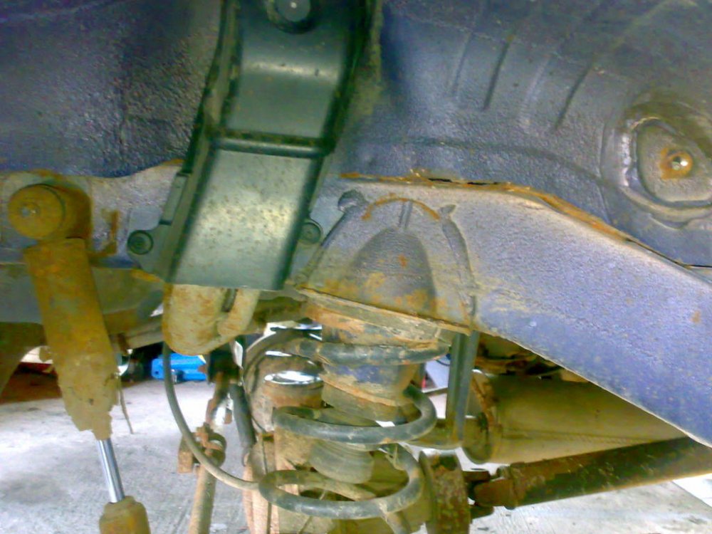

Dorin_Z Posted January 17, 2012 Author Share Posted January 17, 2012 (edited) Re: Daihatsu Terios de la A la Z Au fost schimbate si telescoapele spate 254 lei/buc. adica 508 lei total! Marca LIP pt 4x4 made in U.K. Masina sta mult mai bine pe drum si m-am scapat si de zdranganitul din spate, totul functioneaza perfect. Joi la vanatoare sa ia un pic de noroi in bot :banana. Poze si impresii dupa iesire. Edited January 23, 2012 by Astral Suzuki Vitara my offroader!!! Link to comment Share on other sites More sharing options...

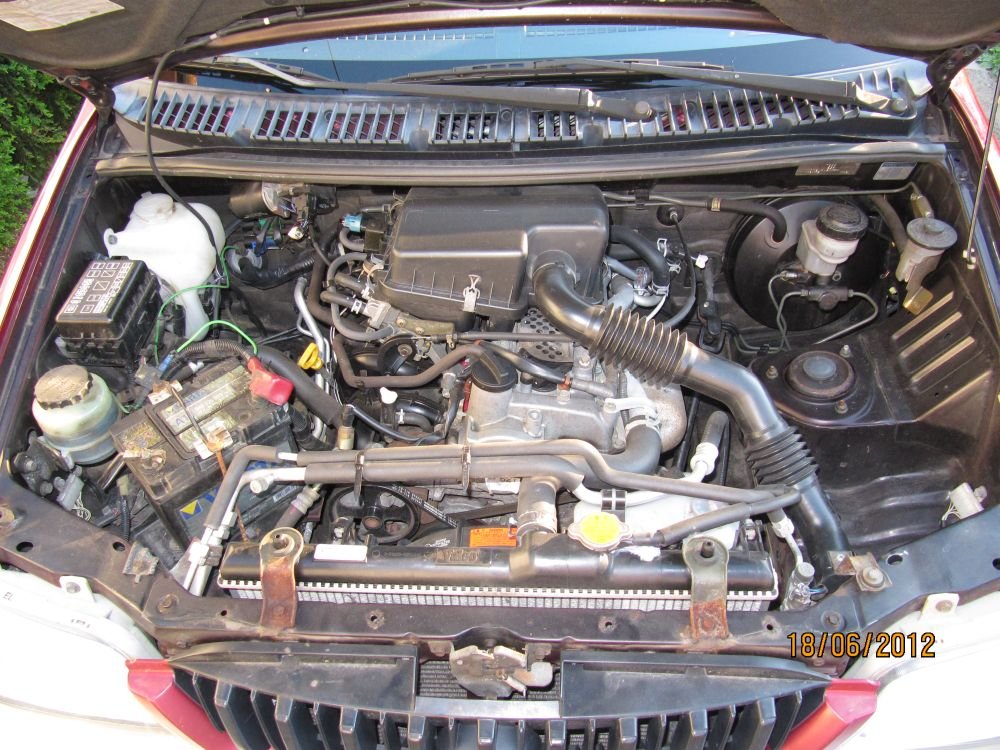

Dorin_Z Posted June 20, 2012 Author Share Posted June 20, 2012 (edited) Re: Daihatsu Terios de la A la Z Datorita faptului ca exista foarte putine informatii despre Daihatsu Terios am sa incerc sa fac o prezentare a specificatiilor tehnice pt Terios Euro 2 si Euro 3: EURO 2 1296 cc type HC 83cp/6100rpm 105nm/5100rpm alezaj: 76 . 0 x 71 . 4 compresie: 9 . 5 : 1 cilindri: 4 cu 4 valve/cilindru injectie: multipunct 11,1 / 7,3 / 8,6 l/100km vit. max. 145km/h 0-100km/h: 16,1s distributie: curea masa proprie: 1115 kg masa max: 1550 kg max. remorcabila: 1400 kg rezervor: 46l benzina tractiune: integrala permanent, buton blocare diferential interaxial suspensie fata: McPherson suspensie spate: ax rigid frane fata: disc frane spate: tambur spatiu porbagaj: 270l spatiu porbagaj cu bancheta rabatata: 1168l unghiul de trecere: 50 unghi de trecere din spate: 38 gradient (Inclinatie): 43 unghiul de rampă: 148 adâncime trecere prin vad: 185 EURO 3 1298cc type K3-VE 86cp/6000rpm 120nm/3200rpm alezaj: 72 . 0 x 79 . 7 compresie: 10 , 0 : 1 cilindri: 4 cu 4 valve/cilindru injectie: multipunct 9,4 / 6,8 / 7,7 l/100km vit. max. 145km/h 0-100km/h: 14,5s distributie: lant masa proprie: 1125 kg masa max: 1550kg max. remorcabila: 1350 kg rezervor: 46l noxe 183g/km benzina tractiune: integrala permanent, buton blocare diferential interaxial suspensie fata: McPherson suspensie spate: ax rigid frane fata: disc frane spate: tambur spatiu porbagaj: 270l spatiu porbagaj cu bancheta rabatata: 1168l unghiul de trecere: 50 unghi de trecere din spate: 38 gradient (Inclinatie): 43 unghiul de rampă: 148 adâncime trecere prin vad: 185 Euro 2 Euro 3 (exista si variante Euro 2, tr avut grija la tipul de motor) Edited June 21, 2012 by Dorin_Z Suzuki Vitara my offroader!!! Link to comment Share on other sites More sharing options...
