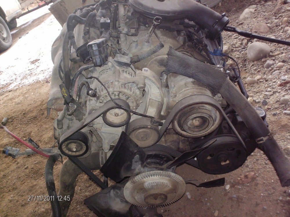

Buna ziua
Aceasta este parerea mea V 8 5.2 l JEEPHPIM8997.thumb.jpg.7fa57bd1fcb80ddf30d06b245ec37c68.jpgHPIM8998.thumb.jpg.bc58ea15cf612c35bb025b970f88d609.jpgHPIM8996.thumb.jpg.43da8121bf9d540991e36c28a6dc24be.jpg
Iti ofera 215 cp ,este scurt ,fara moarte,SOUND fara concurenta, se gaseste la preturi decente
