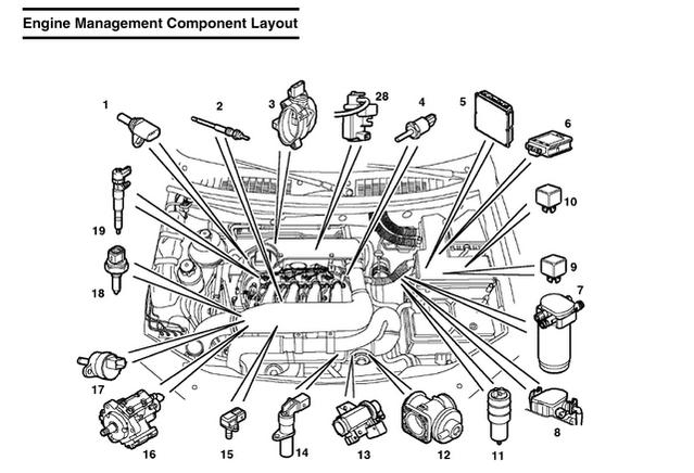

bratu romeo Postat Ianuarie 21, 2012 Partajează Postat Ianuarie 21, 2012 (editat) Re: Limitator viteza ? Masina nu mai trage cand ajunge la 140 Peste 4500 de ture ECM limiteaza motorina in rampa ca sa protejeze motorul , asa scrie in rave. The maximum engine speed for the models is as follows: l Petrol models - 6500 rev/min l Diesel models - 4500 rev/min. Foarte buna ideea lui fery dar s-ar putea sa fie ceva probleme. Failures or malfunctions relating to the ABS sensors and connections are detected by the ABS ECU. In the event of failure of two or more of the ABS sensors the ABS ECU switches off the system and illuminates the ABS, TC, EBD, and HDC warning lamps. If a single sensor fails the ABS ECU maintains the minimum functions to provide safe operation and illuminates the ABS, TC, and HDC warning lamps. The ABS ECU uses the input from the accelerometer to corroborate the inputs from the ABS sensors, e.g. if all four wheels are spinning, the input from the accelerometer enables the ABS ECU to determine the true speed of the vehicle. Daca cei 4 senzori ABS "se defecteaza" in acelsi timp ECM nu av mai primi nici o info despre viteza masinii. Daca in cazul defectarii altor senzori ce contribuie la mamagementul motorului, valorile furnizate de acestia sunt inlocuite cu valori medii stocate in memoria ECM ( nu toti senzorii) in cazul lipsei semnalului privind viteza vehicolului nu stiu ce se poate intampla. PS. La unele masini (alfa 147 )exista un limitator mecanic, un opritor sub pedala de acceleratie. In sensul asta, daca pedala de acceleratie da un semnal eronat spre capat de cursa , adica potentiometru nu se inchide atunci apare si limitare de viteza. Accelerator pedal position: This information is vital to the operation of the ECM and the vehicle. The ECM interprets the electrical signal from the throttle potentiometer as 'throttle' demand and controls the power output of the engine accordingly Editat Ianuarie 21, 2012 de bratu romeo Land ROver Freelander 2002 Td4 2,0 Link spre comentariu Distribuie pe alte site-uri Alte opțiuni partajare...

bratu romeo Postat Ianuarie 22, 2012 Partajează Postat Ianuarie 22, 2012 (editat) Re: Limitator viteza ? Masina nu mai trage cand ajunge la 140 Imi pare rau Info de la senzori ABS ajunge la ABS ECU . Acesta calculeaza viteza masinii si trimite info la ECU motor. ECU motor foloseste informatia trimisa de ABS ECU pentru managementul motorului. The ABS ECU uses the input from the accelerometer to corroborate the inputs from the ABS sensors, e.g. if all four wheels are spinning, the input from the accelerometer enables the ABS ECU to determine the true speed of the vehicle. Si cu asta consider subiectul inchis din partea mea Editat Ianuarie 22, 2012 de bratu romeo Land ROver Freelander 2002 Td4 2,0 Link spre comentariu Distribuie pe alte site-uri Alte opțiuni partajare...
