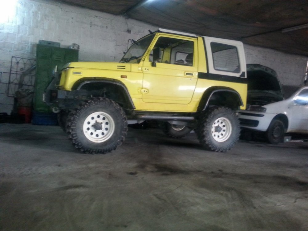

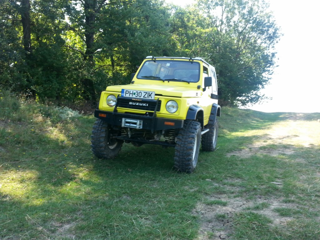

boerumarius Posted December 17, 2013 Author Share Posted December 17, 2013 Re: Modificare si reconditionare Suzuki Samurai. Cateva poze cu masina in cauza : Link to comment Share on other sites More sharing options...

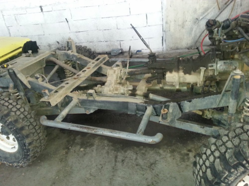

boerumarius Posted December 18, 2013 Author Share Posted December 18, 2013 Re: Modificare si reconditionare Suzuki Samurai. Asa arata azi : Link to comment Share on other sites More sharing options...

koais Posted January 17, 2014 Share Posted January 17, 2014 Re: Modificare si reconditionare Suzuki Samurai. Salut! Arata bine si mai ales curata bestiuta! Conversia pe elicoidale ai facut-o tu sau ai mostenit-o? Ce solutie a fost folosita? Ce alte inbunatatiri mai are? Nici tendoanele nu par de sami Nemo me impune lacessit ! Link to comment Share on other sites More sharing options...
boerumarius Posted January 17, 2014 Author Share Posted January 17, 2014 Re: Modificare si reconditionare Suzuki Samurai. Alte inbunatatiri nu prea, decat blocante pe ambele punti; suspensia a fost facuta acum 2 ani dar o dau jos si-o fac din nou tot pe elicoidale. Link to comment Share on other sites More sharing options...
koais Posted January 17, 2014 Share Posted January 17, 2014 Re: Modificare si reconditionare Suzuki Samurai. Ce arcuri si amortizoare vei adapta? Nemo me impune lacessit ! Link to comment Share on other sites More sharing options...
boerumarius Posted January 17, 2014 Author Share Posted January 17, 2014 Re: Modificare si reconditionare Suzuki Samurai. Inca nu m-am hotarat, mai ales ca s-ar putea sa maresc si ampatamentul. Link to comment Share on other sites More sharing options...

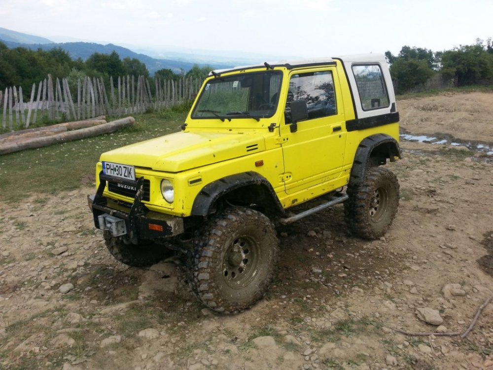

boerumarius Posted July 7, 2014 Author Share Posted July 7, 2014 Re: Modificare si reconditionare Suzuki Samurai. Cateva filmulete dupa transplant : Link to comment Share on other sites More sharing options...

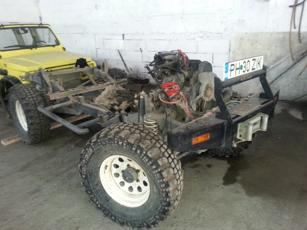

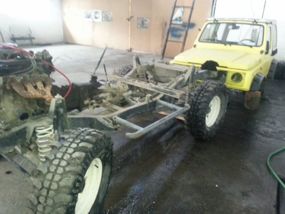

boerumarius Posted January 6, 2015 Author Share Posted January 6, 2015 Re: Modificare si reconditionare Suzuki Samurai. Pentru cresterea stabilitatii o sa-i schimb suspensia si ampatamentul in prima faza duc puntea spate aprox. 20 cm mai in spate. Am cumparat deja 4 tendoane de Mitsubishi. Link to comment Share on other sites More sharing options...
Giani Posted January 6, 2015 Share Posted January 6, 2015 Re: Modificare si reconditionare Suzuki Samurai. Pe spate iti sugerez 4 link sau 2 brate jos impreuna cu V deasupra, fixat in pivot.Daca pui tendoanele de Pajero vei obtine putin mai mult decat ai acum.Pe fata da sunt foarte bune,impreuna cu bara panhard sa-ti tina bine puntea pentru a nu intra in voblaj. Daca duci puntile fata spate sa vezi diferenta atunci. KDJ 90, DID-163 hp Link to comment Share on other sites More sharing options...
koch marius robert Posted January 9, 2015 Share Posted January 9, 2015 Re: Modificare si reconditionare Suzuki Samurai. ce dimensiune au rotile? Link to comment Share on other sites More sharing options...
boerumarius Posted January 9, 2015 Author Share Posted January 9, 2015 Re: Modificare si reconditionare Suzuki Samurai. 31 / 10,5 / 15. Link to comment Share on other sites More sharing options...

boerumarius Posted February 22, 2015 Author Share Posted February 22, 2015 Re: Modificare si reconditionare Suzuki Samurai. S-a marit ampatamentul cu aprox. 25 cm, s-a montat si servo. Urmeaza reamplasarea rezervorului si inca nu m-am decis pentru arcuri. Link to comment Share on other sites More sharing options...
