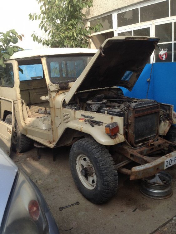

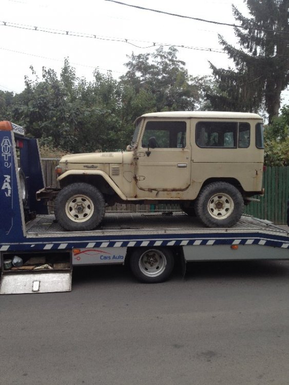

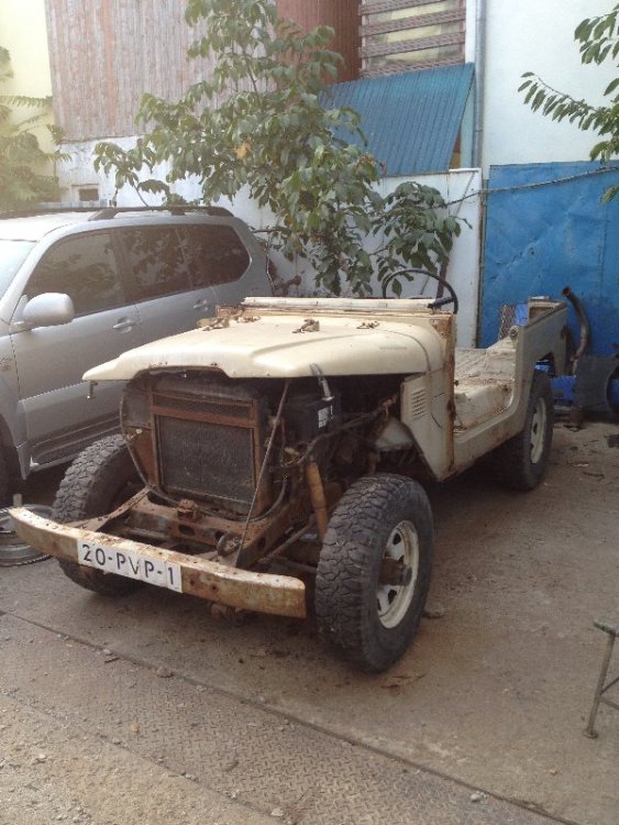

nissan4x4 Posted September 23, 2014 Share Posted September 23, 2014 Venit tocmai din Olanda, un bunicutz 4x4 a sosit la "clinica" noastra pentru a capata o noua tinerete 3 ing. Luigi PIRSU www.nissan4x4.ro service si tunning NISSAN Facebook PAGE: NISSAN4x4 SERVICE Link to comment Share on other sites More sharing options...

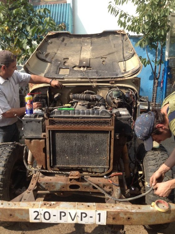

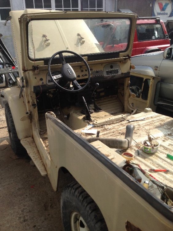

nissan4x4 Posted September 23, 2014 Author Share Posted September 23, 2014 Re: Restsurarare oldimer Toyota BJ40 Bunicutzul se prezinta vioi, are un motor Diesel ce porneste la sfert de cheie... Evident ca bateriile sunt obosite si necesita o surescitare cu boosterul. Odata pornit , a intrat vesel in atelier , pregatit ptr operatiile estetice ce urmeaza ing. Luigi PIRSU www.nissan4x4.ro service si tunning NISSAN Facebook PAGE: NISSAN4x4 SERVICE Link to comment Share on other sites More sharing options...

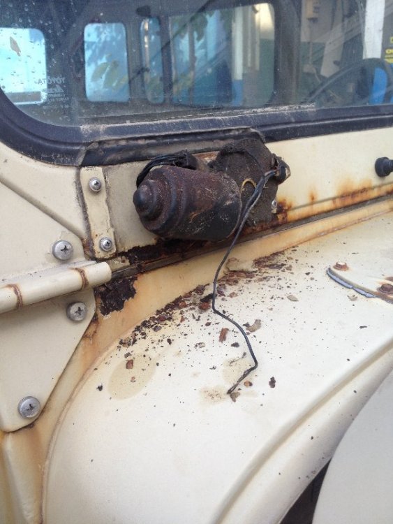

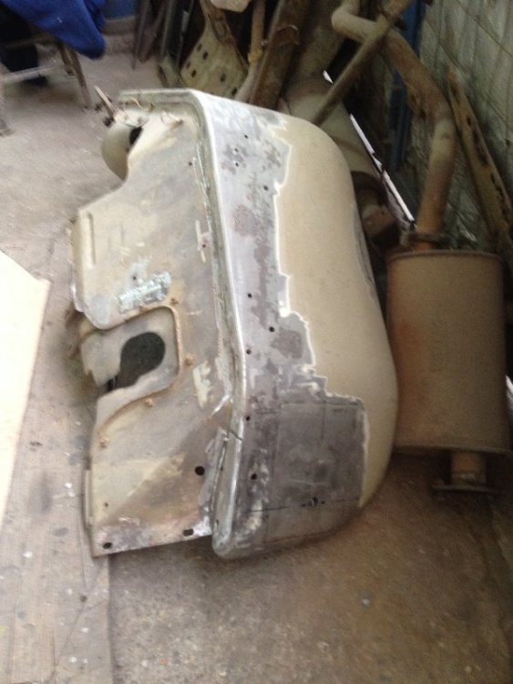

nissan4x4 Posted October 19, 2014 Author Share Posted October 19, 2014 Re: Restaurare oldimer Toyota BJ40 lucrarea continua. -plafon, usi ... jos ing. Luigi PIRSU www.nissan4x4.ro service si tunning NISSAN Facebook PAGE: NISSAN4x4 SERVICE Link to comment Share on other sites More sharing options...

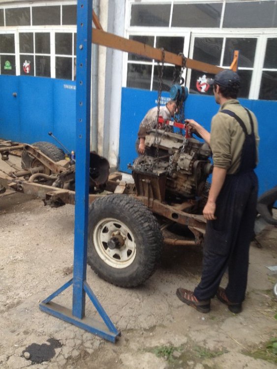

nissan4x4 Posted October 19, 2014 Author Share Posted October 19, 2014 Re: Restaurare oldimer Toyota BJ40 motorul urca la atelierul de la etaj, pentru o inspectie amanuntita jos conducte, rezervor cb, cablaj electric ing. Luigi PIRSU www.nissan4x4.ro service si tunning NISSAN Facebook PAGE: NISSAN4x4 SERVICE Link to comment Share on other sites More sharing options...
Milan Posted October 19, 2014 Share Posted October 19, 2014 Re: Restaurare oldimer Toyota BJ40 Pare sa aiba o baza buna de plecare.Motorul pare a fi 3B din ce deslusesc in poze.Succes colega.Urmarim cu atentie.Daca iti lipseste ceva,arunca o vorba,poate gasim. Link to comment Share on other sites More sharing options...

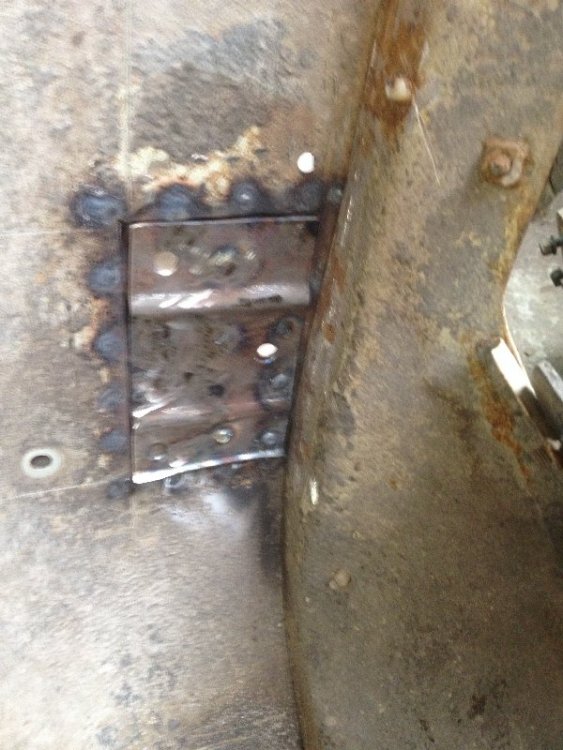

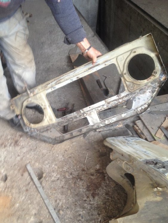

nissan4x4 Posted October 23, 2014 Author Share Posted October 23, 2014 (edited) Re: Restaurare oldimer Toyota BJ40 Lucrand cu migala de chinez, lucrarea continua ! Toate peticele si intariturile sunt confectionate idem cu originalul gasit pe masina, cu ambutisarile aferente, realizate cu mestesugeala din ciocan si nicovala. Sudurile se realizeaza cu MIG pt impact minim asupra metalului. Edited October 23, 2014 by nissan4x4 ing. Luigi PIRSU www.nissan4x4.ro service si tunning NISSAN Facebook PAGE: NISSAN4x4 SERVICE Link to comment Share on other sites More sharing options...

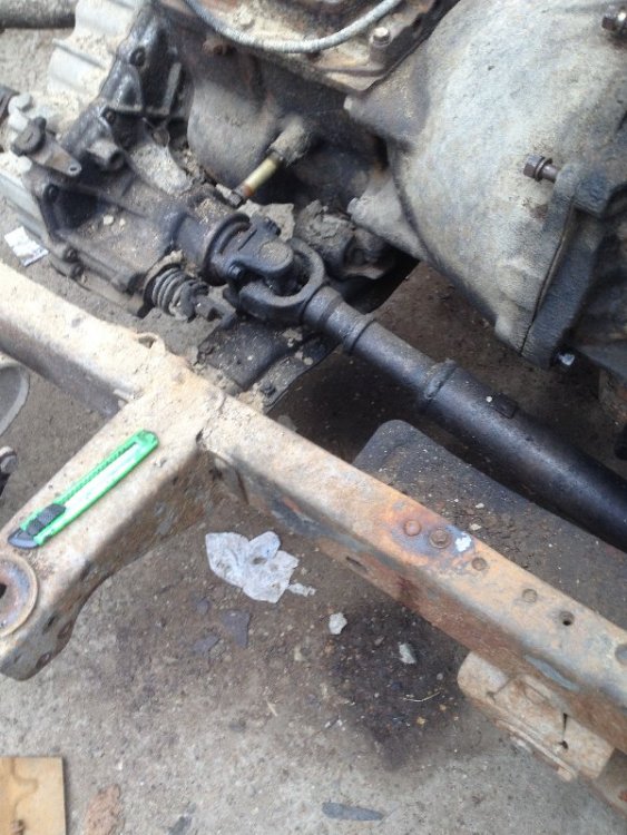

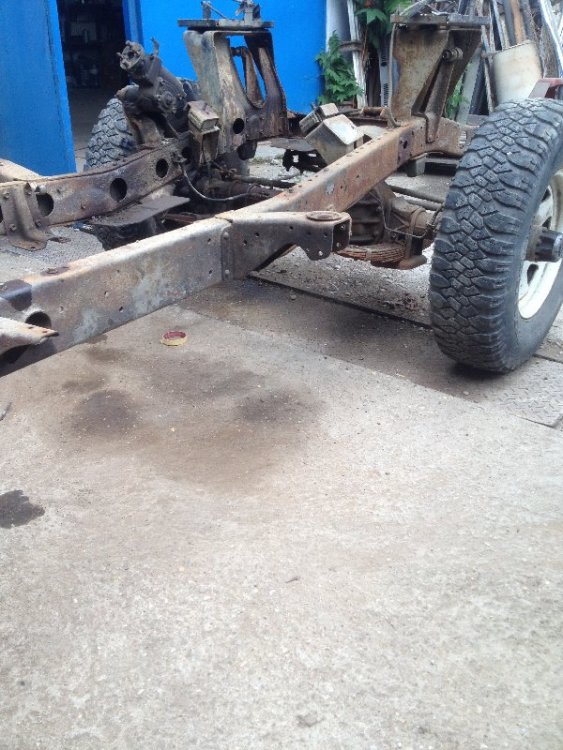

nissan4x4 Posted January 25, 2015 Author Share Posted January 25, 2015 Re: Restaurare oldimer Toyota BJ40 Lucrarea continua, in masura in care timpul permite punem si poze. Am atacat problema sasiului . Dupa demontarea complete a partilor mecanice ( motor, cutie de viteze, punti, conducte etc) am dus sasiul la sablare ing. Luigi PIRSU www.nissan4x4.ro service si tunning NISSAN Facebook PAGE: NISSAN4x4 SERVICE Link to comment Share on other sites More sharing options...
nissan4x4 Posted January 25, 2015 Author Share Posted January 25, 2015 (edited) Re: Restaurare oldimer Toyota BJ40 Dupa sablarea sasiului , a trebuit sa ii facem cateva reparatii, avand zone deteriorate. Urmeaza sistemul de vopsire, unul care sa asigure rezistenta maxima in timp. Am exclus din start vopsirea electrostatica din urmatoarele considerente: - vopseaua e dura si la un sasiu care sufera deformatii la orice groapa, am considerat ca pot aparea microfisuri ce nu dau durabilitate lucrarii - vopseaua e sub forma de anvelopare , punctele de rugina facandu-si serios de cap pana sa alara la suprafata - nu se pot aplica grunduri sub vopseaua electrostatica. Am ales un system de vopsire epoxy, compus din: - grund fosfatic (galben), al caror componenti transforma instant rugina (hidroxid feric) combinandu-se cu acidul fosforic din grund ...rezultand hidroxid feros , neutru si necoroziv ,in plus pelicula rezultata constituie un strat de protectie anticoroziv f eficient - grund alchido melaminic , cu fosfat de zn, ce se fixeaza peste grundul anterior, impiedicand ca oxigenul din atmosfera sa penetreze pana la metal - vopsea epoxy bicomponenta , cea mai rezistenta vopesa de pe piata. Un fel de poxypol colorat ce imbraca la fina sasiul Zonele delicate , le masiticam cu cordoane ptr protectie, vezi foto Edited January 25, 2015 by nissan4x4 1 ing. Luigi PIRSU www.nissan4x4.ro service si tunning NISSAN Facebook PAGE: NISSAN4x4 SERVICE Link to comment Share on other sites More sharing options...
