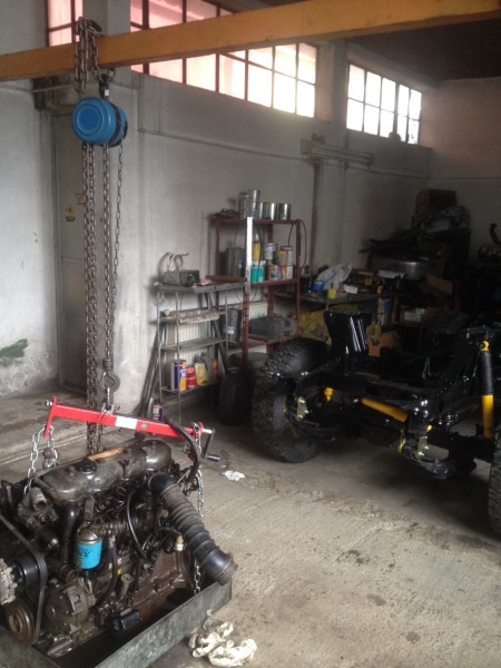

nissan4x4 Posted January 25, 2015 Author Share Posted January 25, 2015 Re: Restaurare oldimer Toyota BJ40 Urmeaza montajul mecanicii inapoi pe masina. ing. Luigi PIRSU www.nissan4x4.ro service si tunning NISSAN Facebook PAGE: NISSAN4x4 SERVICE Link to comment Share on other sites More sharing options...
matake70 Posted January 25, 2015 Share Posted January 25, 2015 Re: Restaurare oldimer Toyota BJ40 Foarte frumos D-le Luigi,lucrare calificata ce sa zic amortizoare ,arcuri, si cercei gresabili anti inversie OME,treaba buna si spor la treaba !!!!!! FJ40, 4.2, `77 HZJ75, PICK-UP, 4.2D, `96 KZJ78, 3.0TD, `93 Link to comment Share on other sites More sharing options...

nissan4x4 Posted January 29, 2015 Author Share Posted January 29, 2015 Re: Restaurare oldimer Toyota BJ40 Am optat pt o suspensie OME, desi initial ma orientasem catre IRONMAN. Argumentul a fost ca OME se livra mai repede, fiind o masina rara , piesele pt ea sunt greu de gasit. Intradevar, am luat "the best" , inclusiv cerceii antirotation si bolturile gresabile. ing. Luigi PIRSU www.nissan4x4.ro service si tunning NISSAN Facebook PAGE: NISSAN4x4 SERVICE Link to comment Share on other sites More sharing options...

Max Posted February 7, 2015 Share Posted February 7, 2015 Re: Restaurare oldimer Toyota BJ40 Am optat pt o suspensie OME, desi initial ma orientasem catre IRONMAN. Argumentul a fost ca OME se livra mai repede, fiind o masina rara , piesele pt ea sunt greu de gasit. Intradevar, am luat "the best" , inclusiv cerceii antirotation si bolturile gresabile. Eu am ambele variante de cercei si OME si Ironman. La Ironman imi place faptul ca gresoarele sunt ingropate in piulite deci sunt mai protejate. La cele de la OME am rupt gresoare in teren. In rest, cerceii sunt identici. Link to comment Share on other sites More sharing options...

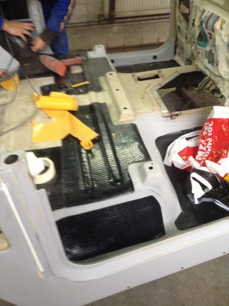

nissan4x4 Posted February 9, 2015 Author Share Posted February 9, 2015 Re: Restaurare oldimer Toyota BJ40 pregatim caroseria de vopsire. Dupa grunduirile si antifonarile ca la carte , sarim repede cu presuri insonorizante bituminoase. Fac masina mai linistita si ofera ceva protectie podelelor . Covorasele au autoadeziv pe spate, ele se taie usor cu cutterul pe forma dorita si apoi se incalzesc cu lampa de gaz sau feon-ul industrial. Se muleaza mirific pe orice forma a caroseriei 1 ing. Luigi PIRSU www.nissan4x4.ro service si tunning NISSAN Facebook PAGE: NISSAN4x4 SERVICE Link to comment Share on other sites More sharing options...
